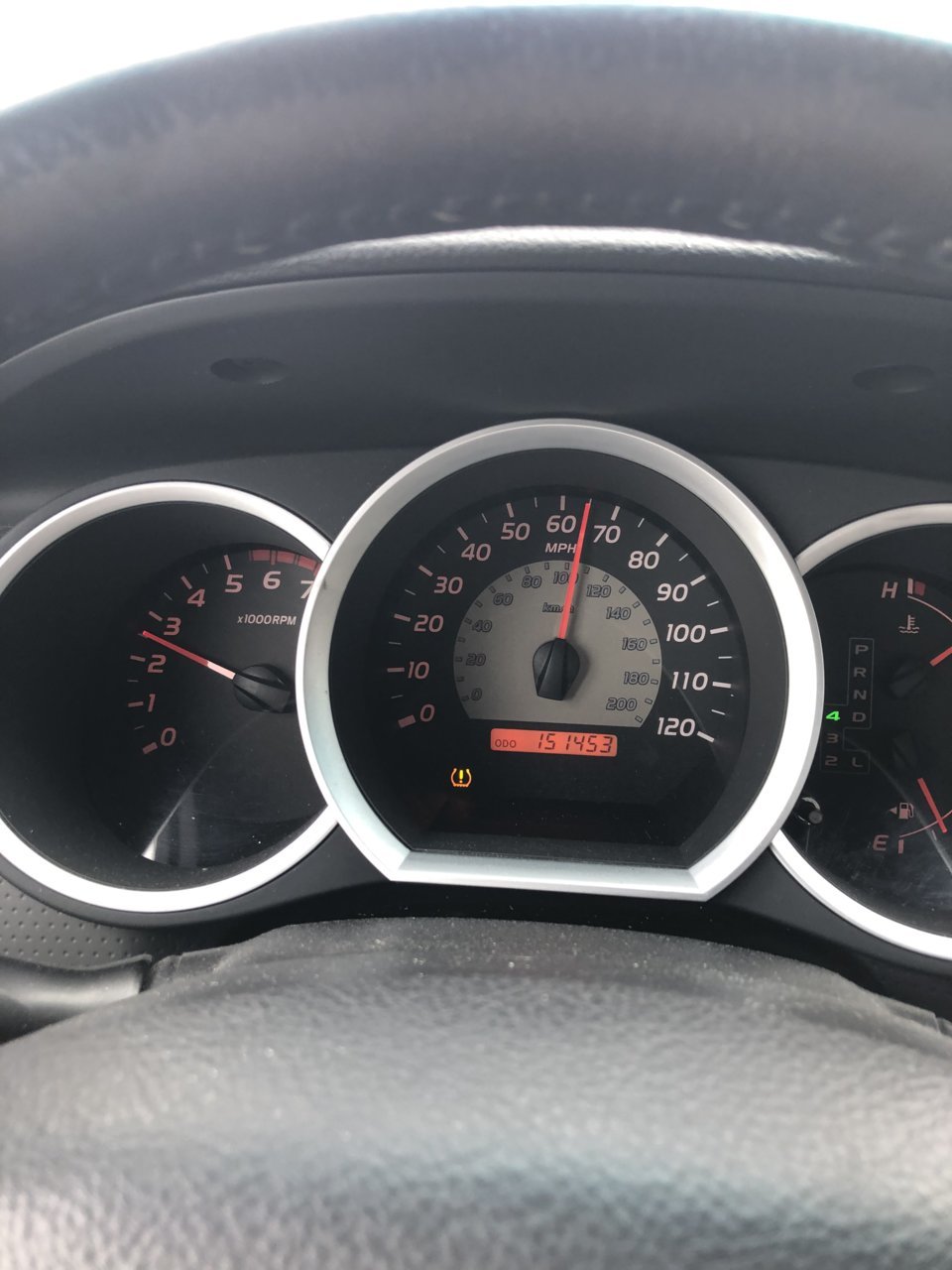

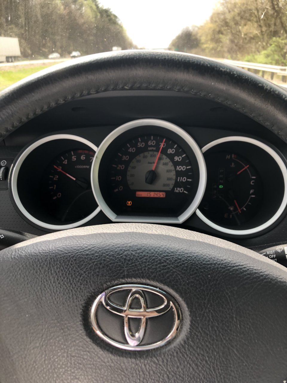

    Here is my truck in 4.
    And Yes, it was in D in one of the pics.
    You just have to trust me on it being in 4th. I took these while towing.
    And before anyone tells me NOT to tow in 5th. I know this. So no need to waste your time telling me it. C7F42D9E-6DF5-4BB2-B27C-233FE6878294.jpg89EC8222-2BD4-4E50-B6F7-8142373C633D.jpg
