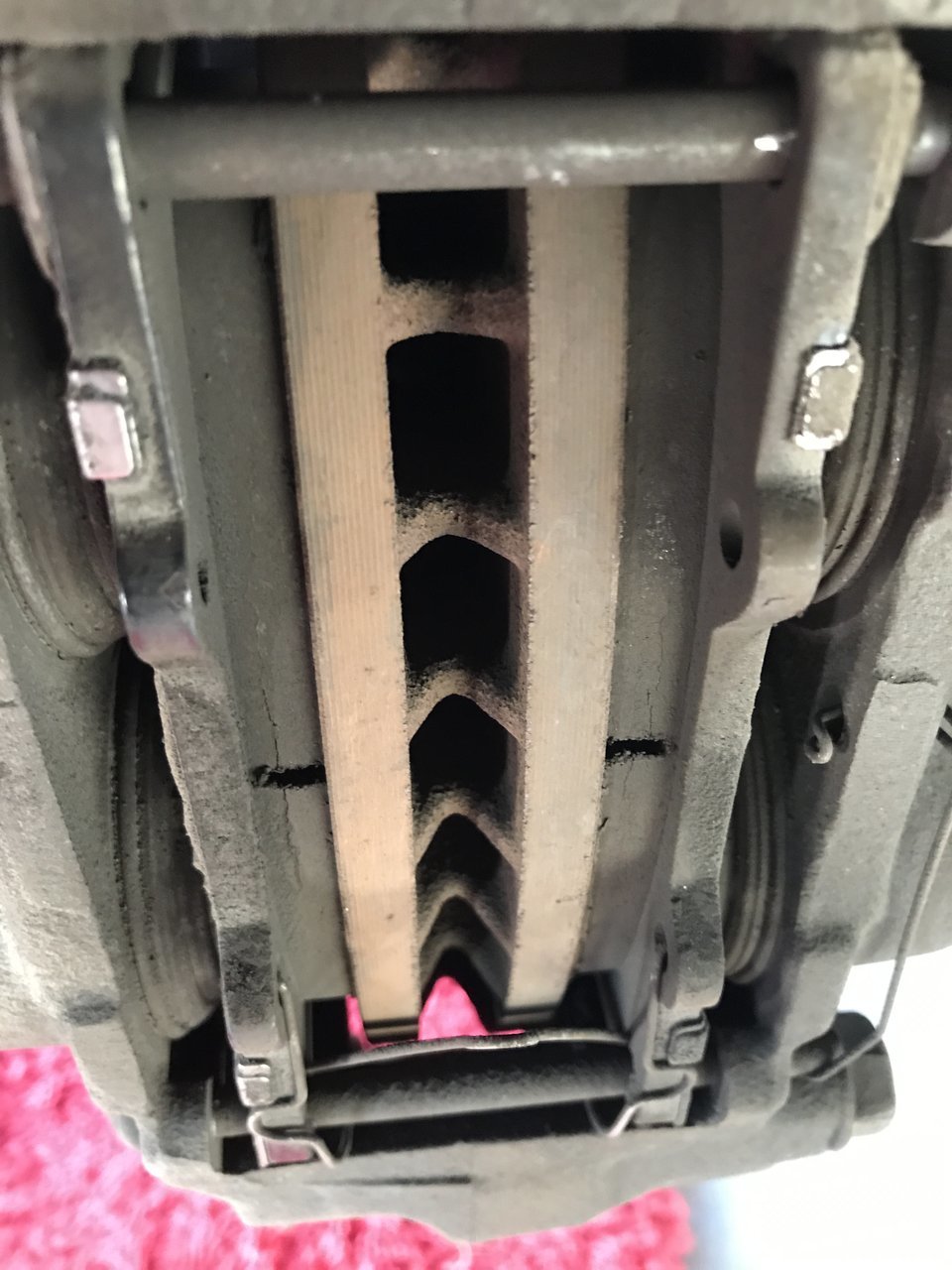

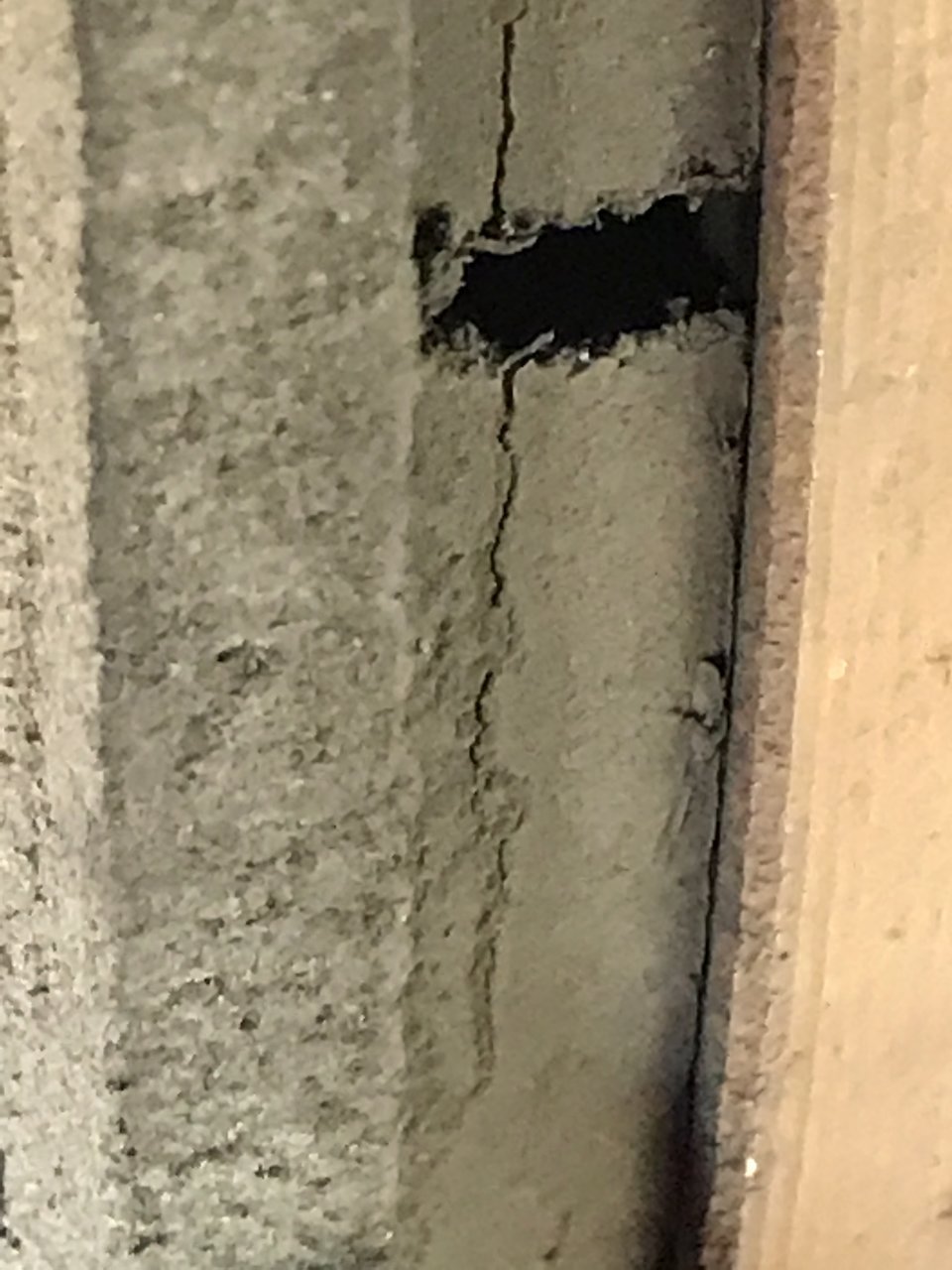

    Lately, going 50 mph I step on the brakes and my steering wheel shudders. I pulled off one front wheel and the rotor looks good -- no grooves. The pads look good, too -- thick. Then I notice a crack in one pad -- see photos. What's going on? Anybody want to chime in?

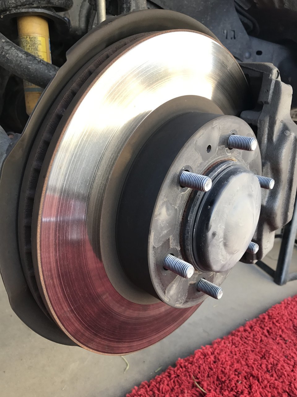

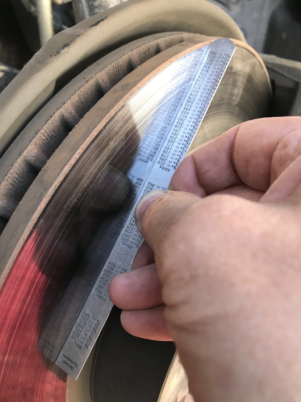

    EDIT: Thanks for the replies, guys. I will take into service at Toyota and report back. Meanwhile, I've uploaded photos of the rotor for your viewing pleasure. See the straight edge placed strategically across the rotor where the brake pads meet it. There's no gap showing warping, but this isn't scientific proof it isn't warped. I'll get back to you after a pro looks at it.
    Update: I took my truck to Toyota/Cathedral City, Calif., and they determined the rotors were warped. They resurfaced my front rotors and replaced the front brake pads -- under warranty! OMG. What a great service department. They even washed my truck inside and out. Also, they adjusted the PSI in all four tires so my idiot indicating uneven tire pressure went out, finally. They spent hours on my truck, and made Toyota pay for it, not me. Gotta love it.

    You probably got the rotors hot, and they warped a bit. Happens a lot. Hard to tell from looking at them.

    Looks like both pads are cracked. May, or may not, be source of vibration. Either way, the vibration should be covered under warranty. Our Lexus had vibration at 30K and Toyota replaced rotors and pads.

    I did a quick google and I don't think the cracking is critical. Cracking was listed as indication of thermal stress. It may be the cause of noise.

    The same thermal stress that cracked the pads likely also warped the rotors.
