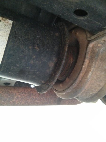

    Here's a photo of my CB. It can hear it clanking and rattling when I push it up and down. If you can tell, its kinda sitting on the bottom, not necessarily held in the middle of the bearing. I can push it up about 1/4" from where you see in the photo.

  17. Jul 29, 2014 at 5:23 PM
    #37
    MagneticTaco79
    MagneticTaco79 COLD ASS HONKY
    Apr 28, 2014
    #128692
    704
    AARON
    WV
    Mag Grey 2012 Tacoma AC TRD Sport 4x4
    ALL KINDS OF SHIT
    Yeah, that is for sure one of your issues.
  18. Jul 29, 2014 at 5:28 PM
    #38
    TacoLlama
    TacoLlama Well-Known Member
    Jun 29, 2014
    #132919
    195
    R.I.
    2019 SR5 DCSB
    The rubber is worn pretty good on yours.The bearing failing is a clicking sound with up and down pressure.Metal on metal.I'm not saying that worn rubber isn't changing your angle.Flip that CB and drop it 3/4 of an inch.It will be back to stock if you have a 1/4 inch play.I think flipping the CB takes it up an inch. You will need longer bolts to pull the job off. :D
  19. Jul 29, 2014 at 6:45 PM
    #39
    MagneticTaco79
    Apr 28, 2014
    #128692
    704
    AARON
    WV
    ALL KINDS OF SHIT
    First thing I would do is REPLACE that CB. Looks well done in the pic
