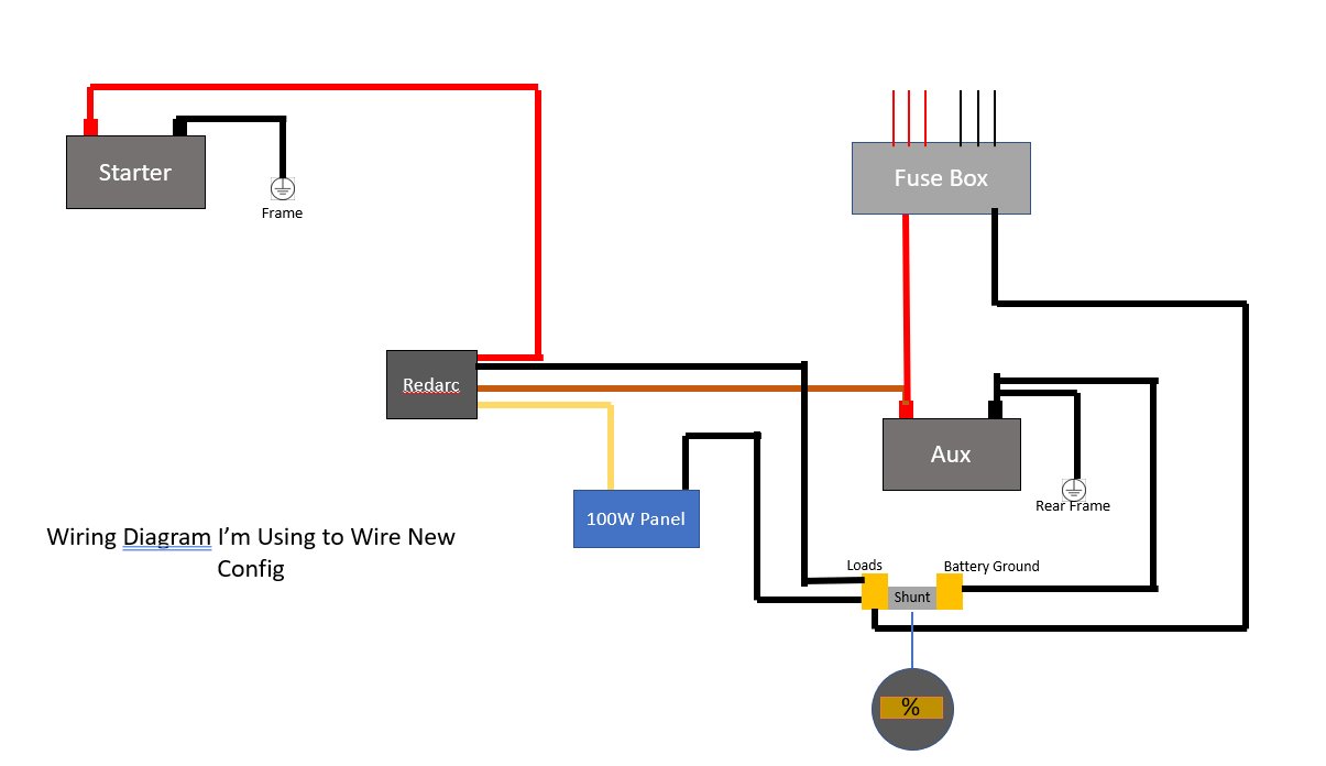

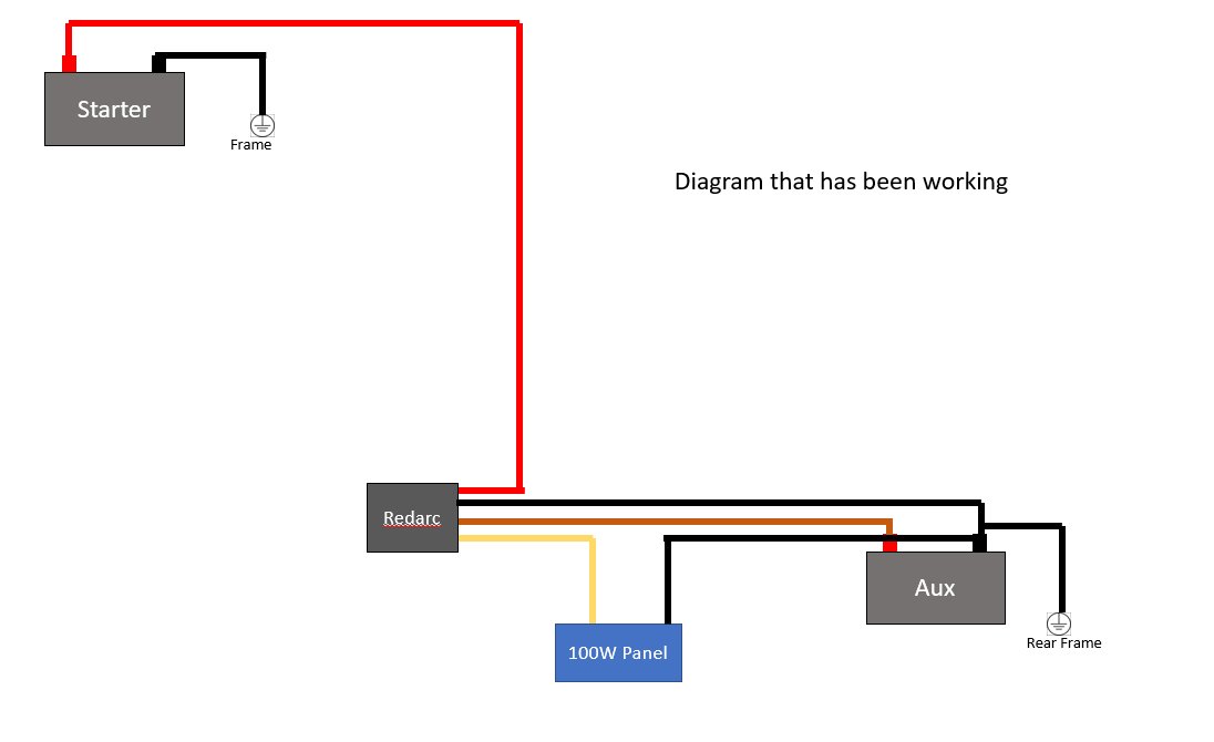

    Hey guys,
    I've been running a dual battery system with the Redarc bcdc25 and a 100W solar panel with no issues. My aux is in the bed of the truck. I'm cleaning up the rear wiring which means adding a fuse box and a shunt to read battery life, charge in and charge out etc.
    The wiring diagrams are dumbed down just to show the routing. No fuses and no loads shown such as lights, fridge etc.
    The first diagram is what I have been running with no issues.
    The second diagram is what I'm currently wiring. I understand the principal of a shunt. The "load grounds" and battery ground are between a "resistor" and we get current from the dV across the resistor. I=V/R, simple. It was mentioned in a van life that the Aux shouldn't be grounded to frame or the redarc would cause the shunt to read a negative amperage since it's already grounded through the starter battery. Not sure I understand this. It seems weird to "float" the aux battery.

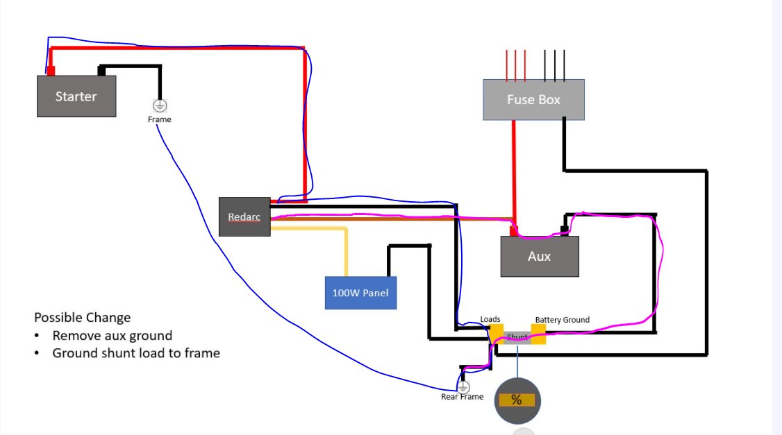

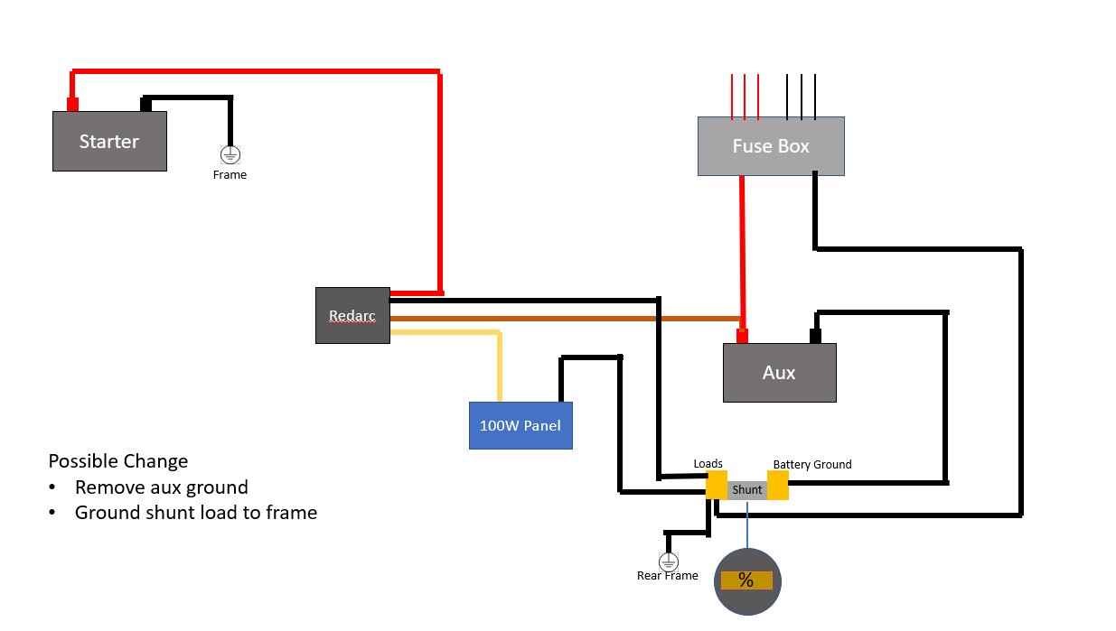

    A more circuit savvy friend of mine explained option 3 to me and it makes sense now. I will finish wiring it up and report back.
    Blue line is the full red-arc circuit
    Magenta line is the full aux battery charging circuit
    As for me mentally not accepting that the aux battery doesn't have a physical ground cable from negative post to frame, that is resolved.
    The battery is still grounded to frame, but through the shunt. It doesn't make sense to connect aux negative post to frame, when you connect aux negative post to shunt. That would throw off the reading.

    Checking back in.
    Looks like battery was full and floating upon first startup. No light for solar either so I was getting no charge.
    Attached some loads (fridge,shell lights ) and was getting perfect numbers so I’m pretty sure it’s all good. Will report back if any issues.

    The ground connection through the shunt is what allows you to measure the battery. If you were to bypass the shunt with another ground from the battery to the frame or wherever you won't get accurate readings.
    frenchee[OP] likes this.
