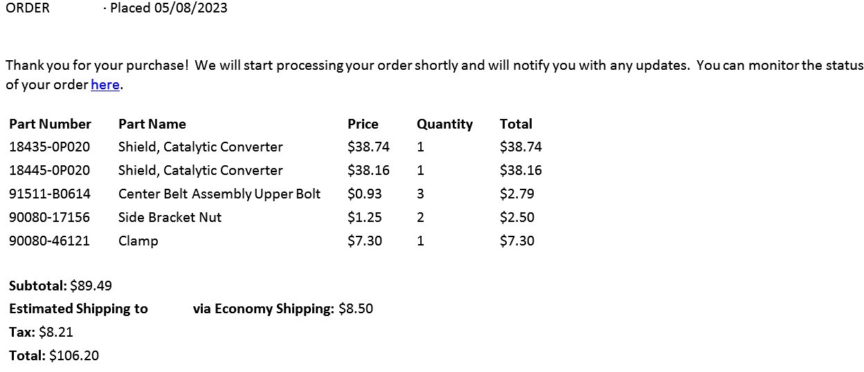

    Get under the truck and look at your catalytic converter on the driver side. See if there is a clamshell shield on there. Most likely there isn't....and most likely you have a rusted out clamp hanging on for dear life making that intermittent vibration noise. That's what happened to my 2014 Tacoma with 106K on the clock. It will be stuck between the catalytic converter and a "Y" shaped exhaust hanger on the driver side.
    The bolt holding the clamp was completely rusted as was the nut. And there are 2 bolts for the front of the protector/heat shield that must have completely rusted out.
    I ordered a whole new set (2 clamshell havles, 3 bolts, 2 nuts, and a clamp) for $105 to my door.
    Look at my thread for pics.
