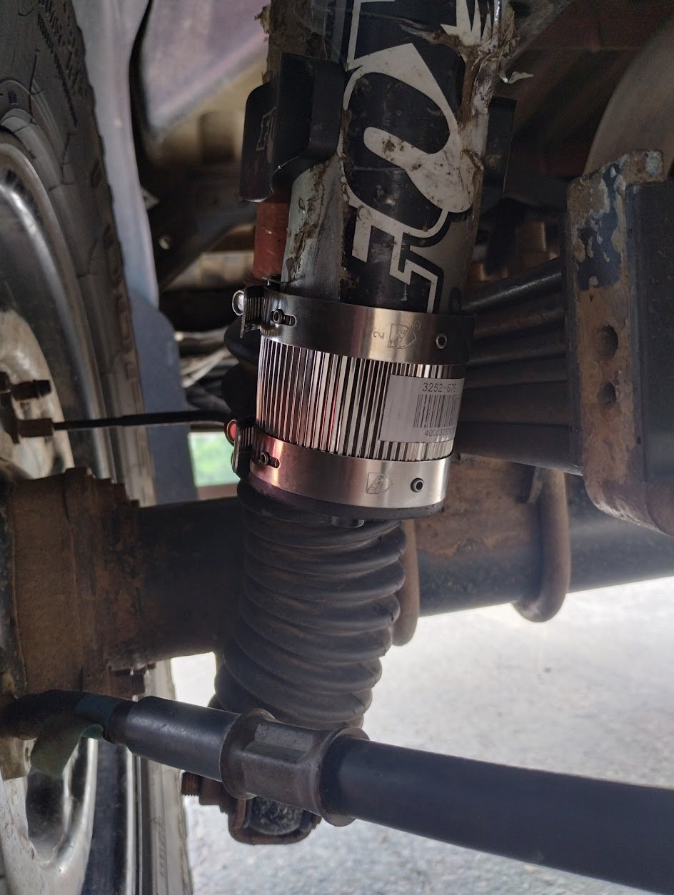

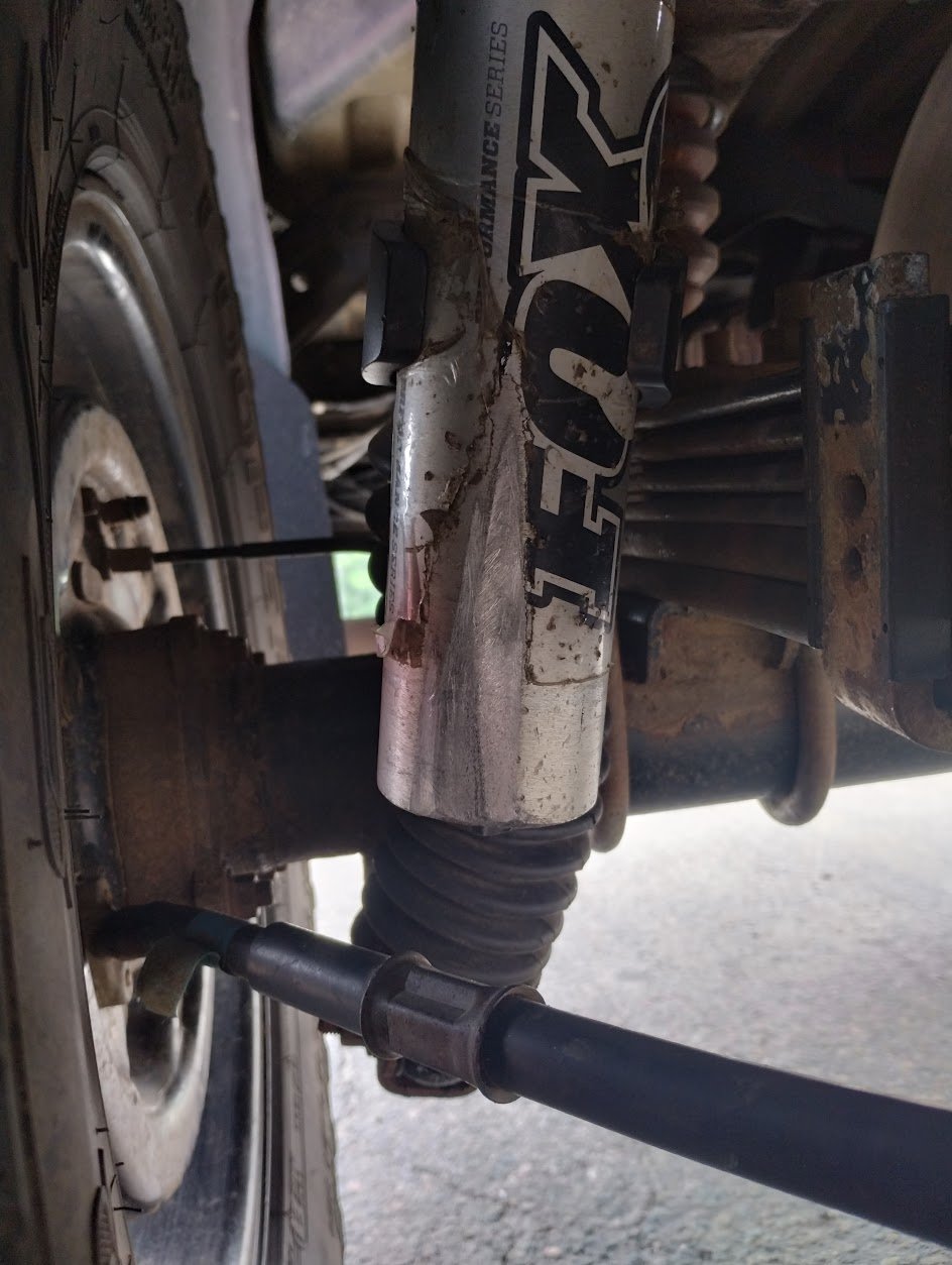

    So noticed my Fox 2.0 (passenger side) resi was wearing against the e-brake line
    temp solution:

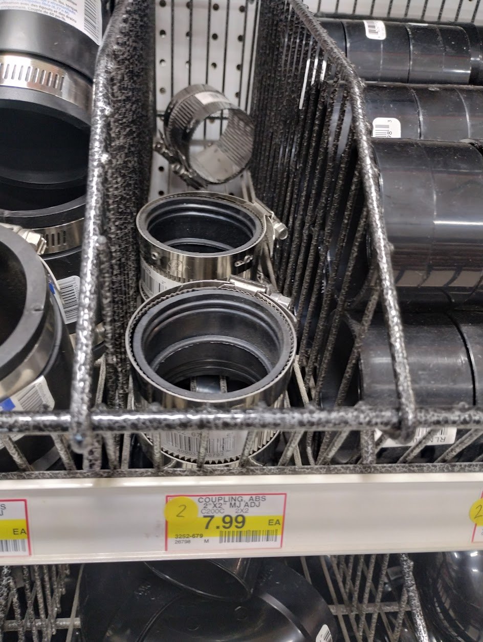

    ABS 2" pipe coupler
