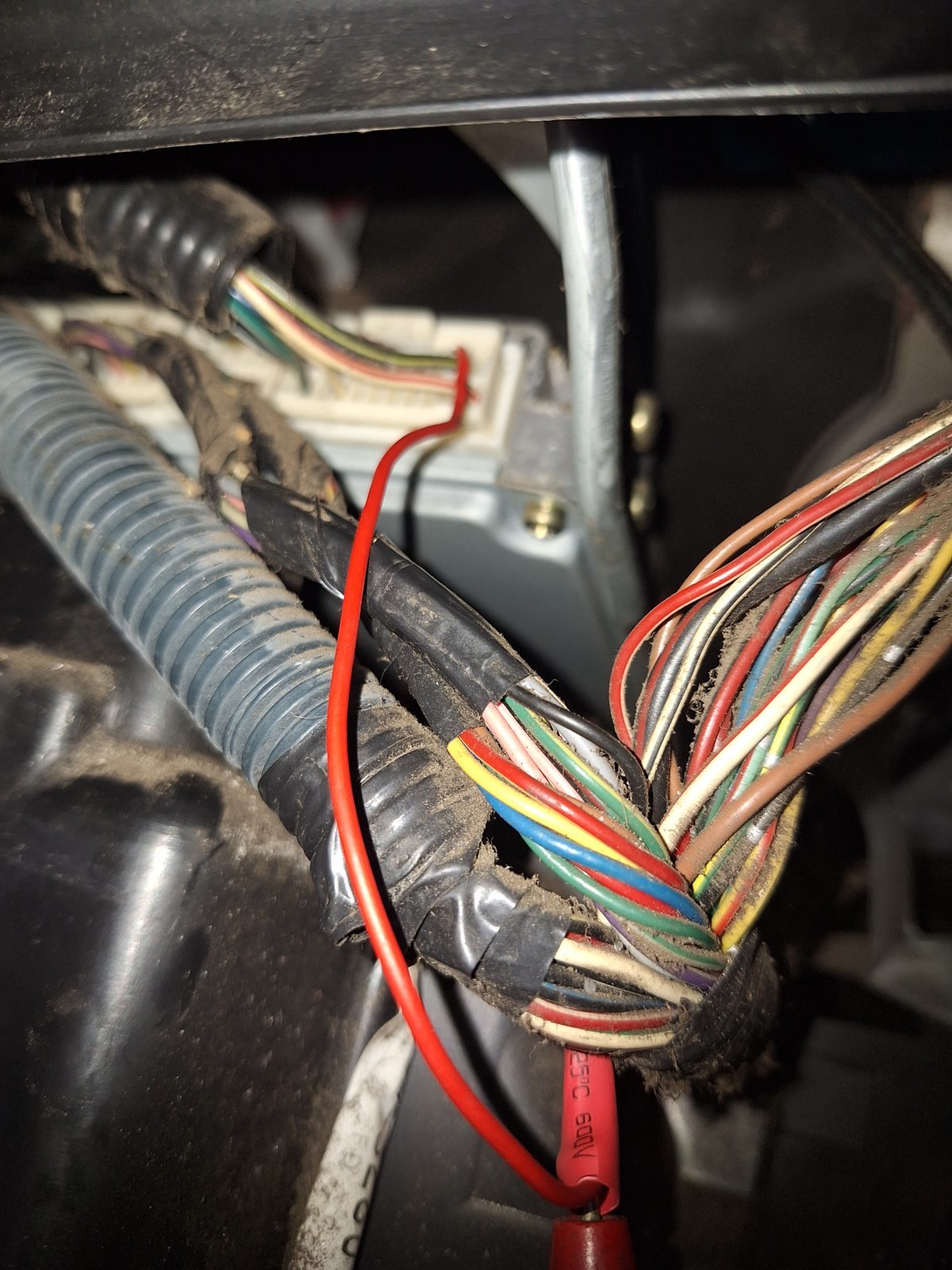

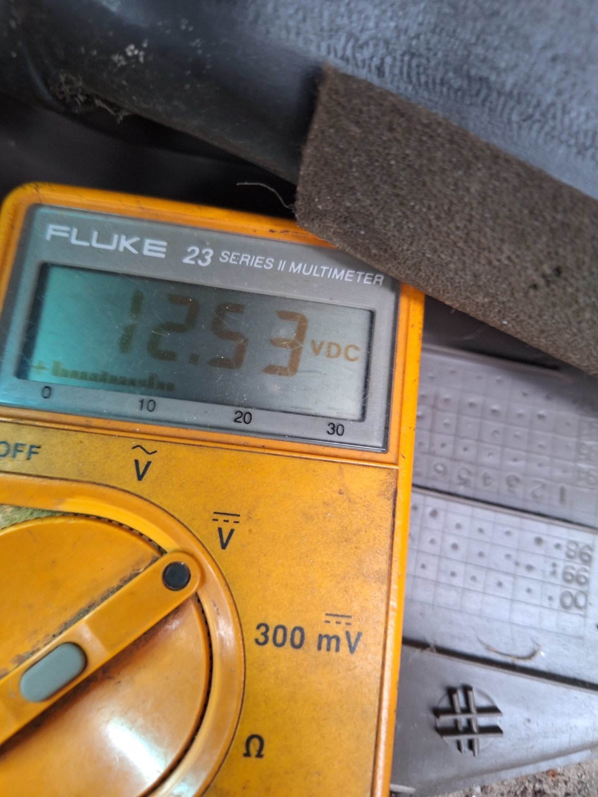

    Checked pin #2 on e5 at ecm to ground with meter had 12.53 volts. With key on , cold .
    Now if I turn off key for a minute or longer it takes apx 2.5 minutes for light to come on and truck cranks fine.
    My friend said now I have a built in Antitheift device.... haha

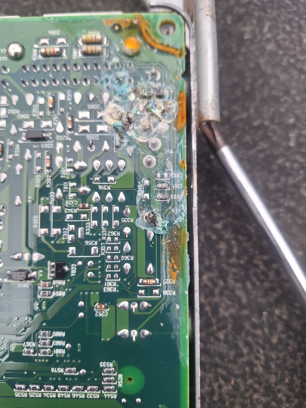

  13. Mar 2, 2024 at 1:03 PM
    Here's johnny
    Here's johnny [OP] Member
    Feb 29, 2024
    #444906
    10
    2000 tacoma 2.7 4x4
    Dm93 is spot on.
    You the Man.
    Pulled the ecm and opened the cover.
    Definitely water damages.20240302_155547.jpg 20240302_155933.jpg 20240302_155933.jpg

  15. Mar 2, 2024 at 2:14 PM
    Dm93
    Dm93 Test Don't Guess
    Mar 3, 2015
    #150066
    13,818
    Texas
    2014 DC OR 6spd 4x4
    Predator tube steps, Ranch Hand grill guard, Magnaflow CatBack exhaust, Toyota tool box & bed mat, 2LO Module by @Up2NoGood, Rearview Compass/Temp Mirror, Tune by @JustDSM.
    Yea it looks pretty bad, hopefully you can find one.
    You may check www.hollanderparts.com for a used one.

    I re- soldered one of the bad places on the ecm board and cleaned it up.
    The truck still took about 5 minutes before the check engine light came on .
