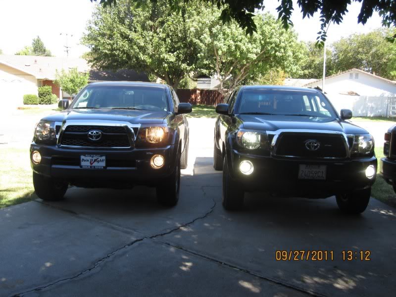

Side by side comparison hid vs stock lights

    6000K? 8000K?

    4300k from slim chubby group buy. i was thinking 6000k but after careful research I realized that 4300k is the closest to my audi and VW which I really like the looks of a natural bright white as oppossed to a bluish tint which to me tends to look like the cheapos at your local auto store that is just my opinion.:D

    Looks good, I wanna get hid's I'm just afraid of blinding other drivers. You should get a night shot next to eachother

    Looks like the photo above IS the stock housings?
    This has mixed success depending on how the stock housing is made, I have had it work well for some vehicles, but be way too blinding in others.
    So, do the HIDs work well in the stock housings for our trucks then?
    I realize that getting the better housings or retro fits would be even better, but I was curious if the stock housings at least project a nice, and safe beam.

    The OP's photo is of HIDs in stock housings. As WWFirefighter stated, you can adjust stock housings so it's not blinding to oncoming traffic however it's still not the best idea in my opinion. Reflector style housings are not meant to receive HID's. A big factor is the HID kit itself. Some have a shield that sits below the HID bulb that helps with the stray light issue, others do not have this shield and cause blinding light to oncoming traffic.

    Those lights in the OP must suck hard when approaching. I think hid brights are the way to go. Lows don't work unless they have projector cutoffs.

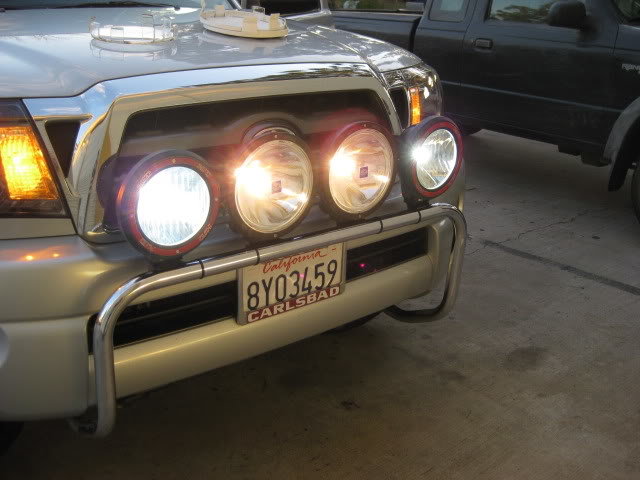

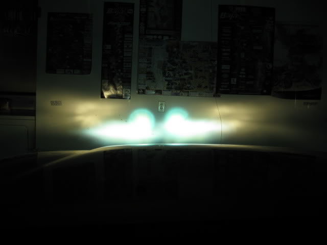

    The two center lights are Hella 4000s with 100 watt halogen bulbs. The two lights on the outter side of the Hellas are Kragen 35 watt HID bulbs.

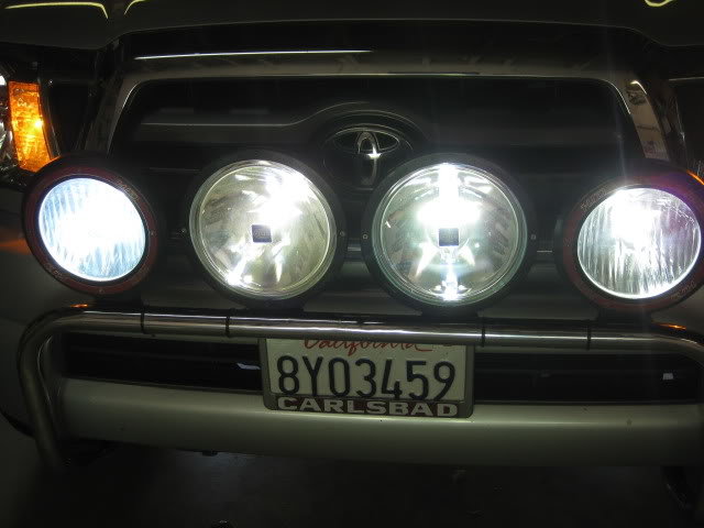

    Here are the Hellas with 35 watt, 6000ºK bulbs (so said GG Lighting). They were too blue and useless off road (dimmer than the halogens). Others have said these look more like 8,000ºK bulbs...?

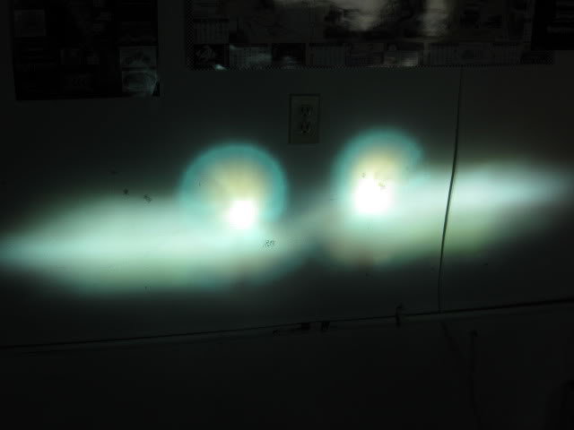

    On the garage wall, both.

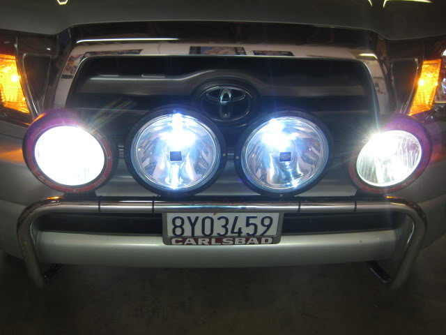

    Now, that's the ticket... Hellas with 5,000ºK bulbs. Color very close to pure white and very close to the Kragen Euro Beam HIDs.

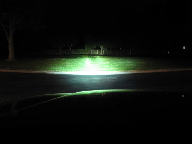

    Lighting up a grassy slope on the street by my house... I have adjusted the aim up more since this photo as well as spreading the Kragen's euro/ driving beams apart to light up a wider area... More photos to come!
