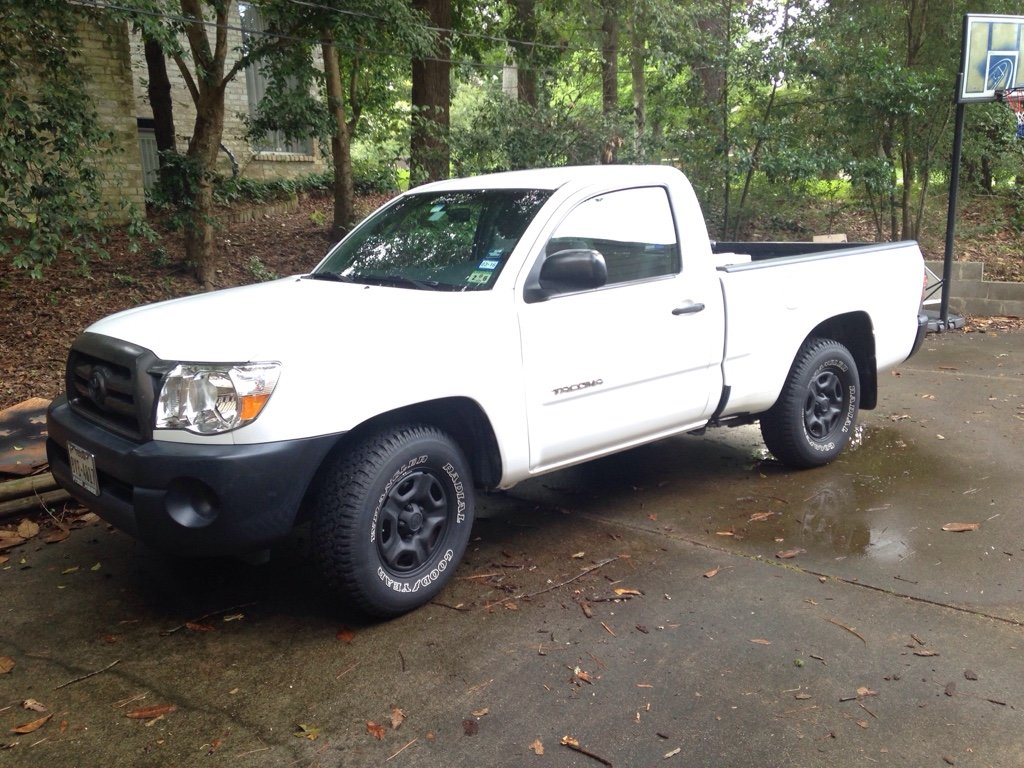

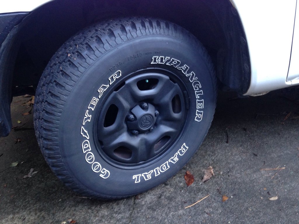

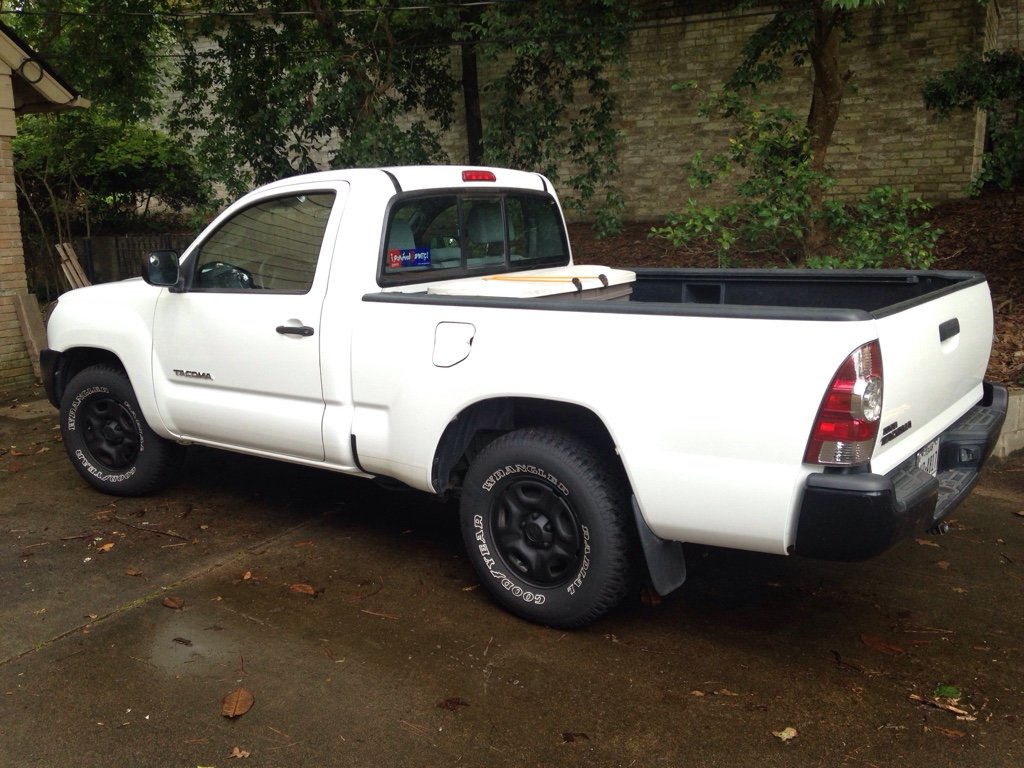

    235 75 R15 Goodyear wrangler radials. Plastidip factory wheels, emblems. Headlight TSB
    I believe I even saw your post here when I was thinking of changing to a bigger tire, I like the look you have there, and my superwhite RC base 4-banger looked big compared to the original tires on there. I still couldn't bring myself to get rid of four perfectly good used tires, until I picked up a screw and it was "unrepairable" according to the guy at discount tire.
    That was all i needed. I had Wally put on a new set of Goodyear Wrangler Radials at 235 75 r15 on the stock rims. I have the auto, and I can say I feel the difference. The new tires are 2 inches larger, and as I've seen others post, they have plenty of clearance.
    Wally made me sign a paper stating that they did not suggest the tires and were not liable for the fit.
    It does do a bit more down shifting, and the mileage has decreased a bit. When calculating mileage I have to multiply by 1.075 to make up the difference. My speedometer also shows about 2 mph lower than actual speed, whereas before it was showing 2 over actual.
    Pics of the truck after plastidipping the stock wheels. 8e352c8982207c1d320b5fb712f24c6e_16d5882ab9bedd7ca14620b8b657a4a1653b77cf.jpgcc81ec7ca34efb02370225180d345087_b8a0a8f93792321359fb93cd11fbf0501024d655.jpga4ac88def744f347d122bf916df9c436_025e0cc7ec0e114cab4f54409c80bf7f0473c4e5.jpg
