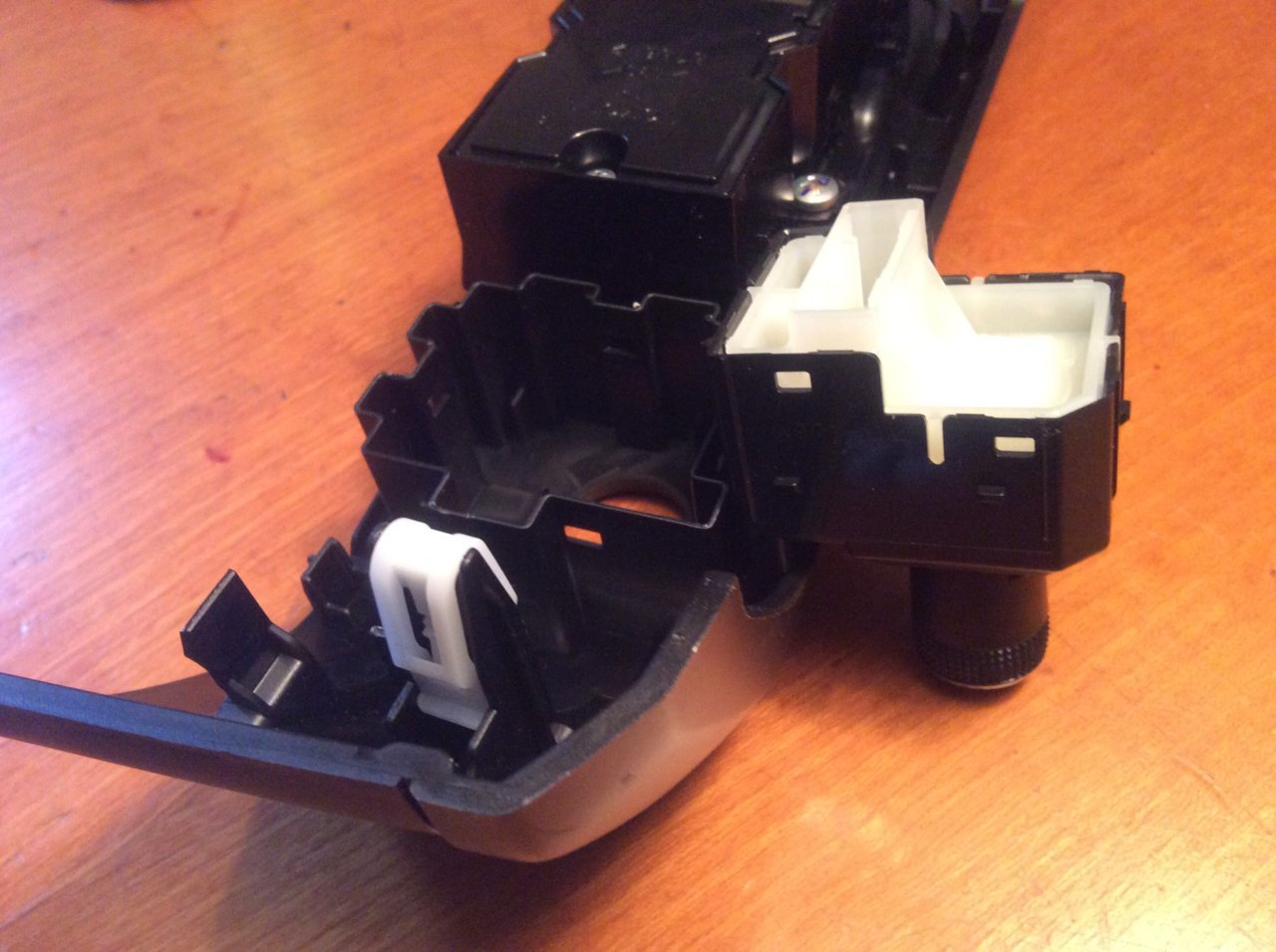

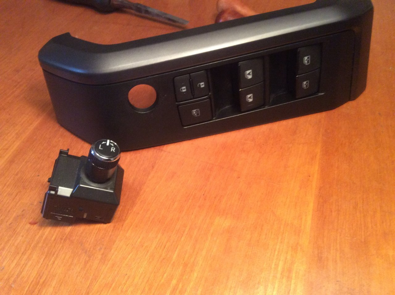

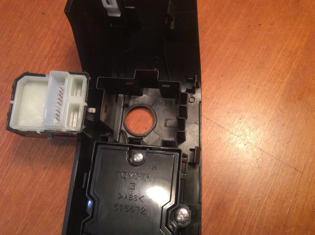

    image.jpg image.jpg image.jpg I have the door panel off so I look at the window/ mirror switch panel and think how does this come out. Push on the square spots sticking out while pushing up on the button from underneath. The more you push the higher the button goes when it lets go. 5 tabs to depress in all. Hope it helps someone.
