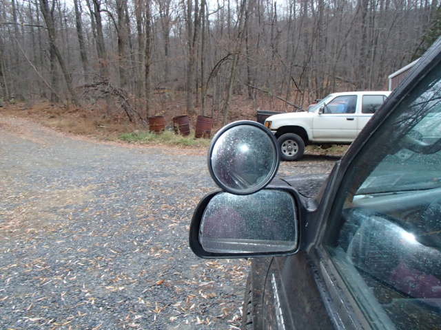

    I put 5" round spot Mirrors on Top of the Factory mirrors I liked them so much I put them on the 4Runner

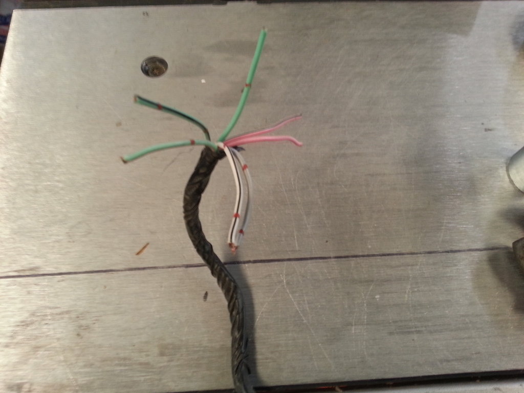

    First get yourself a switch off of a 4runner or Tacoma with power windows. I suggest ebay or junkyard since they are fairly cheap there. Try and get one with a pigtail attached.
    This is the pigtail connected to the the actual switch. You will have to run wires from these to your mirrors.
    Grey is 12v power (They recommend radio tap)
    White w/black stripe is ground.
    Green w/red stripe is right mirror
    Green w/black stripe is right mirror
    Solid Green needs to be split to both mirrors
    Pink w/green strip is left mirror
    Pink is left mirror
    Thats all there is too it.

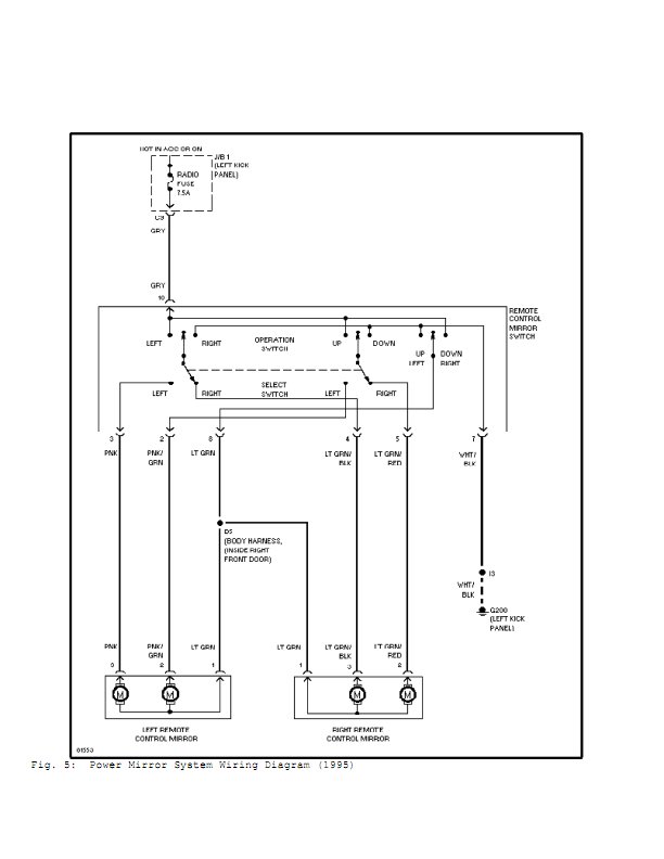

    Here is a wiring diagram to help you understand:
    Keep in mind you may have to test the actual connections at the mirror ends if the wires don't color match (depending on year of your mirrors). Just swap two wires at a time until the mirror goes in the direction you press on the button. Good luck and have fun!

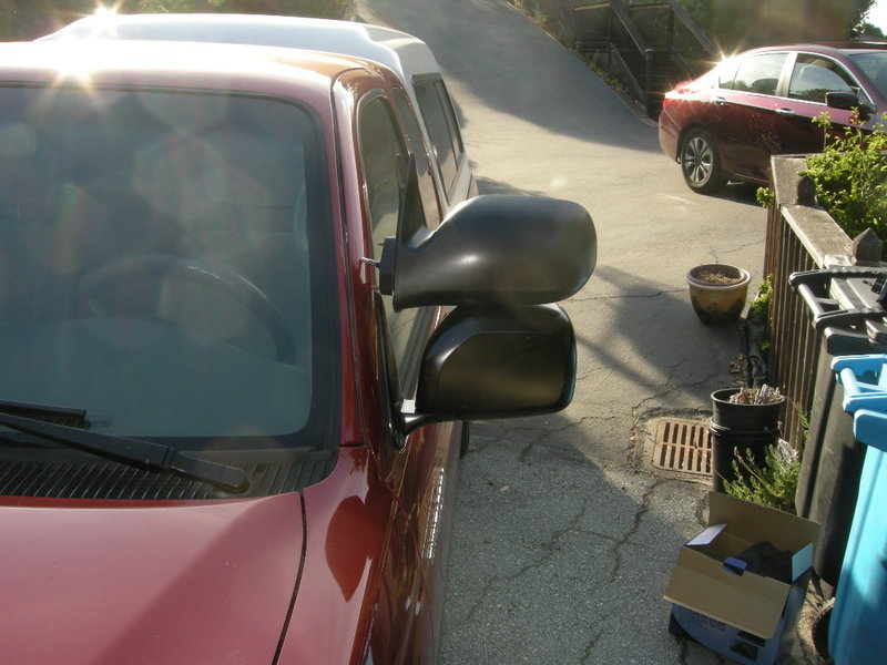

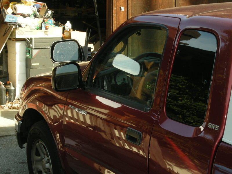

    I just installed a set of these on my 2003 2wd extended cab Tacoma after purchasing them on E-bay. The quality, price, and fit are very good. My original sized mirrors with the manual adjustment lever were too small. Even though the mounting enclosure is about the same size, the new mirrors give you a lot more area. Plus they fold in when needed! Now I have to plug the hole for the adjustment lever.
    Old stock mirror on top. New 4x4 mirror on the bottom
    Same but from the back. Yeah I know the garage needs cleaning.
