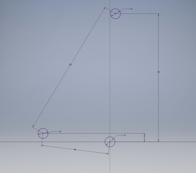

    I plan on measuring the spacing of the 3 bolts used to mount the mirrors on the off chance Hilux mirrors are compatible. I found these, but am unsure if they'll work:
    https://www.clearviewaccessories.com.au/product/toyota-hilux-2005-to-2015/
    @asgardengineering was kind enough to take measurements of his Hilux's bolt spacing, so all I have to do is find the time to do the same.

    I'd like to revisit this idea. From what I can tell, bolt spacing on my 2015's side view mirrors is identical to the Hilux bolt spacing sketch above. Of course, there are a couple other considerations that will likely make modding necessary.

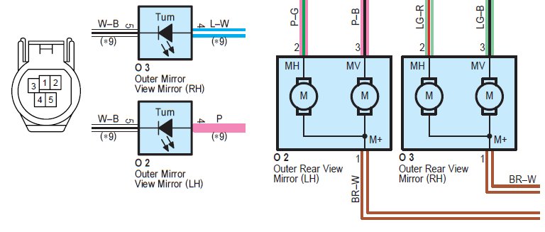

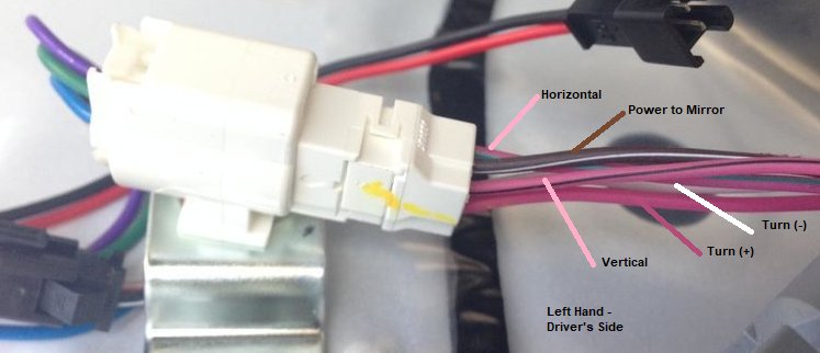

    @caribe makaira, do you have any insight on the wiring and the connectors used for the Hilux? I found the following picture of the Hilux connector. There are only 3 wires on this model due to lack of turn signal indicator:

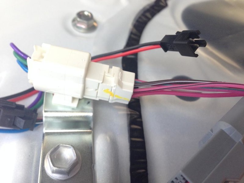

    As compared to the 2nd gen Tacoma connector (in white). Turn signal indicators are equipped, hence 4 wires are present. The left "female" portion goes to the mirror:
    The other factor is trim mismatch, which will be hard to figure out without the mirrors in hand. I'm open to any suggestions folks may have about filling in gaps.

    No specific info of a Hilux, but those 3 wires are for the remote mirror adjustment input. (UP & Down, Left & Right, Fused Power)

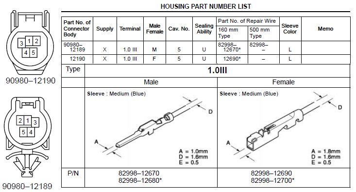

    Understood, thank you for the information. Do you know what connector is used for the Tacoma mirror? I'd rather not cut my existing mirror wiring up to convert the Hilux mirror, since Sport mirrors with turn signals are fairly sought after.

    That connector is from your truck?

    It is not. I found a picture of that connector from a thread on here. It's off a 2013 Sport, which should be identical to the connector used on my 2015 Sport.

    I don't work with "should"...o_O:D

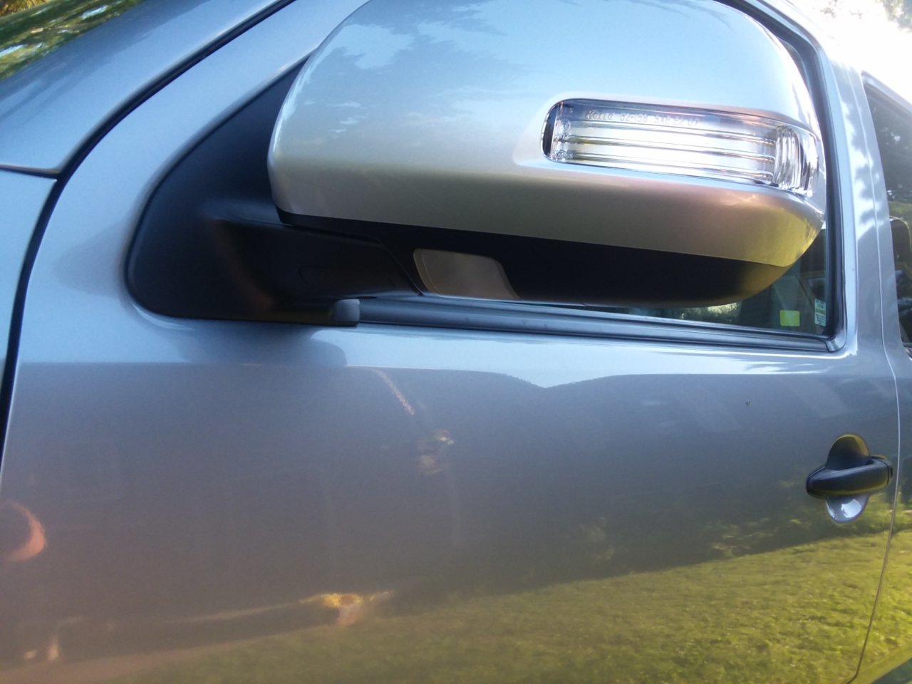

    I respect all your research-I didn't even know about the Hilux option. I went with 2013 4runner mirrors (because I wanted puddle heat and turn.) It was a bit of work, but it wasn't hard. The 2015 pillars are a match for the 4runner mirrors. 3 bolts. Had to cut off the plug and feed the wires. The plug on my truck was hot. this gave me the turn signals and the articulation. I ran wires for the puddle and heat. Heat was the most challenging to do because I wanted a timer. It was a lot of wiring, but if all you want is articulation and turn signals it should be an afternoon gig. Some where on here I posted my mod with the mirrors. Good luck!
