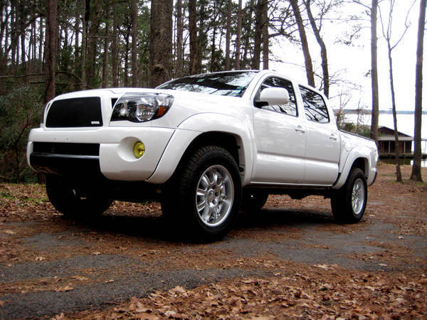

    I went the cheap route. I bought chrome mirror covers on ebay, sanded the sheen off the chrome, sprayed with adhesion promoter, and then with superhite paint I got from spraycansunlimited on ebay. Turned out perfect and only cost $35 bucks.
    I wasn't sure if the paint would stick well to the plastic on the mirrors. That's why I went the cover route. Figured if I screwed it up, no big deal, I'll just take them off.
