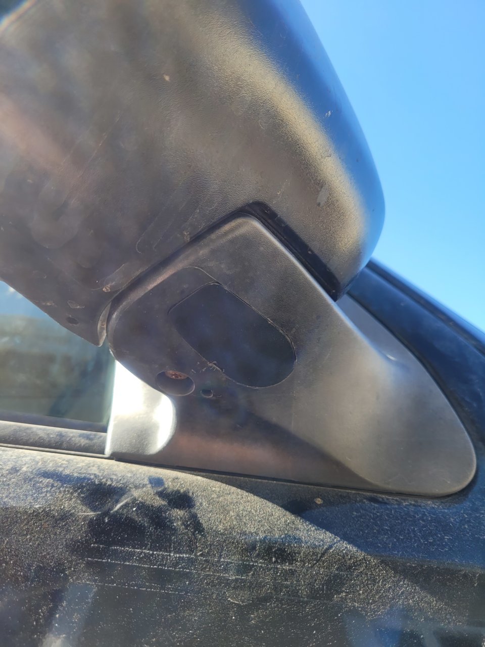

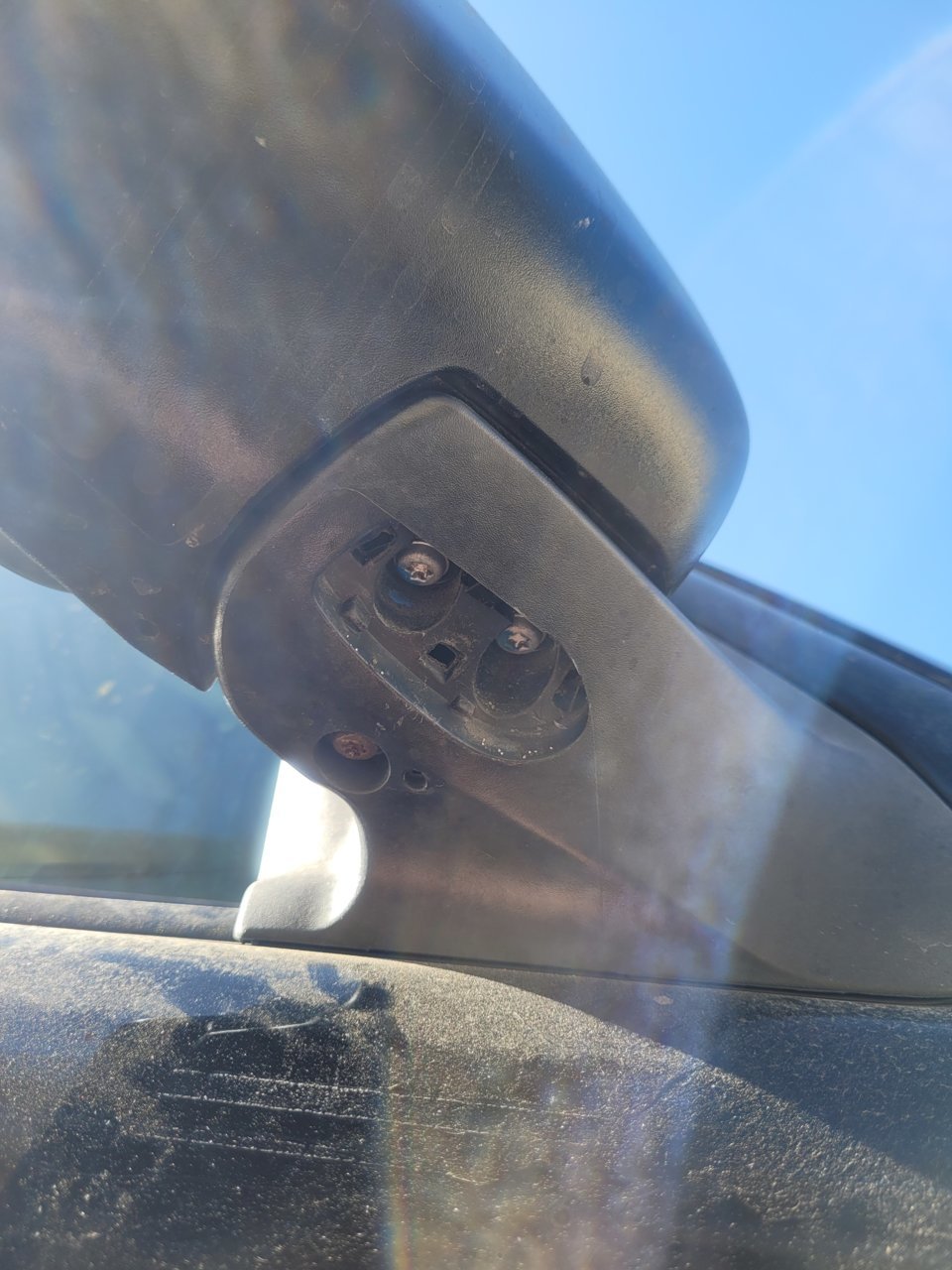

    I got tired of my driverside side mirror rattling. Found a cover to tighten the loose screws holding the mirror housing. Need a torque bit t-25. Manual mirrors, not powered.

    Get some vibra-tite and put it on them so they don't work loose again.
