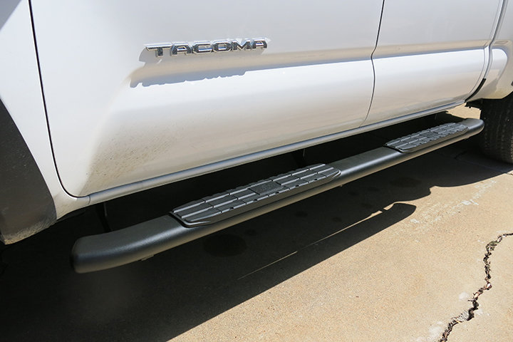

    First, side steps are not sliders (more often called "rock sliders" or "sliders" instead of "runners"). Sliders are heavy and are bolted or welded to the frame. Steps are lightweight and not as secured. Steps crush, sliders do not.
    Weight matters, as bed racks to support RTT (rooftop tents) or front/read bumpers that support recovery or winches, or belly armor (engine skids, transmission skids, catalytic converter covers, transfer case covers) ... these are steel and add hundreds of pounds.
    Sliders often do not push out far enough to make good steps.
    Toyota makes Predator steps that are not popular for off-roading (thin-walled aluminum pipe) but are lightweight and make decent steps.
    Others will chime in with a long list of expensive options that make a difference, beyond the short list I already provided that "add weight".
    For reference ... these are "sliders" which are not good steps (I lifted this picture from another TW member for your benefit ... so sue me) ...

    I'm very happy with my Steelcraft 4" ovals. Just the right distance from the truck body and low enough to be very useful as a step. Welded ends instead of plastic caps. Far better than the round OEM steps that were too high and too close to the truck body to be useful.

    I like the round ovals. Mine are OEM.

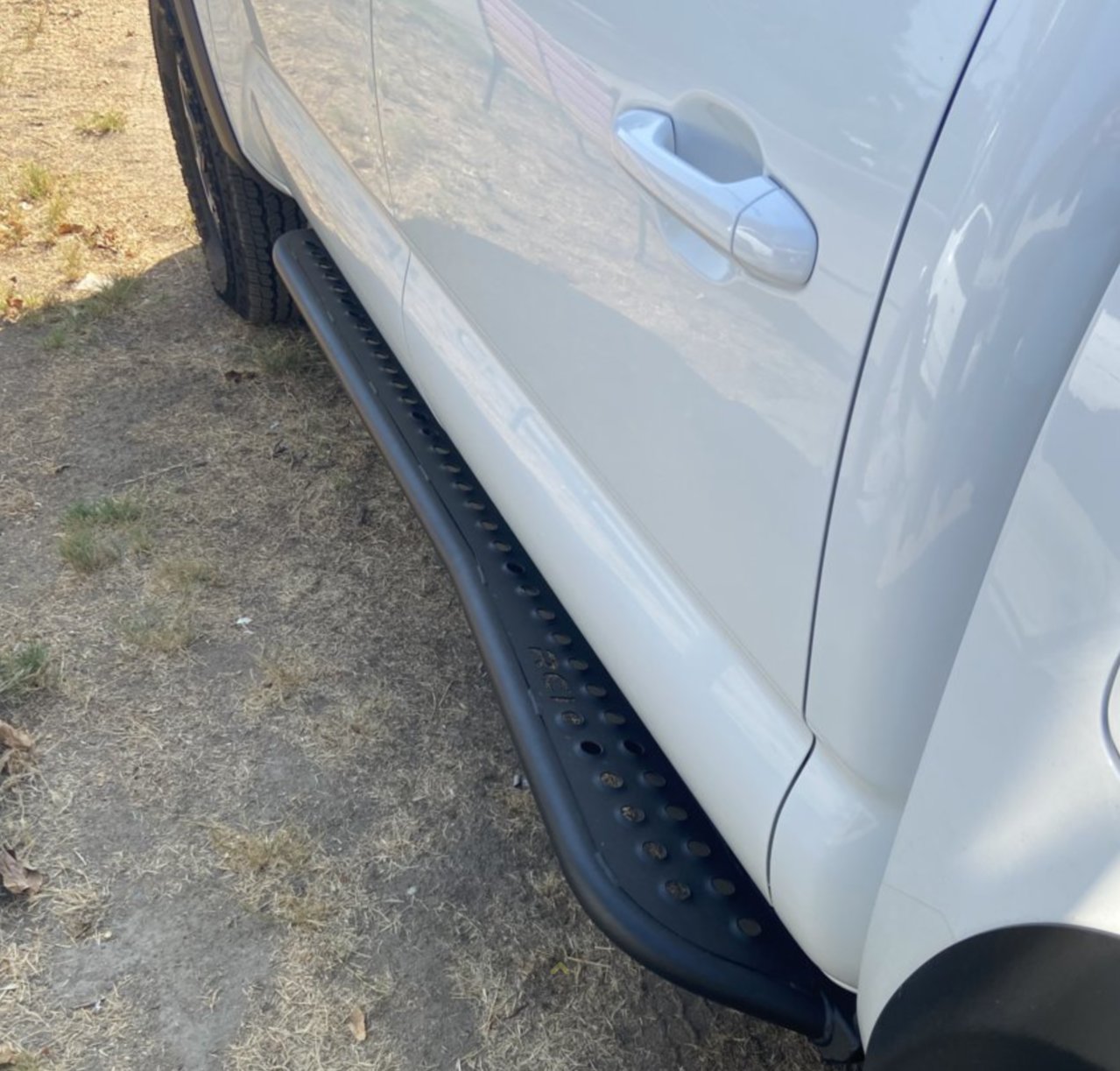

    I had a set of go rhino dominator d6 that i took off my previous truck and installed on my 22 taco. Look good, slider look,very sturdy. My wife is short so it works good as a step for her and does a good job of protecting the sides of the truck. Going to eventually put a roof rack on for hauling long stuff, so they will also work great for reaching across roof to tie down. Oops, just saw O.P's new reply that he decided and got the steps!
