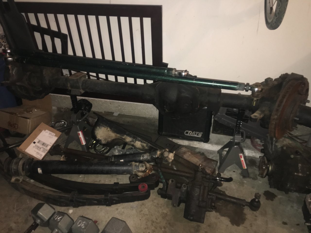

    Getting closer to the solid axle swap a couple of pics of the pile of parts have in the garage,,,
    37”s Kevlar
    17”pro comp wheels
    Dana 44 5.38 (from a wagoneer)
    Warn manual hub lock
    High steer
    Transfer case
    T100 oil pan
    44044 leaf springs
    4runner steering box
    Etc. I will post more information of all the parts that are going in the sas and 4wd conversion

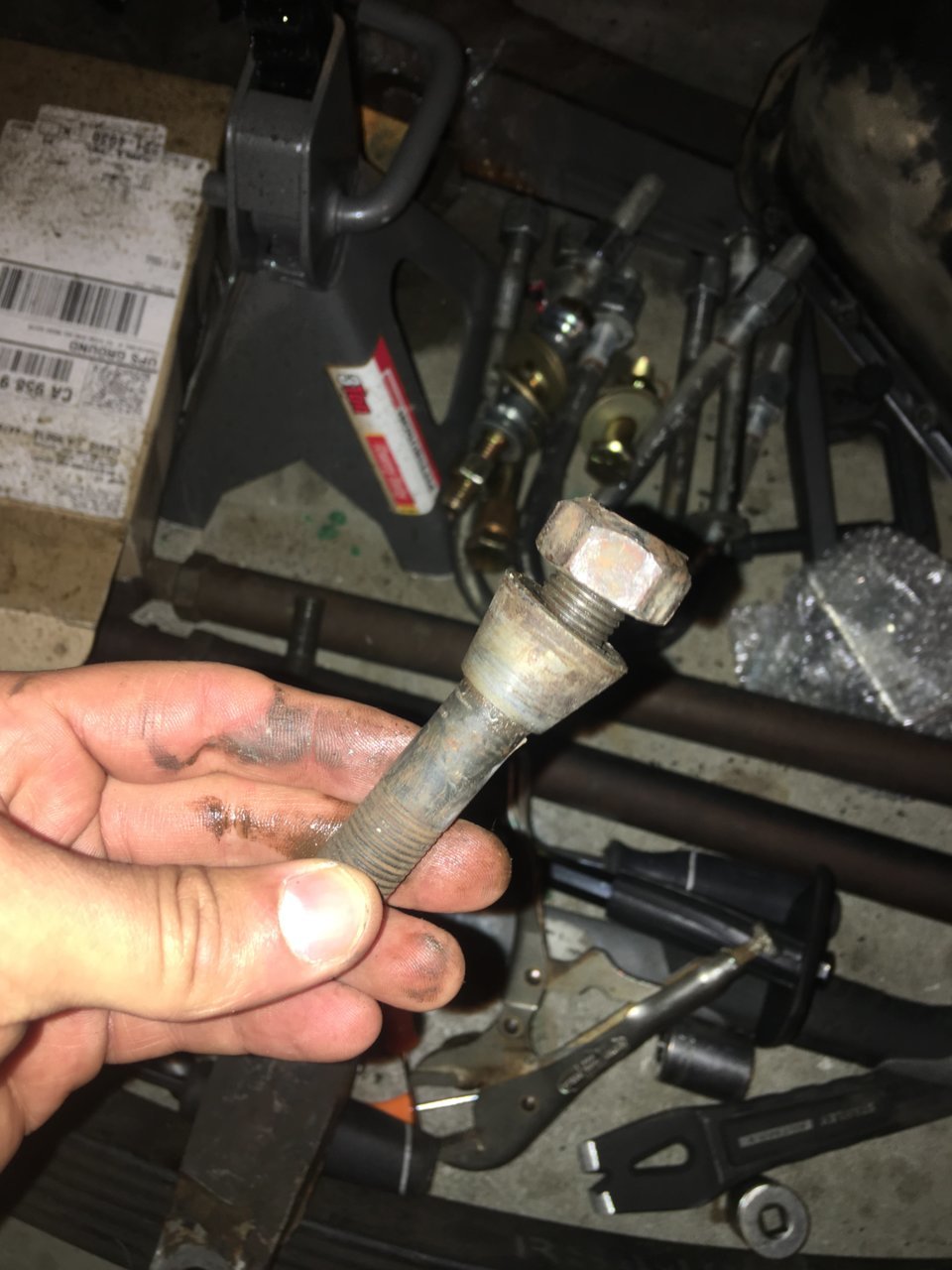

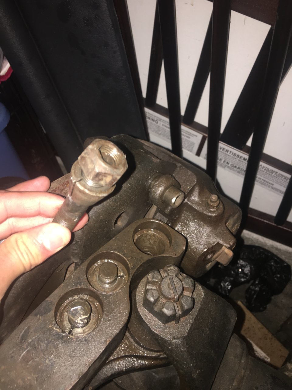

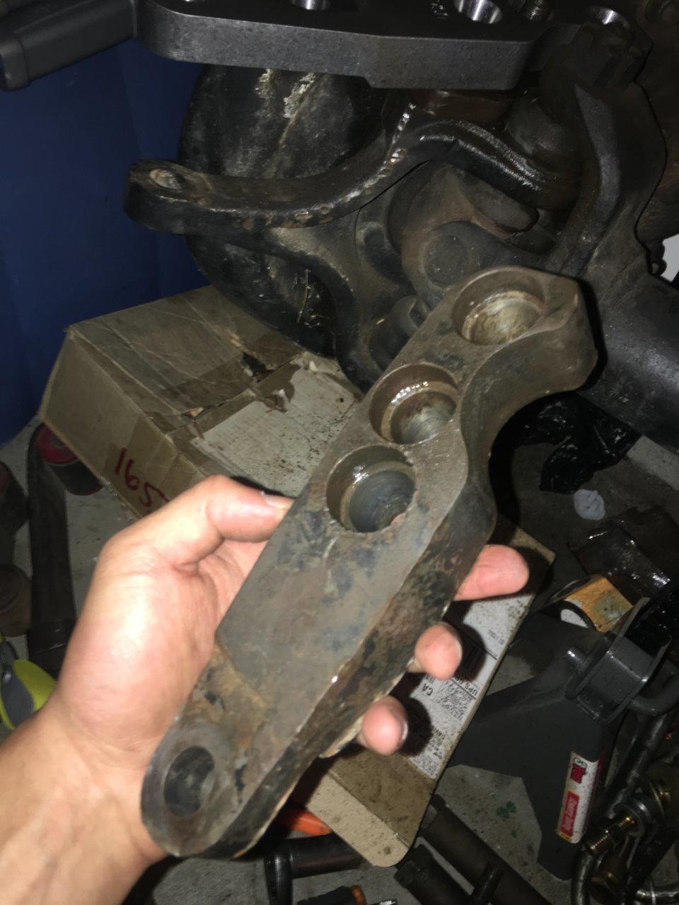

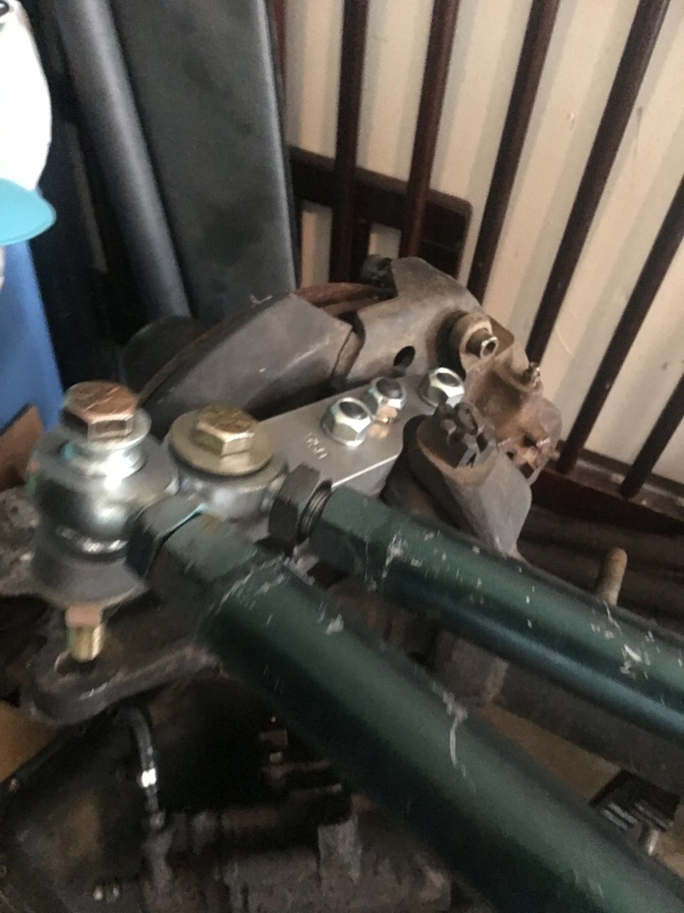

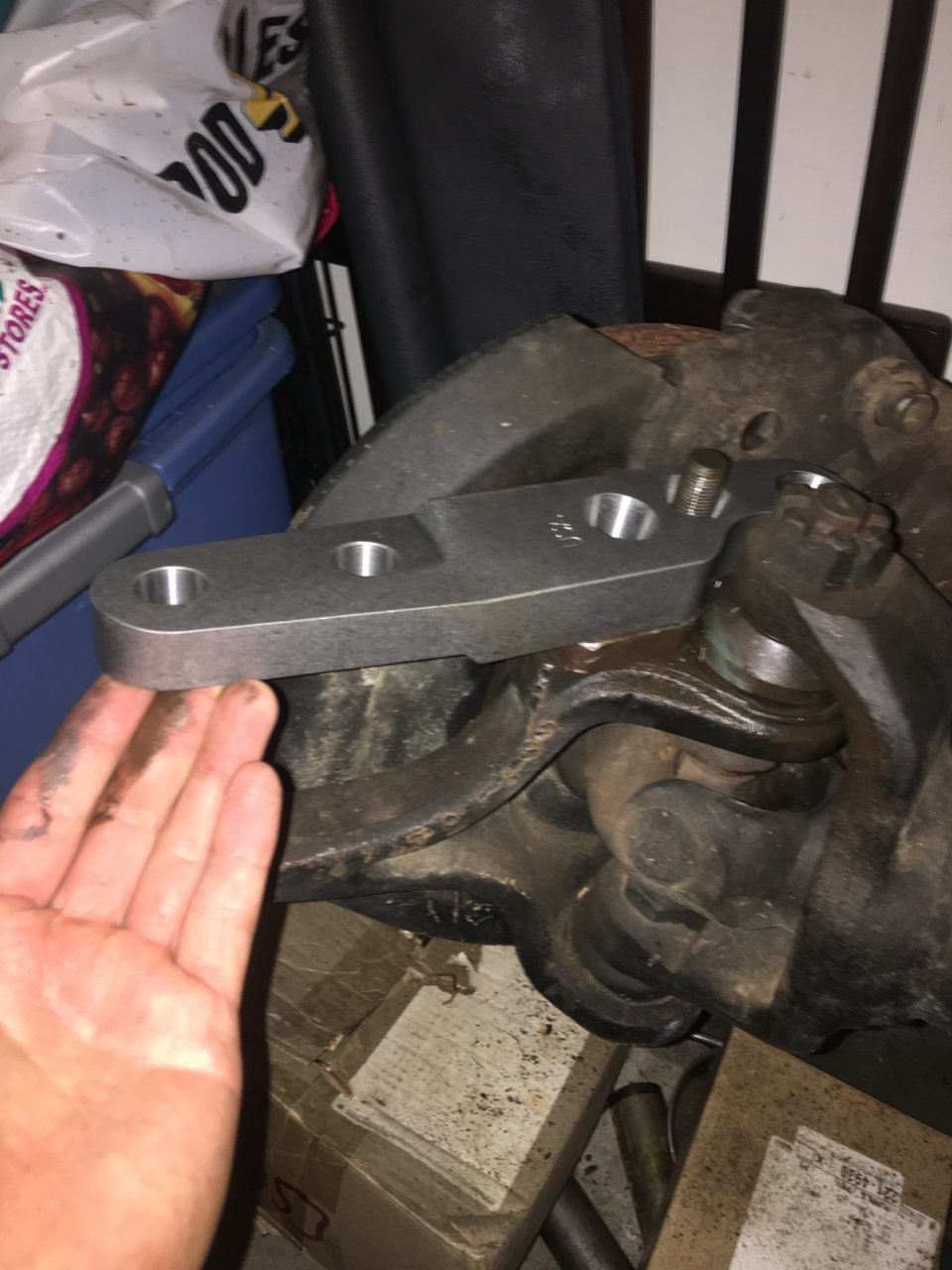

    Starting to set up the axle,, I changed the passenger arm with a two whole arm for the high steer links,, it was such a Bitch to remove the old arm, those cone washers are no joke I hammered the shit out of the arm to loosen the washers and finely popped off luckily I’m replacing the studs and nuts cause they are done haha

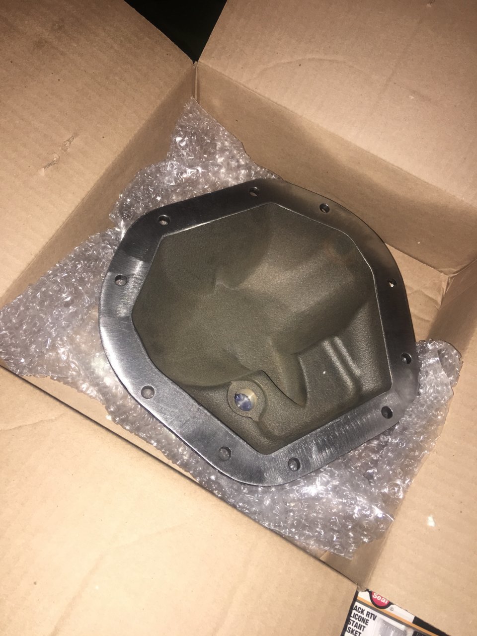

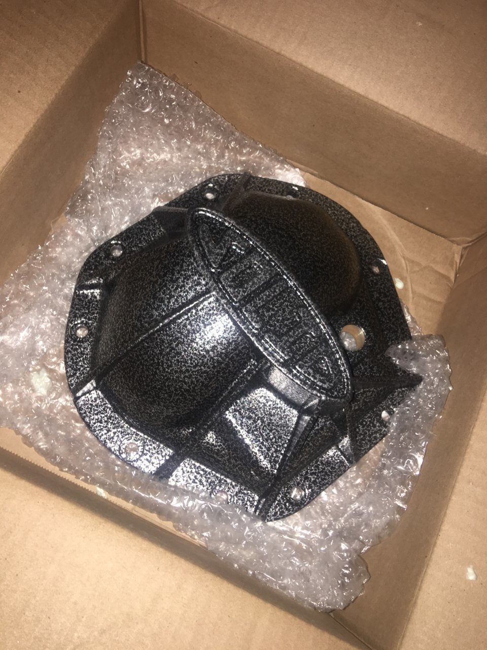

    New diff cover for the Dana 44 since the stock ones are weak ,, solid is pretty solid with diffs haha

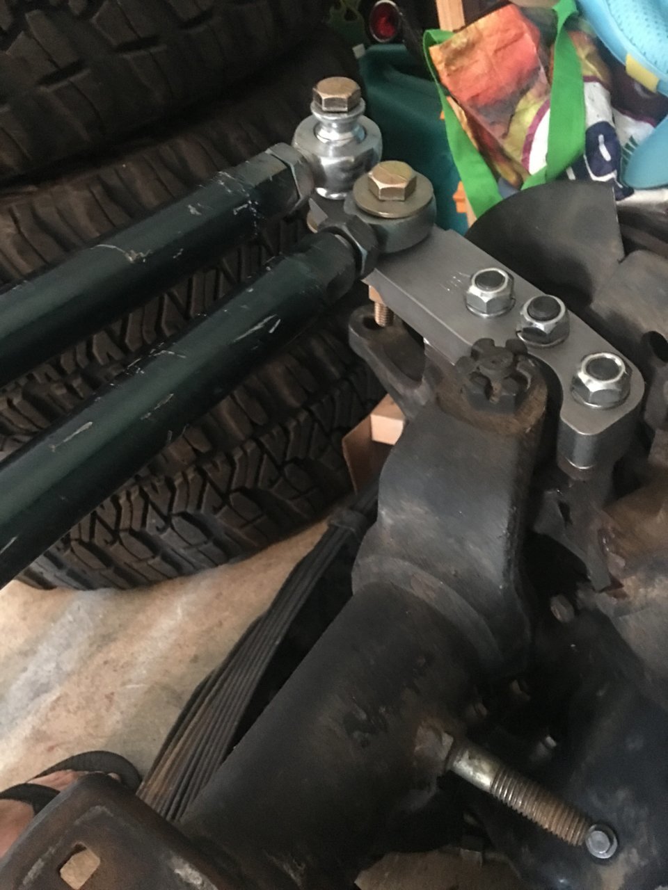

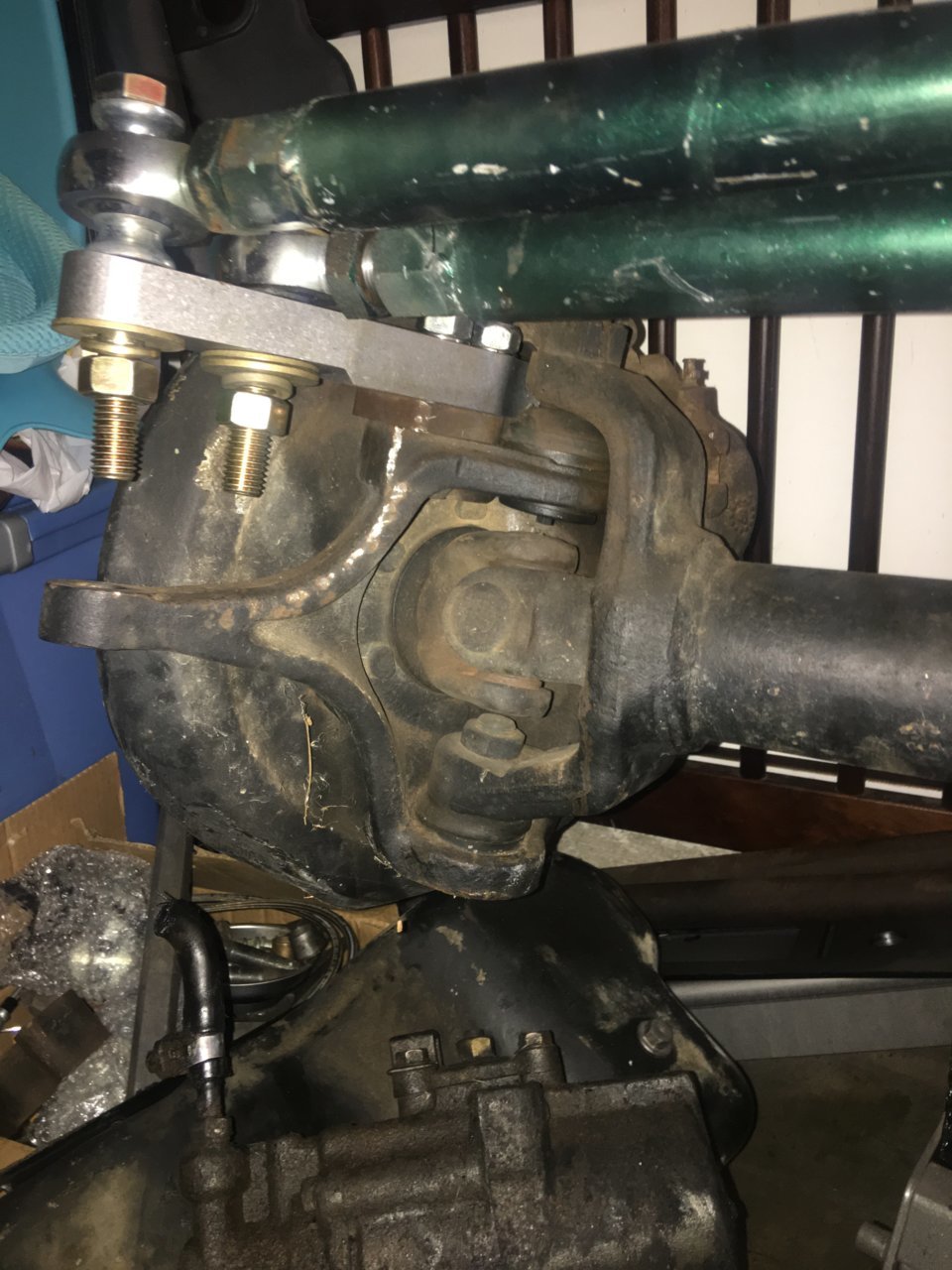

    Starting to set up the tie rods for the high steer fits perfect with the two hole arm just have to wait until the axle is under the Tacoma to really see if it’s long enough for the steering box

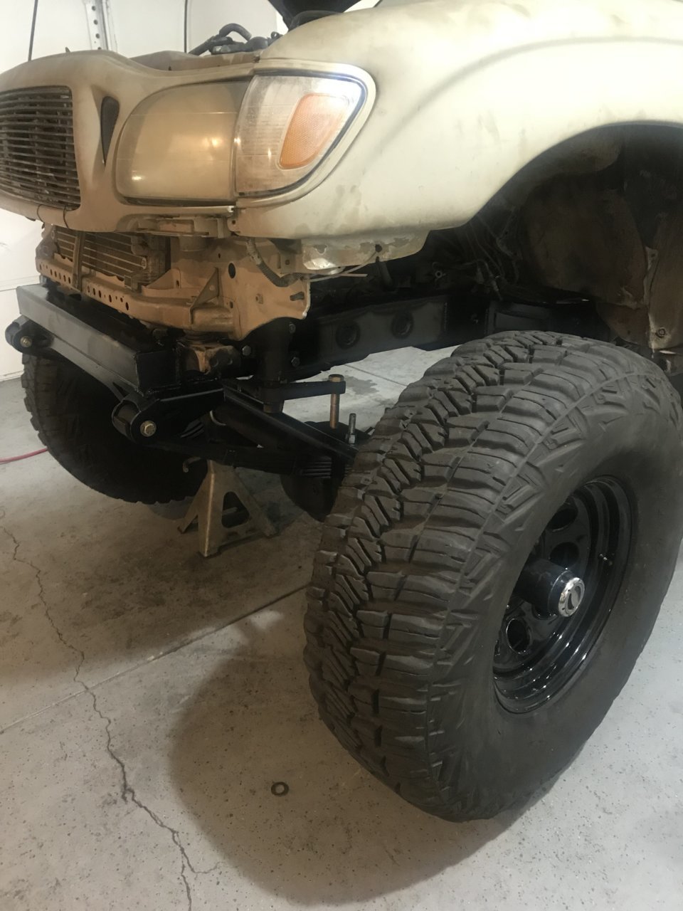

    How she sits today

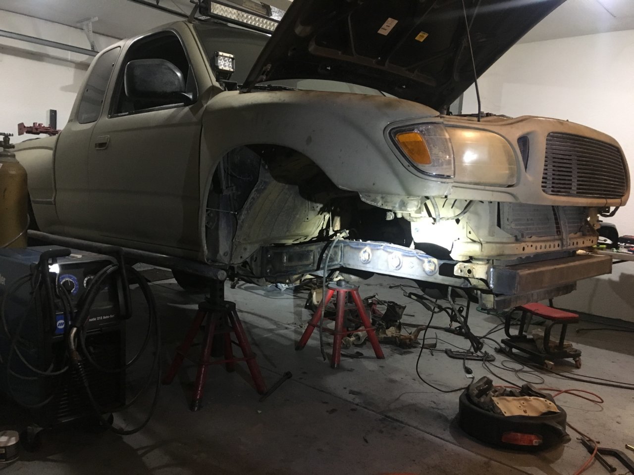

    How she sits today should finish the swap in a couple of weeks

    Standing on all 4 tires !!! Getting closer to finishing!!!!

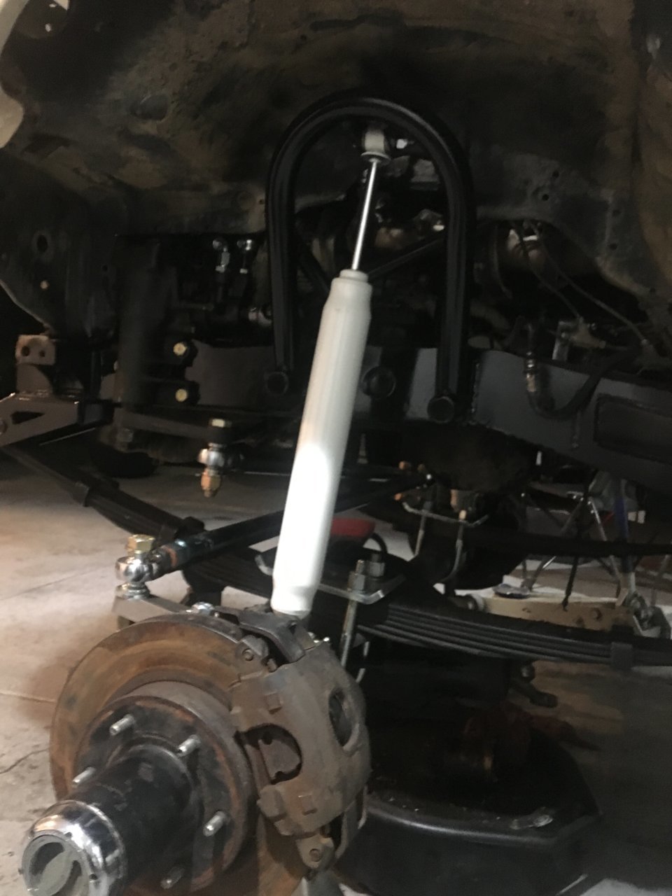

    4wd tranny is in,, steering and shocks are set up for the front,, just need to re-gear the rear and add longer shackles and relocate the shocks and getting longer shocks 12”

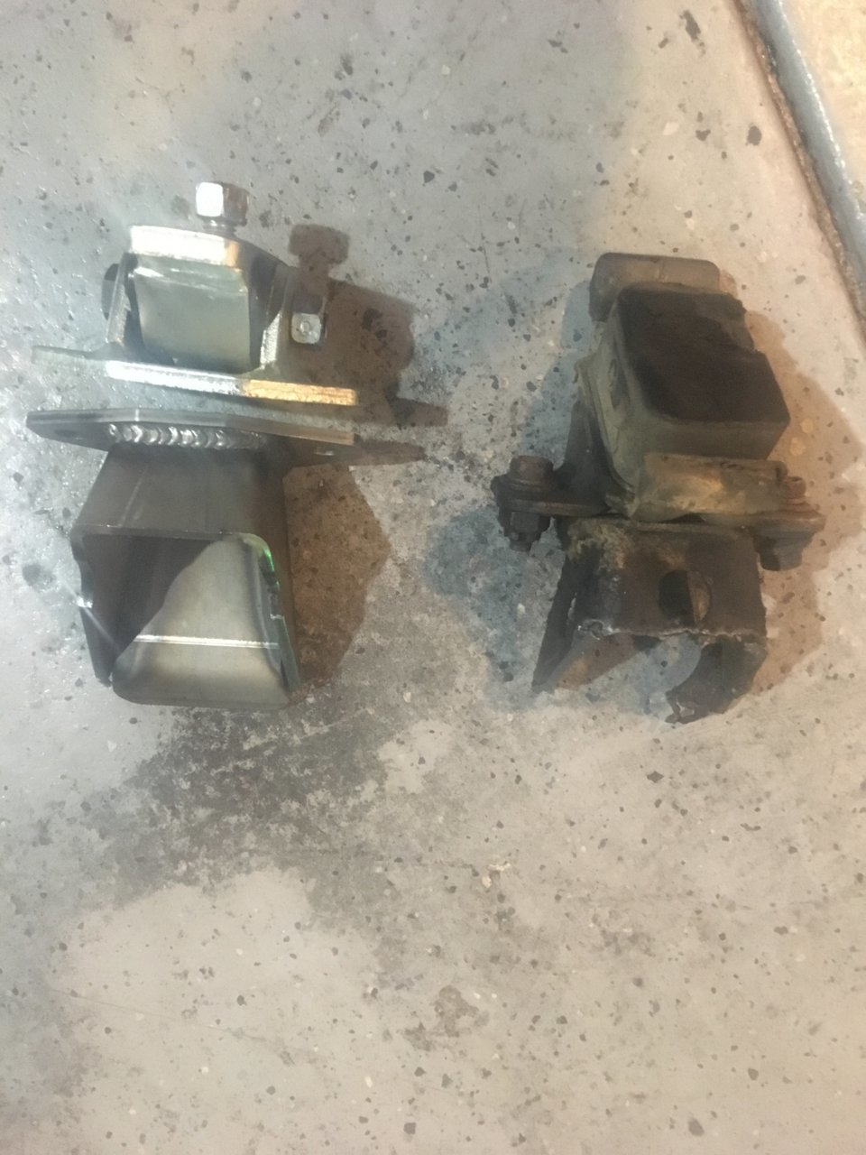

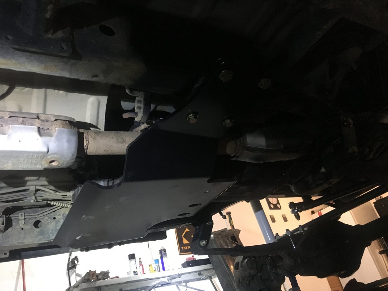

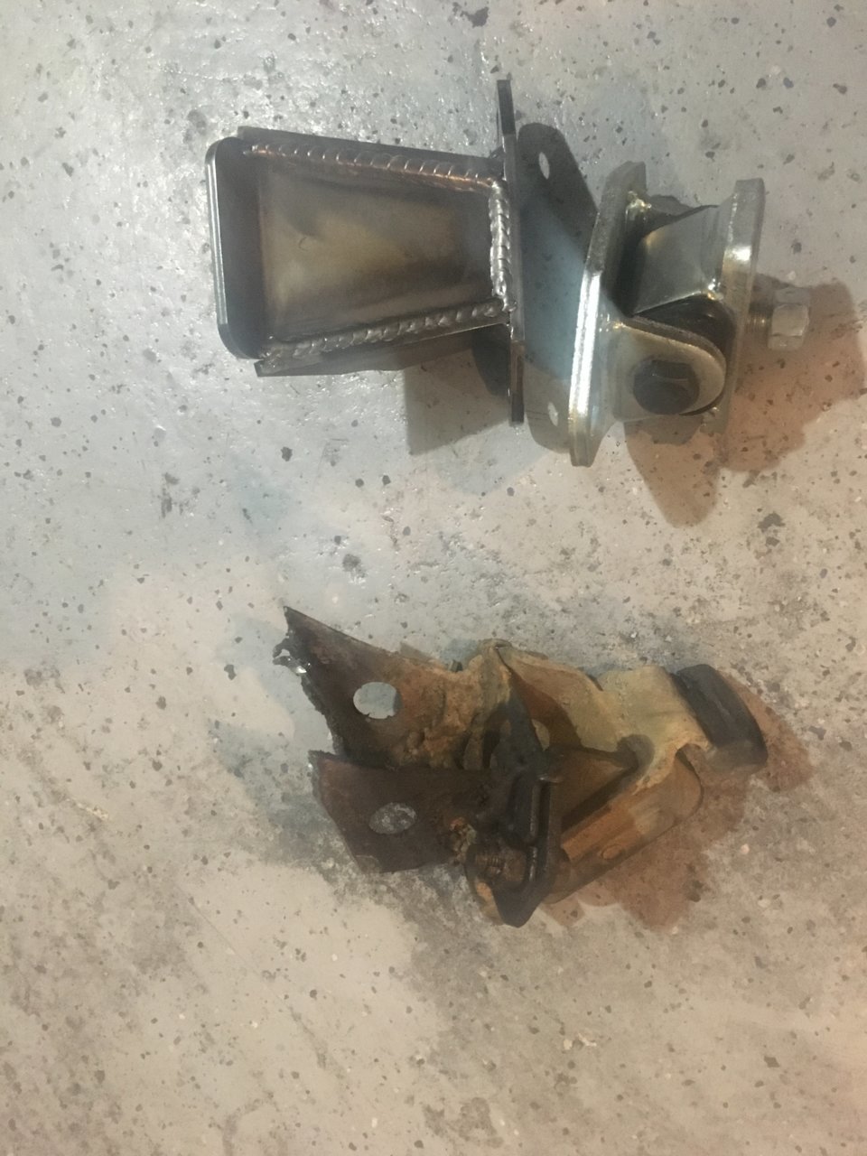

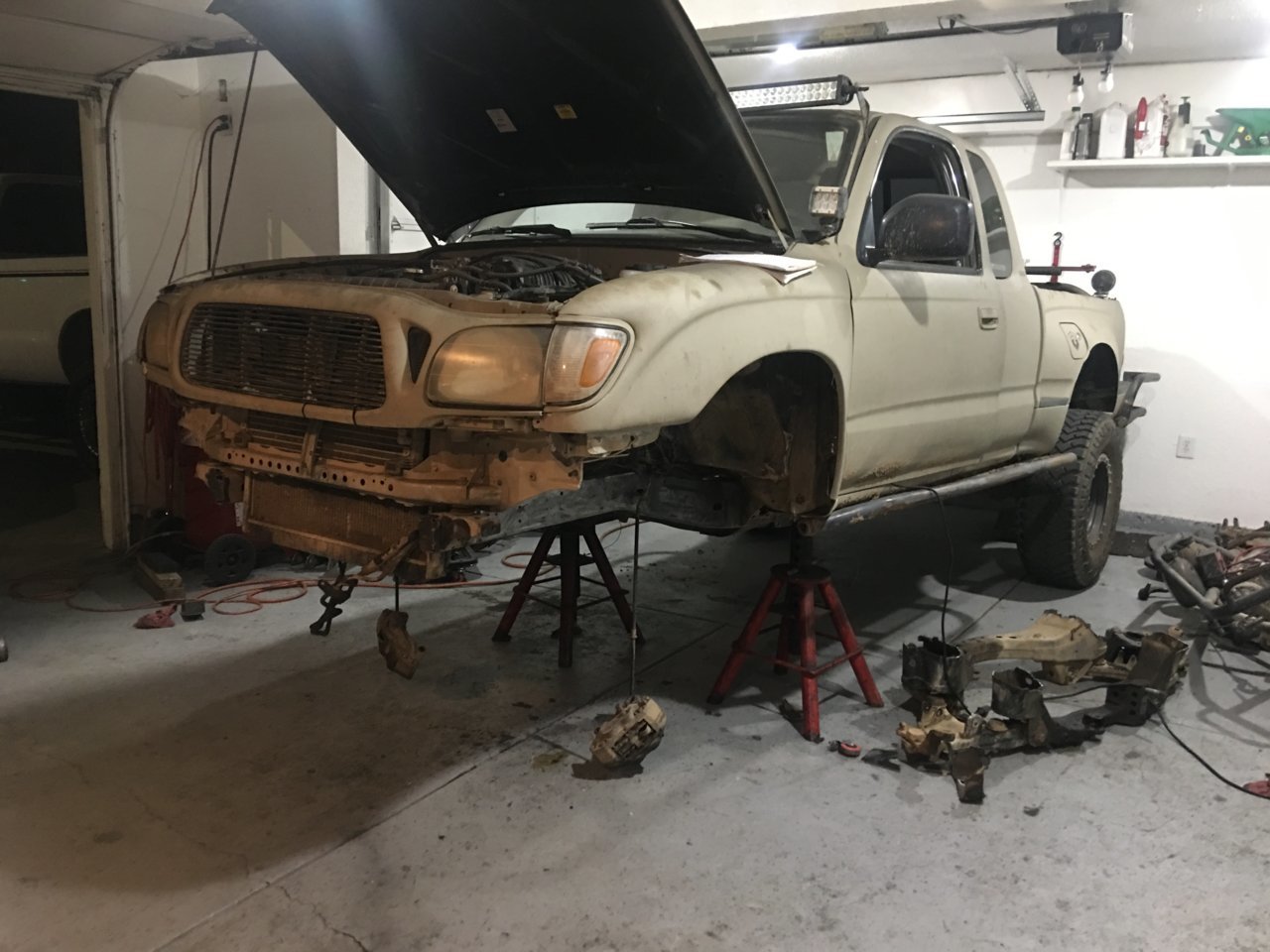

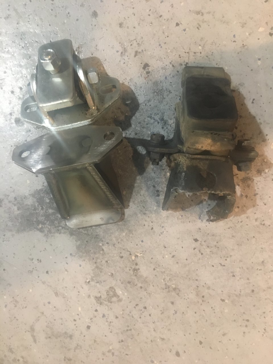

    Out with the old motor mounts and motor mount perch,,, the stock perch were really bad bent and cracked
    Went with trail gear motor mounts and
    DMZ motor mount perch
