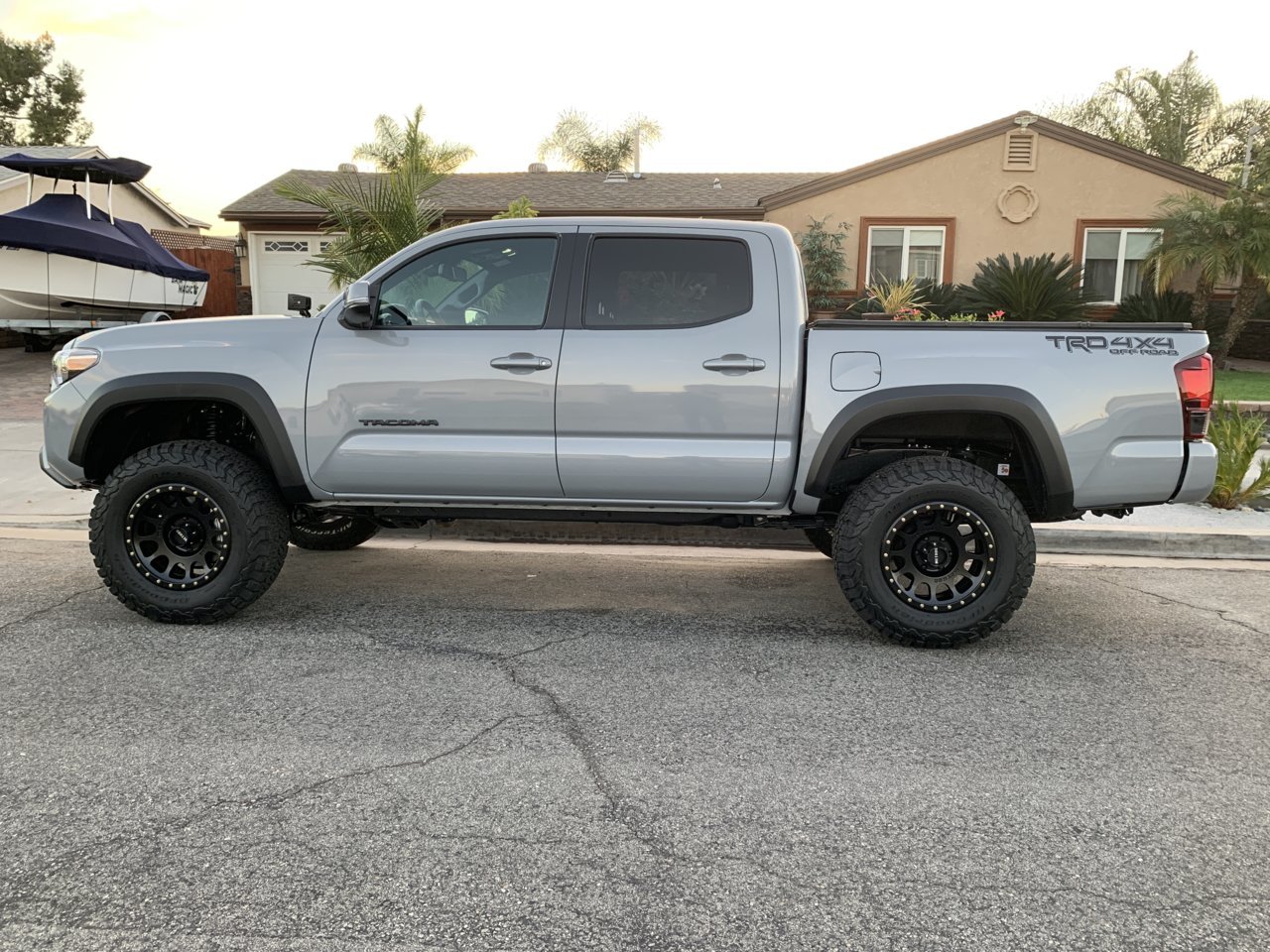

    I love that look. But what made you choose the 888 over the 887? Planning on adding some weight up front sometime?

    885, 887, 888 are all the same spring rate, just longer springs. The 886 is higher spring rate used for bumpers and extra weight.

    Because I really wanted to avoid too much rake especially after settling and yes I might add a winch at some point but that's another story because i might have a different suspension setup by then.

    Noted. Sorry, I thought the 888 was similar to the 886. What's your settled lift up front with the 888's?

    oh, no not at all from what I researched. 888's are not for added weight just taller than 887's. I would do a winch with 888's but If I ever got a winch and bumper then I'd do 886's.
    Not too sure since I haven't measured but it's been over 2-3K miles now with this setup and I can definitely notice the settling. I'd say 1/4" or so? maybe closer to 1/2" which i'm completely fine with.
