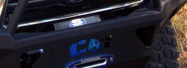

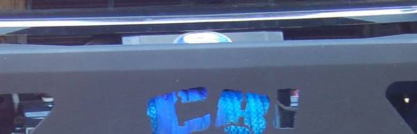

    Not sure if this pic is good enough. It doesn't really show how it tucks behind the bottom of the grille.
    Maybe this is better?

    Well I wont have the bumper on for a couple of weeks so I will have to take eric's advice on this one.
    So basically that just means I need to get a non i model right? like a 9.5

    I believe so. That Talon definitely wouldn't fit in mine. I can't even get my index finger between the solenoid and a rib on the bottom of the grill.

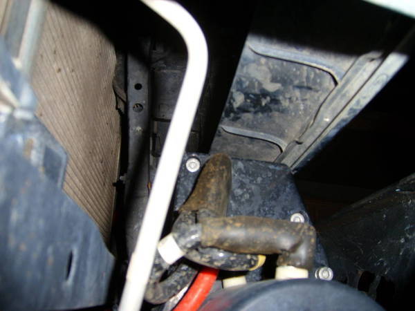

    Kind of late but these might also be useful to singlefin
    You can see where I had to notch the bottom of the grill and also how close it is and why I can't say if it will work with others bumpers. If the mounting plate were forward a half inch it would eat the grill. Heck, I can't even be sure if it would work with all CBI's bumpers, I don't know the tolerances they are made to.
