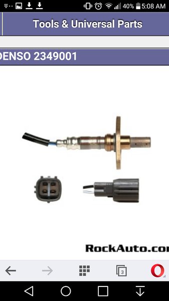

    So annoying. I was hoping I got the right one. Because everything I read says to get the denso 234-9001
    Got on Amazon. here
    This style:

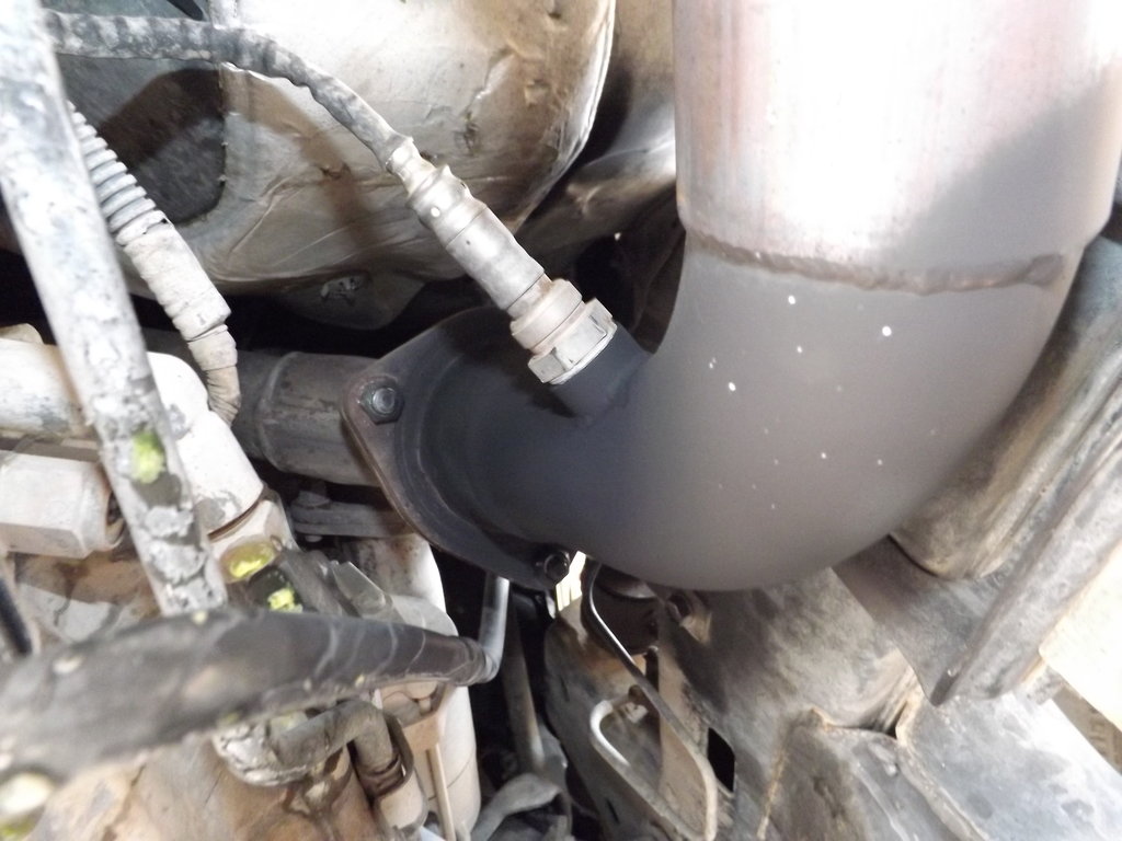

    But this is the sensor I have up front.

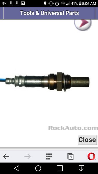

    Which looks like either a Bosch or delphi, comparing it to pics of the other ones on Rockauto:
    I was hoping that this sensor could simply be unscrewed from the mounting plate, as i saw one on Rockauto that has that option, but this new one can not. It's all one piece..
    So.. Is it possible that the previous owner had it modified to accept the different type? Or did some Toyota's come with these different brands? And what am I to do? Should I just get a brand that will fit? Or modify the exhaust to accept the correct denso one if that's what it calls for??? Annoying because I had a new exhaust installed and I assume they had to weld on that fitting to accept the sensor that's in there now. I feel like I should get it redone to accept the denso because all I've ever heard is "denso denso denso!!!".

    Think its different between one cat and dual cat exhaust systems

    I am betting some one changed that Does yours have the California Emission Package.
    You can see the weld on the pipe
    The Truck I am working on is a 2002 3.4 California Emissions it has the Denso type flanged sensor

    No parts found on densos site. But I did find it on Bosch and it says that one I listed above is the one.. But yeah it was a dual cat Cali spec setup. It had the same sensor flanges on the stock exhaust. But I couldn't tell you if the stock exhaust looked like it was modified for that sensor or not. I had a whole new system installed so they just put the same fitting/flange on the new. The rear sensor does have the plate flange. Just the front is different.
