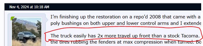

    The truck easily has 2x more travel up front than a stock Tacoma. It’s ridiculous how much travel it has, especially up travel. I took it through a frame twister to test it and didn’t see any signs of anything critical hitting, just the tires rubbing the fenders at max compression when turned. Body mounts are chopped and clear fine.
    Am I missing something? I feel like more people would talk about drop bracket lifts if they gave this much travel. I looked up the BDS 6” lift that comes with the Fox coilovers and the bump stops look smaller than the ones I fabbed up. Am I going to wreck a CV or tie rod end or something? Or is this just an unspoken advantage of a drop bracket lift?

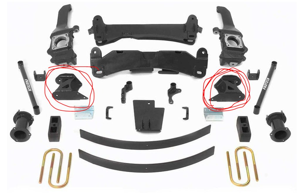

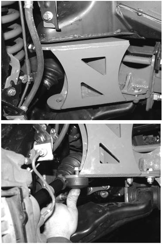

    A drop bracket lowers the lower control arm mounts and leaves the uppers in the stock location. It manages this by using longer spindles (ie steering knuckles), thereby increasing the distance between upper and lower control arms. This adds 6” to the gap between lower control arm and bump stop.
    Without any further modification, this would allow an additional 6” of up travel at the bump stop, and even more at the wheel, barring some sort of mechanical interference like control arms hitting something else.

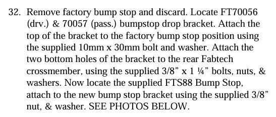

    Fabtech has bump stops built into their coilovers, eliminating the need for traditional bump stops. Fox does not, and has noticeably more travel. The BDS kit comes with extended bump stops, and now that I look closer, brackets to relocate the bump stops further down. I’m not sure if the bump stop length is set to prevent the coilovers from bottoming out, or if something else maxes out first (like CV’s or TRE’s binding).

    2x the travel would mean you went from approximately 8 inches of travel on OEM stock suspension to 16 inches of travel. 9, maybe even 10 inches of travel are possible with longer travel shock and upper control arm allowing slightly more max angle. But you literally said 2x the travel.

    Does the kit installed on your truck have these?

    It does not. It had worn out Dirt Logic coilovers with primary bump stops built in. I'm guessing the kit on mine never came with extensions, or someone figured they weren't necessary. I'm not sure of the age, but I wouldn't be surprised if it's as old as the truck. Those coilovers were done...like, not even rebuildable anymore.

    The coilovers may have had their own bumpers on them, but they were never designed to work without proper bumpstops on the suspension itself.
