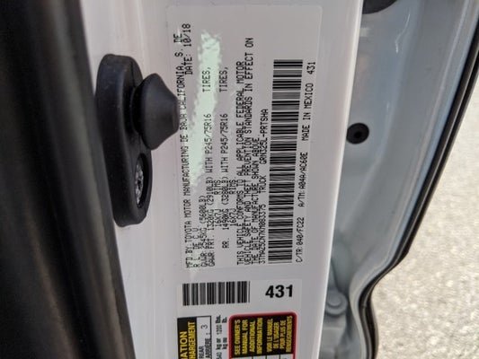

  5. Dec 30, 2019 at 9:19 PM
    #25
    Superdave1.0
    Superdave1.0 Grandma Dave
    Dec 27, 2018
    #277158
    6,240
    SoCal
    LX470, 2025 Civic Si
    Open driver door and the vin label is on the pillar. Top right has the production date.
  6. Dec 30, 2019 at 9:38 PM
    #26
    baldbeardedtaco
    baldbeardedtaco Well-Known Member
    Sep 4, 2018
    #265223
    3,328
    FL
    18 TRD Sport DCSB MGM
    :rofl: So it is 7/18 and I guess it was more of a mid yr fix since my vin doesn’t match the 2 listed on the tsb unless there’s a newer tsb than the one I looked at

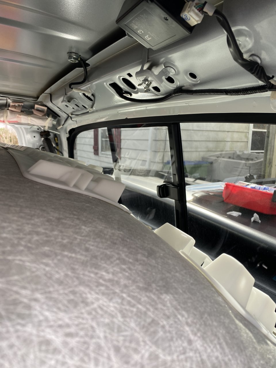

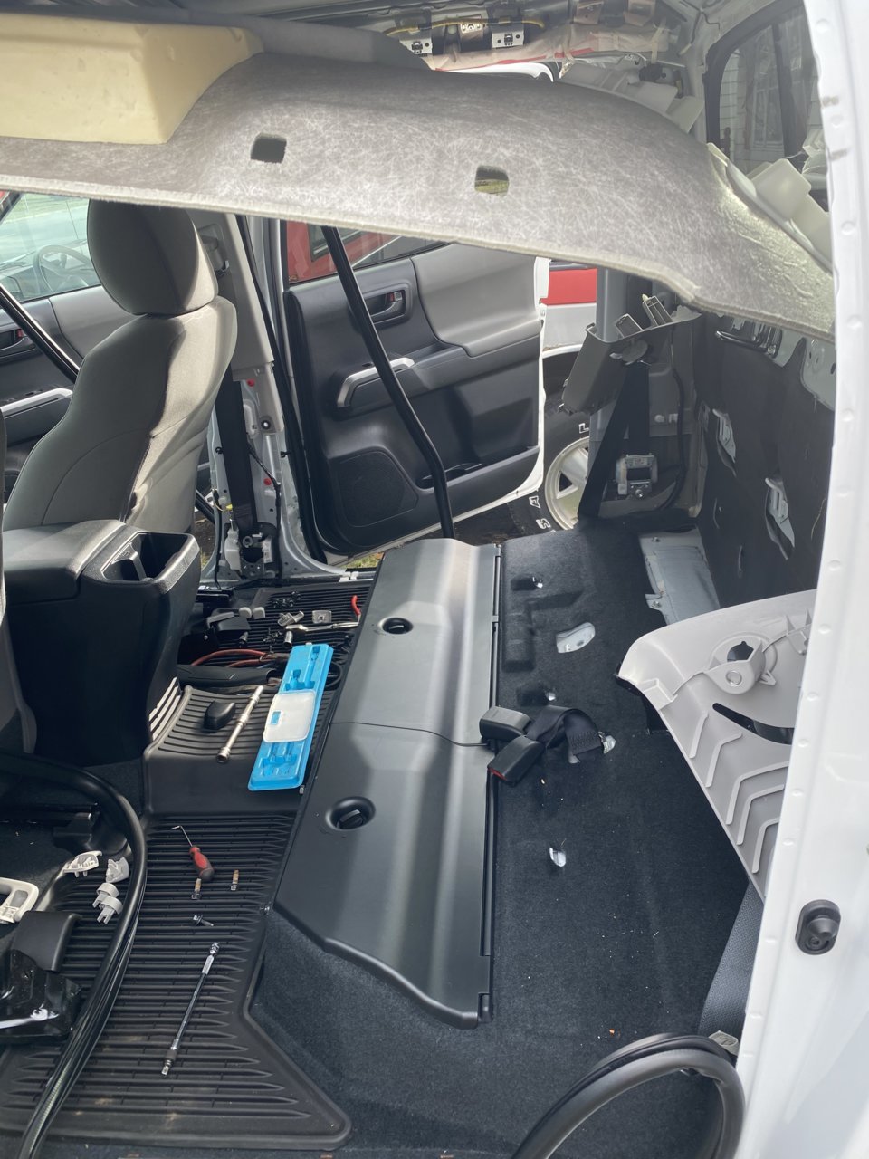

  20. Jan 28, 2020 at 9:15 AM
    #40
    jws6295
    jws6295 [OP] Well-Known Member
    Sep 7, 2019
    #304602
    194
    Central PA
    2016 SR5 double cab long bed
    Yep! I can attach a picture with the part number. And as far as what I did I found a video of a Toyota tech on YouTube doing one and got a rough idea on how it was done. Basically everything in the back comes out, seats, seat backs, storage compartments behind the seats, upper and lower B pillar trims, c pillar trims, weather stripping comes off to let the headliner fall a bit, dome light comes down as well, also rear grab handles come off, and the little hooks in the back holding the headliner up. Overall it’s not bad more of a pain in the ass than anything. Be careful not crease it, I rushed a bit and did crease mine a bit, luckily it’s formed back.
