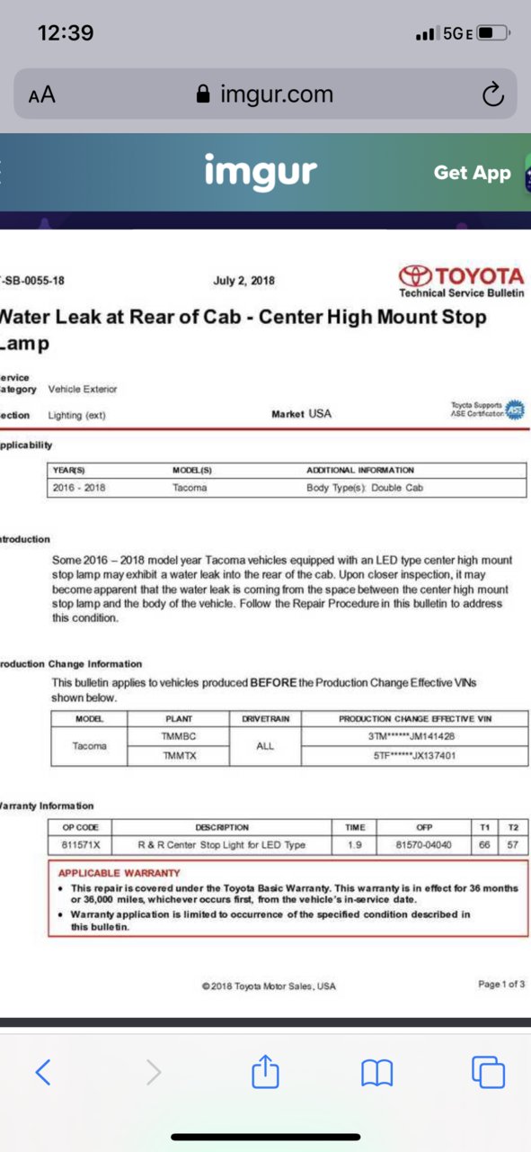

    It's all VINs prior to those numbers, so if yours is < the ending digits, you are affected.

    I’m still confused by how they did the effective vin range. I have the 5tf in the front then ends in jx069715.
    On the tsb it’s
    5tf_____jx137401 so I assumed since the ending vin didn’t match I was good but from what you say my jx06 comes before jx13 so then I actually fall into this tsb- did I read that right? I assumed the front and rear numbers had to match

    The last 6 digit number of the vin is the production number. So I'd say yes, your truck falls under the TSB since it was produced before the 137401 listed. Looks like the asterisks are replacing the shared vin info (but at first glance, it does kind of come across that everything should match and that you'd have different digits/letters filling in the asterisks).
