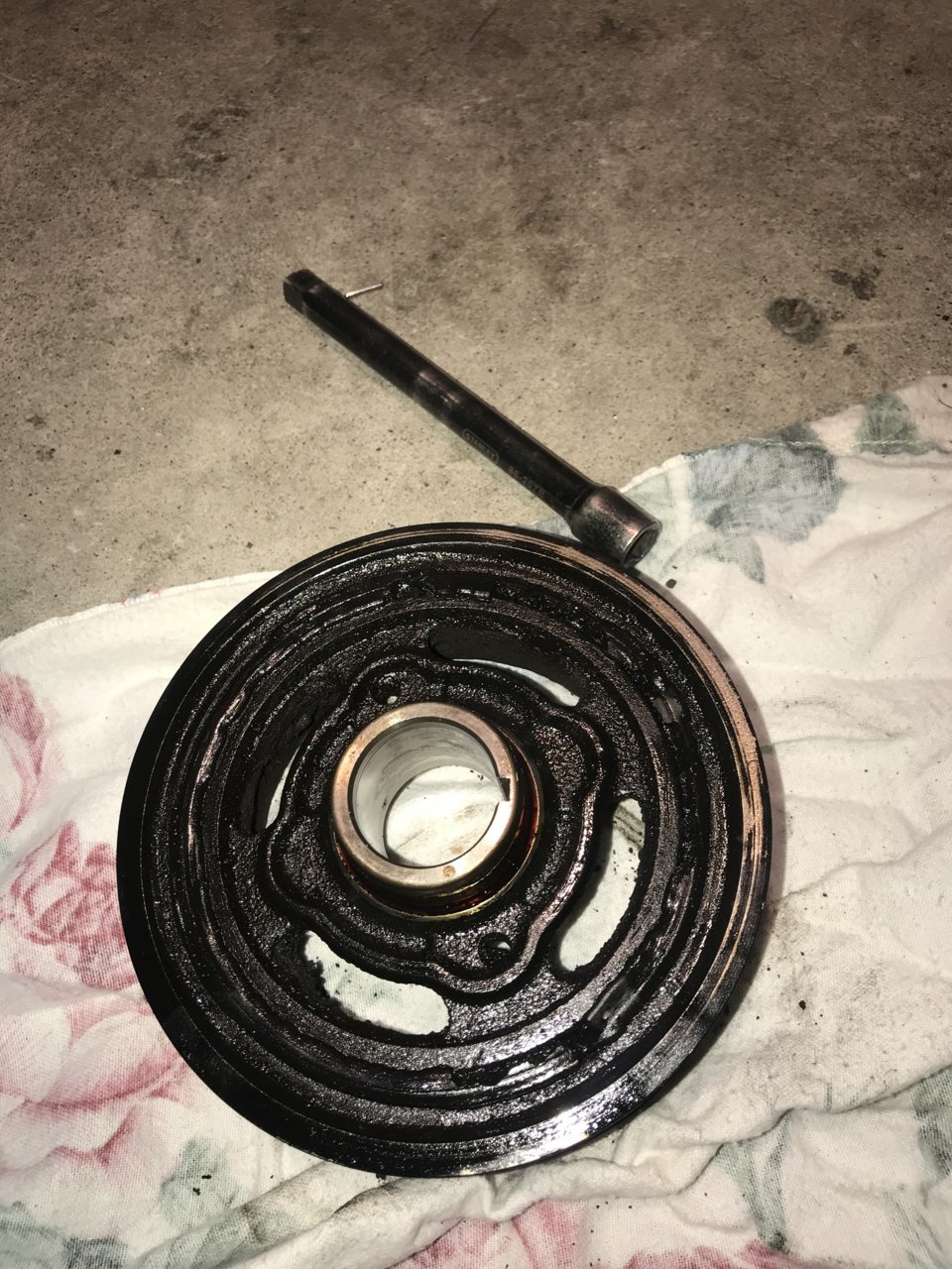

    Houston
    2007 Prerunner & 2008 4Runner
    What's the part number for that balancer?
