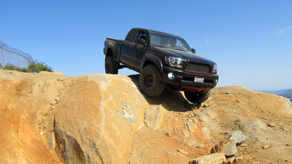

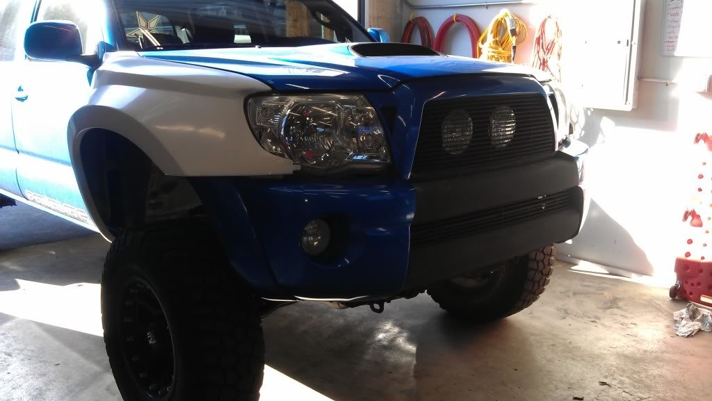

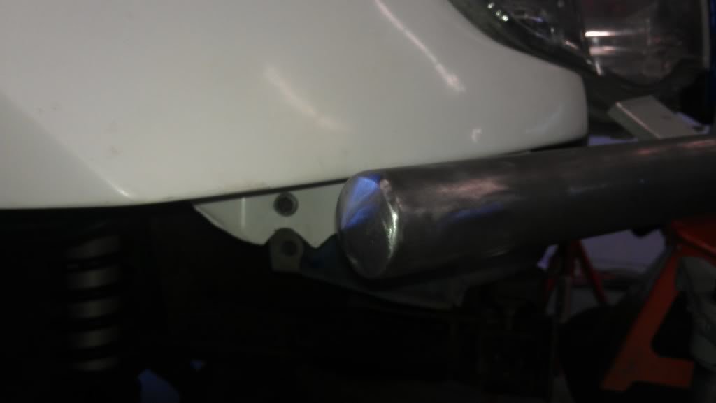

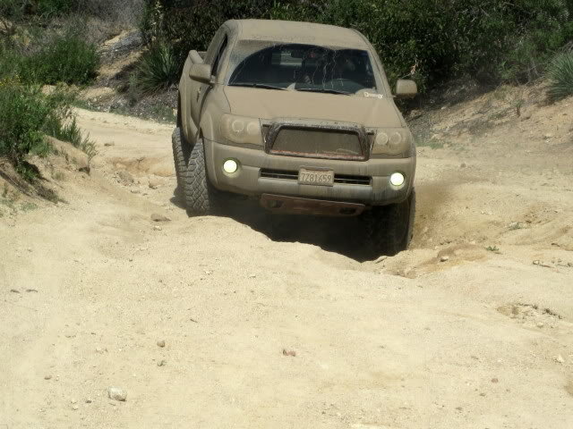

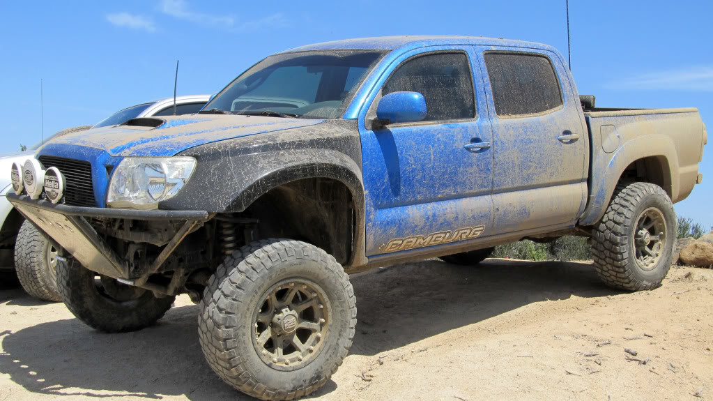

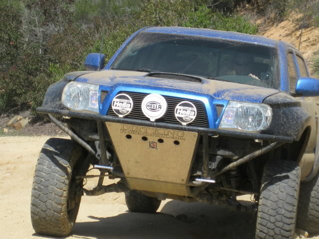

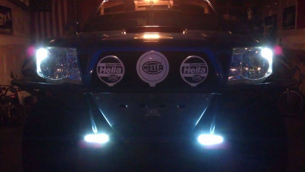

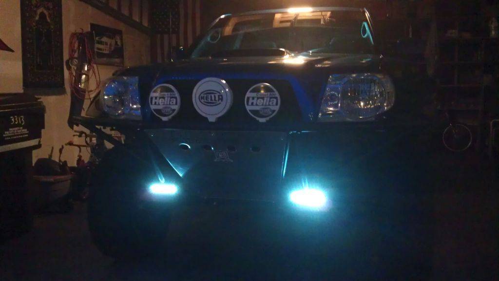

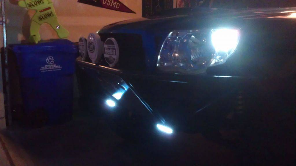

    New Ebay special LED lights. I wanted to have my DTRLs back since I had to remove my Stock bumper for the tube bumper. They are not bad for 9 bucks.
    Night Shots. Not very good though. Battery was dead on phone. Wouldn't use Flash.

    Nice Randy, digging the DTRL mod

    Thanks Rick. Good seeing you yesterday.

    You too dude, let me know where you got those lights and how you install 'em. I'd like to do. That when I get my bumper :D

    I got the lights off Amazon. I ran the wires to the factory fog light plug so i could run them off the stock button. Pretty easy install.

    Sweet tits, I'll look on Amazon right now and add those to my wish list :D

    come un pinche jefe (like a boss) lol looks good man...i plan on eventually doing the same as well just havent decided on what lights yet

    The lights were like 9 dollars shipped. I figured if I couldn't use them the way I wanted they would go into the interior for under the dash or something. Very cheap investment.

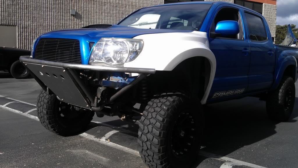

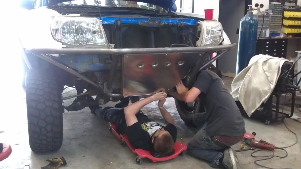

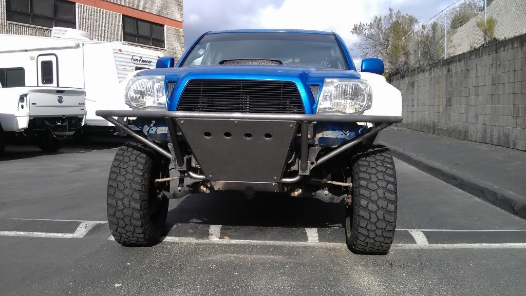

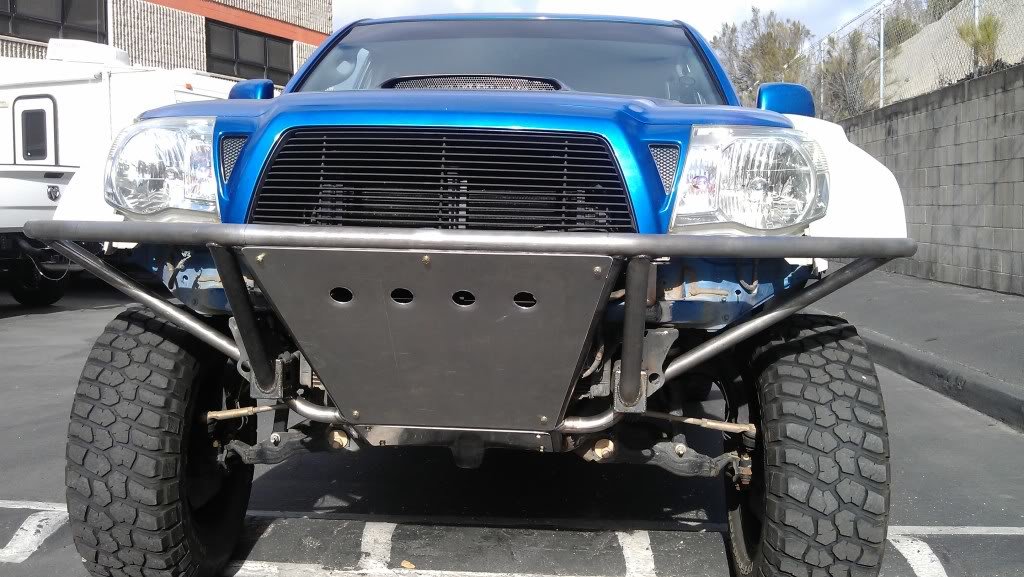

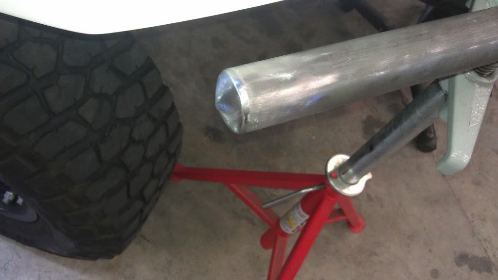

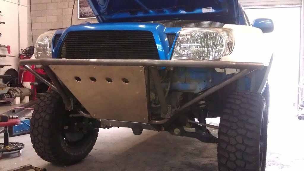

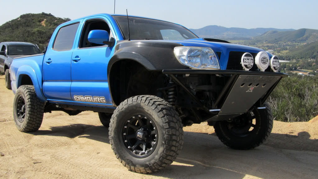

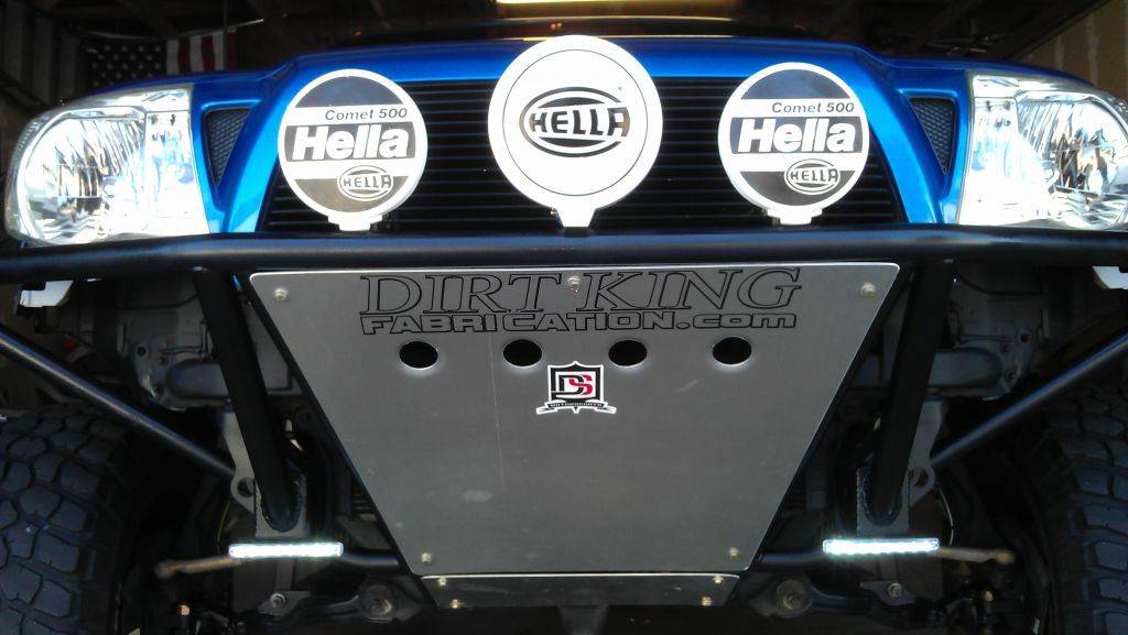

    Did you have to cut anything up front for the new tube bumper to mount?
  10. Apr 4, 2012 at 1:03 PM
    #250
    anthony250f
    anthony250f Well-Known Member
    Feb 18, 2012
    #73066
    16,770
    Anthony
    San Diego, CA
    2008 dcsb trd offroad 4wd
    looks like there is no crossmember and its welded
  11. Apr 4, 2012 at 1:09 PM
    #251
    Cortland
    Cortland Well-Known Member
    Mar 25, 2010
    #33948
    1,500
    Cortland
    California
    Clifford aka Big Red
    Camburg 4" Spindles, 5100's All Around, All-Pro 1.5" Leaf Pack, All-Pro U-Bolt Flip Kit, Avid Sliders, AFE Pro Dry Filter, Wicked Flow 18" Muffler
    Touche!

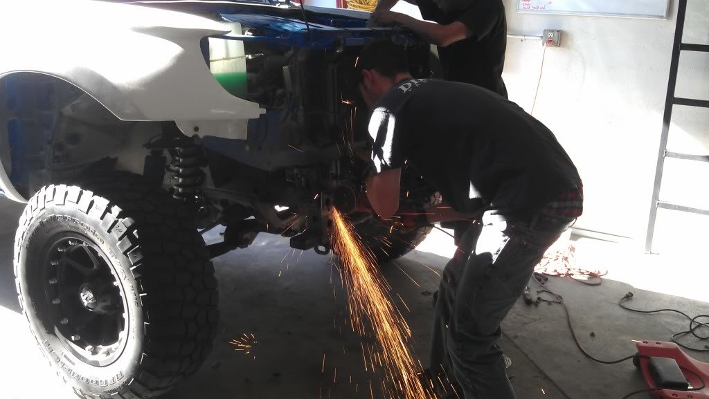

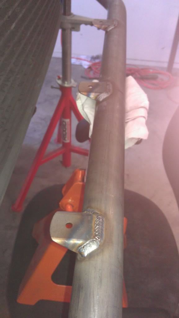

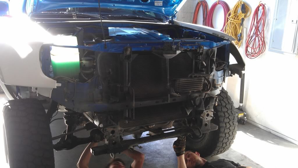

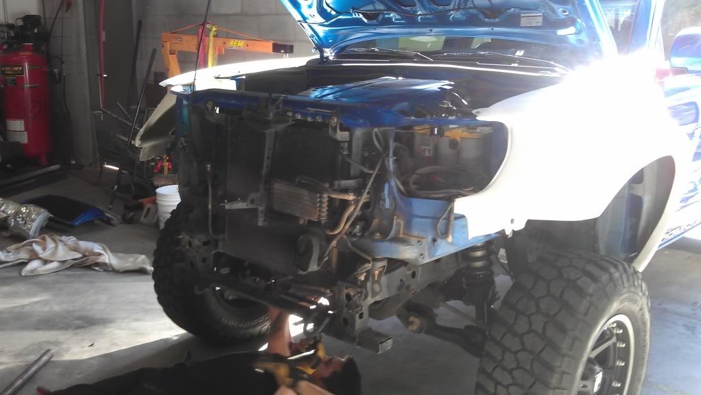

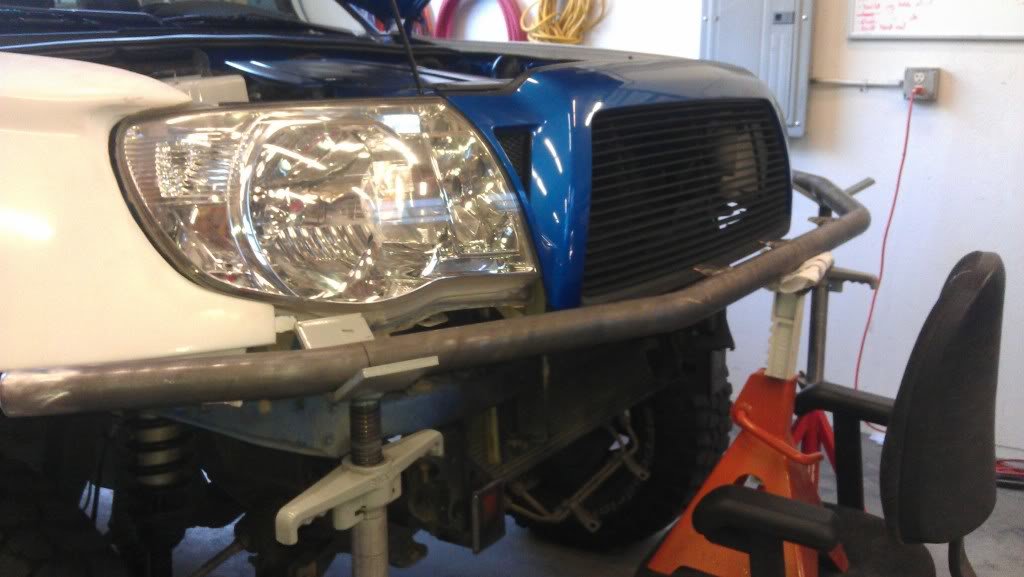

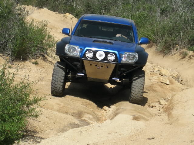

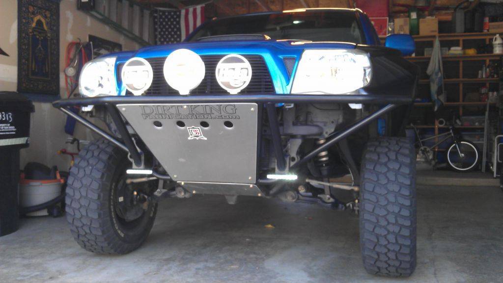

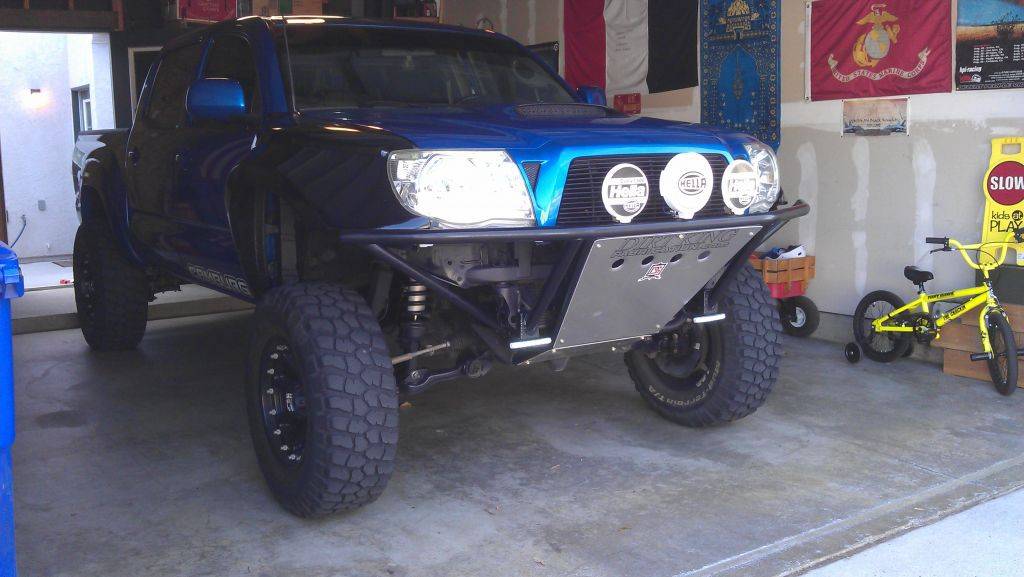

    We cut out the bumper cross member and welded a new one in when the bumper was built.
    Correct
    Thanx Mark! It's a very slow progression. It will never be as nice as yours but it will be great when it's done.

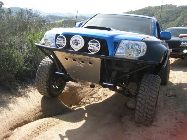

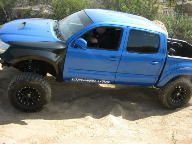

    Here are the few pics that I got of the build.

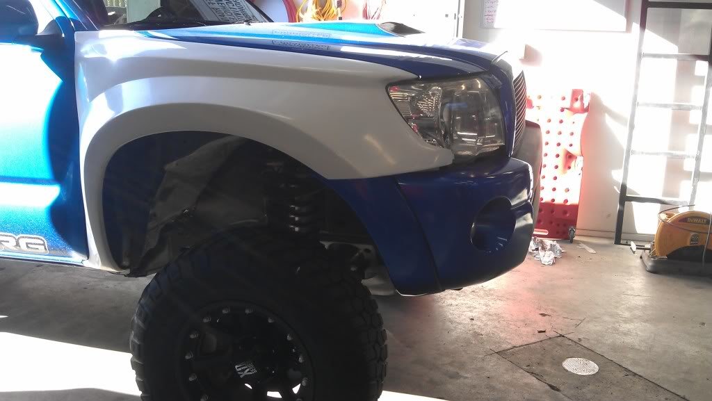

    those flares look great! they are the 6" right?
  15. Apr 4, 2012 at 2:47 PM
    #255
    imsikotic
    imsikotic [OP] If u cant stand behind our troops. Stand in front
    Apr 22, 2009
    #16278
    4,934
    Randy
    Temecula, Ca
    06 TRD Sport DesertRunner
    4" Camburg Race Spindles and Icon 2.5" ext travel Coilovers in the front for about 5"of lift and for the rear All-Pro 3" leaf pack and Fox 2.0 Resi's converted to piggyback and custom valved by DownSouth Motorsports. 17x9" KMC XD Addicts w/ 4.5 inch Backspacing and -12 Offset. Wrangler Duratracs 285/70/17. K&N CAI, Exhaust, Carriage Works Billet Grill, Custom Bed bar with ProComp fog lights,DirtKing Fabrication front bumper w/ 3 HID converted Hellas, Demello rear PreRunner bumper, Tinted windows, Full System w/ 2 10s, Garmin 265WT, ClearHLM. Theres more I just cant think of it right now.
    Thanks and yes they are.
