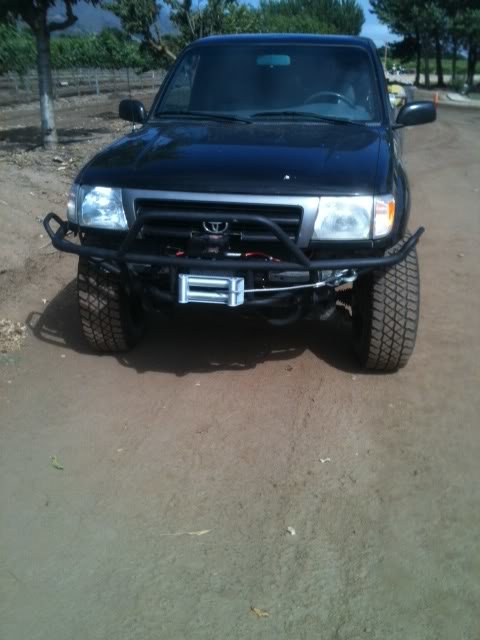

    Bought this Taco in May. Was a jeep guy before, had 3 jeeps. Decided to switch over.
    98 2.7L, 216k miles, not sure what lift it has on it, was told it is a 3", there are coil spacers upfront, and blocks on the rear leafs.

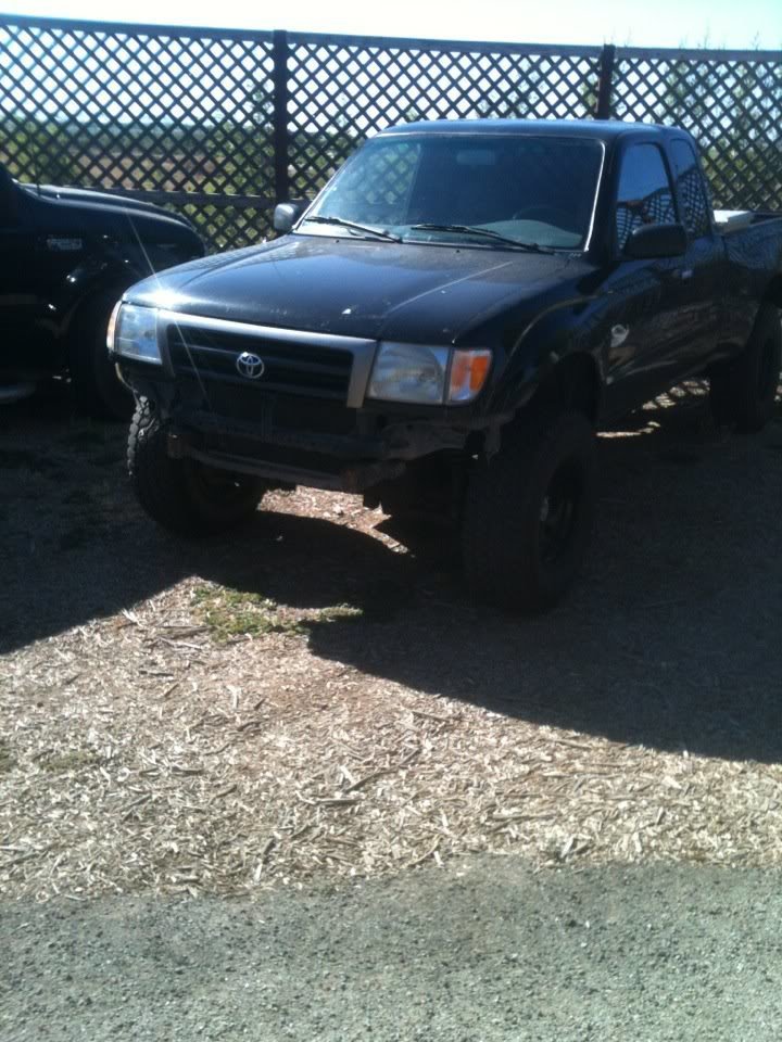

    This is what it looks like today.

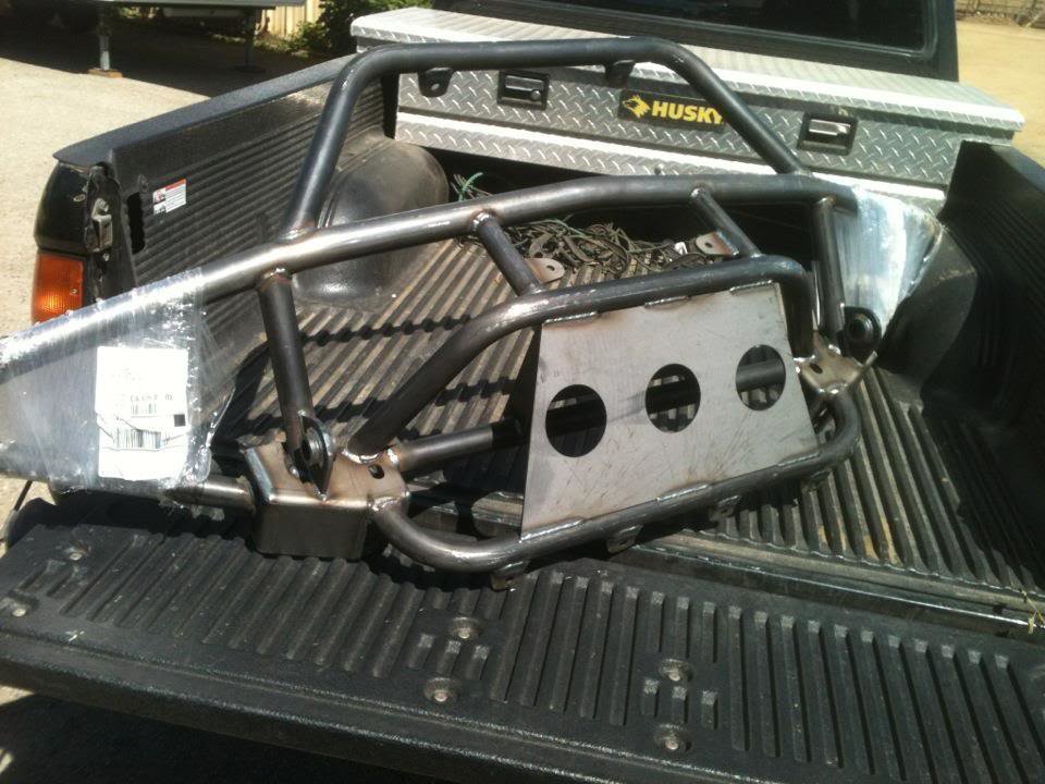

    Bought All Pros tube bumper
    Painted and mock up.

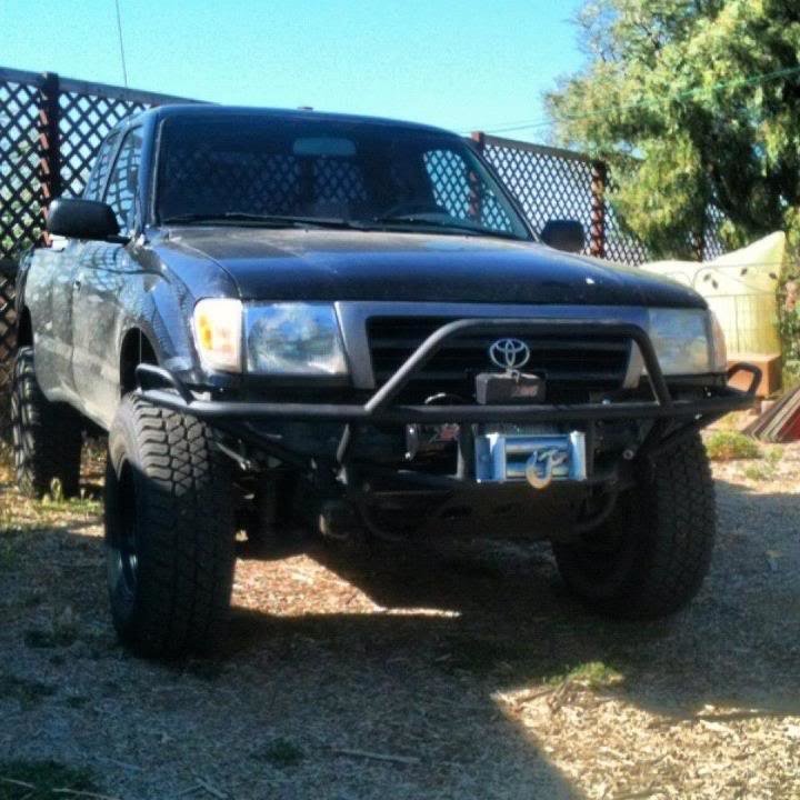

    Done with Xrc8 winch.
    Got front windows tinted and put on a husky toolbox i had from a frod ranger i had.

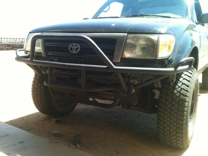

    You're off to a decent start with the allpro bumper & the addition of a winch, I think your next MOD should be to lift that truck proper like thru suspension, & it doesn't have to cost an arm & leg, dump the block & add 2 Chevy truck springs per side for a 3" lift in rear, get some Bilstein 5125's from DSMS for the rear & some 5100's for the front with some Eibach 3" lift coils for the front, you could do all this for about $600 & change...:)

    probably gonna order the bilstein 5100s for the front and just use the stock coils for now
    im thinking in the long run doing the camburg coil over and camburg upper control arms
    just got some 265/75r16 km2s mounted
