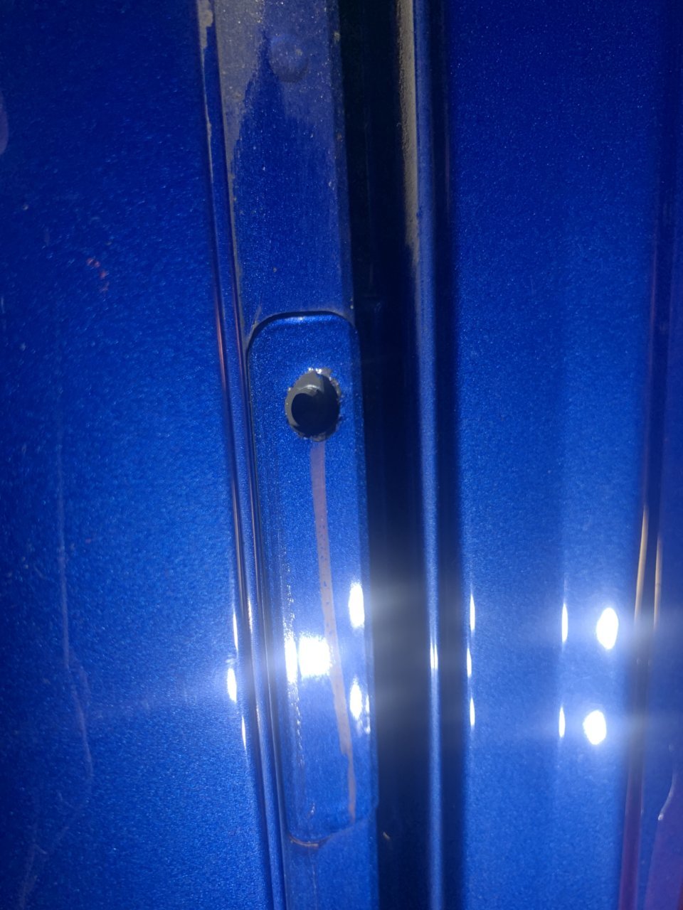

    I recently installed a rhino rack which bolted and riveted to the roof. Best I can tell, they are thru-holes which go into the headliner cavity. They are 100% sealed BEFORE you remove the painted membrane over them.
    I attached a pic of one, once the seal has been cut away.
