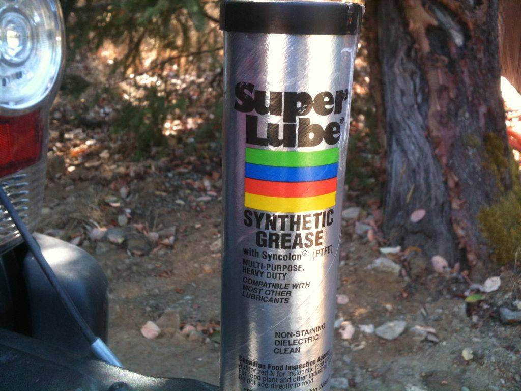

    What is the best Silicone grease to use for my Camburg UCA and Defined Shackles. I have searched and searched, but these recommend Silicone lube and the only Silicone lube I can find is in a can for like rubbing on not pushing through a Zerks fitting. Should I just buy the 3M stuff in a can and dump it n the grease gun?

    Super Lube , at least that is what was recommended for the Defined shackles
    I had to order it in at my local auto parts store

    Super Lube is the lube recommended to me by Defined Engineering specifically for the Defined Engineering Greaseable shackles for 2nd gens

    I will use the recommended super line for the shackles, but was just wondering for the UCA.

    you can use superlube on all pivots, been racing on it for years. i just dont recommend it for drivelines.
    you can use whatever you want but just dont use a petroleum based grease on delron bushings
