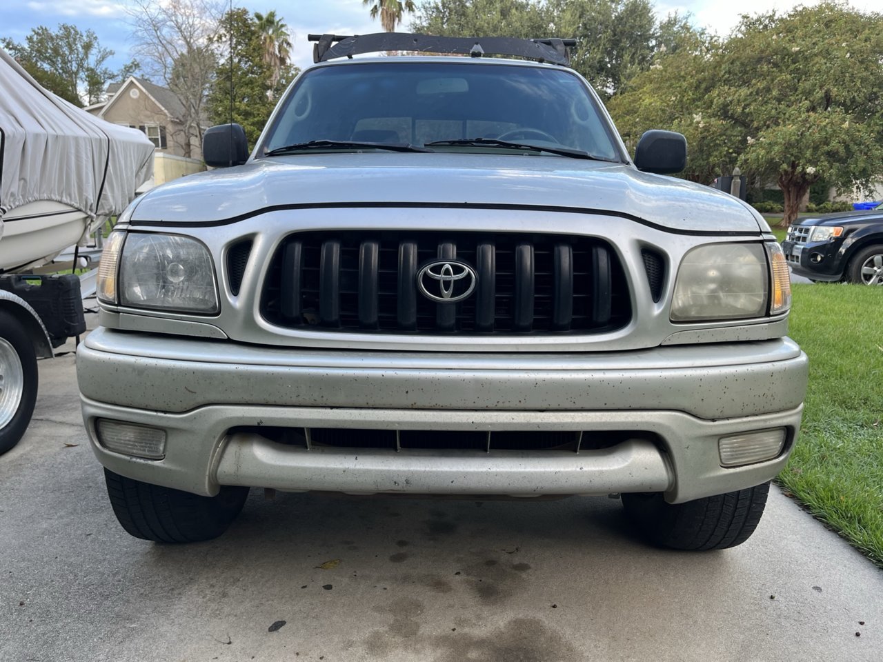

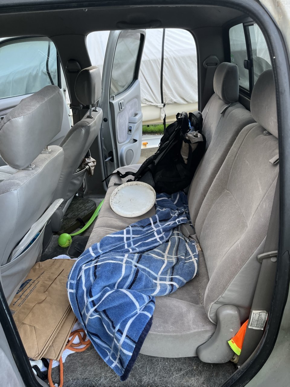

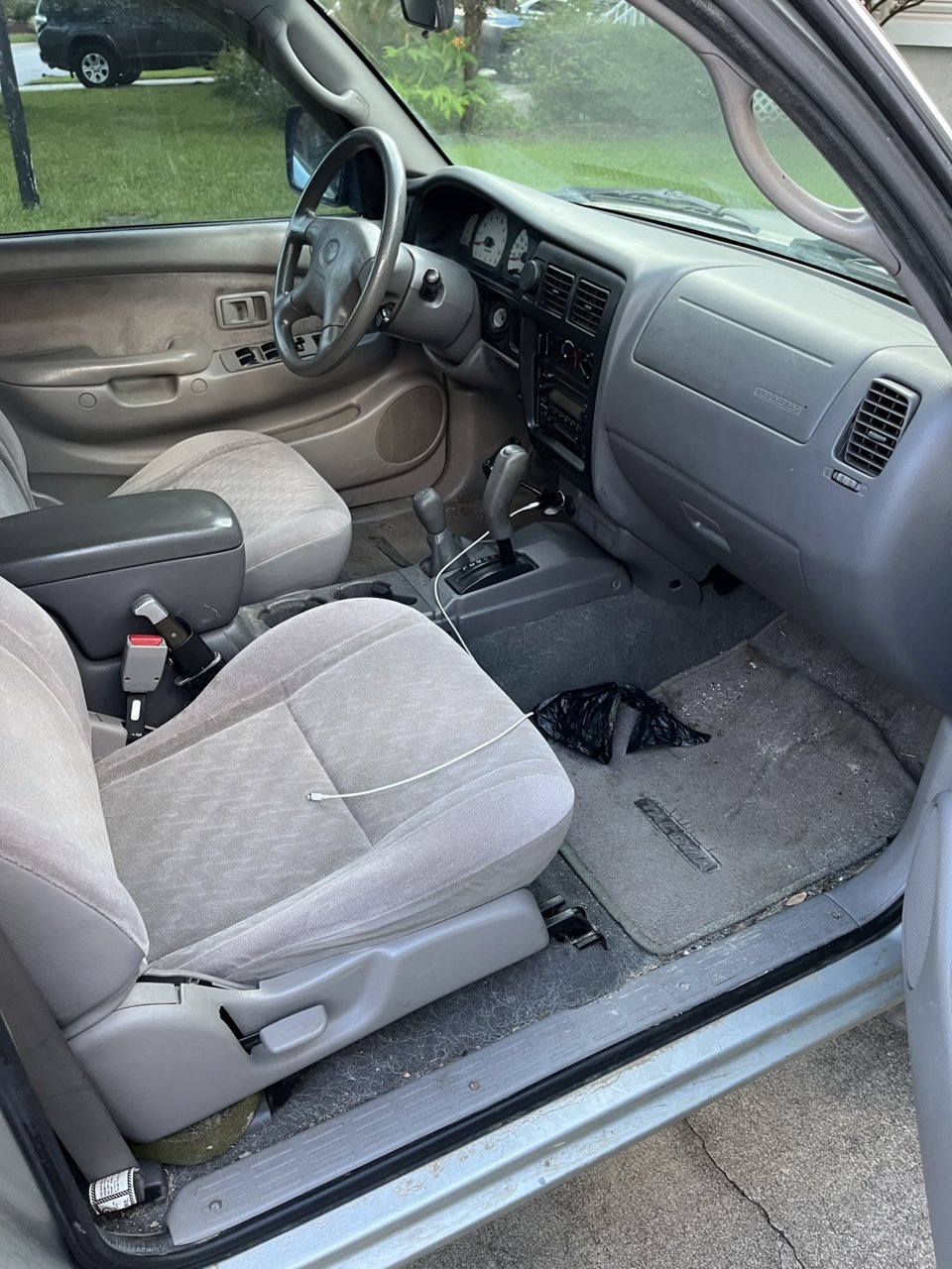

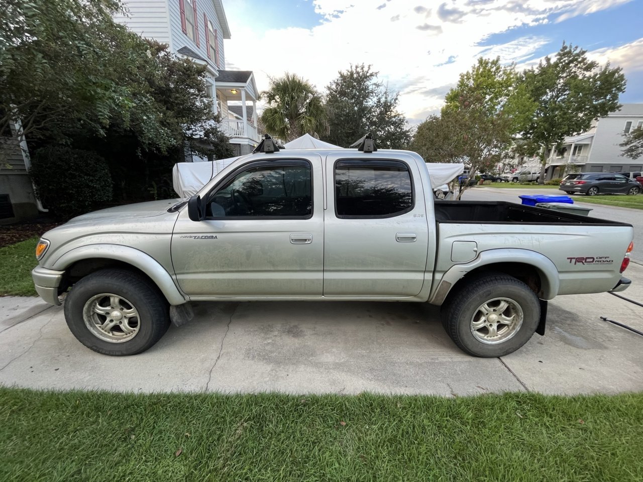

    Here is how she sits today, stock as a rock, dirty, but still loved

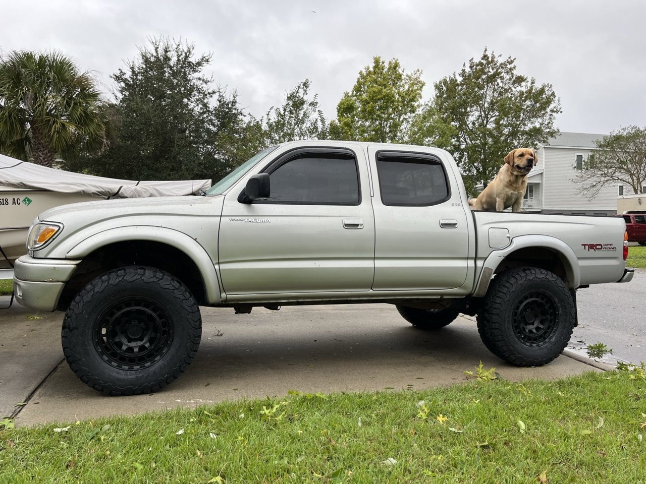

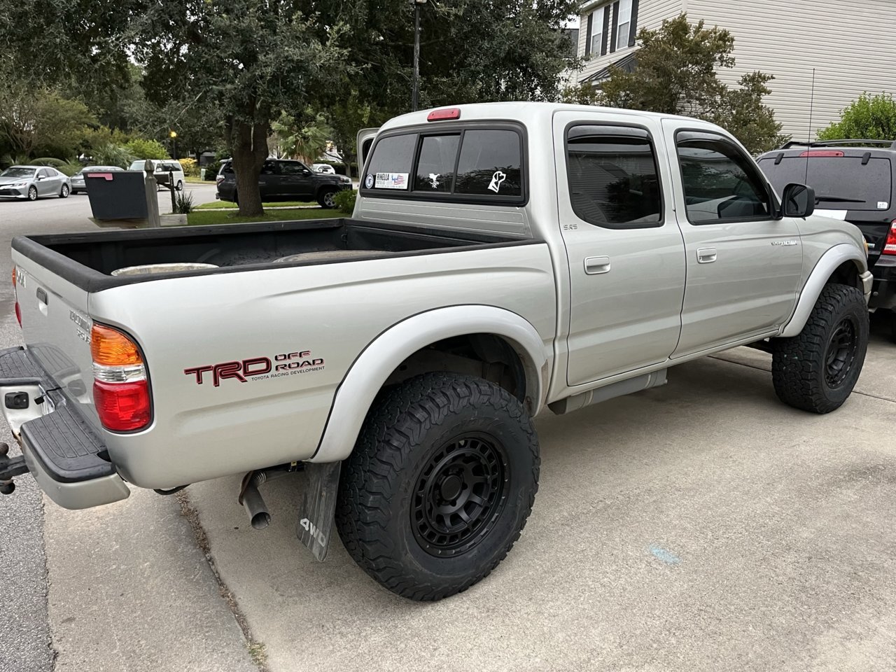

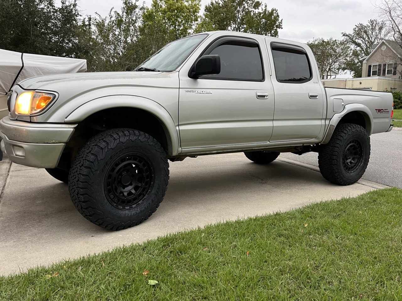

    Sorry for the delay! Life has been BUSY to say the least. I've done a bunch of work to the truck since my last post, but I'll show off one upgrade at a time. First, the OME Lift, Black Rhino Chamber Wheels, and BFG K02 tires. I picked full kit up from 1st gen offroad. It was the best price AND they had everything in stock. Many vendors advertising don't actually have everything in stock, and parts are on backorder for a long time. Before making the purchase I reached out to them just to make sure, and Josh was extremely helpful, guiding me to choose the 883 coils since I would be adding a heavy front bumper + winch, and wanted as much lift as possible. I did not add an additional DX4 leaf in the back, as I don't intend on adding any heavy constant load to the rear of the truck, just the front. Since my suspension was very worn out with 309K miles at time of install, I believe I got even more than 3 inches of lift out of it.
    So the full setup looks like
    Suspension: Old Man Emu 3" Suspension Kit, 883 coils (https://www.1stgenoffroad.com/store/p186/1stgenToyotaTacomaOMELiftKit.html#/)
    Wheels: 17"x8.5" Black Rhino Chamber with -18 offset (Part # BRH-1785CBR-86140M12)
    Tires: BFG K02 285/70/R17
    Overall I could not be happier with the look. The pictures don't do justice of how good it looks in person. I've already got tons of compliments. Highly recommend the Black Rhino Chambers with the -18 offset. As for tires, I debated on going bigger to 285/75, but I think this is plenty, and I still had to do a very minor cut to the plastic covering the pinch weld to prevent rubbing. The tires clear the pinch weld, but I still planning on mashing it down with a hammer just to ensure it doesn't hit and potentially cut the tires when off-roading. The MPG has dropped from 17-18 highway to 15-16 and I can tell when accelerating that they are there. So, I can't imagine going to 285/75 without making changes to the gearing. The ride is VERY STIFF right now, but I think once I add the heavy front bumper, and it wears in a bit, it will get better. Even though it is very stiff, I'm not missing the excessive roll the old suspension had when cornering / riding long on/off ramps. IMG_6119.jpg

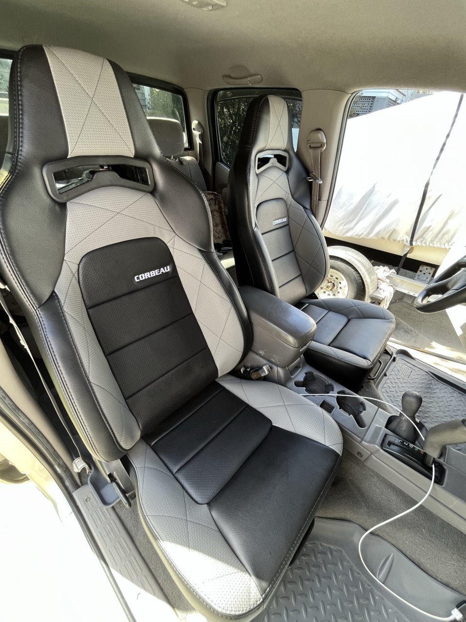

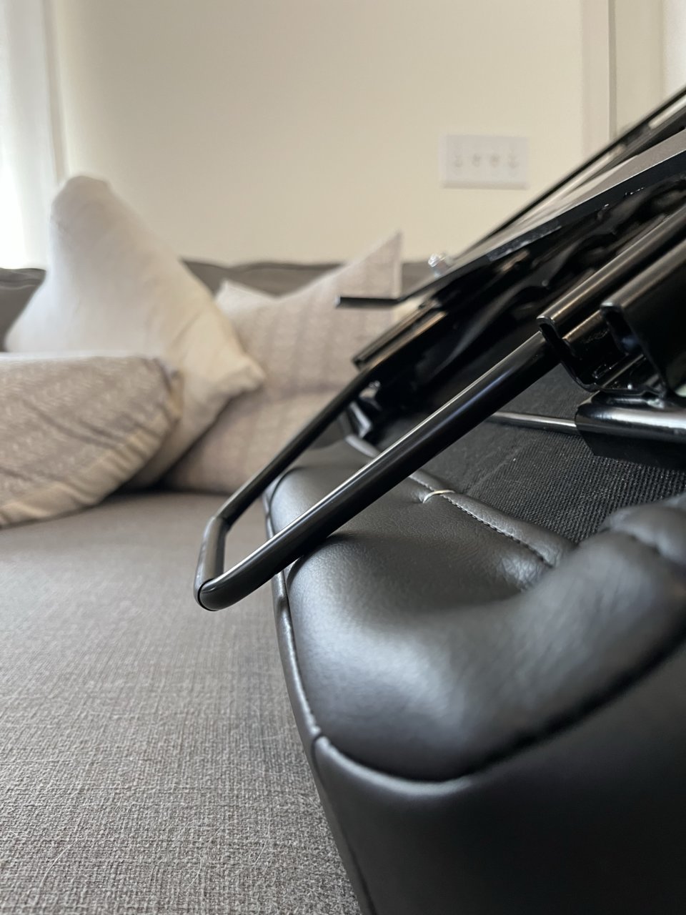

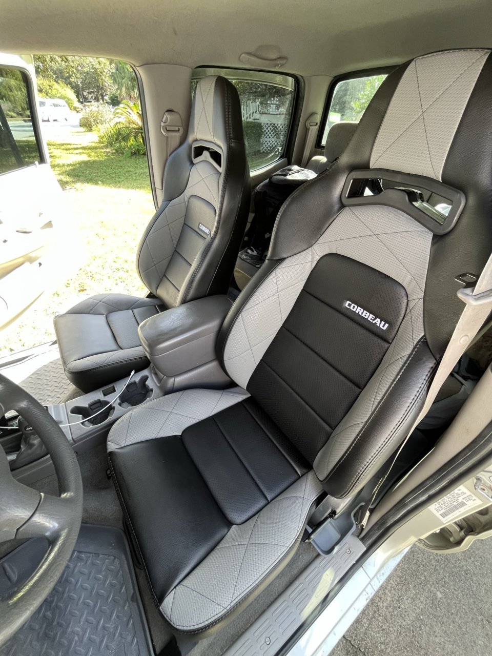

    Next up, Corbeau Trailcats with grey accent. GAME CHANGER. GET BETTER SEATS YOU WILL THANK YOURSELF. Factory seats are so awful I should have done this years ago.
    I waited about 2 months for these, as they were on backorder. Corbeau was nice enough to hook me up with a discount, because I did actually call them to verify they were in stock before I placed the order. They told me they were in stock, but it sounds like their warehouse system inventory was off, because they weren't! I placed the order just before labor day weekend and received them the last week of October.
    For those of you looking into aftermarket seat options, what drove me to buy Corbeau was that they offer seat brackets that bolt right up to the factory bolt locations. No drilling, cutting, welding, etc. modifications needed. The seat brackets must be installed on the seat, and then the seat and seat bracket go in the truck all at once. They have instructions online of how to install the seat bracket to the seat. Very simple bolt up as well. The only thing that was a little frustrating about my one seat bracket that I didn't realize until struggling for a bit was that the seat release bar was installed upside down from the factory. So, when you go to put the seat bracket on the seat, the release bar hits the bottom of the seat so you cannot release the seat slide, and get to the bolt holes as needed/shown in their video instructions. I've shown a picture of this below for any of you future customers to be on the lookout for! I'm going to let Corbeau know about this as well so they can keep an eye out for it.
    The only thing that is not bolt right up and go are the female seat belt receptacles. There is a bolt hole on the frame where you can mount the female seat belt receptacle, but the threaded stud is welded to the factory seats, and the length of the female receptacle bracket doesn't quite match up to the Corbeau seat bracket so it sits in the correct position. So, I am seatbeltless until I get that squared away, but should be pretty simple fix but cutting factory belt receptacles shorter, drilling new hole, finding bolt to fit factory nut, etc.
    The seats are very comfortable to ride in, and keep me centered much better around turns. It has really helped the ride of the truck especially since having a new stiff suspension. They do tend to trap moisture a little bit and not breath as well as I had hoped, so prepare for a little more swamp a$$ in warm weather. Cold weather no issue. The seats sit up higher than factory, which I did not need since I am 6'4". However, I really like having my legs at a more upright angle. Only downside is I have to peak out to see traffic lights at intersections, or stay further back to help the angle!

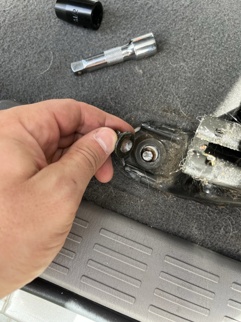

    Last but not least, don't be a dumb like me and decide that the first bolt you're going to remove with an impact is the the rear seat bolt that is rusted through the underside of the truck, and shear the head off. At which point a simple fun job becomes a not so simple very frustrating job!

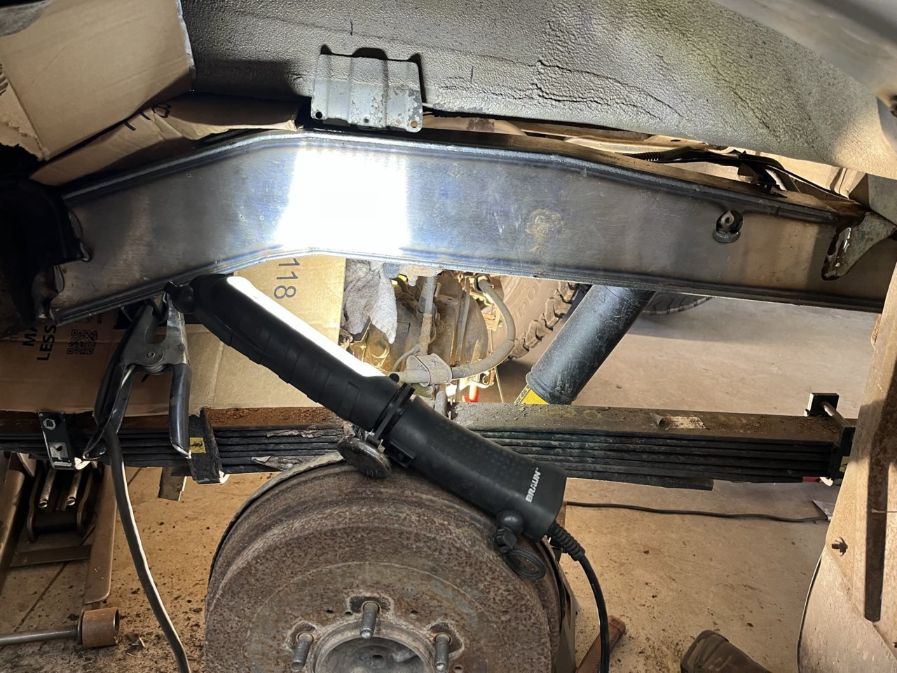

    Frame perforation fixed with the Safe-T-Cap!

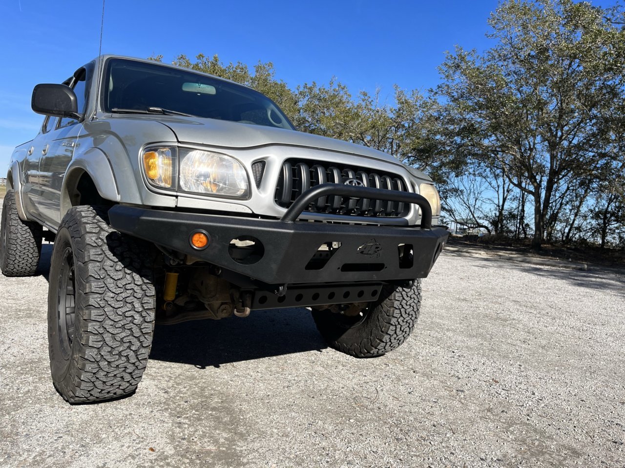

    All Pro Apex Front Bumper Added this past weekend too!

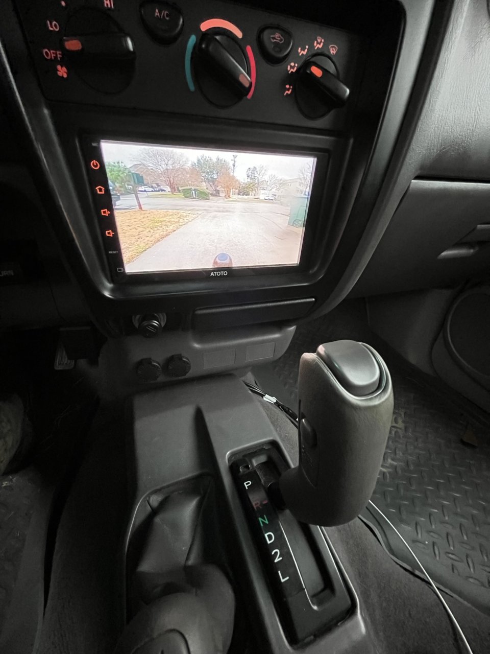

    Installed this a while ago....

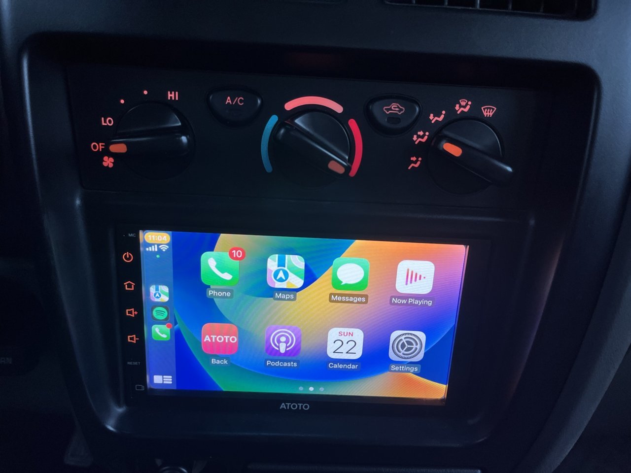

    ATOTO S8 Touchscreen with rear backup camera. Has Apple Carplay / Android Auto, can even match the color tone of the buttons to the OEM orange color of the truck. Love it! No more guesswork backing up to the trailer. Can see right where the ball is relative to the hitch. Saves me a couple hops in/out of the truck. Nice to have Spotify or whatever audio running at the same time as google/apple maps on the phone. Can run it in dual screen mode as well.
