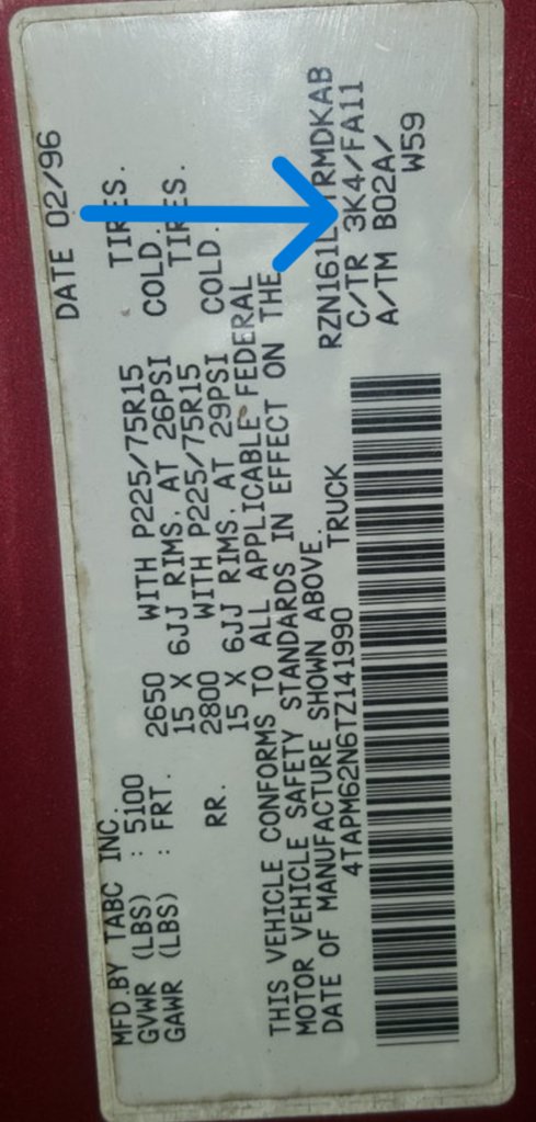

    It's usually on the door jam vin sticker.
    Look for C/TR. Then next to it on the right side will be a 3 digits.
    That's the paint code.

    Paint code here.
