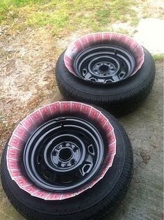

    I aint painting the flat parts just the indented parts. If I spray how do I get it only on i dented parts then? Spray will be all over the place.

    Painter’s tape…

    ahhh oroblem is tires are on pain in the arse

    It’s not as bad as you think. I have done it many times just set aside six hours or so and a little patience.

    Playing cards are a very easy and effective way to protect tires still mounted.
