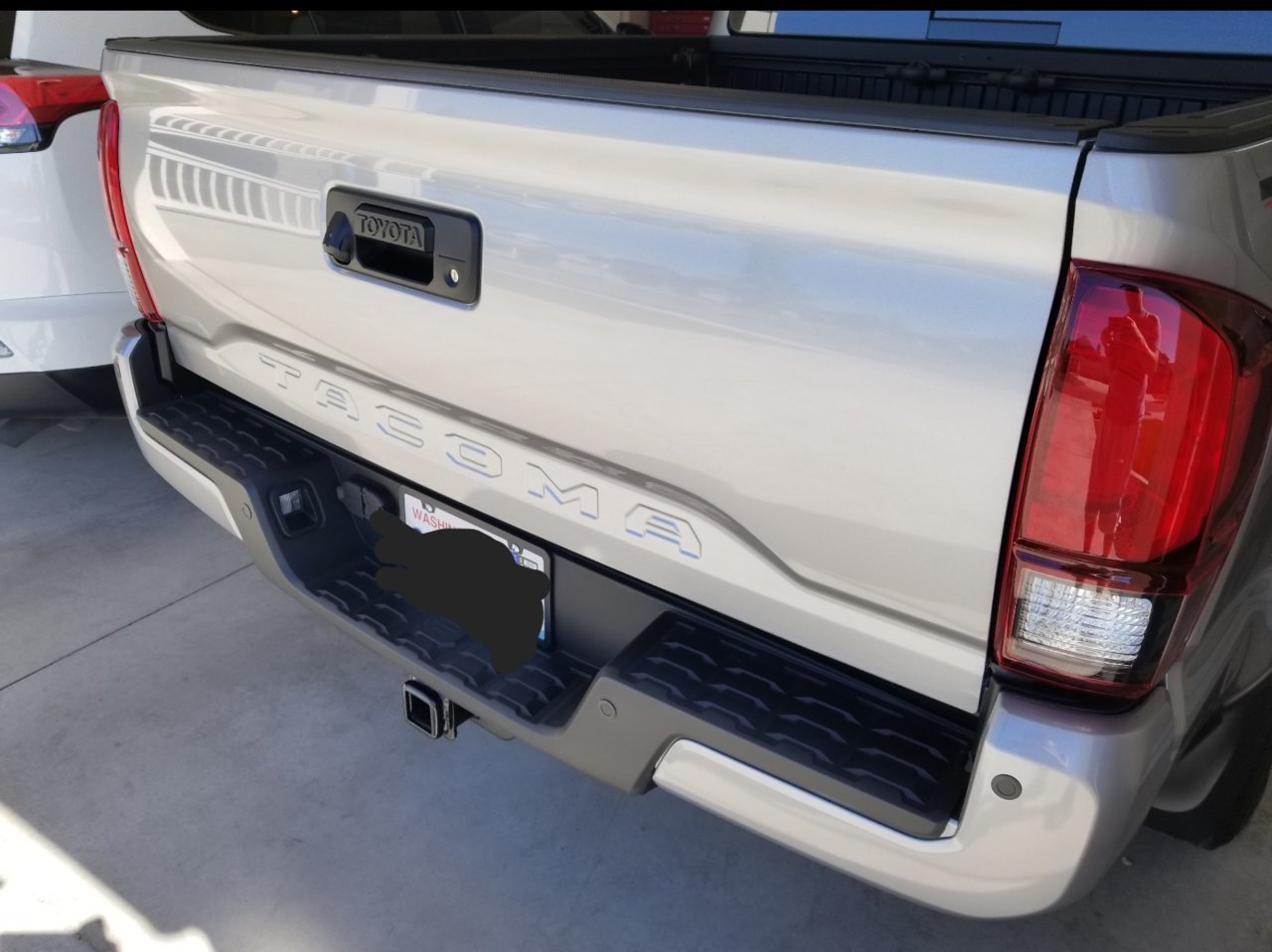

    2017 Silver Sky Metallic Sport SB
    Passenger side is the repainted bumper cap.
    Driver side is he factory cap.
    Really appreciate all the comments as body and paint work I have no knowledge of. I knew there had to be some answers and not settle for the shops shrugging their shoulders saying I’m just going to need to settle that it will never match

    plastic and metal don't really ever match up. You try to get it as close as possible. At some shop i have work they have a sign from the paint manufacturer saying that. Some painter say waterbase colors match a little better. If i remember I think Toyota use that.

    That ^^^ should be able to from Toyota parts department. They are costy but that paint they put on there, well hahahahahaha not even close. Aren't they testing the color BEFORE painting the part?? If so looks like colored blind. Seriously not even close.

    It kinda looks like it matches the fender flares.

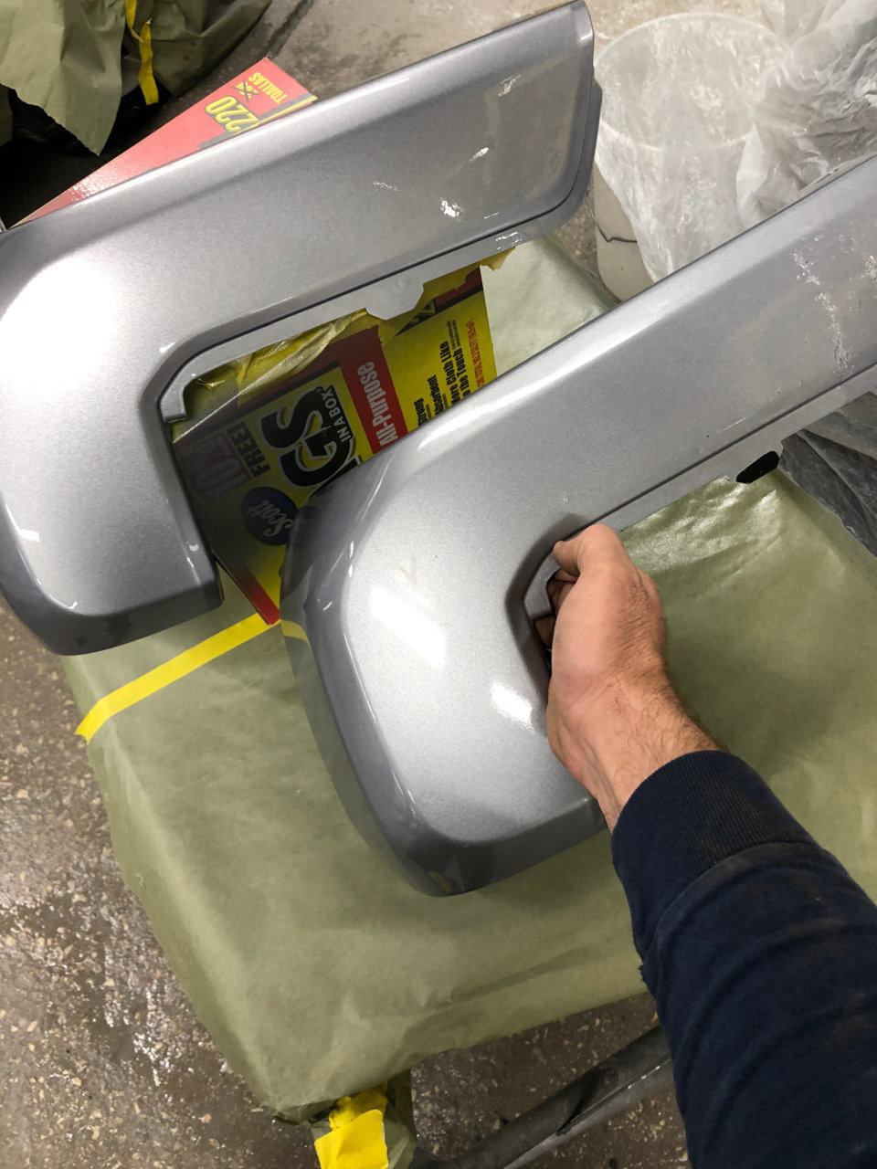

    All -
    Thank you very much for all of the responses and sorry for the lack of response on my end had some stuff going on at work that I was traveling with so this kind of got pushed to the side till now. I'm attaching a picture from the body shop let me know what everyone thinks. The top is the new piece and the bottom is the original. I think the new one looks pretty good minus some shadows from the lighting. I'll send a picture of it back on the truck tonight.
    Thanks again for everyone's input. Maybe a plate bumper down the road have to put a cover on the back before winter comes to our neck of the woods this fall.

    That paint they did is silver Streak,Not SSM.

    I don't see it

    Just to let you know, there are about 5 different metallic silver sky with thevsame code. Went to the automotive painshop and he had a swatch of silver with same code but 5 different swatches but were extremely close.

    Give that painter a six pack. Only an experience painter can blend.

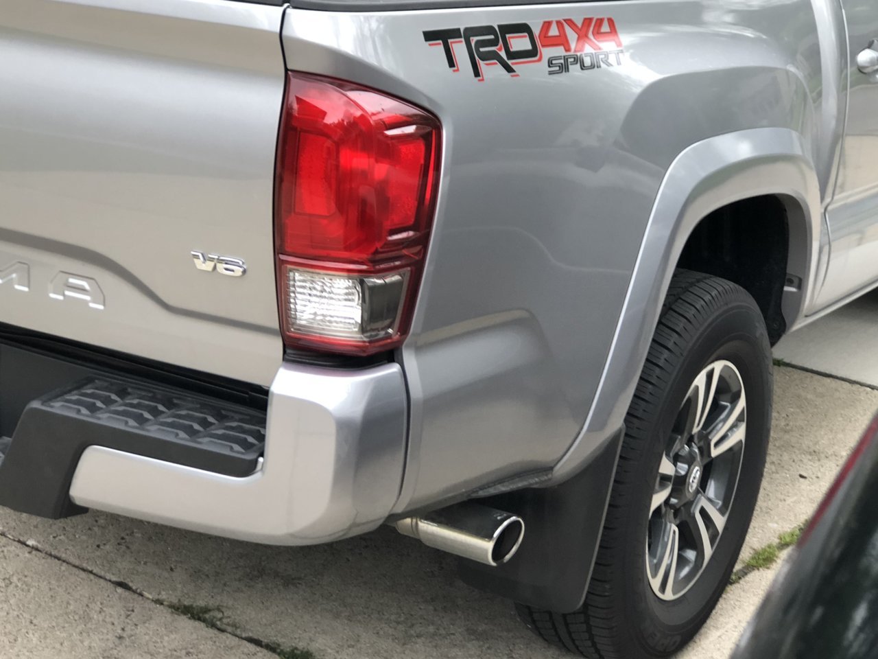

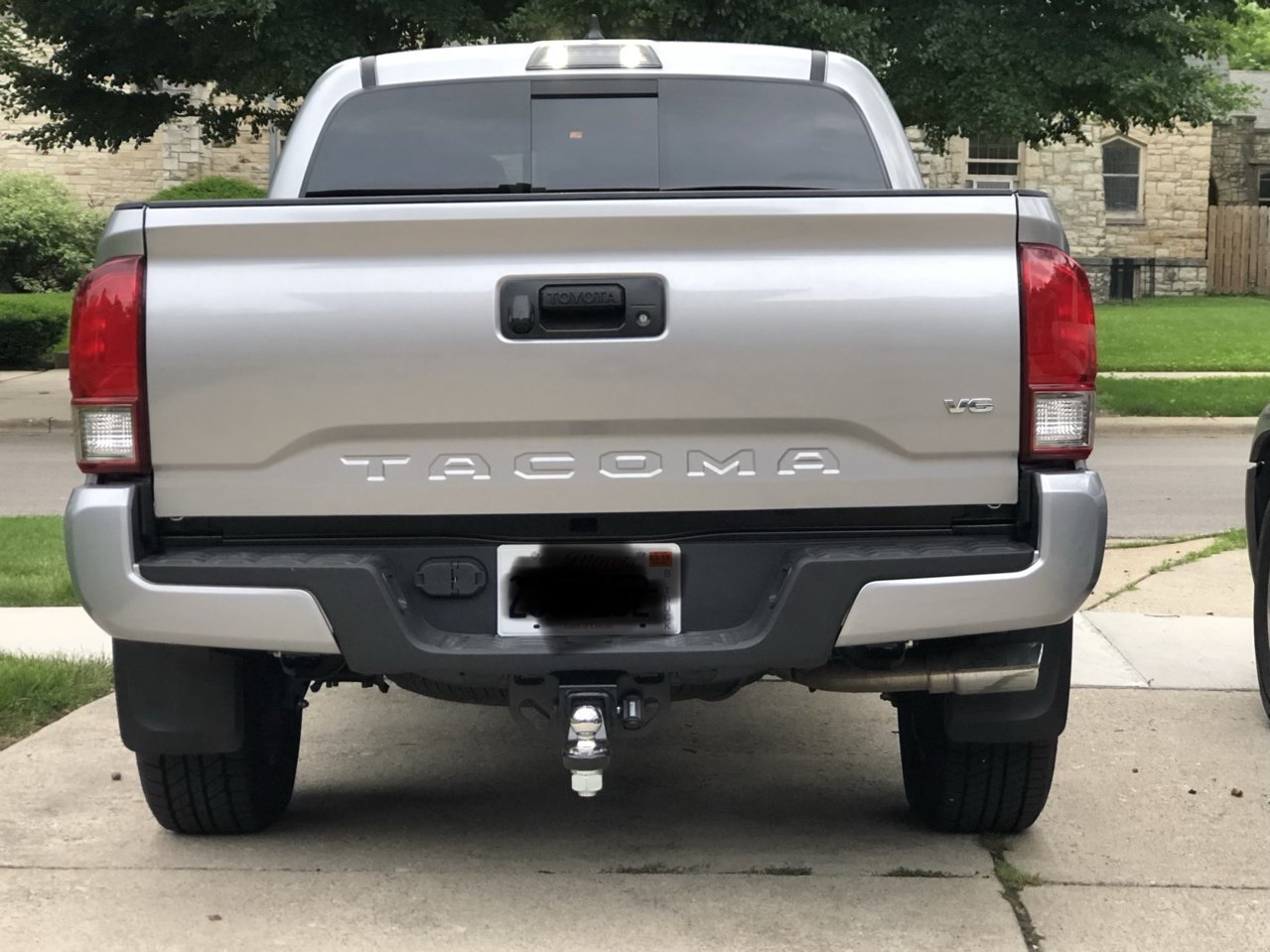

    All here are a couple of quick photos with the cap back on the passenger side.

    Looks much better. Pop that lonely V6 badge off before you have fading and it's too late. I took mine off right away. It just looks silly floating out there in no man's land all by itself.

    Thanks I agree it looks much better.
    Never paid attention to the V6 badge till you just said it. Guessing pull it off on a hot day and a lil adhesive remover to get the glue off?

    Fishing line. I heated it up with a hair dryer first. You don't want to pry or it could scratch the paint. The fishing line slides right behind,
    then it falls off. Pick the adhesive off, then take some bug and tar remover to remove the residue. Takes about 15-20 minutes. Looks so much better in my opinion. I've never debadged any vehicle before, but that emblem was just too strange.
