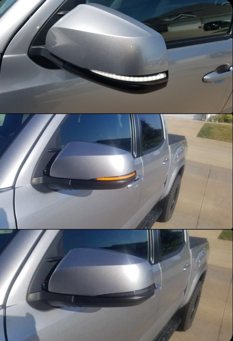

    USR LED mirror lights with DRL's - I am very impressed with the light output of these over the factory lights & the DRL feature is just awesome!
    https://www.uniquestyleracings.com/...ke-lens-switchback-led-mirror-signals?search=
    Here is an install video of the mirror lights. Installing the lights is an easy 5 minutes each side. Pop off the painted cover, 2 screws, 1 connector & pop the cover back on.
    On the DRL wiring make sure you reserve yourself enough time (probably 2hrs - 1 day depending on your skills) & take your time fishing the wiring through.
    https://youtu.be/SNhQkdQNxIU

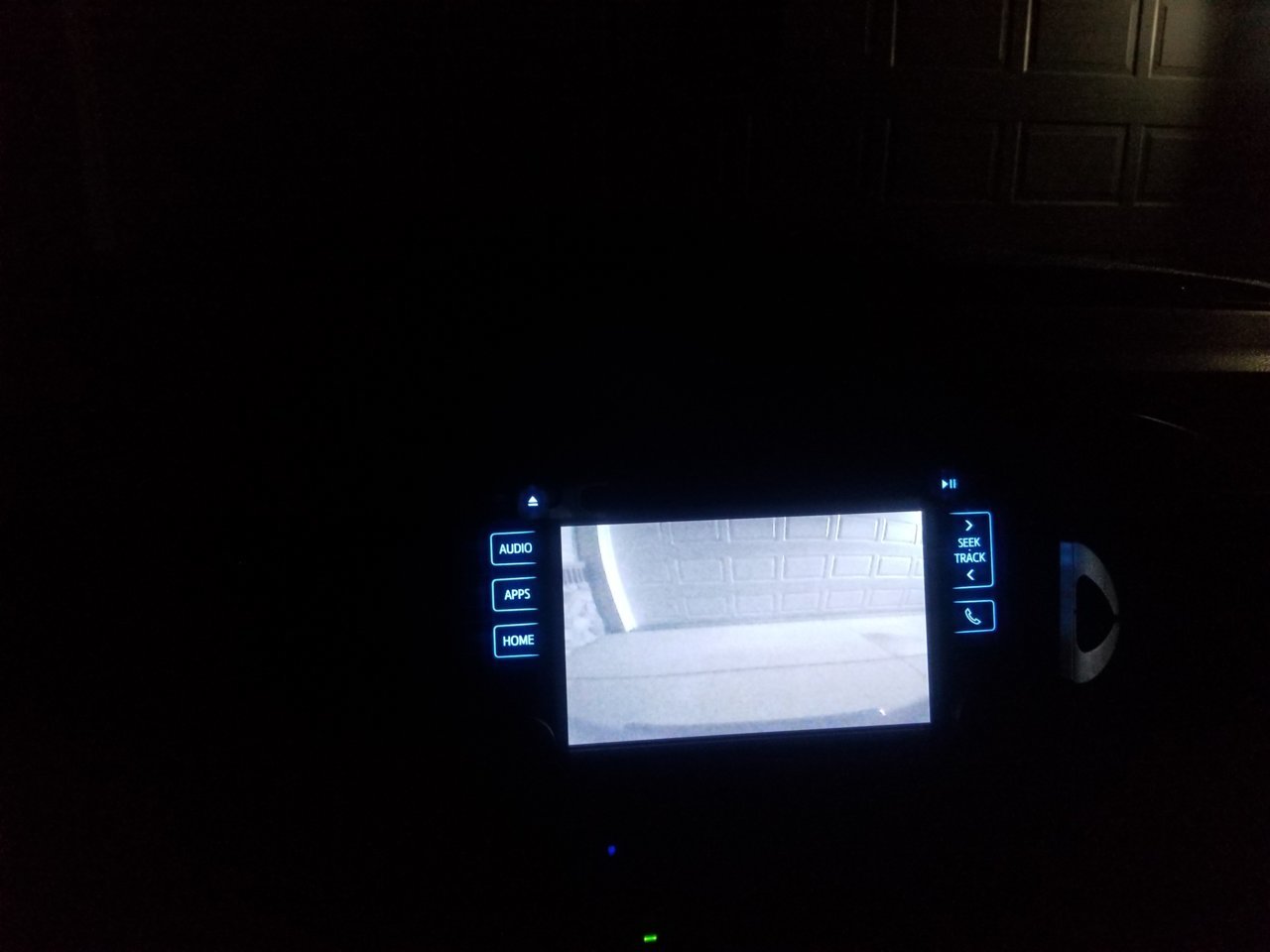

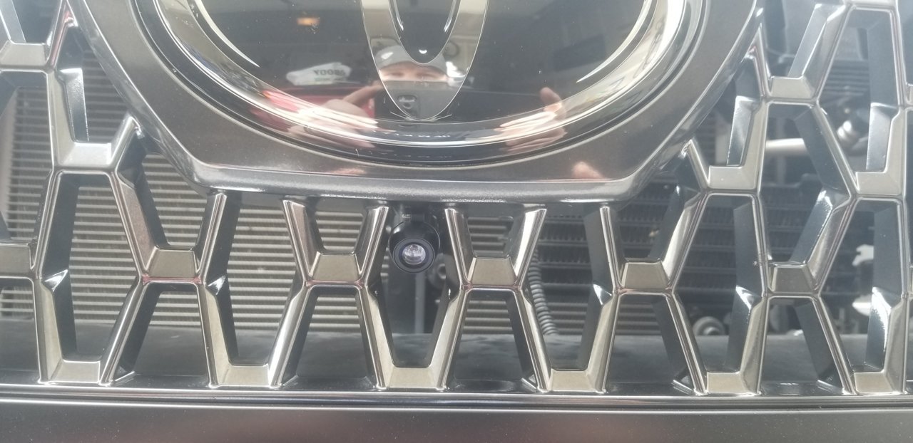

    I decided to do a front camera & chose the Car Solutions system. I am super impressed with the functionality & view I got with this setup both daytime & nighttime is great.
    I used this kit from Amazon
    The camera i used from Amazon
    Daytime
    Nighttime - In front of my garage with headlights off & outside light on. You can see through the windshield that it's really pretty dark out but looks good through the camera. Very impressive!

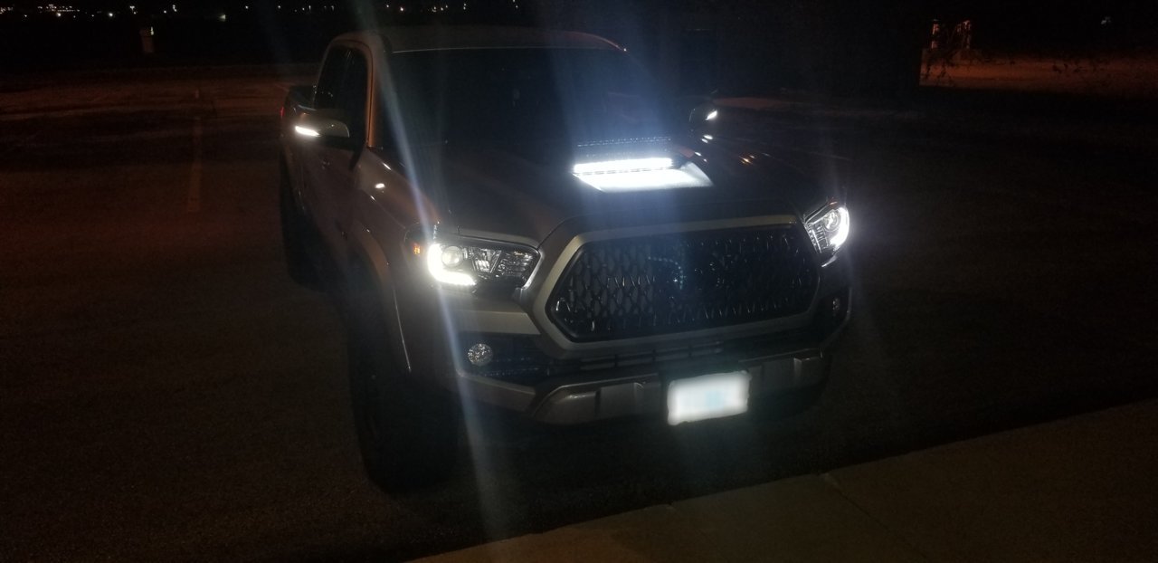

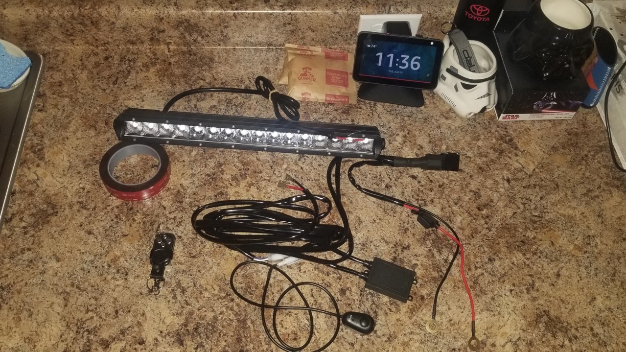

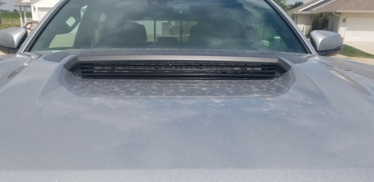

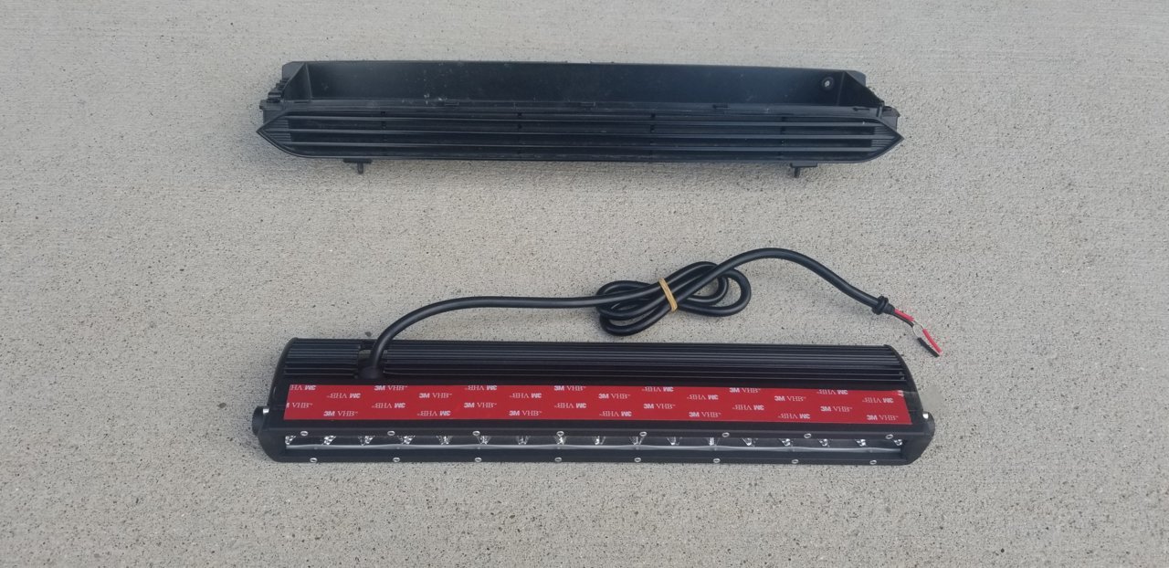

    For a lil more light I decided to make my nonfunctional hood scoop useful & got an inexpensive 11" LED light from eBay. After I ordered it I found out I could get a wireless remote with a receiver so I got that also. All in I spent around $50 but was super easy to install. The light is 80W & comes with battery +/- leads, an inline fuse & a 40A relay all in the harness. It does comes with a switch but I didn't use it.
    Here's where I got the light:
    https://www.ebay.com/ulk/itm/183689616669
    I got the wireless remote harness from here:
    https://turbo-sii.com/product/2-22-...ogue-rv-4x4-motorsports-jeep-wrangler-serise/
    Added some 3M VHT tape to the bottom
    Hole drilled to route wiring through & put in a rubber grommet to help seal the hole
    Barely noticable!

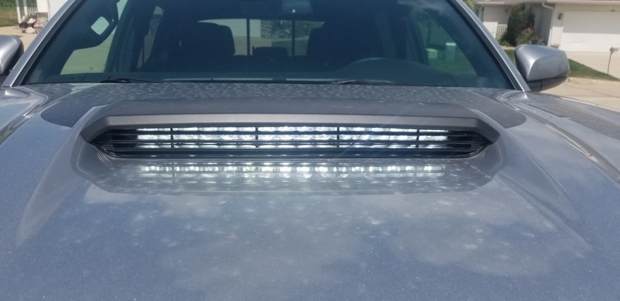

    Almost could be used as a DRL
    Good amount of light output. This 11" bar has both spot & flood bowls
