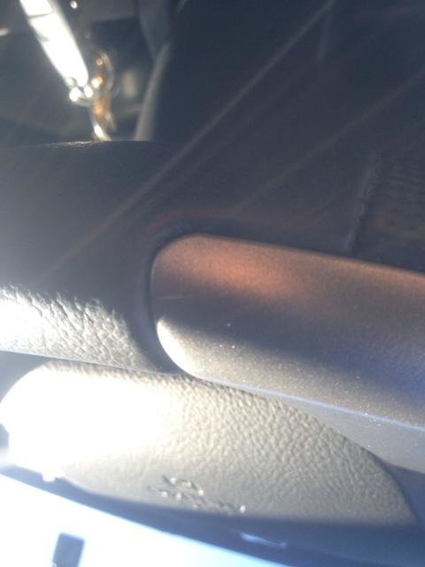

    Does anyone on TW know off hand if these trim pieces are replaceable? or can be removed? Took my truck to Toyota for it's first "Free" oil change at 5,000 miles. Would have done myself, but it was "Free" and I just don't have the time really.
    Anyway, later on today while driving, much after I had left the dealer of course, I felt and noticed a gouge or scratch in the silver plastic trim on my steering wheel. Definitely wasn't there prior to my service visit. Also guy that moved my truck was a BIG dude, probably scratched it on his belt buckle.
    You know when I first got my 2014, I said under my breath how stupid the design of that trim is, for a high-wear zone IMO, and it wouldn't be long before that trim there started looking like $hit. Anyway, I've been searching online at various parts diagrams, and not one breaks the steering wheel down enough to get those parts. Tried to pry the trim off with little luck, gave up before I broke it alltogether, (the lower portion snaps off) but the upper appears to be bolted or screwed under the air-bag assy (I really hope not) If there is no replacement part avail, I'm just going to sand it, and paint matt black and move on. But would still like to know how it comes off the wheel.

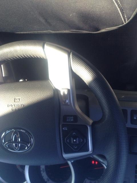

    Yes they are, but you need to remove the airbag.
    Disconnect you negative terminal
    Locate 2 roughly 2 Sq.in. black panels on either side of the backside of the steering wheel and remove with a small flat head.
    Remove the 2 torques head screws (think they're a T30?)
    Carefully pull out the airbag portion of the steering wheel and rest it on the steering column.
    Remove the 4 philips head screws holding the 2 side controls.

    Again though, why that plastic trim curls under the steering wheel like that, is beyond me. Should be completely leather all the way around the ring. I feel like my wedding ring scratches it every now and then as it is, but it doesn't, just feels like it. I'm sorry to be OCD about this, I just hate having damage right in front of my line of sight when driving.

    Does anyone know if the base Tacoma's with the all black steering wheel trim, had the full Bluetooth, Entune and volume control option? I think I found the parts here...
    http://www.oemtoyotapartsgroup.com/...64292/Steering-wheel/455966A-4504-674470.html
    And if I'm going to the extent to remove the Airbag assy, It would be worth the $33/ each to change to the OEM black version .Vs the IMO cheesy and easy to scratch silver.

    Looks like my only option may be to find the black trim from a '14 T4R, Trail like this. *Except my truck doesn't have that DISP button under the Bluetooth side. I wonder what that button does on the display? Perhaps it would work for something on my Tacoma?
