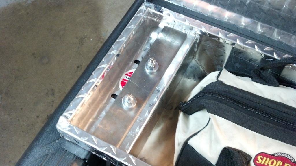

    No help on the paint. But I put that box in today. Perfect proportions for the short bed IMO.
    It's pretty light duty though. I cut and drilled some flat stock to beef up the mounting points. I don't have a pic, but I also cut a piece of 1/2" plywood to size and set it in the bottom of the box. Just I case I drop something heavy in there.

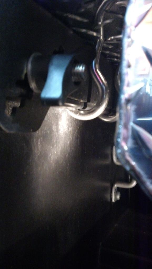

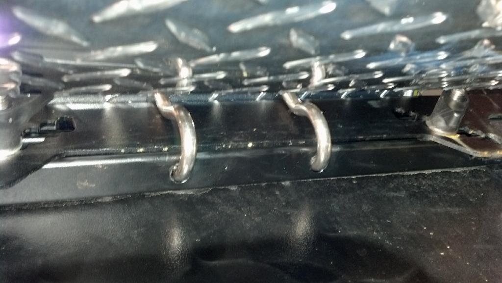

    Those look like good mounts. I couldn't use them due to my rack mount covering up the bed rails.
    This is the bottom side of my toolbox mounts. Good if you can't use the rails or just want to save a little $.
