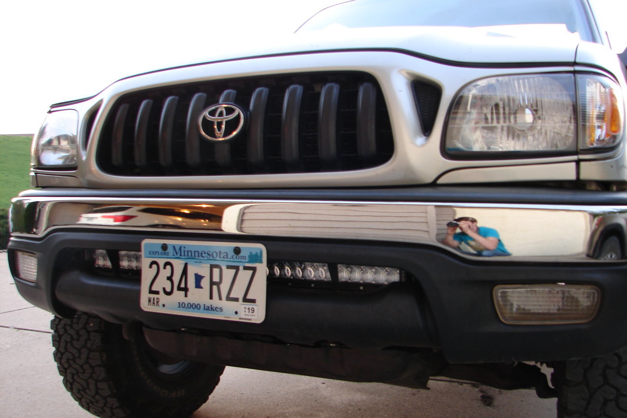

    Well it certainly took me long enough to get pictures, but here is where I mounted my 30" Light Bar from Cali Raised LED last summer. I had a local metal shop cut some pieces of 1/4" aluminum to mount on each side of the front crash bar. I decided to take the lazy route and mount it without removing the bumper, so I can tell that it ended up being positioned slightly slanted to one side. However, I think that's just the perfectionist in me! The bar is super bright, no complaints there. I wired it into my fuse box and placed a switch in my Paranoid Fab switch plate under the radio. I don't think I've ever enjoyed driving at night as much as I do now!
    I'm very happy with the "stealth" look to the bar, it's not as obnoxious as the roof mounted bars but still gets the job done!

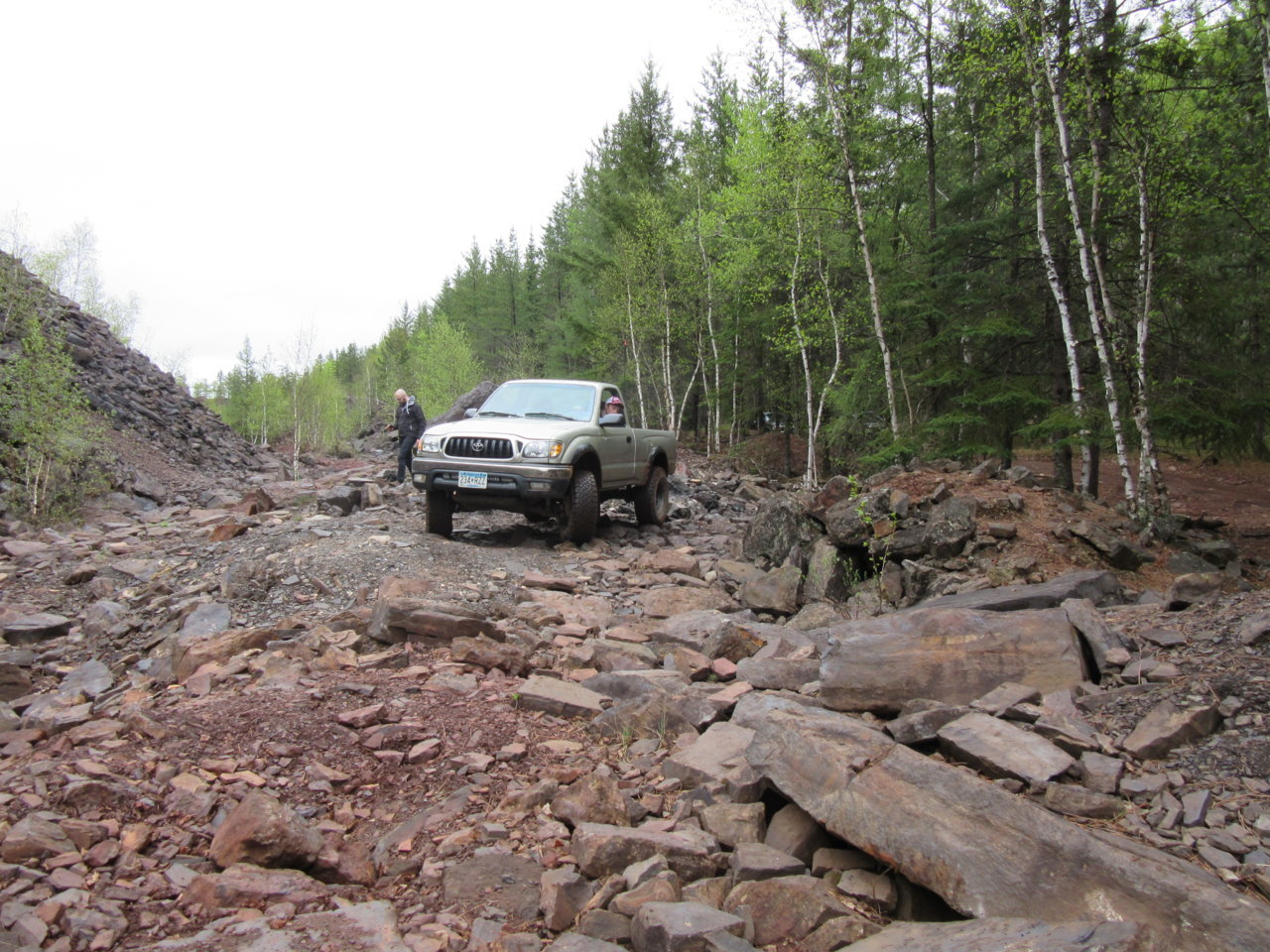

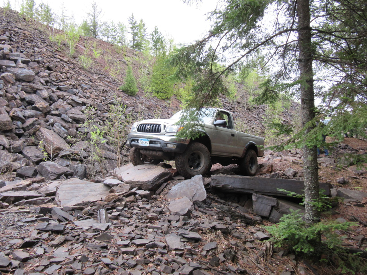

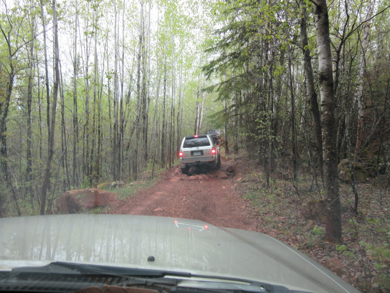

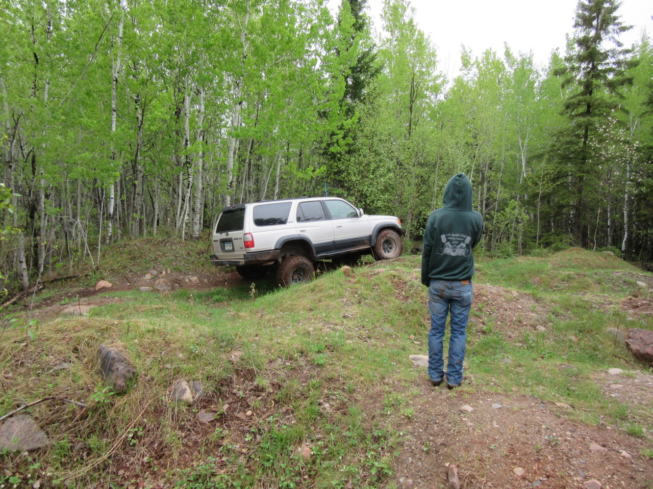

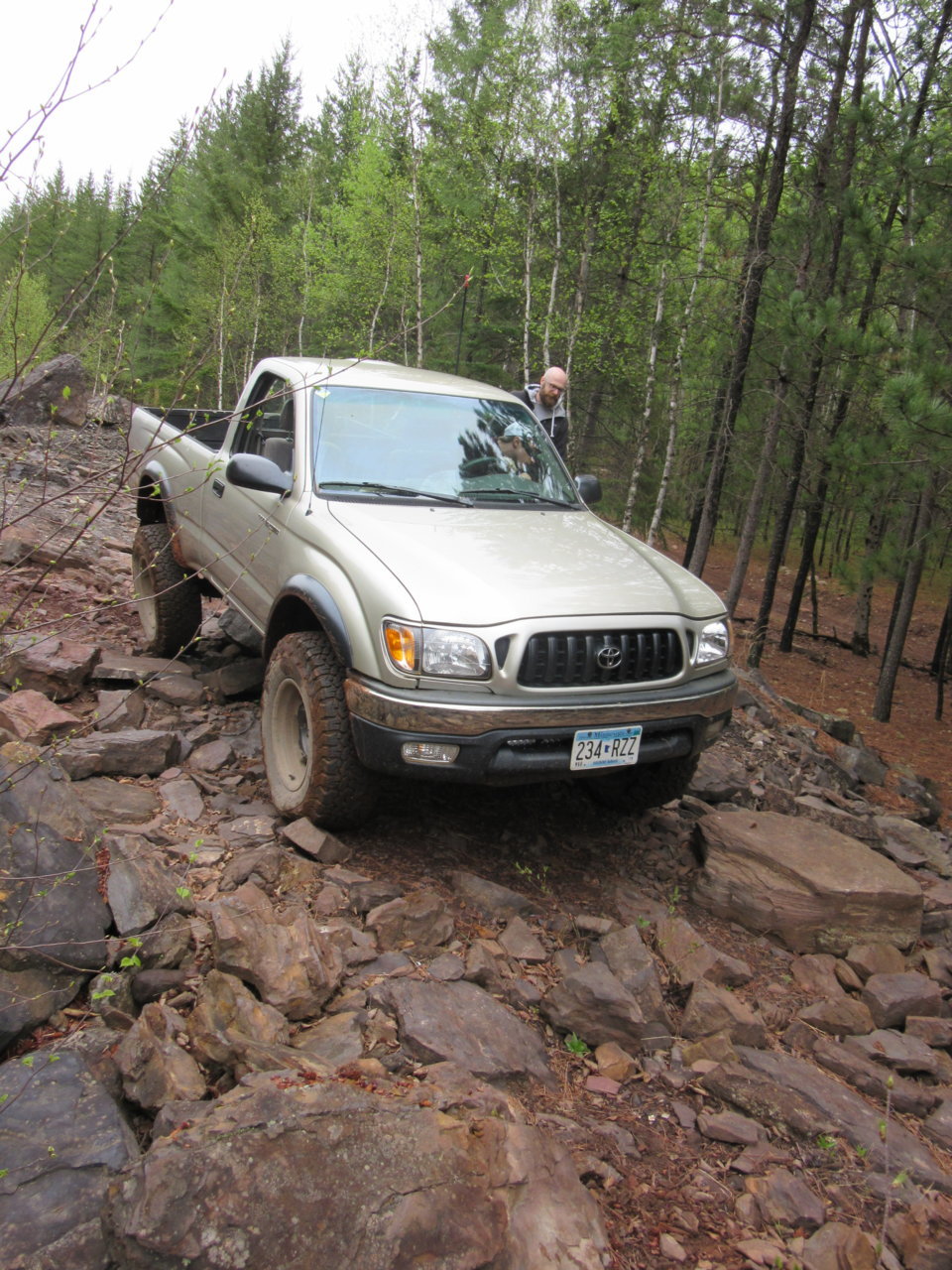

    North Shore Wheelers' Open House - 5/19/2018
    This past weekend I participated in an open house at the Iron Range OHV Area put on by a local group of off-roaders. The group was almost evenly split between Toyotas and Jeeps, including some well-built Tacomas and 4Runners. I was quite jealous of all the supercharged Toyotas! We ended up splitting up along the lines of brand, except for one Jeep that tagged with the Toyotas.
    After some "beginner level" hill climbs and trails, they started sprinkling rock crawls into the mix. I was quite nervous at first, but the guys leading were very good spotters let me through multiple crawls I would have been much too worried to try alone! Much to my own surprise, I didn't kill the truck once the whole day!
    I had an absolute blast and cannot wait to go on more group runs with these guys! There's still a lot left in the park to explore too. At lunch I won the raffle for a shiny new Hi-Lift jack! One of the Tacoma guys showed me how he mounted his jack in the bed, so that's the next project on my list!
    Thank you to all the club members who were there as well as all those who helped spot me the whole day, and teach me the finer points of off-road driving! Also, thank you to all the club members for the Hi-Lift, I'm sure it will see plenty of use! :mudding:

    Looks like a great time. I've never once won a raffle, that's awesome!
    Did you air down the tires at all? We run the same size but your KO2s look beefier than my Falkens.

    I didn't air them down too much, normally I have them at 35psi but at the recommendation of some of the guys I aired down to around 20-23psi. They said that anything less than around 20 was overkill for what we were doing. It was far from an exact science, I just used a gas station tire gauge to air down and measure the pressure

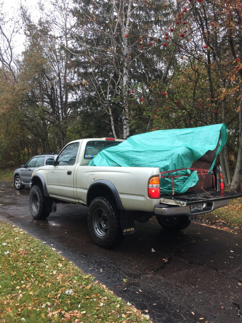

    Not too much has been going on with the 1st gen since the last wheeling trip. Other than serving as my daily driver to work, I took the truck to pick up a 2 ton engine hoist to work on my project car!

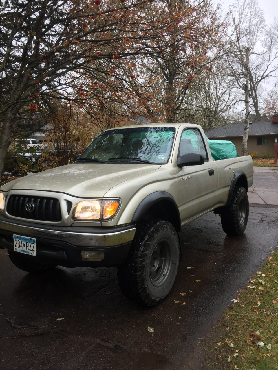

    It's about time for an update. In late October I put my 2nd Gen in storage for the winter and brought my 1st Gen up to college. I wasted no time getting busy moving around some things for our off campus house, such as this couch that we (eventually) found out was too big to fit through our door. Oh well, at least someone at Saver's got a decent couch!

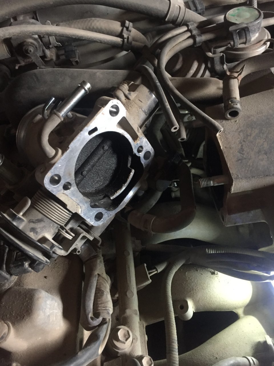

    When the temps started getting below 50 degree I started experiencing an odd idle behavior. When first starting up, the truck idled super low (below 1k) and as the truck warmed up it idled higher and higher, until almost 2k rpms. It was very odd and the opposite of what should be going on.
    I ended up taking the throttle body off and cleaning it as well as the IAC (Intake Air Control) Valve that lies just below. As it turns out this valve was stuck open, allowing excess air to get past the throttle body. After a generous cleaning it seemed to work again, and a short test drive confirmed the fix!

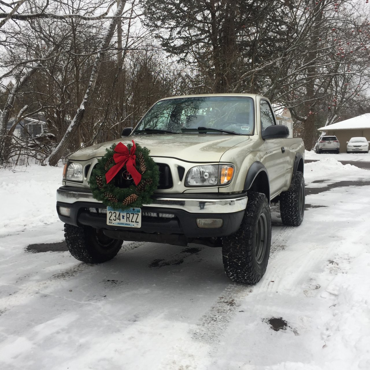

    Since I was without a bed outlet this year to power my Christmas lights in the bed, I decided to go a different route. I grabbed a wire-backed wreath and added some pine-cones and a bow. I also picked up some 1" diameter foam pipe insulation and hot glued it to the back of the wreath to prevent and paint damage. Then a few zip ties through the grille and I was festive again!

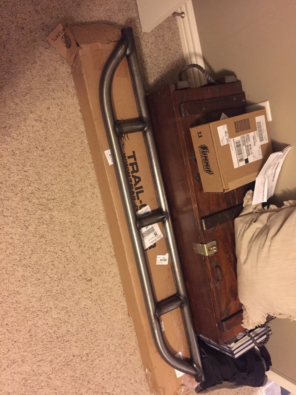

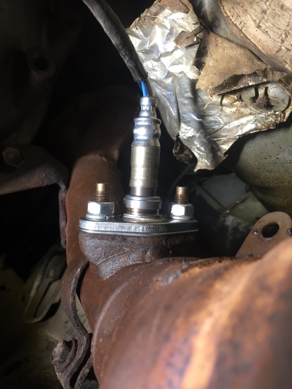

    Over Christmas break I got to open up my Trail Gear sliders that I ordered on Black Friday. I won't put them on until summer though so I can paint them.

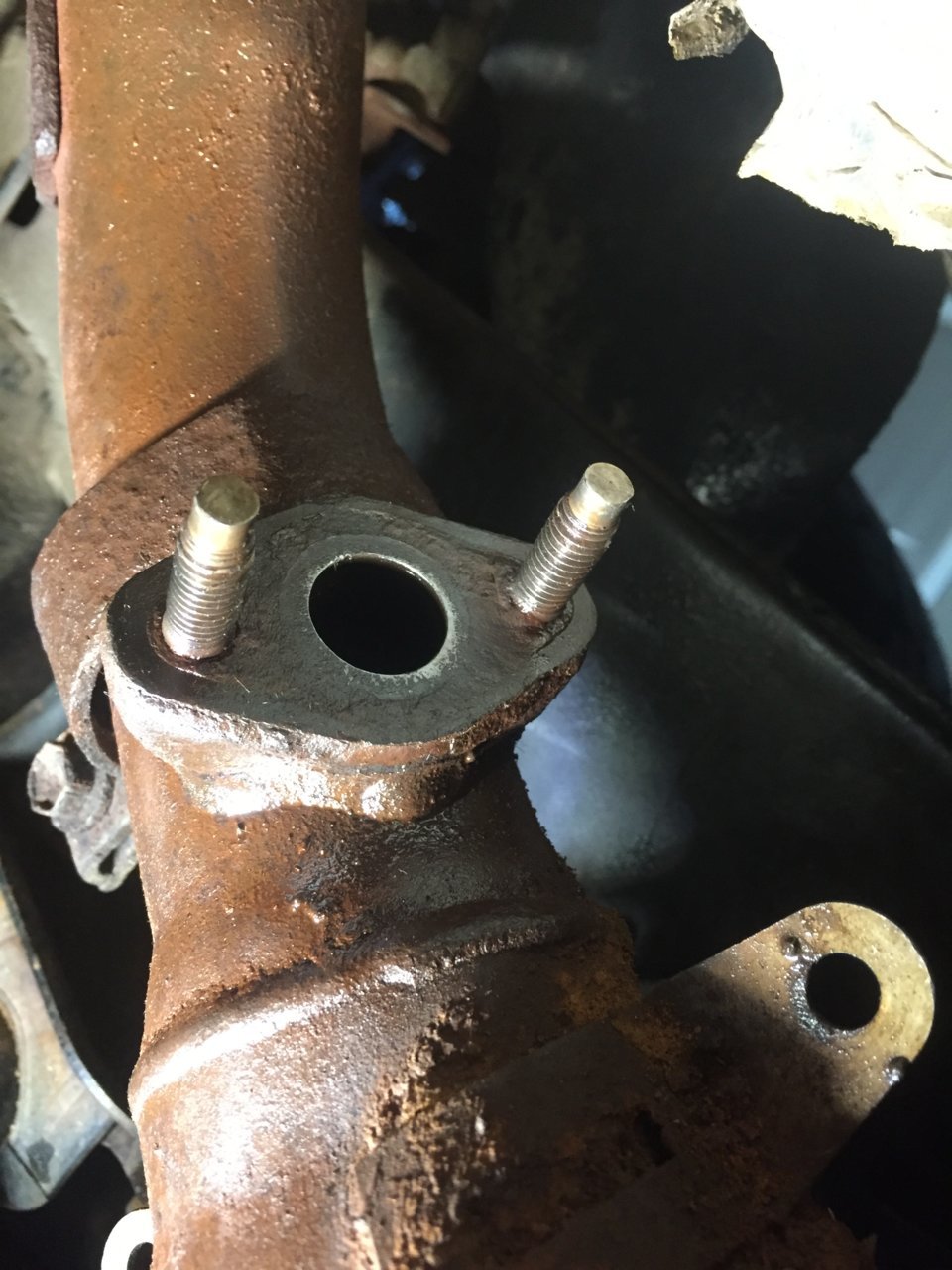

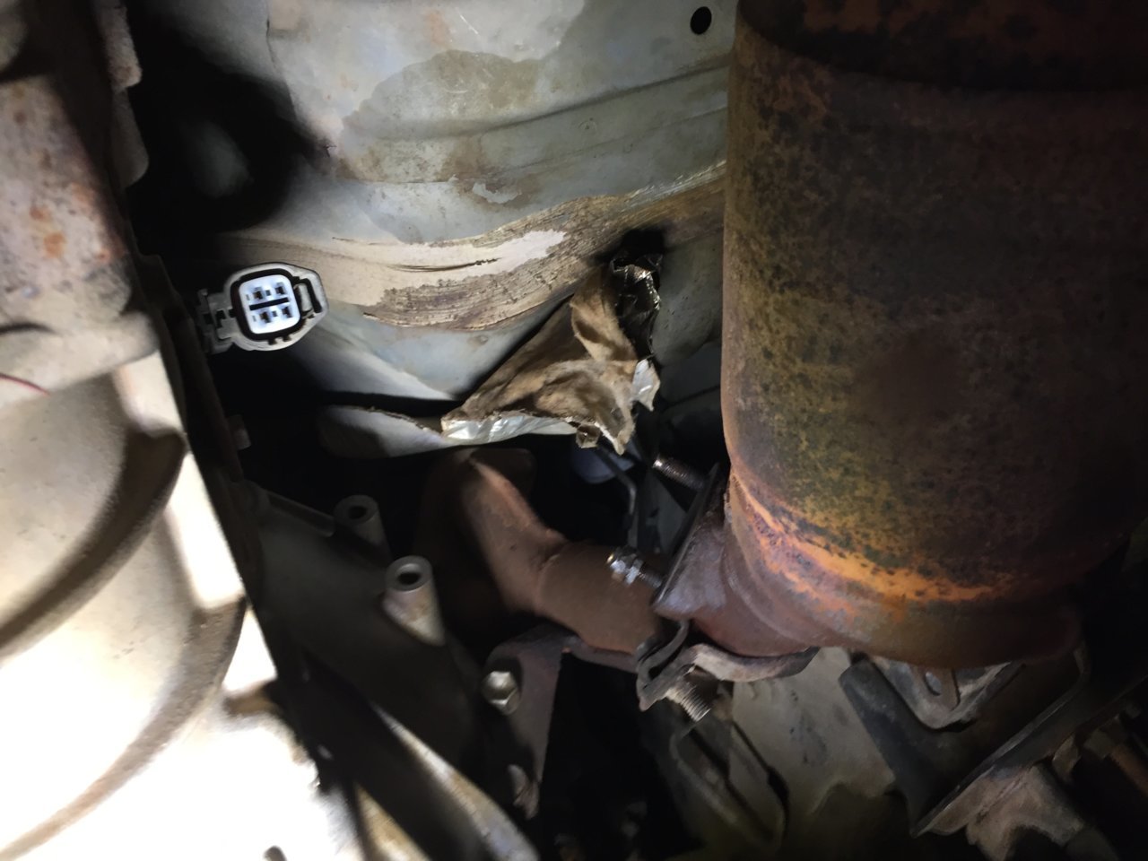

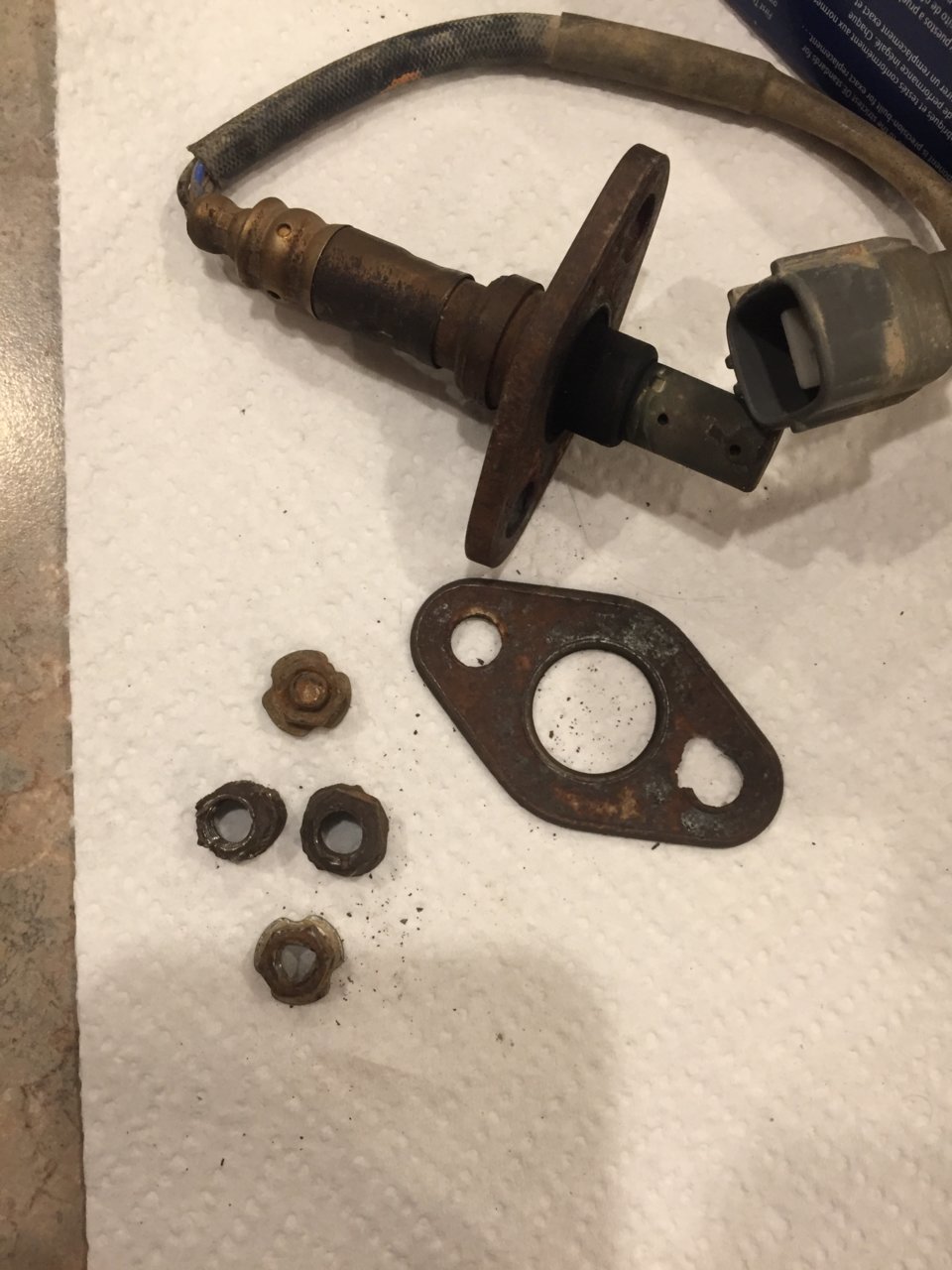

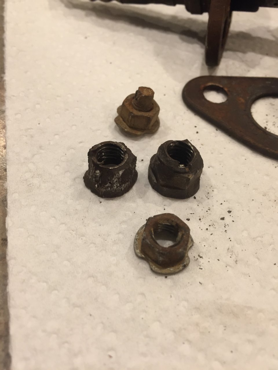

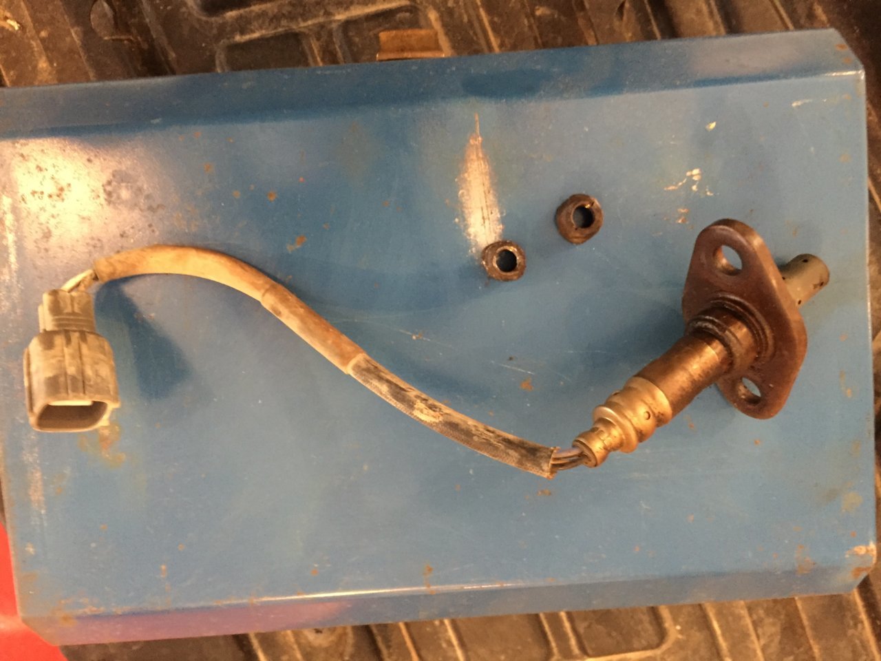

    I also addressed the engine code for P1135, the upstream O2 sensor. One of the nuts holding the old sensor on was incredibly corroded and I had to resort to a vise grips and a lot of PB Blaster to get them off.
    I used stainless steel hardware this time around so hopefully I won't have so much trouble if I every do this again.

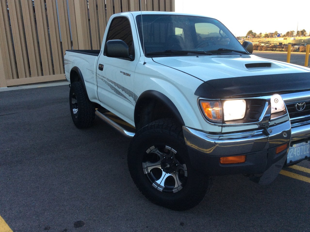

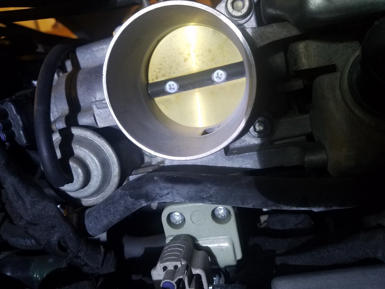

    Wow that’s a lot of carbon buildup,
    It should look like this
