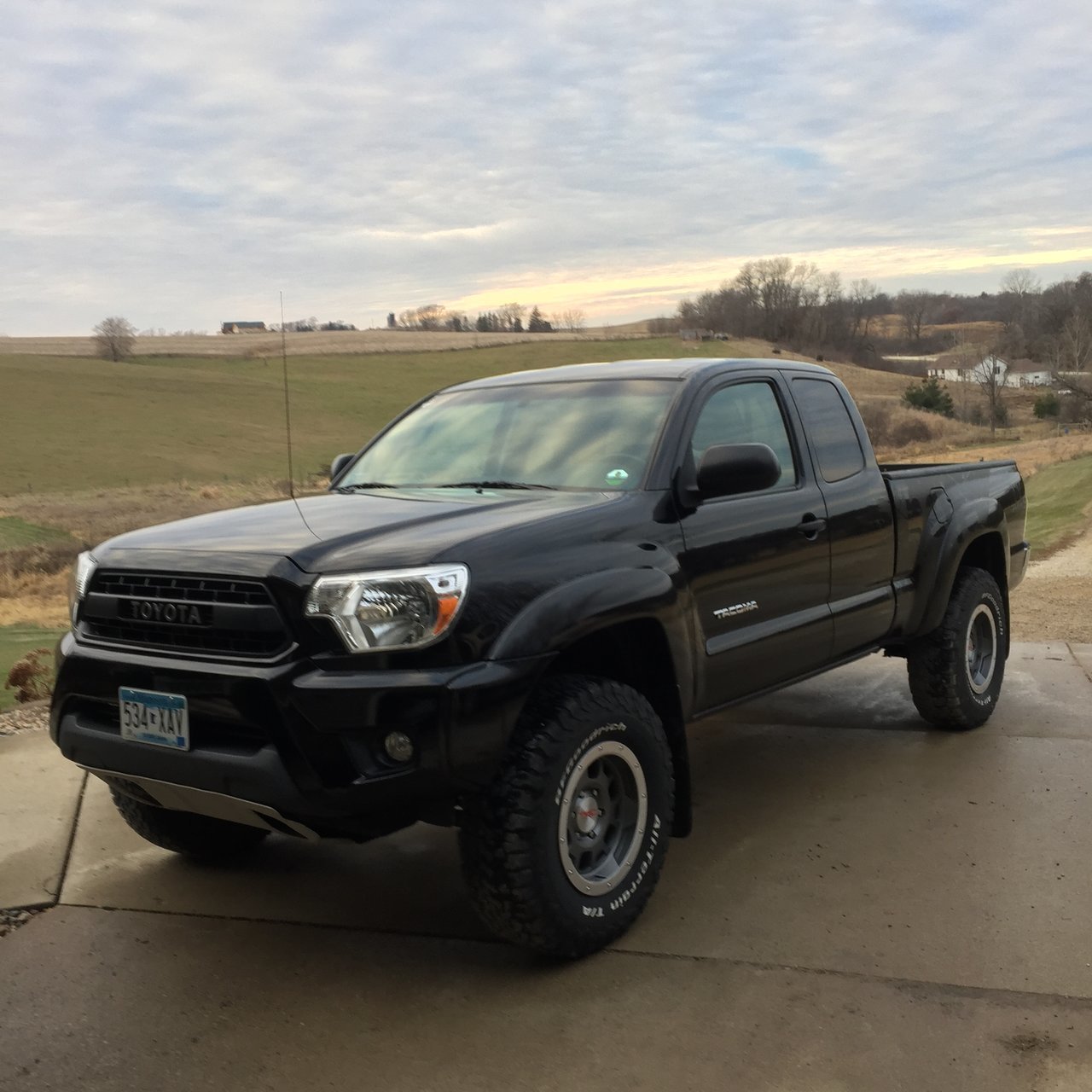

    This summer I upgraded from my 2002 Tacoma regular cab base model to a 2013 Access Cab Baja T/X 6MT. Needless to say, going from power nothing to power everything is quite a change! When I picked her up, she only had 30k miles on her, which means I should be able to keep her around for many, many years (My 2002 has 260k). I still have my regular cab, but since I am in college right now, there isn't a whole lot I can do with it. Throughout the thread, many of the pictures you see will have been taken by my roommate/best friend from high school. He is an aspiring photographer and takes phenomenal pictures!
    Current Mileage: 40,000
    Current Picture (4/18):
    12/17:
    9/17:
    Here's the earliest picture I have from the original ad:

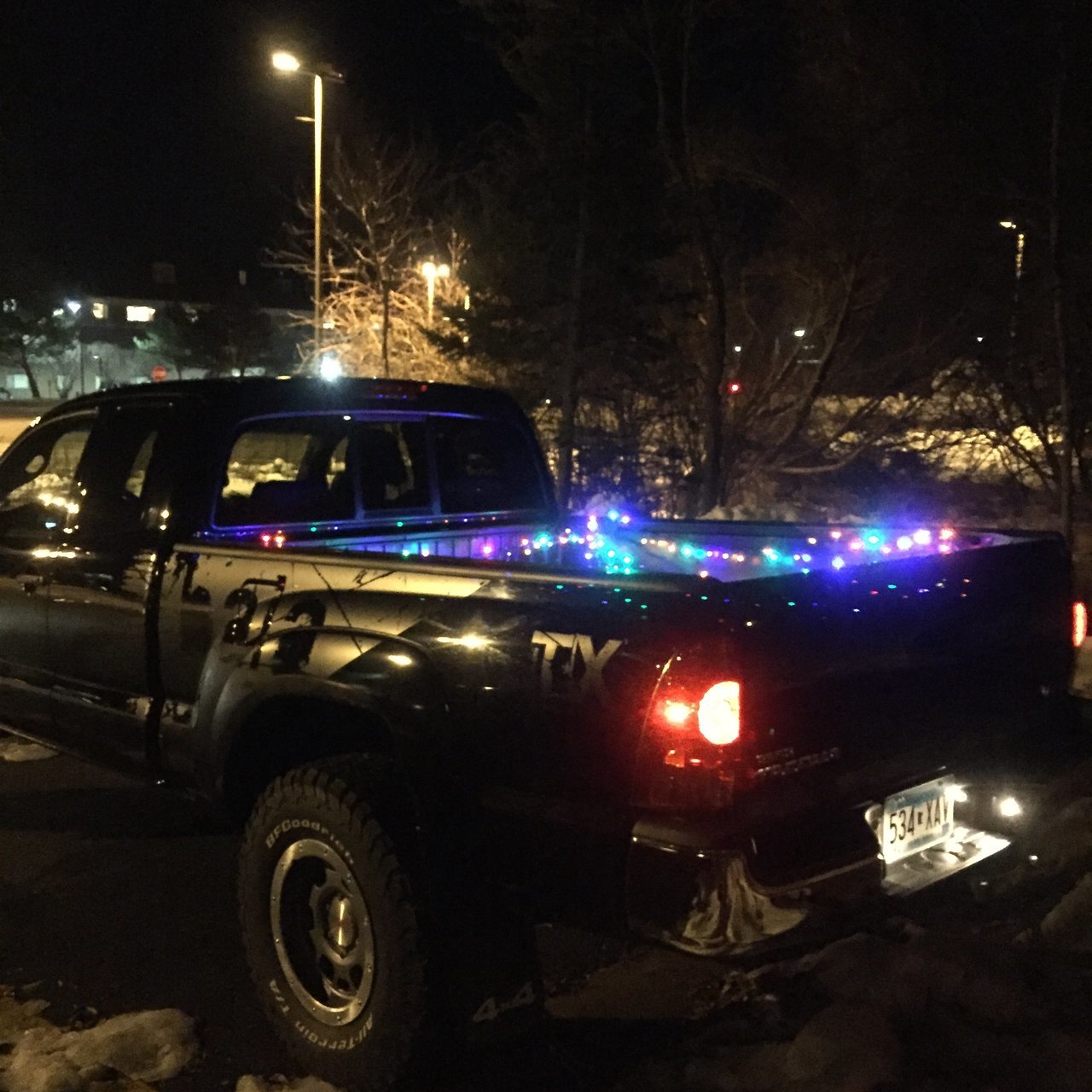

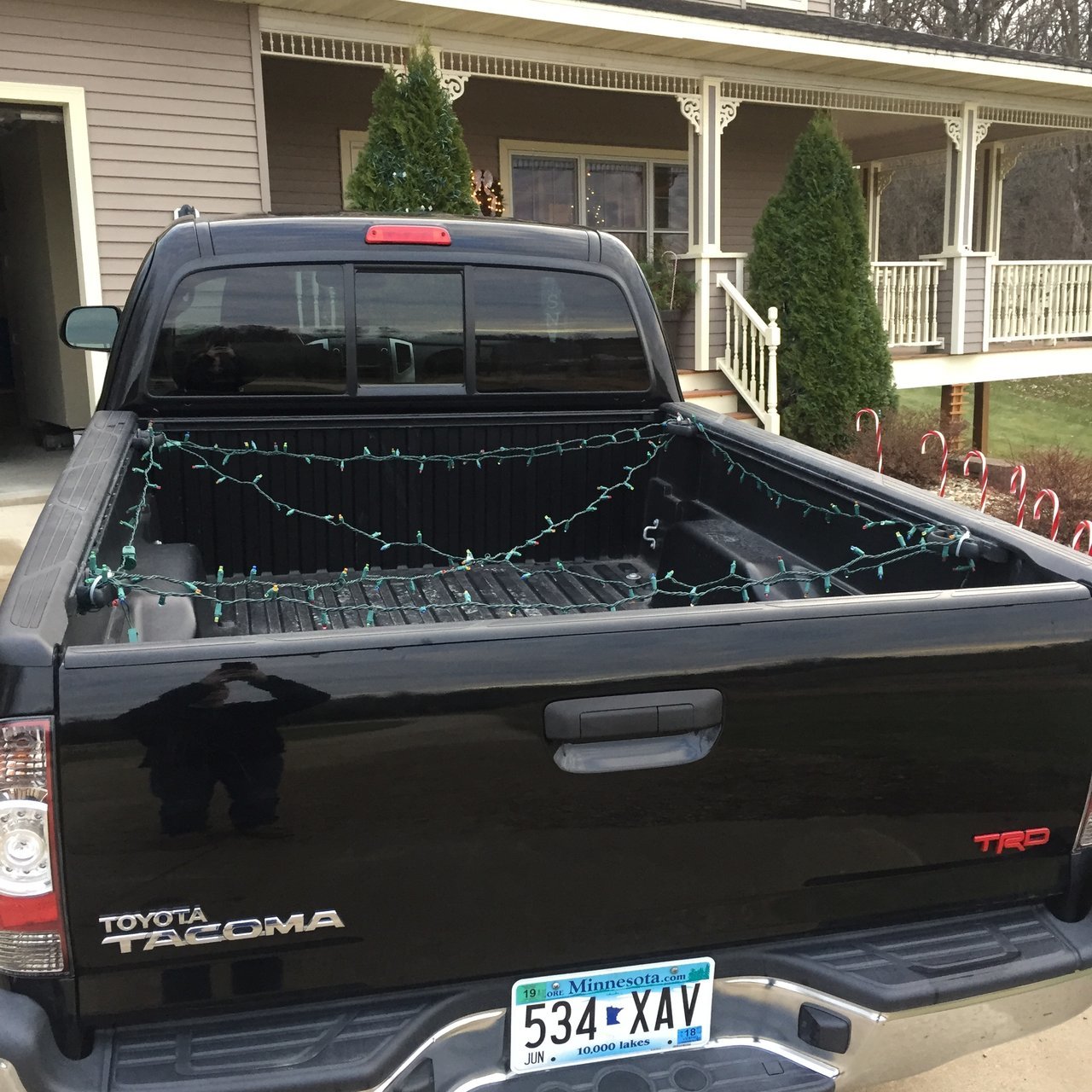

    The lastest "mod" I did was quite simple, I just put Christmas lights in the bed to spread some holiday cheer! I ended up using three strips of 12 ft multicolored lights, which I secured to the tie down points with zip ties. So far they have held up wonderfully, even when doing 75 on the interstate! At night they give the bed a nice glow too. I'm not sure how the police feel about Christmas lights on vehicles, but whenever I see a cop I just switch off the power to bed.
    Hopefully over Christmas break I will have time to complete some more mods! My wish list keeps growing and growing the more I read in the 2nd Gen section of Tacomaworld:rofl:

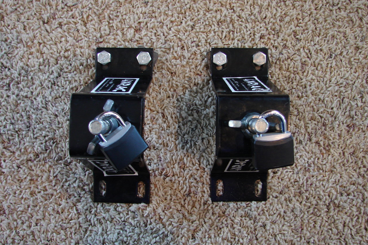

    Later on, I picked up some small keyed-alike locks for a bit of security and theft-deterant when the jack is mounted to the bed-side
    And here it is all mounted!

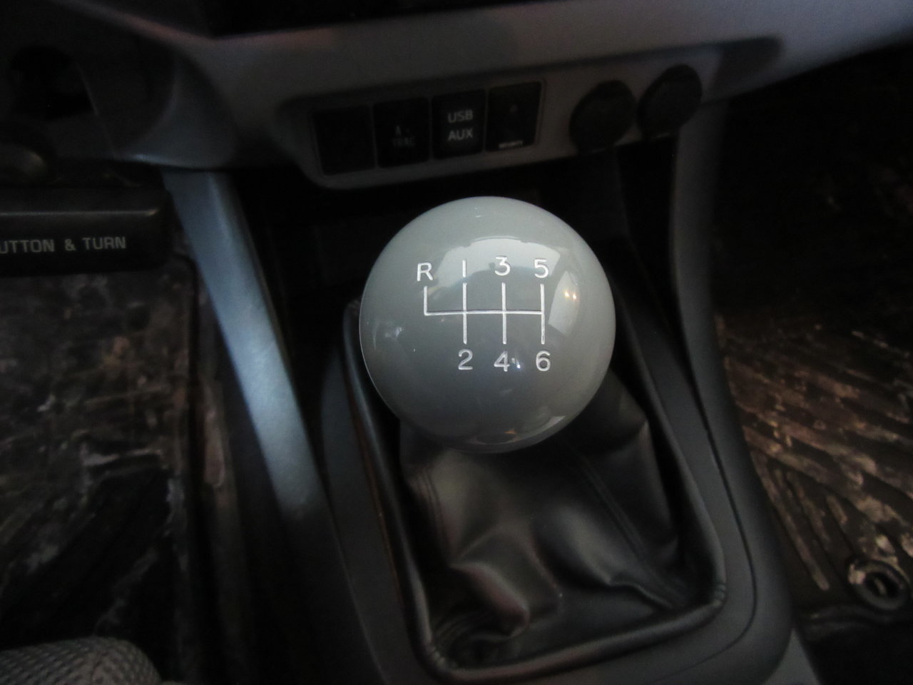

    For Christmas, I received the TRD 6 Speed Shift Knob. It feels so much better than the stock leather, and the "cue-ball" shape fits my hand much nicer. I would highly recommend this upgrade for any 6 speed owners. I do have the OEM Quick-Shifter from the factory, so sometimes I forget that I'm driving a truck and not a sports car!

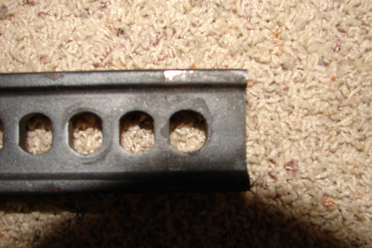

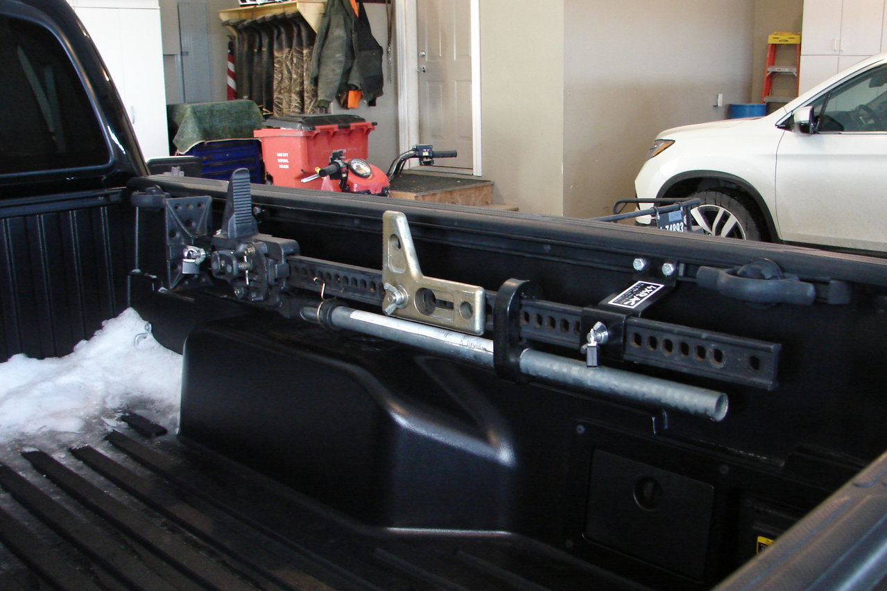

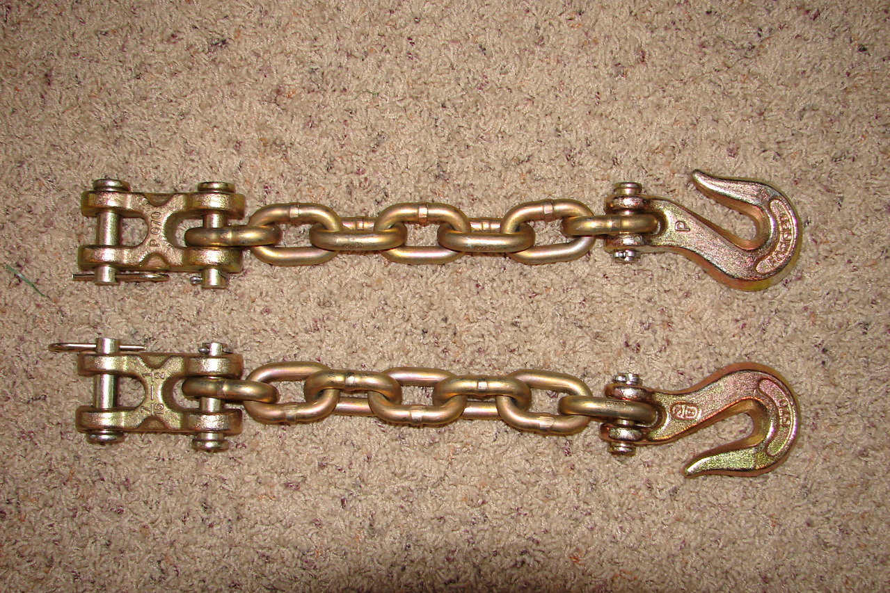

    Later over break, I decided to piece together some parts so I would be able to use my newly acquired Hi-Lift as a winch. Hi-Lift does make an Off-Road Kit, but I was not interested in paying $70-$90 for parts I could easily find at Fleet Farm. All I needed for this project was two winch tensioners, a tow chain (which isn't included in the ORK anyway), a tree saver, and a tow strap (that I already had for recovery purposes).
    This is the website where I got the idea from, it does a good job showing how to use the jack as a winch as well: http://www.j8g.co.uk/landy/hilift/winch.php
    I was able to find a cheap 6600 lb. tree saver at Harbor Freight. I then went to Fleet Farm to purchase a 14' 3/8" tow chain (5400 lbs.), and two lengths of 3/8" chain for the tensioners (7 links, or a half foot each). I used two clevises to attach the chains to the Hi-Lift, and two 3/8" hooks on the end of the tensioners for connecting to the tow chain. I also picked up some cotter pins for quick attachment and detachment to/from the Hi-Lift. After I assembled the two tensioners, this is what they looked like:
    In order for the clevis to attach to the bottom of the Hi-Lift where the base normally goes, I uses a dremel to slightly round the bottom-most hole of the jack. It's very difficult to capture with a camera, but if you look closely you can see where it was rounded.
    After both tensioners are attached, this is what the setup looked like:
    All in all, this was a very easy project, and costed far less than buying the Off-Road Kit. Hopefully using the Hi-Lift as a winch will let me explore more remote areas without having to buy a full blown electric winch yet (although eventually I plan to get one.)

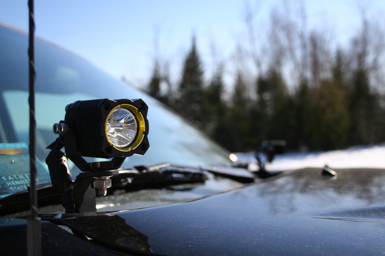

    It's taken awhile for me to get pictures, but I picked up some KC HiLites Flex LED lights (flood pattern) for use as ditch lights on the Tacomaworld Marketplace. They came with Relentless Fabrications Ditch Light Brackets, but I have since ordered CBI Off-Road Brackets to replace them. Nothing wrong with the Relentless ones, but I would prefer to have the lights sit farther away from the center of the truck as well as not run brackets that utilize the hood bolts.
    Pictured are the lights on the Relentless Fab Brackets. In my opinion, the KC Flex lights are perfect for use as ditch lights. Even with the Relentless Brackets, they obstruct a minimal amount of vision from the driver's seat, yet throw out plenty of light. I can imagine with the CBI Brackets they will be even less of an obstruction. Also, they are made of metal instead of plastic, which is plus for me in terms of durability.
    Not to mention they look sweet! They are a nice departure from the well-known design of LED pods and light bars. Some passengers even think that they are cameras at first! :rofl:

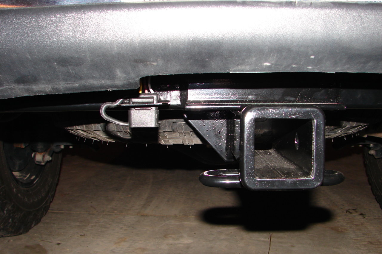

    Next up I FINALLY got around to installing the Class III Curt Trailer Hitch that I've had sitting around since October-ish. Sure felt good to get that off my plate! The install was fairly straightforward, nothing too complicated and the directions included were pretty clear. I also picked up and "L" shaped bracket for holding on the the 4-Flat wiring harness. I made sure to position it so it would not hang down and potentially break off. It definitely looks a lot better than leaving the wires wrapped around the hitch like a lot of truck owners do around here!

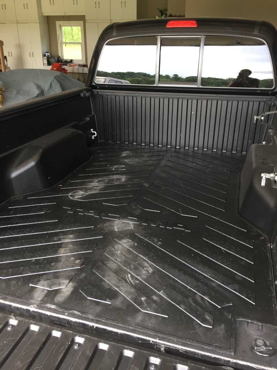

    I ordered and installed an OEM Bed Mat. After testing out how grippy it is, I can't believe I waited this long to order one! Not only will it help protect my bed, it will keep smaller items from shifting around in the back as well.

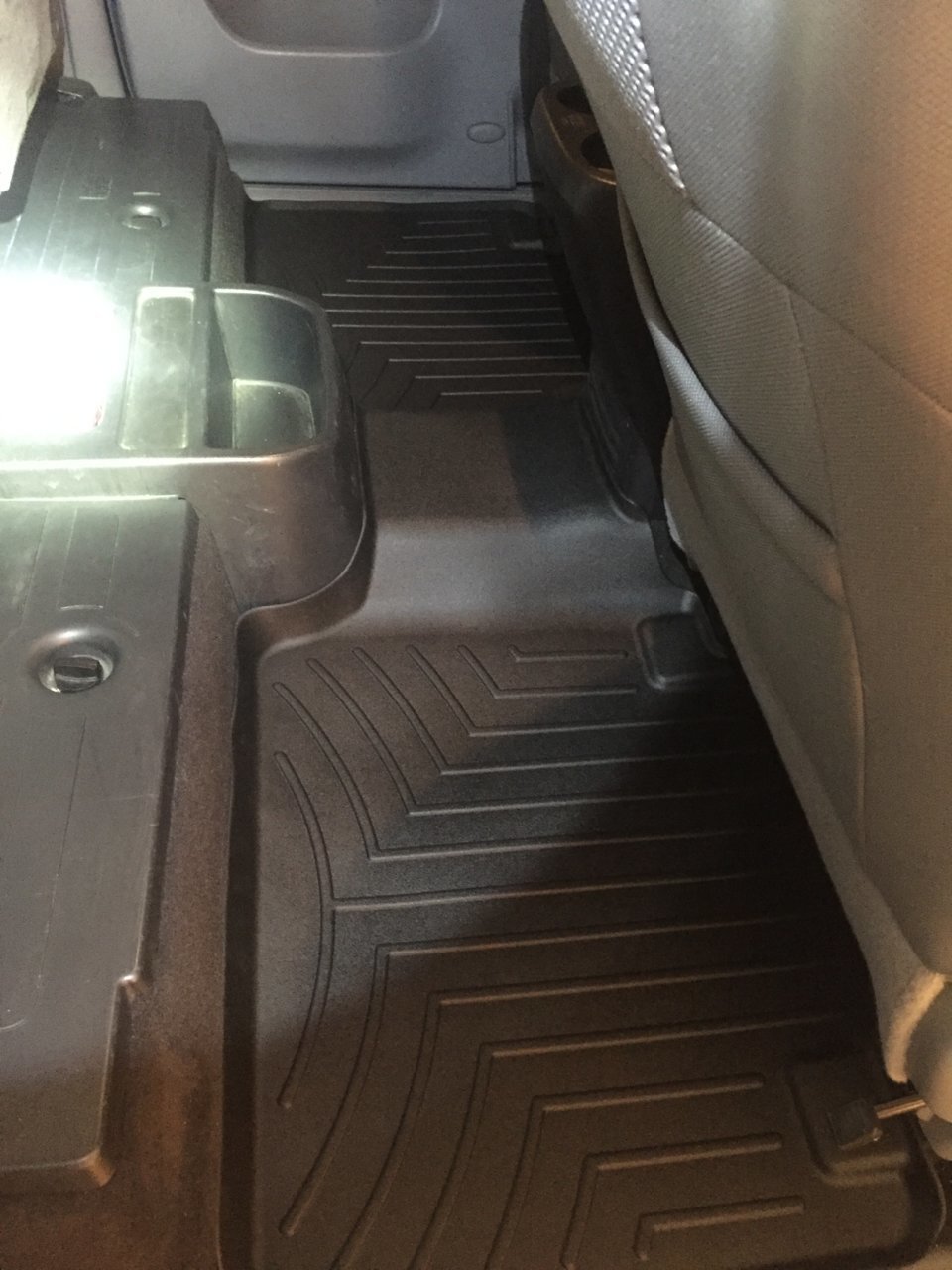

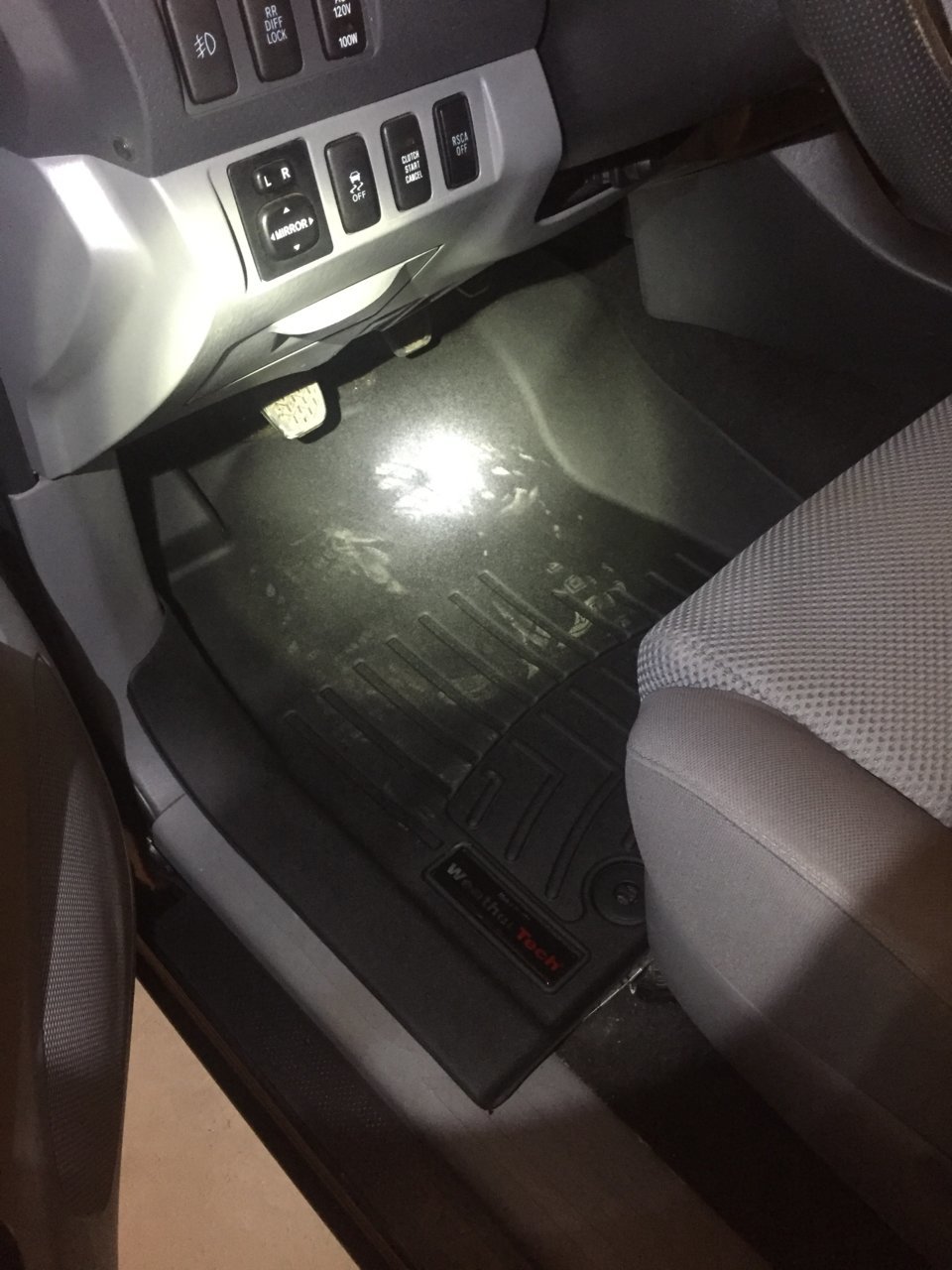

    I ordered some WeatherTech Floor Liners recently, and I opted for a first and second row set in preparation for hunting season. I have heard pros and cons to both WeatherTech and Husky Liners, but I am very happy with how the WeatherTech's fit and with their coverage. Only time will tell how well they will hold up!
