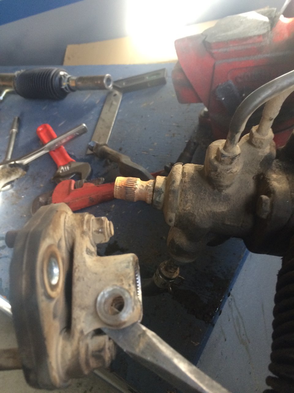

    I forgot about this little bitch. It was rusted on so bad I had to pull out my propane torch to heat it up to get it off. A little tip if yours is a pain.

    Now I know where to go when I need to replace mine :hattip:

    Oh I guarantee mine will be a PITA. Thanks for the heads up
