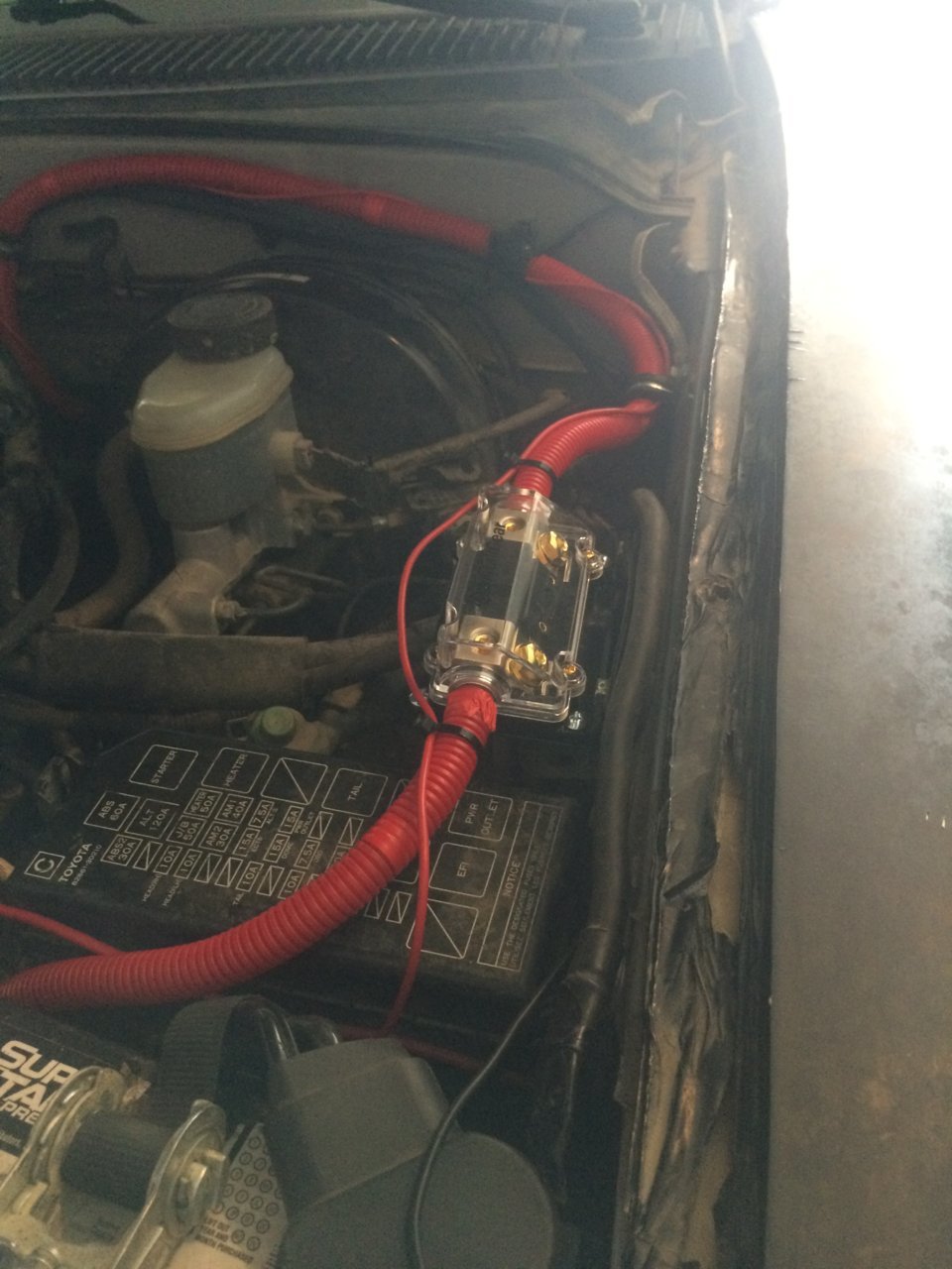

    is that a fuse?

    Yes sir. 90A fuse.

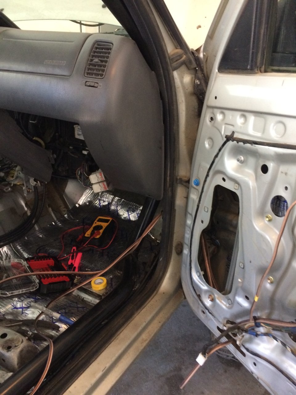

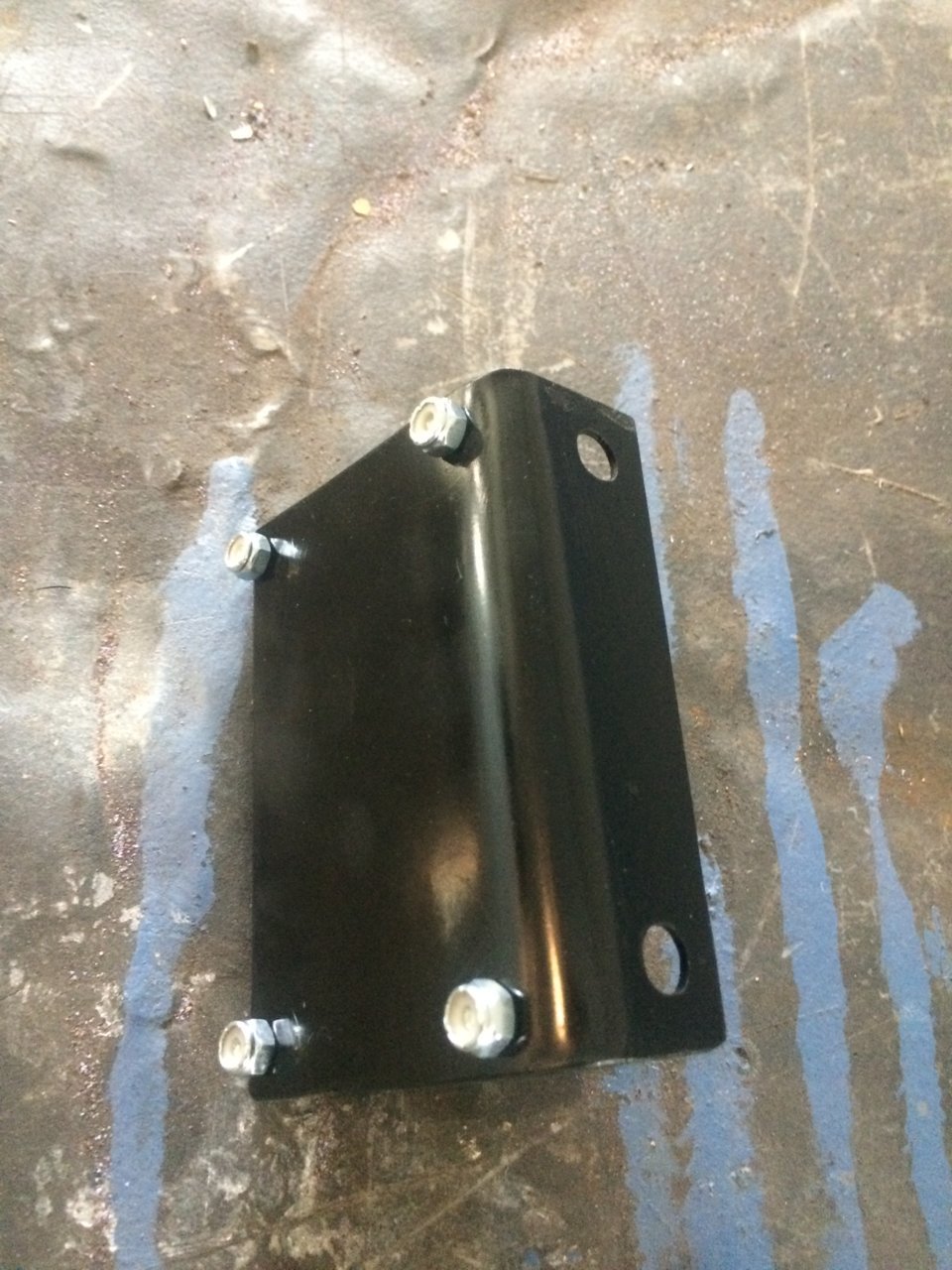

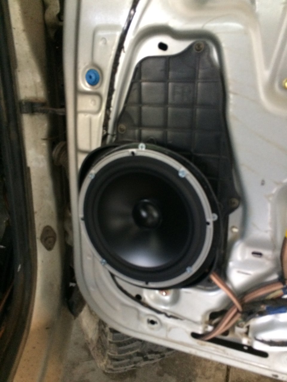

    Working on the audio stuff until I get the new power steering pump.

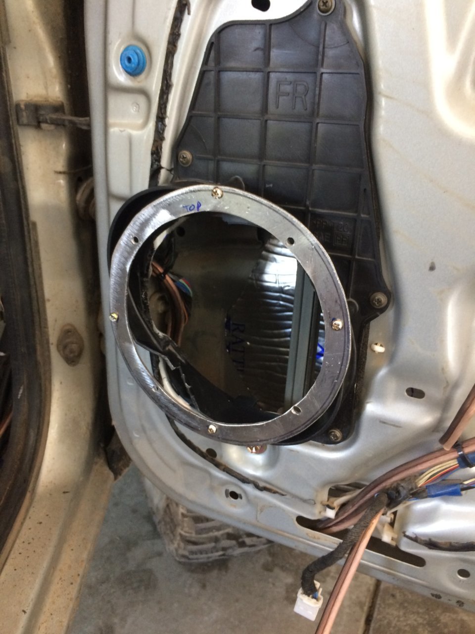

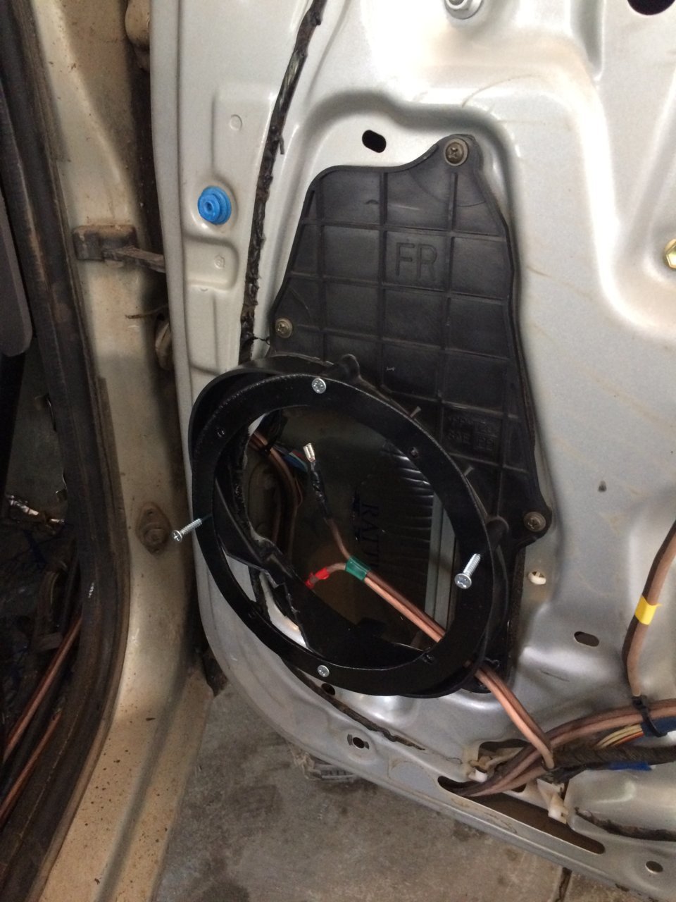

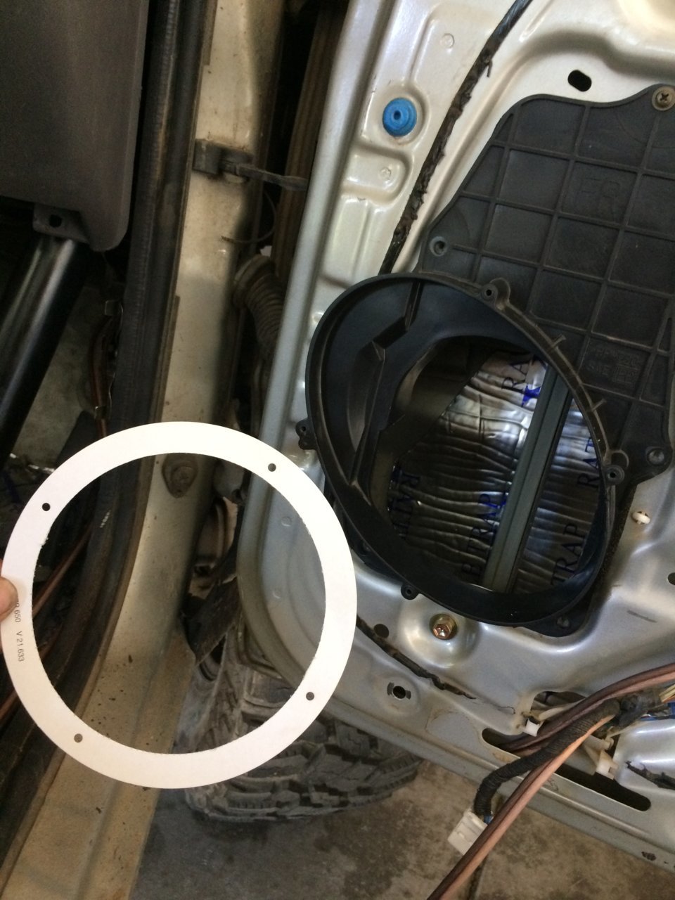

    I'm running all new wiring for the audio. 12g for all the speakers. I'll be running the speakers without the crossover and run the twitters live off the amp because everything is going to be controlled off the DSP. Well at least that's how car toys told me to set it up. They will be the ones to tune everything for me and make sure nothing gets over powered.

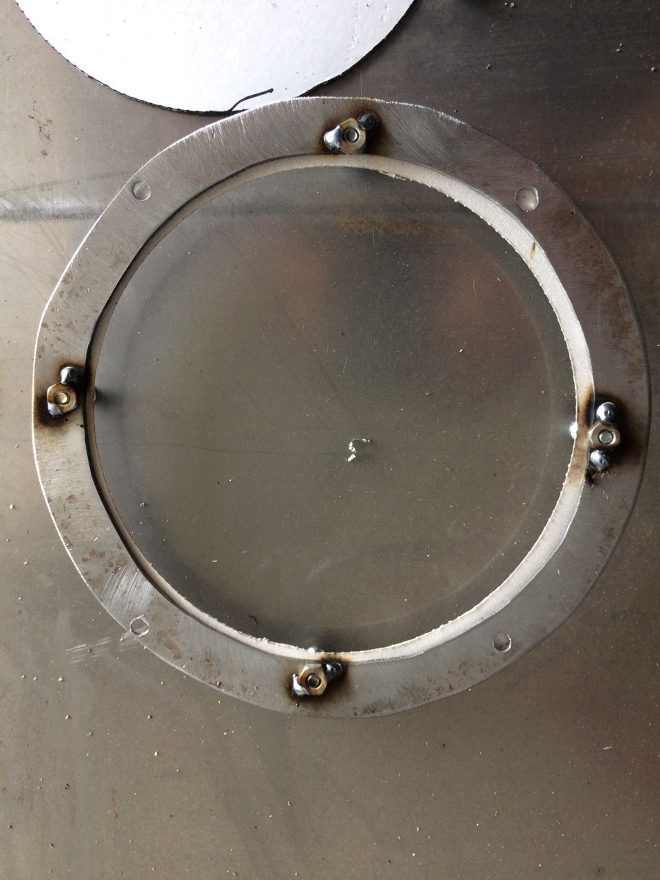

    To get the new JL speakers to fit I had to fab up a new mounts. I ended up cutting some steel into a circle and drilled a bunch of holes. I went and got some longer screws because I didn't trust the stock ones to hold this heavy ass speaker. I tac welded some nuts behind the metal circle so I can just screw the speaker on and not worry about it coming loose. Every this seems solid and hopefully jump proof.

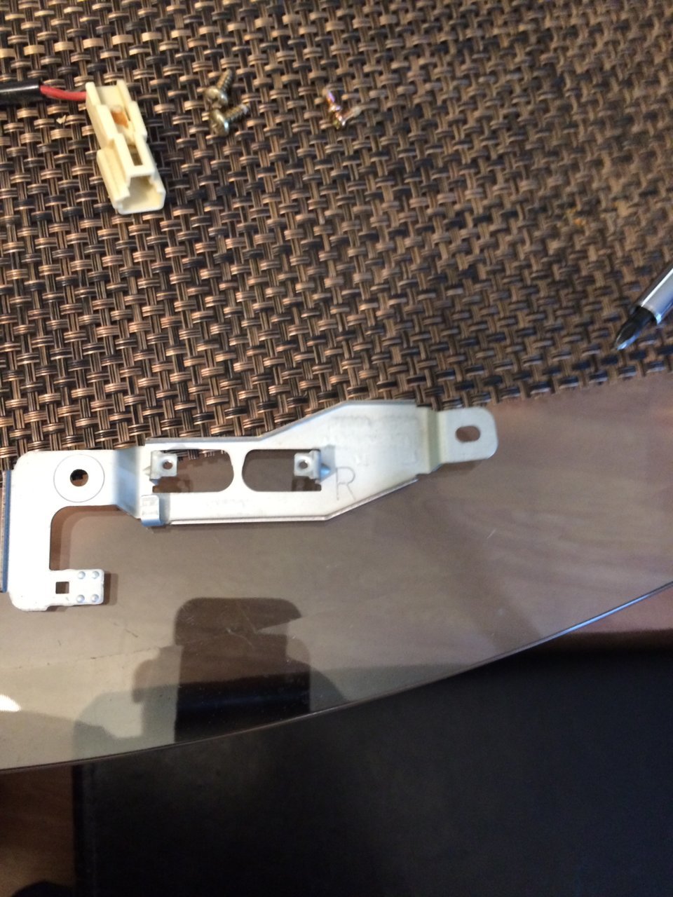

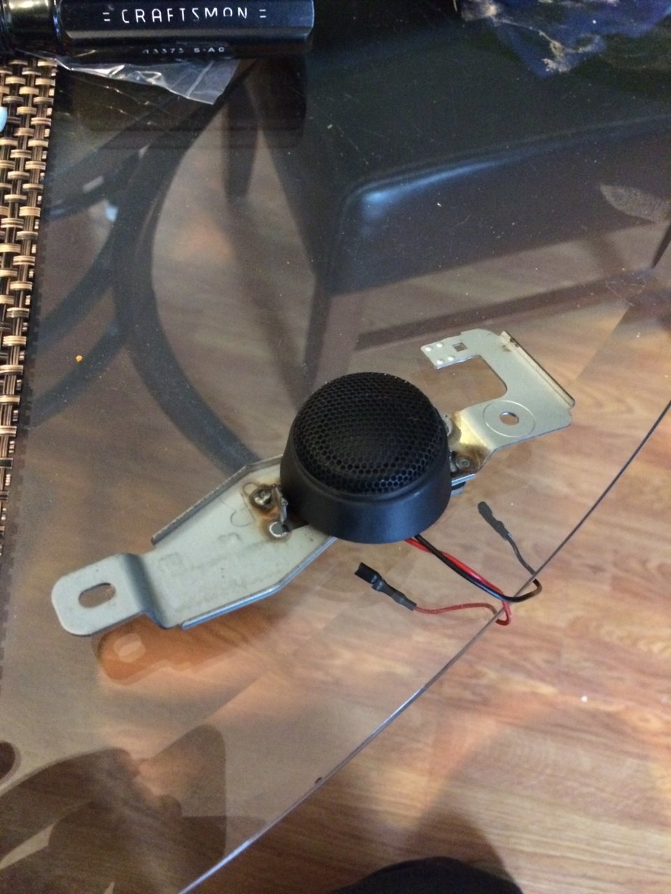

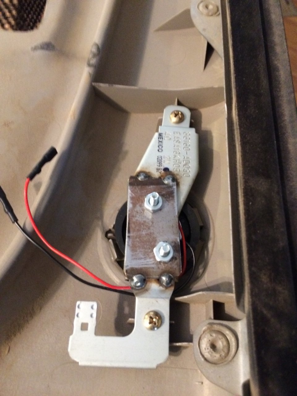

    Got the tweeter mounted up. I reused the factory mount. I cut off the screw holders for the factory speaker. Welded on a small plate on the back side and drilled two holes for the tweeter mounts to bolt on. Fits pretty good. Kept it simple. I just need to cut the bolts flush to the nut.

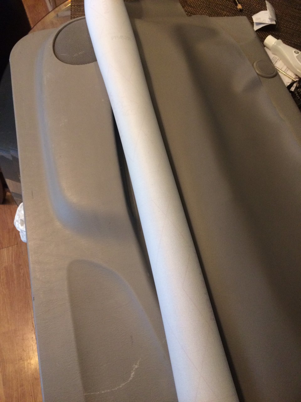

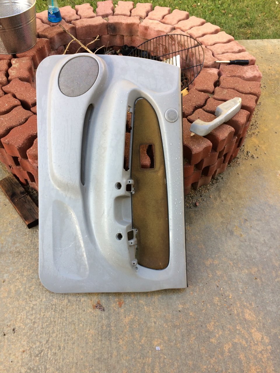

    Might as well give it a good scrubbing since it’s stripped down. Now the million dollar question. Should I go with the black vinyl I used for the headliner or use a dark grey to replace the old fabric on the door.
    Edit: maybe just match the original color but vinyl.

    Dark grey for the doors would look nice

    No one had dark grey so I ended up calling PRP Seats and asked if they would sell me some vinyl that was used for the seats. They said yes. 2 yards of the grey that is in my seats is on it's way. Wish I would of knew about it sooner. I would of used it for the headliner.

    The headliner is smashed between the cage and roof so I would have to cut the headliner all out. It does feel dark in the truck with the black headliner but for now I’ll run with it. Since I’m getting a new vinyl floor I think I’ll go with the grey instead of the black to lighten it up inside. I don’t know. I’m so undecided :p

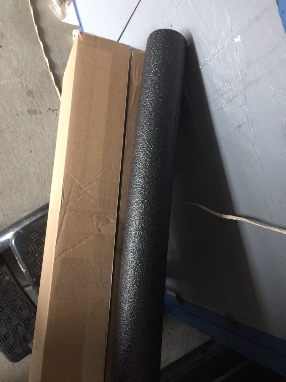

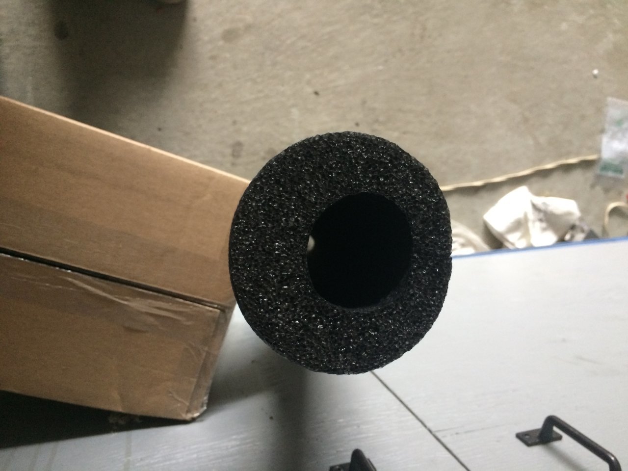

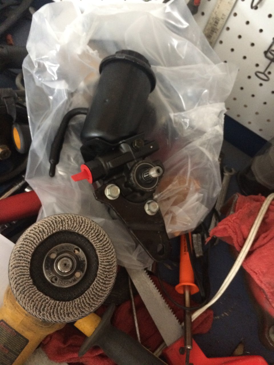

    More stuff showed up. Vinyl for the doors and back of the cab. New Toyota power steering pump and foam for the cage. Going to be a busy weekend.
