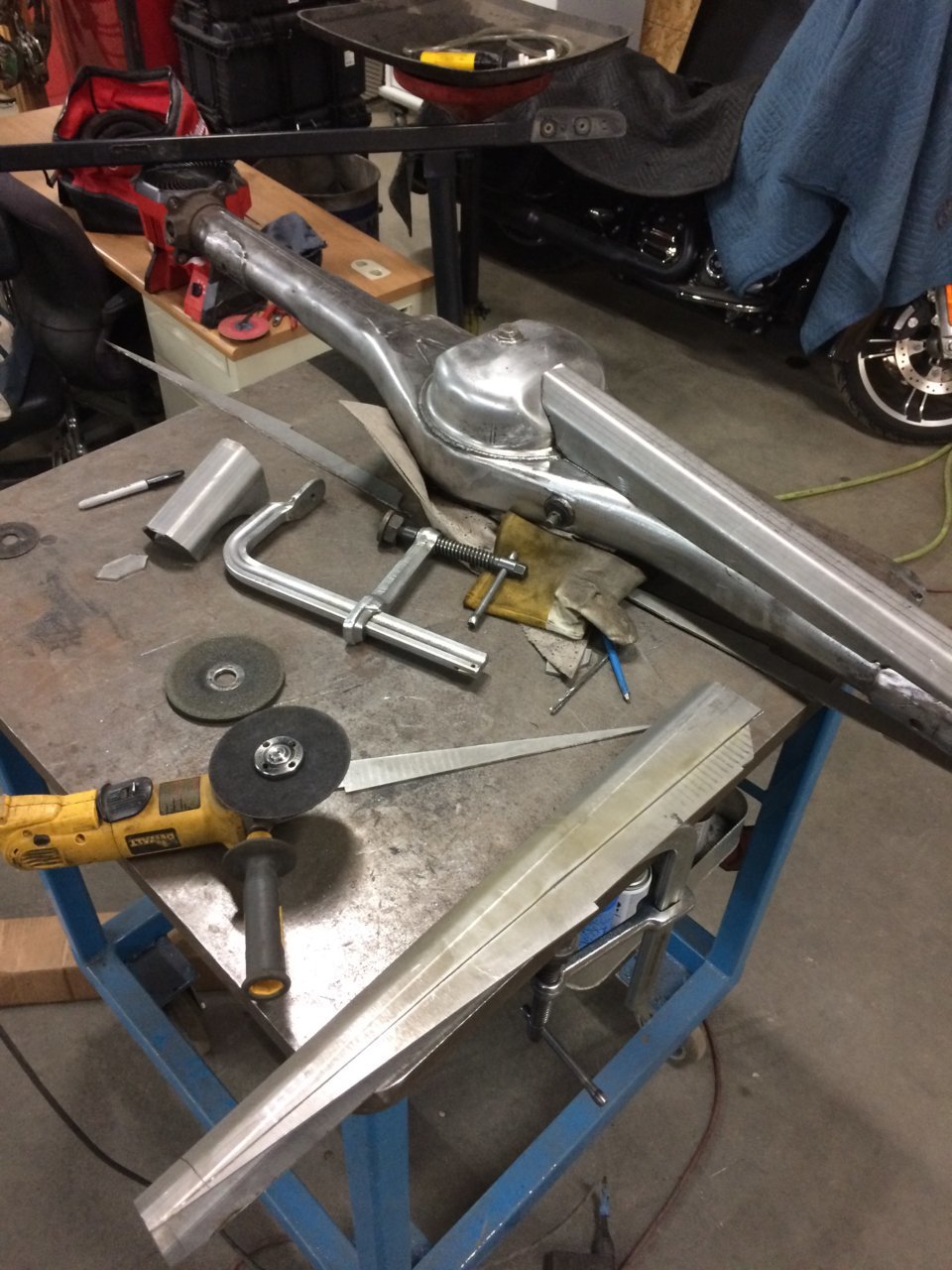

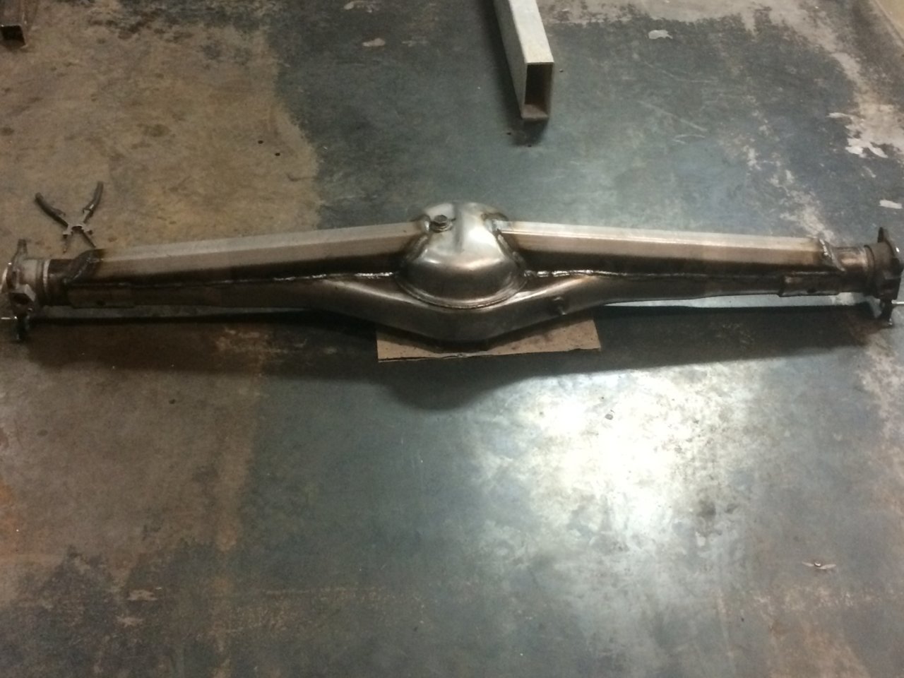

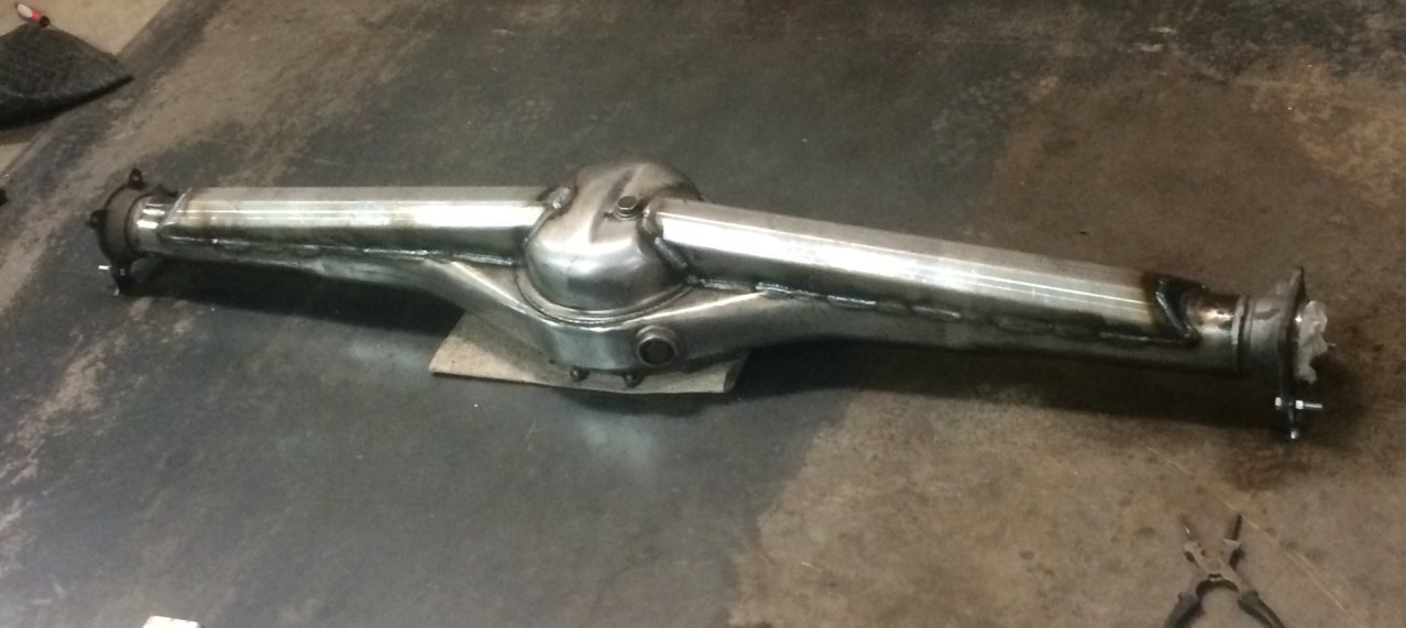

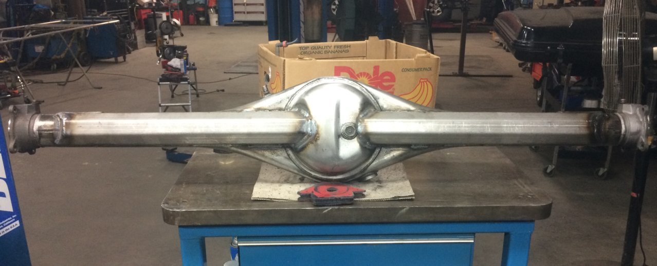

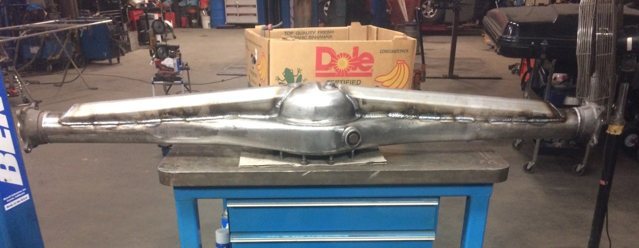

    Got some things done.

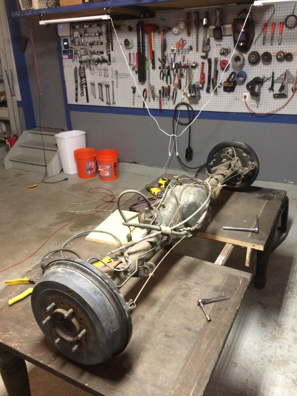

    Stripped and cleaned the tundra axle housing.
    Ordered the ruff stuff 9" truss and cut it up to fit the tundra housing.
    Used Corey's Plate as a fixture to hold the axle housing straight.
    Corey did weld the truss for me and it was still straight when I removed it from the plate. the bolts where real easy to pull out of the mounts I made. I will be adding some thicker plate to the back of the housing to beef it up since they are so thin.

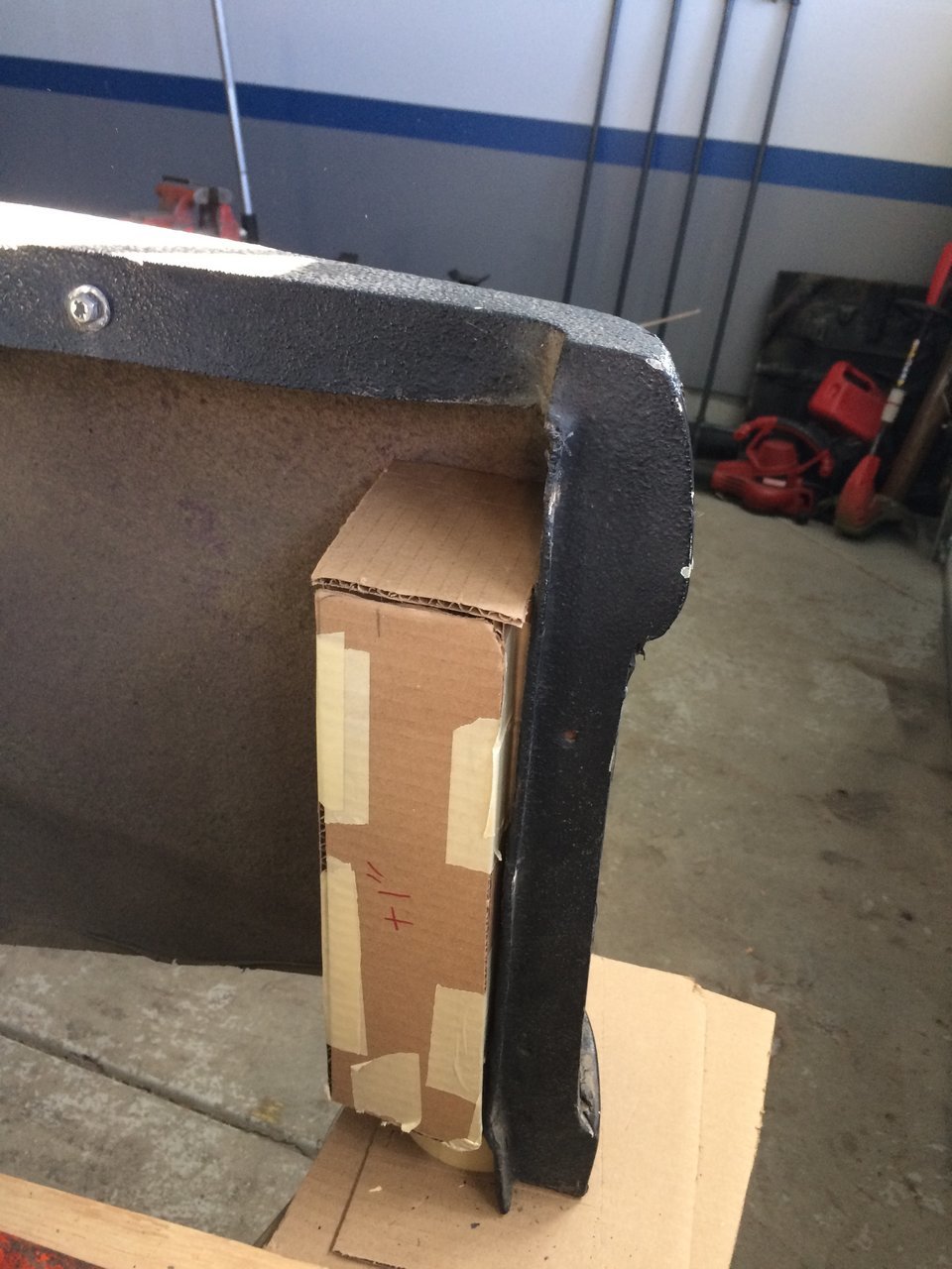

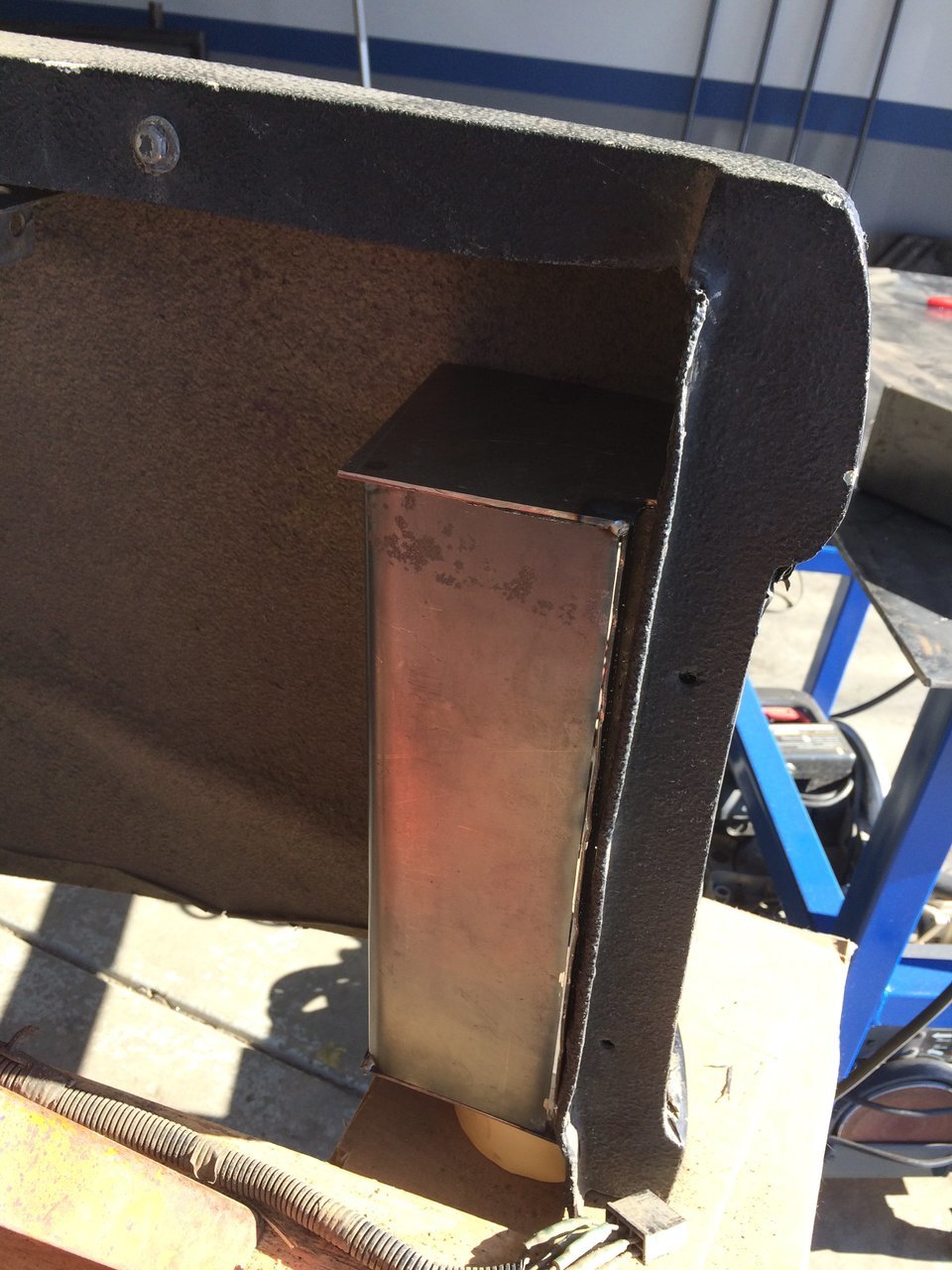

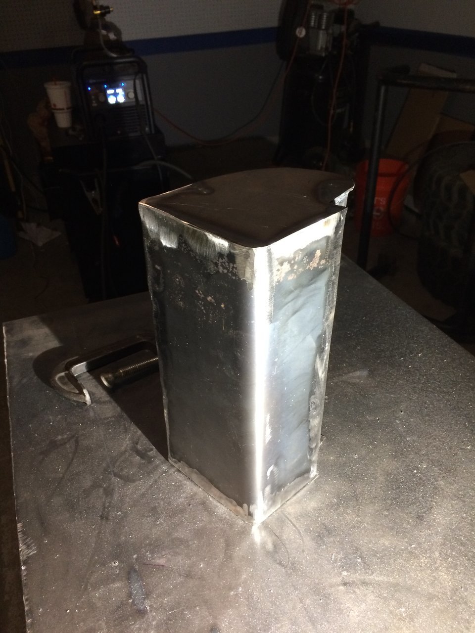

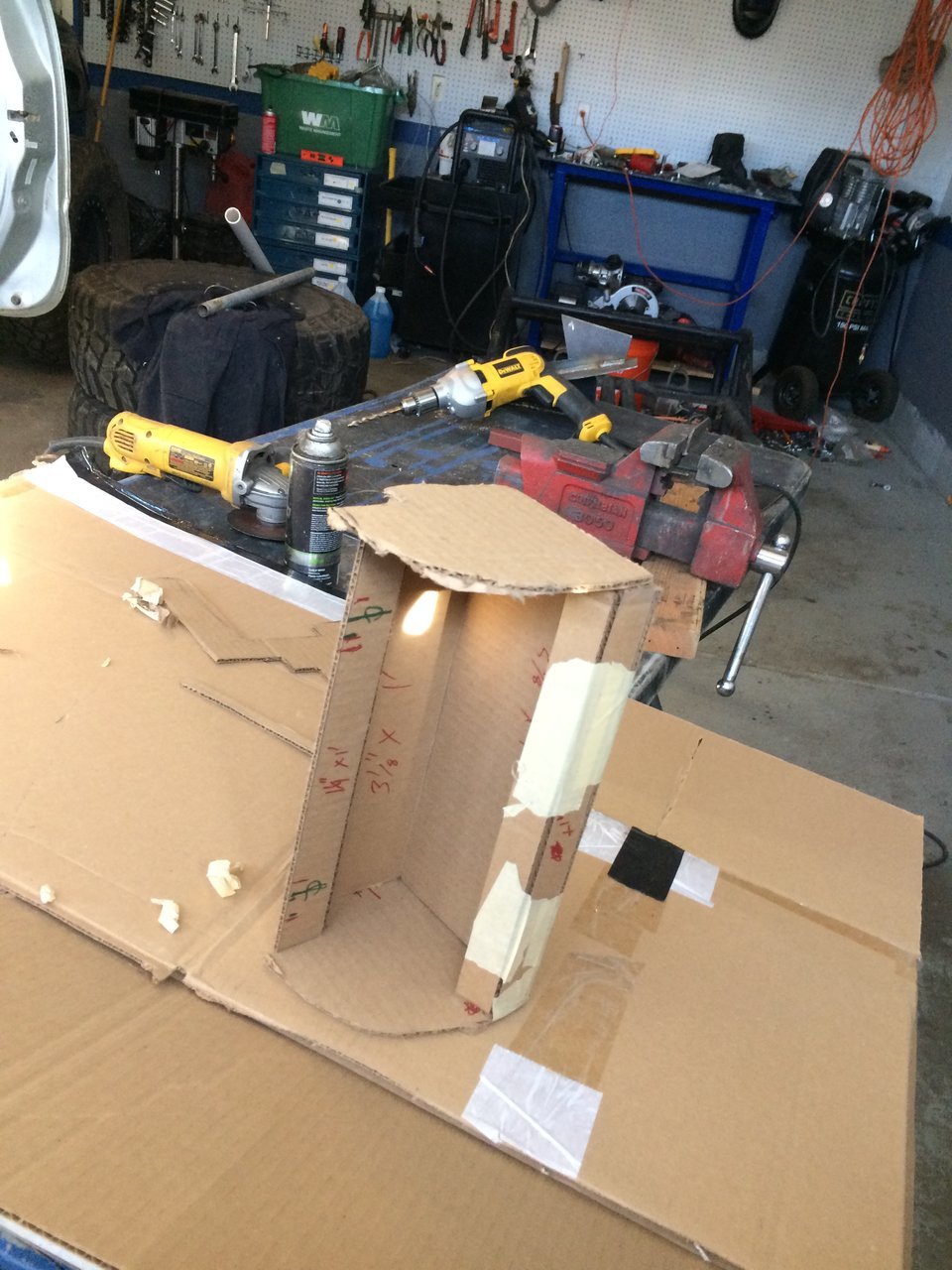

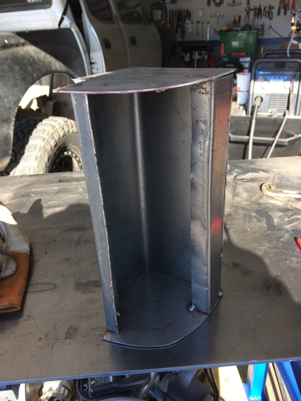

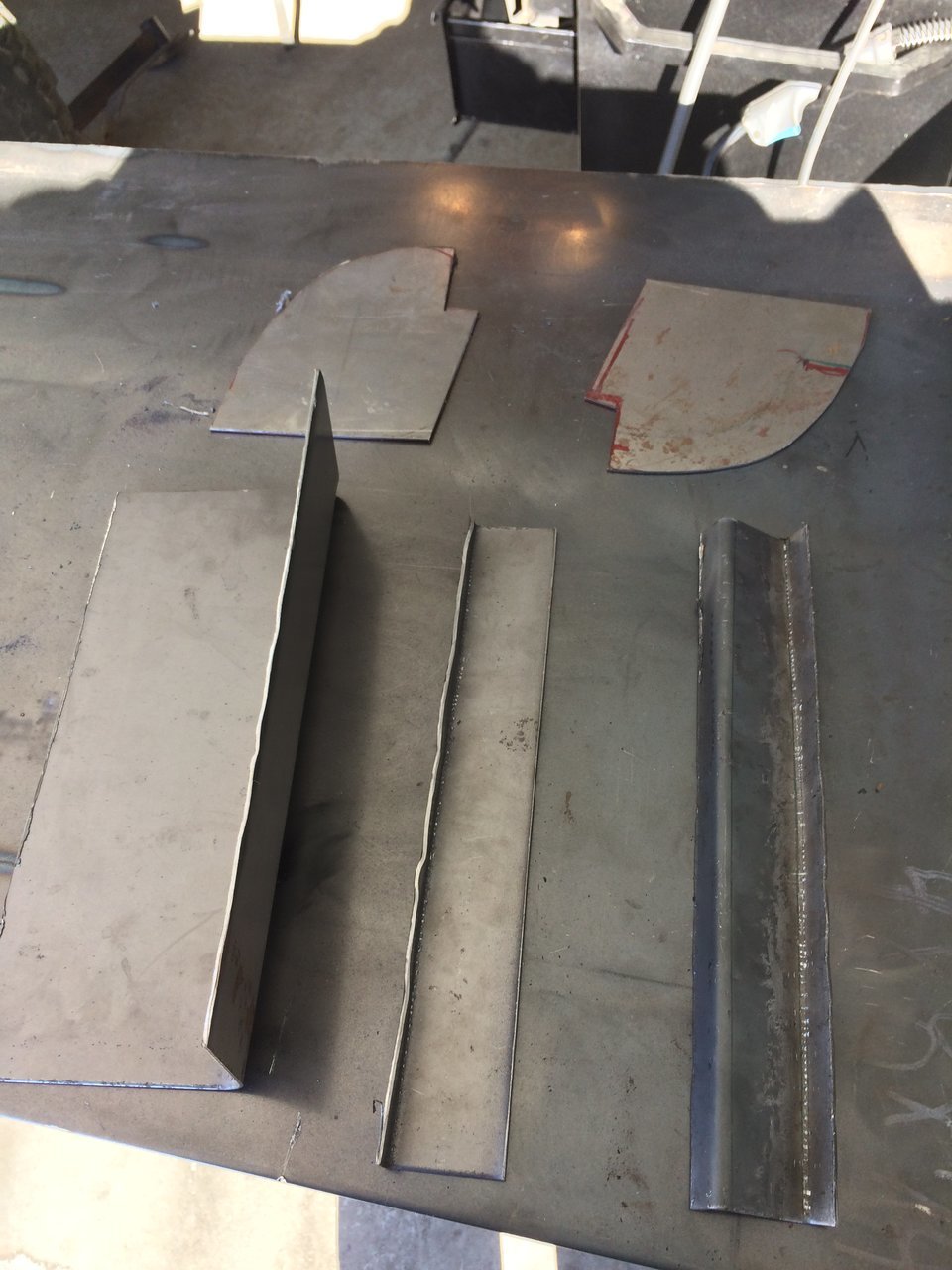

    I started on the parts for the fuel cell.

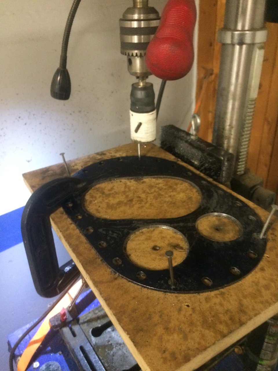

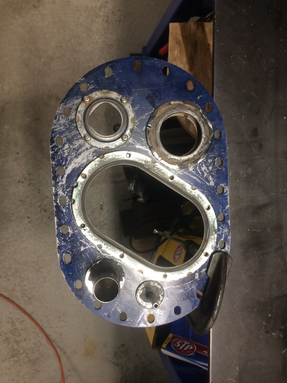

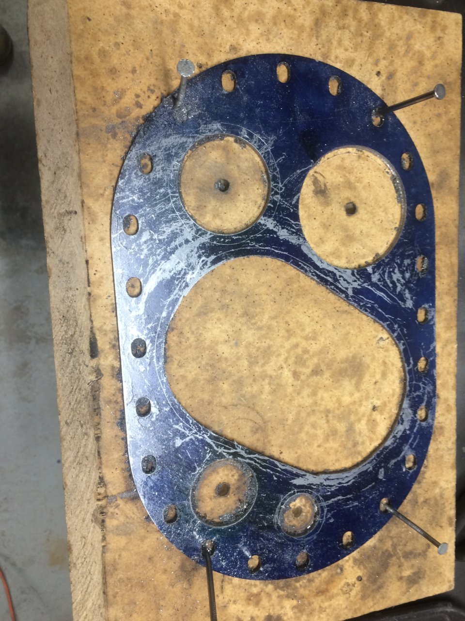

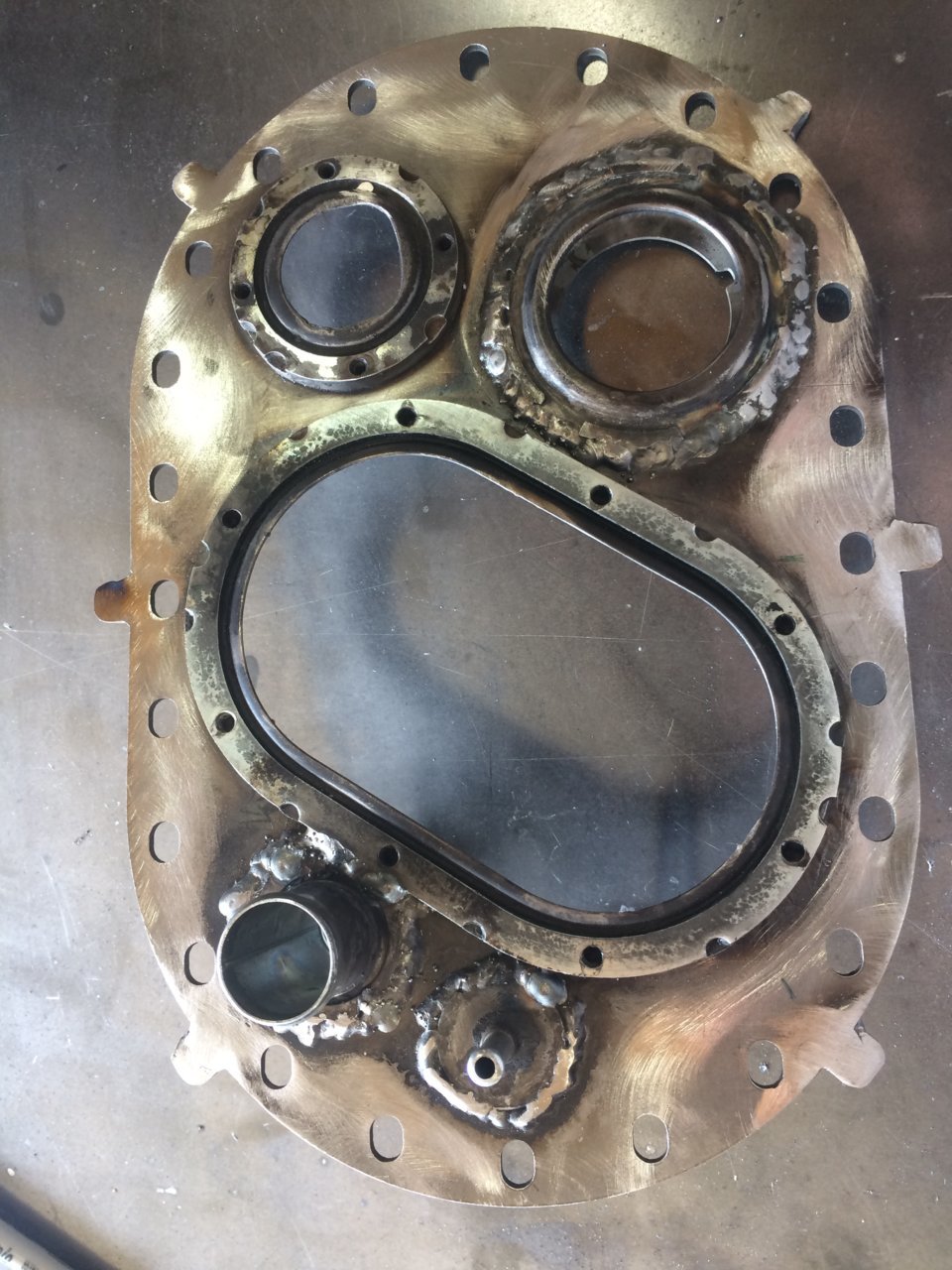

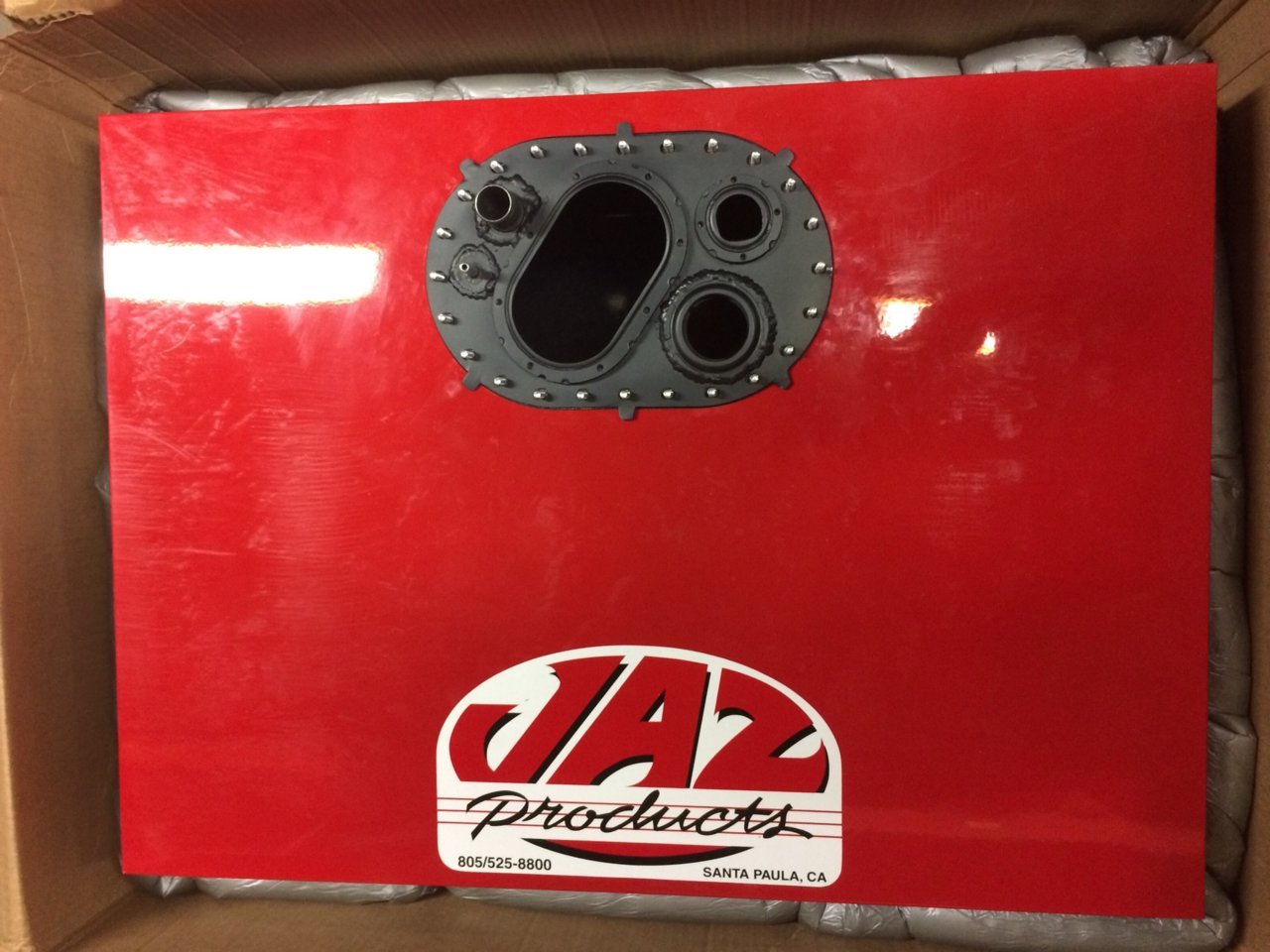

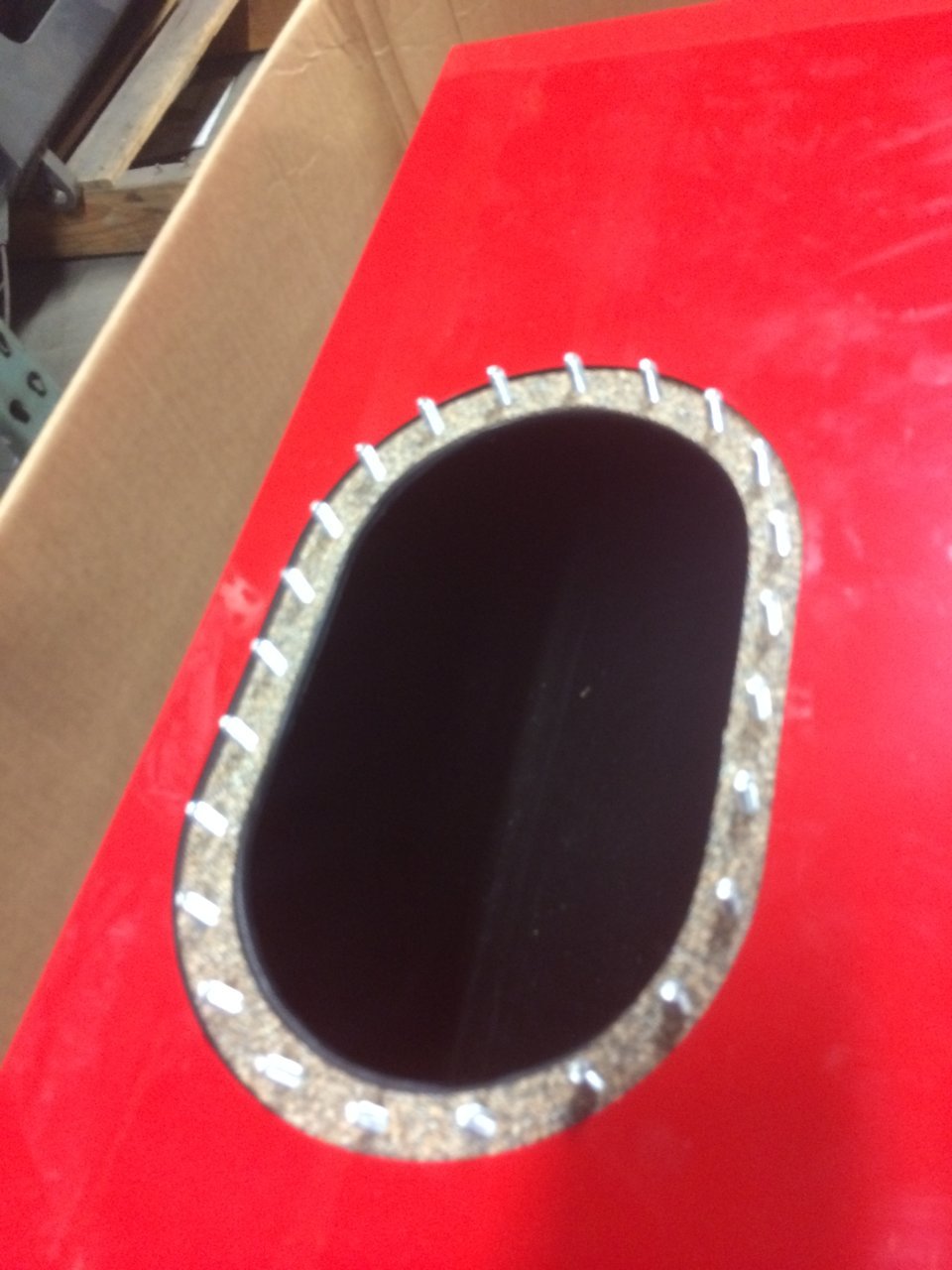

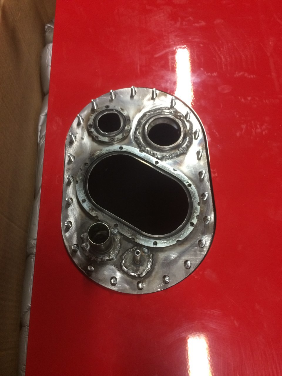

    Finished the fuel cell filler plate. I still need to extend the fuel pump bracket and sending unit once I drop my stock tank. I want to use the new fuel pump I have and other parts instead of the junk yard parts that came with the tank. I used Steel It black to paint the plate.
