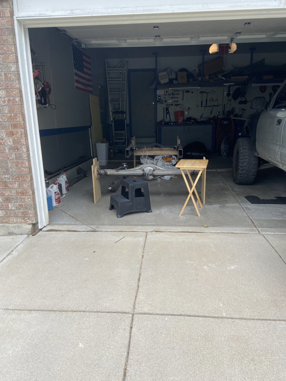

    Those jigs are freakin killer, Ray!

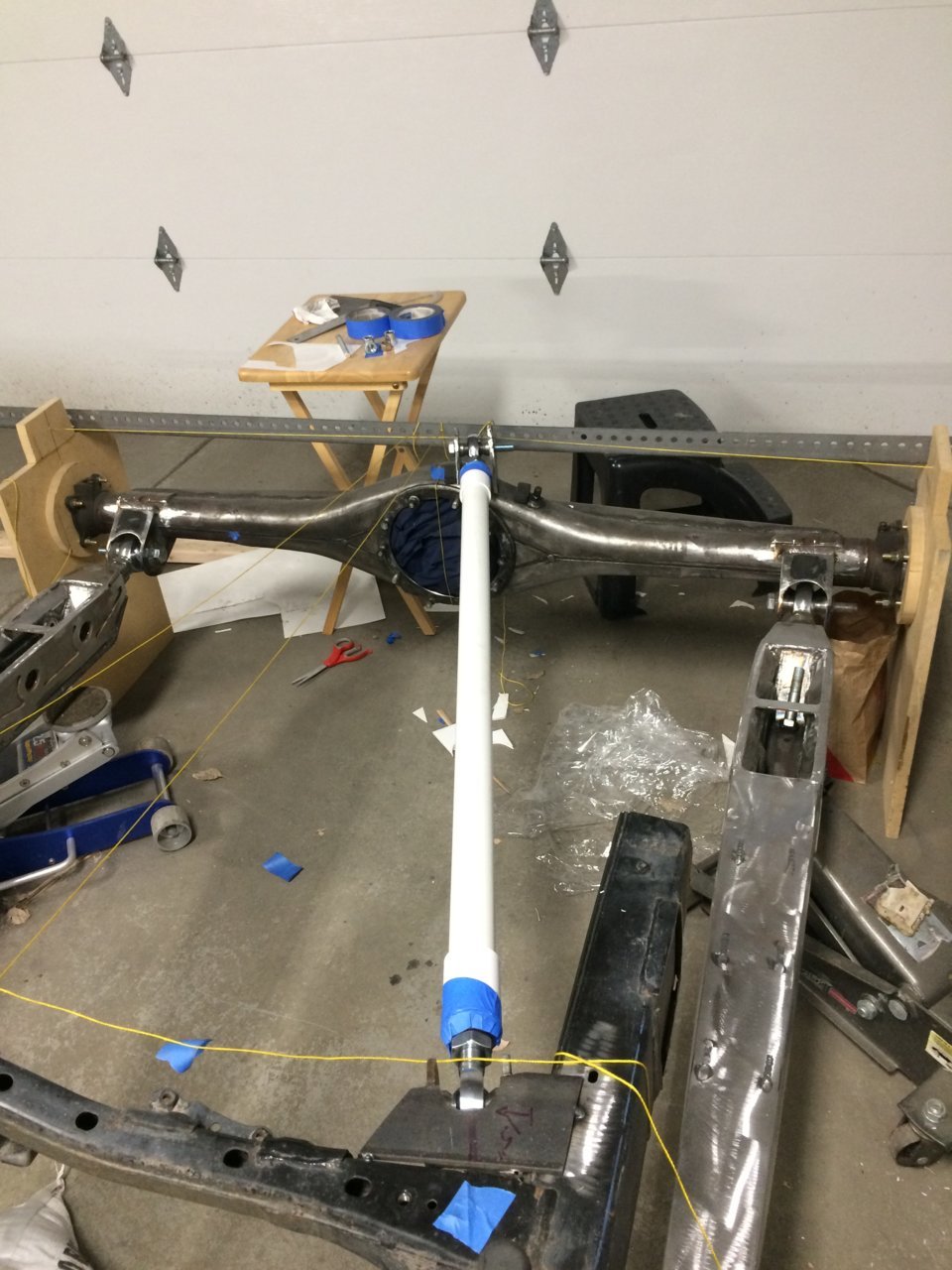

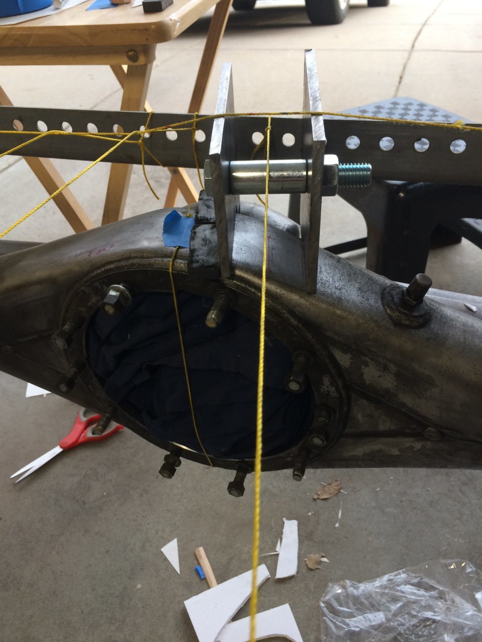

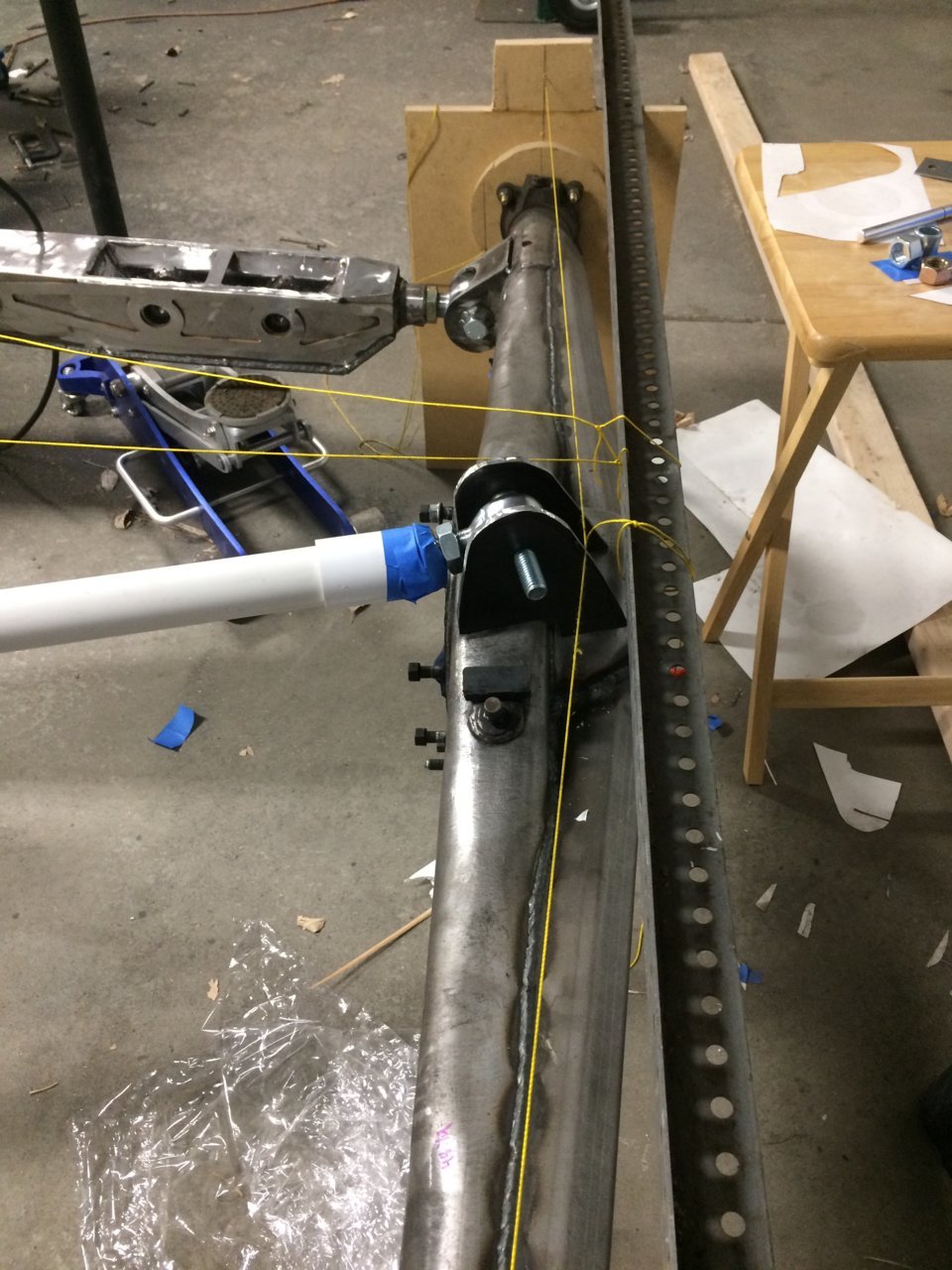

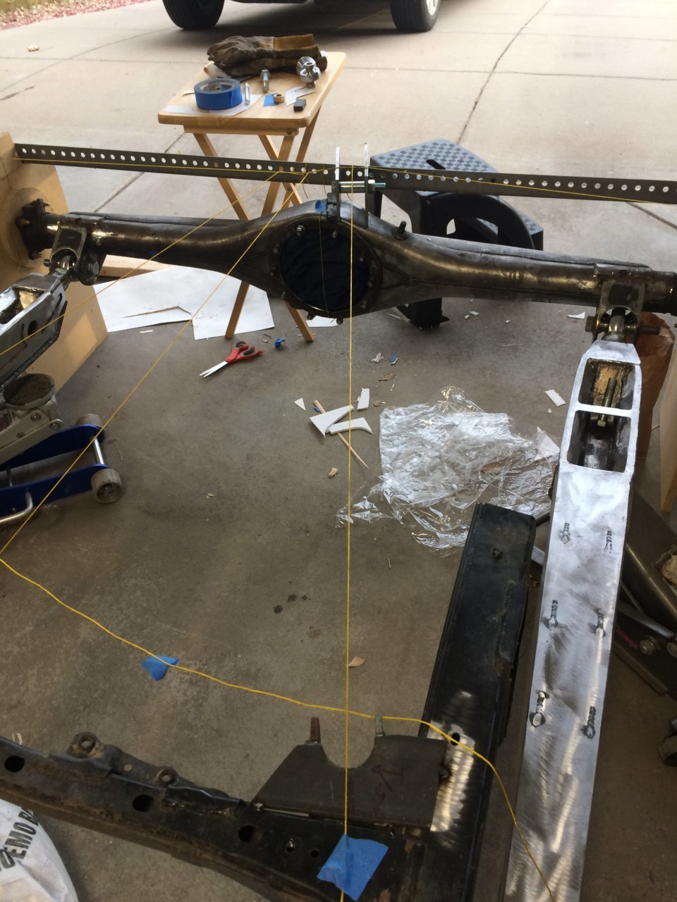

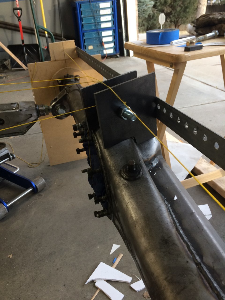

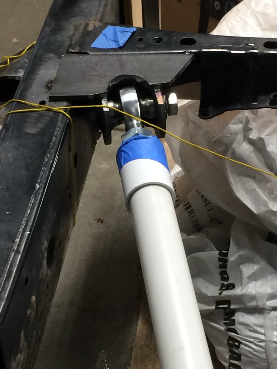

    And of course this. I need to make sure that the upper link axle mounts are high enough so the tube link won’t hit the axle at full bump. So I’m using pvc.

  5. Mar 15, 2020 at 7:43 AM
    #2325
    Wishbone Runner
    Wishbone Runner Because 4R
    Sep 9, 2012
    #86546
    6,348
    James
    CO
    04 SR5 4Runner
    King/Dirt King
    Ok cool, should have figured you would do something like that out of the norm :thumbsup:

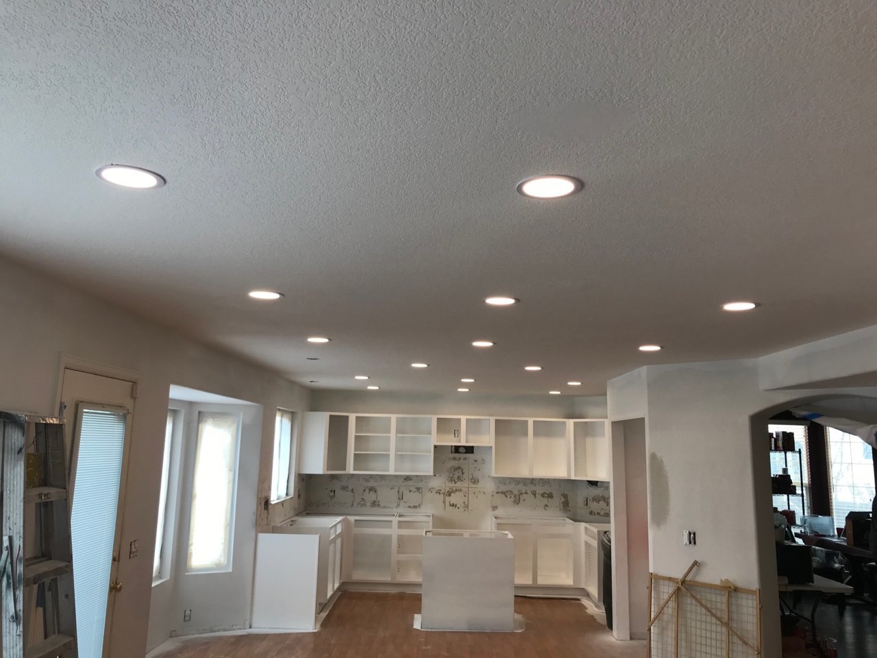

    The truck is on hold because of this whole virus thing going down. So I’m taking care of the honey do list.

    Nice work, Ray!
    Hope you and yours are doing well.

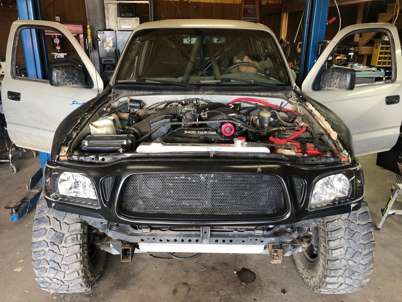

    Some extra ponies to pull this cage around.

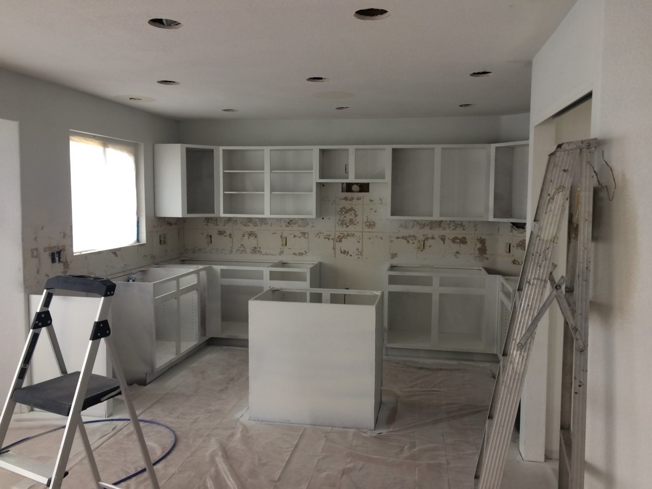

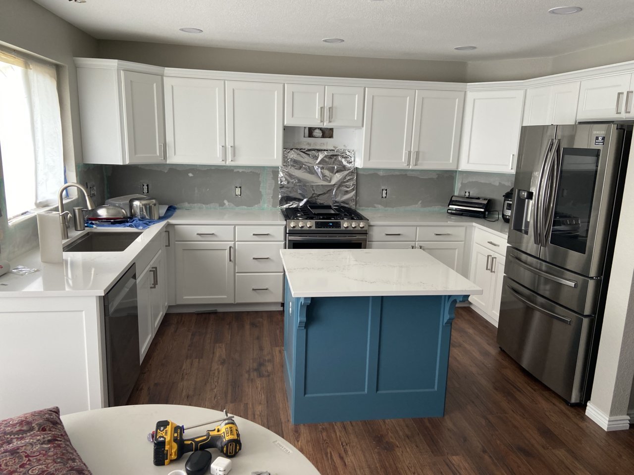

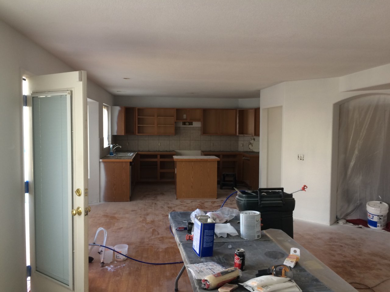

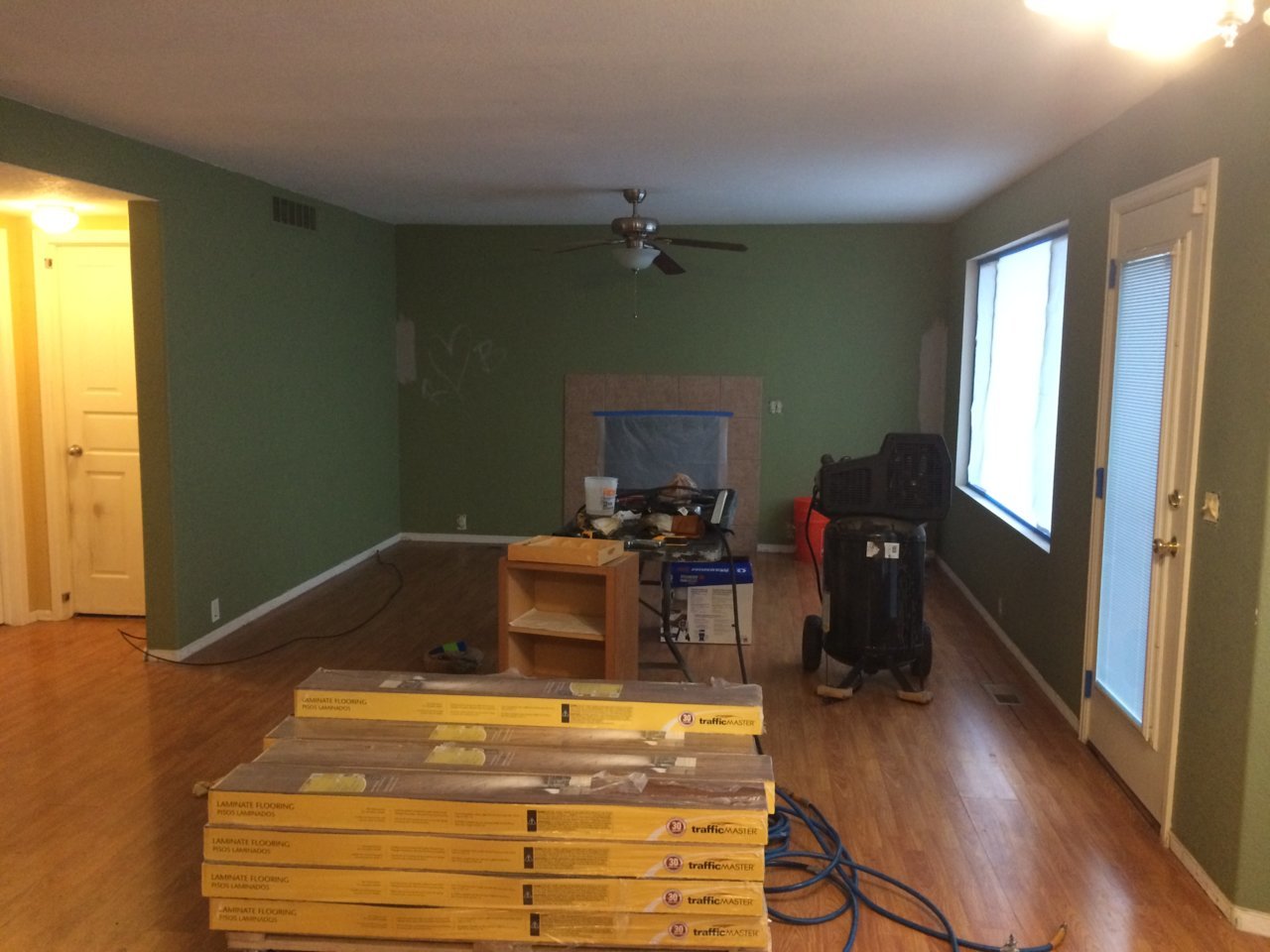

    I decided I’m going to try and make RT this year if I finish the truck. I got as much as I can get done with the house for now. I still have a lot more to do. I’m leaving the backsplash for someone with skills to do it because I don’t want to screw it up. Time to get back to the truck. Shocks and bypasses are here.
  12. Jun 25, 2020 at 6:16 PM
    #2332
    T-Rex266
    T-Rex266 SpaceX Director Moderator
    Mar 21, 2011
    #53447
    28,259
    Elon
    Solid renovation work my man. :fistbump:

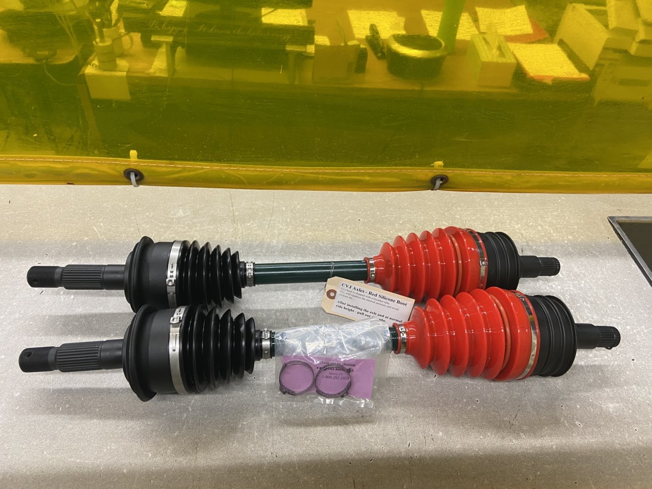

    I picked up an extra set of cv’s from yota jims and took them to CVJ. I’ll swap out my old CVJ axles with these and keep the older ones for spares.
