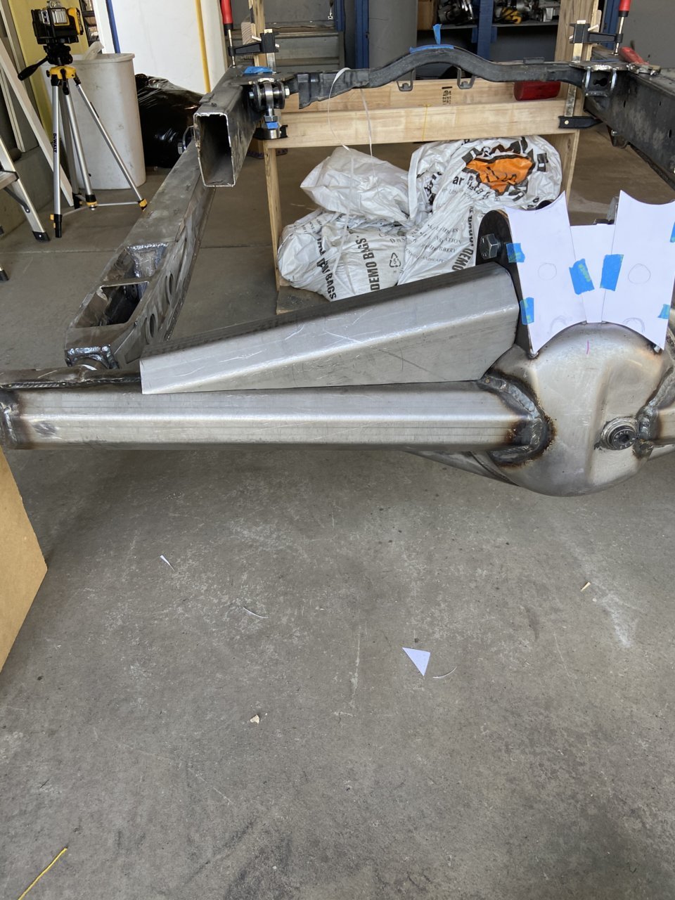

    Im running a 2001 Tundra axle.
    It’s the ruffstuff 9” upper truss. I will trim it to fit.

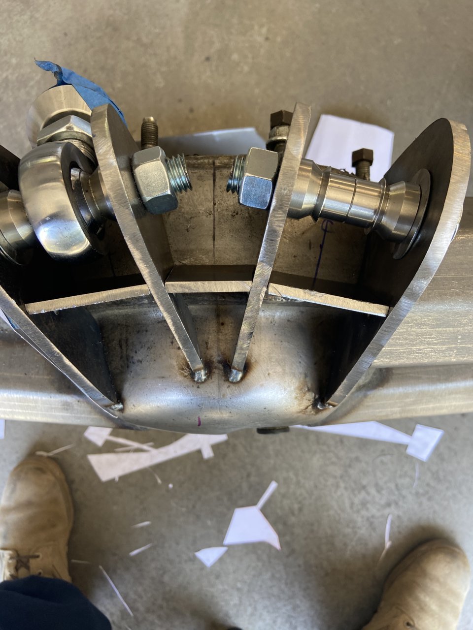

    Stuff and junk and things...

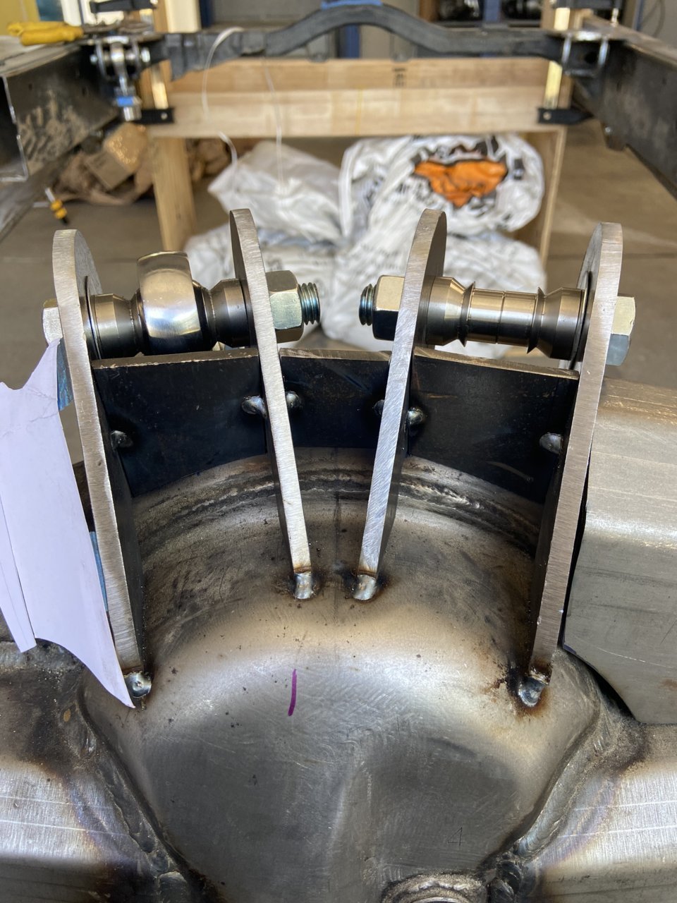

    Slip some 0.04"ish shims in between the misalignment spacers and the mount to make assembly easier. I have some shock shims that could work if you want. House flashing cut to fit can work too.

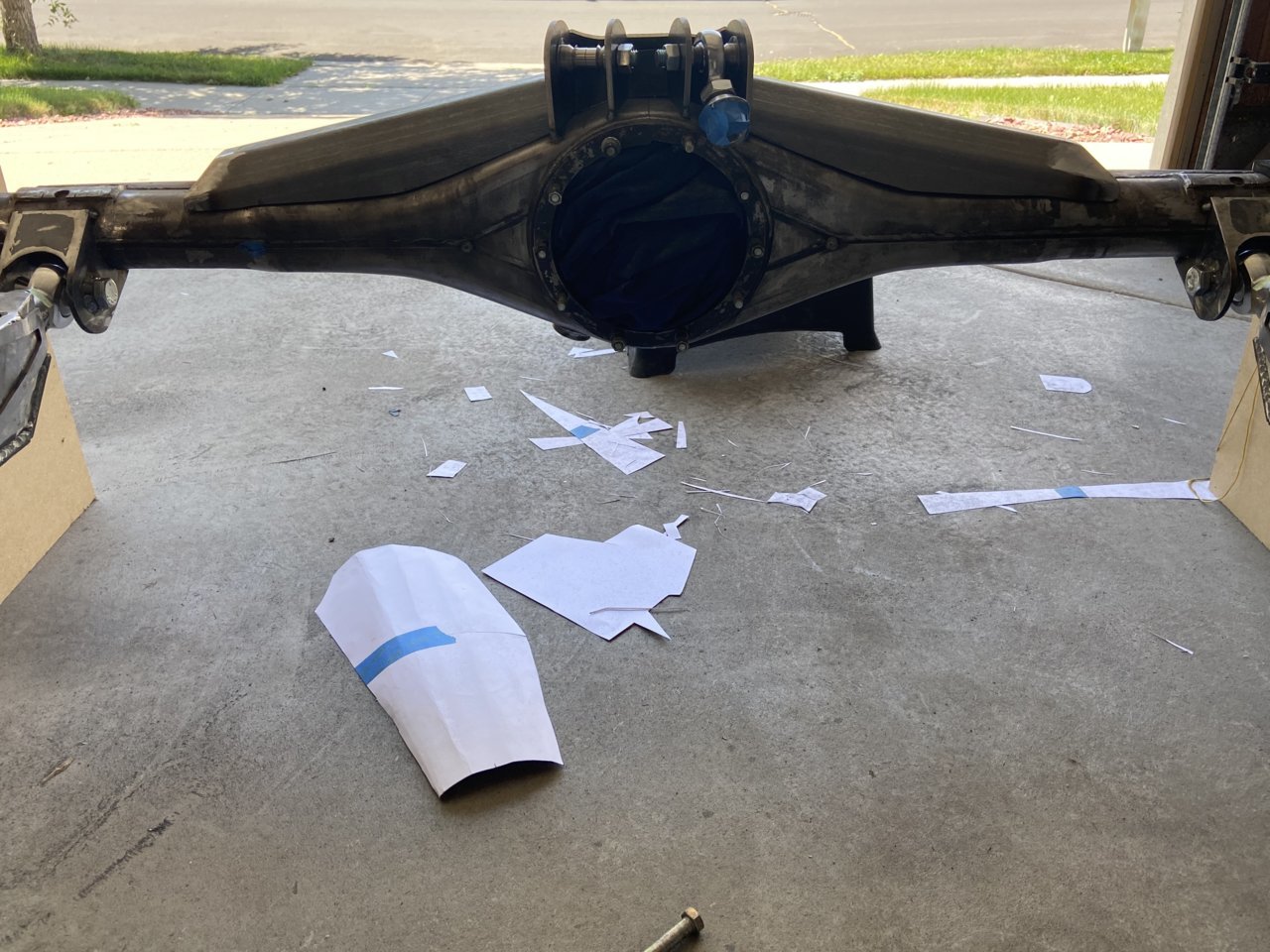

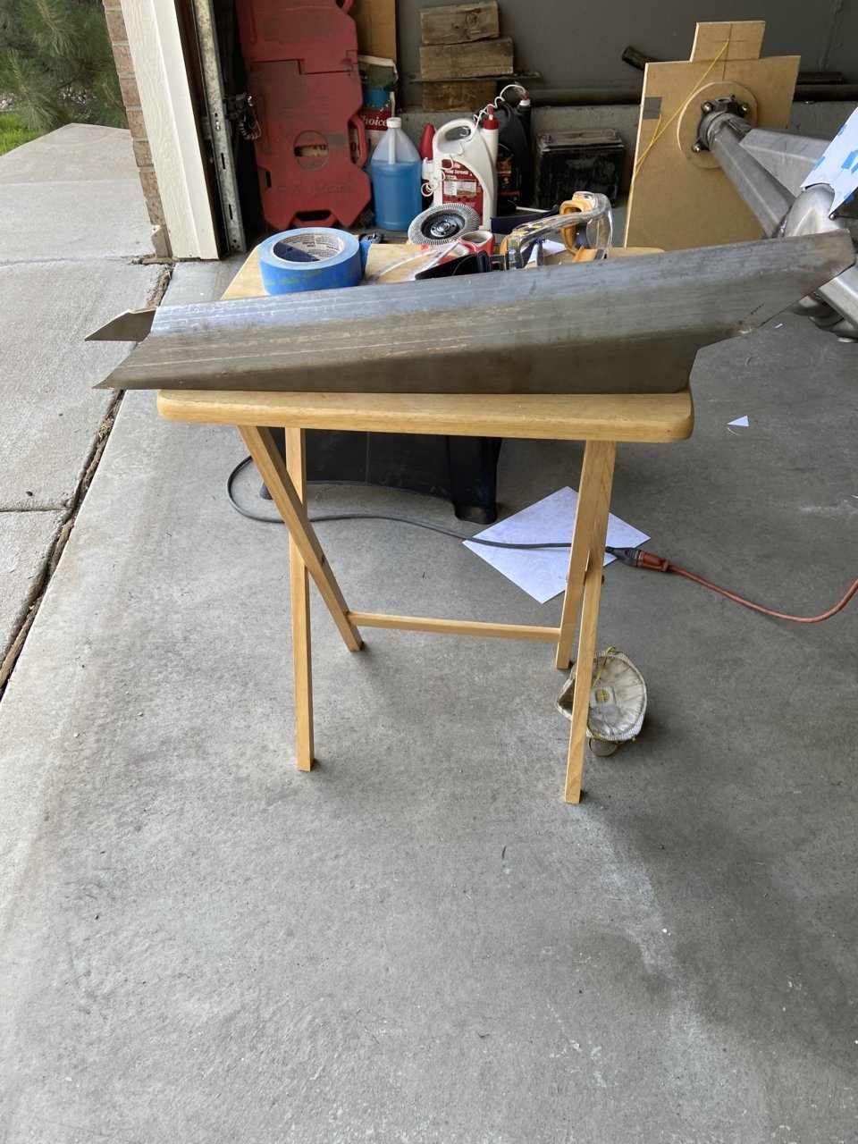

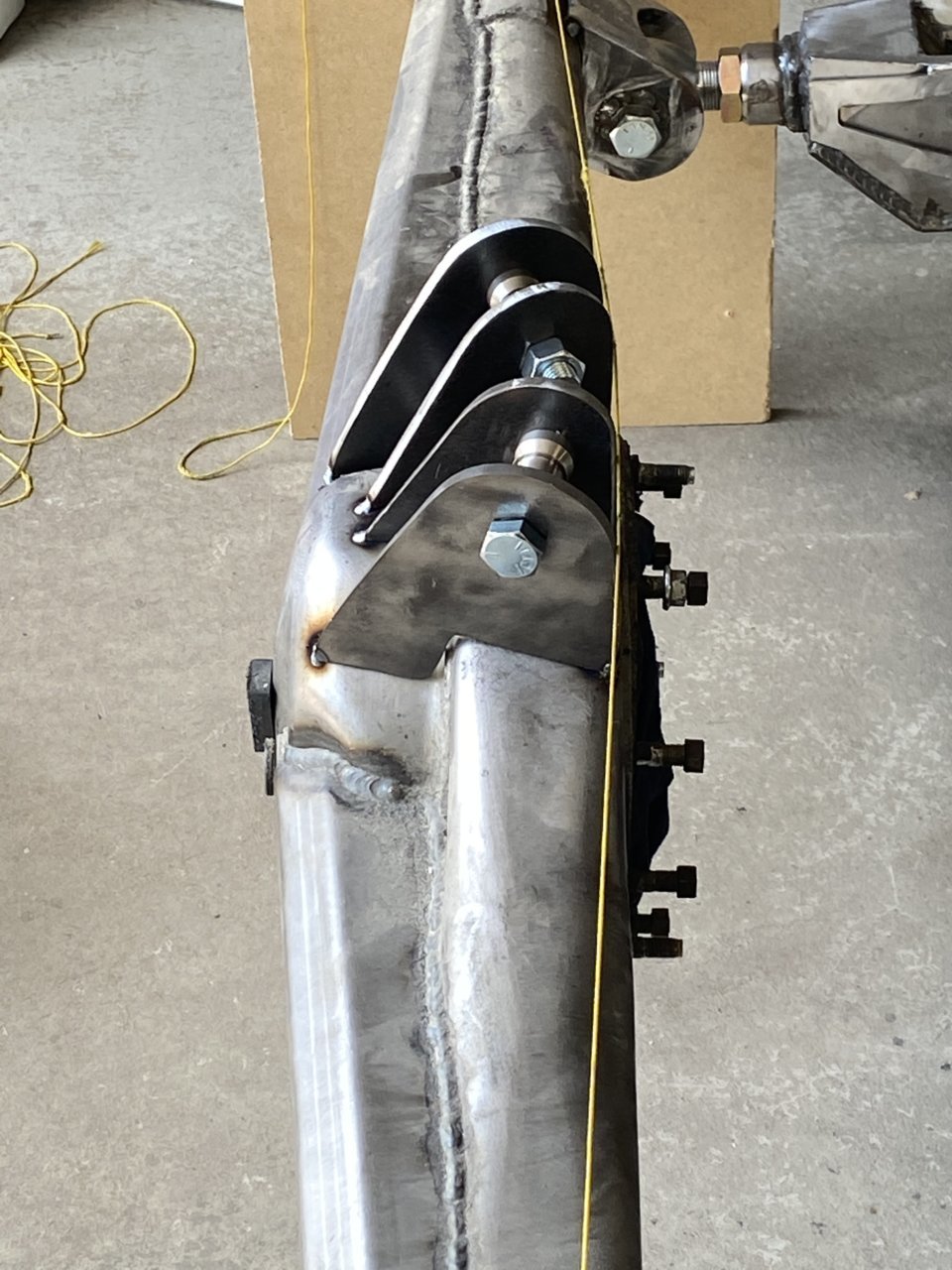

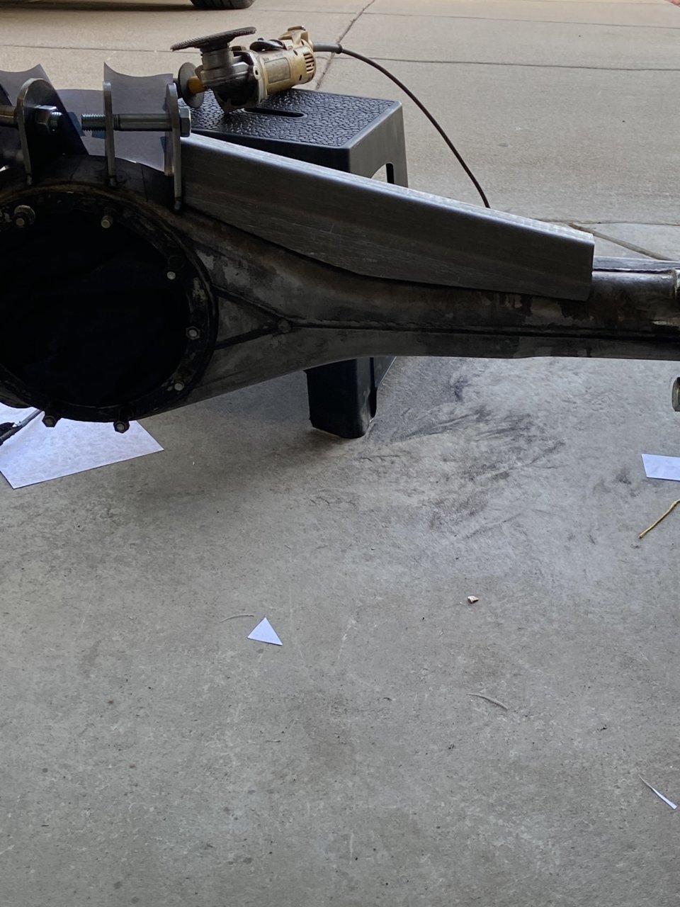

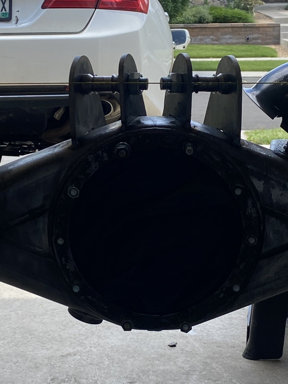

    The upper truss came in today after work. Started chopping.
    This is how they came.
    Decent fit. Still needs more work.

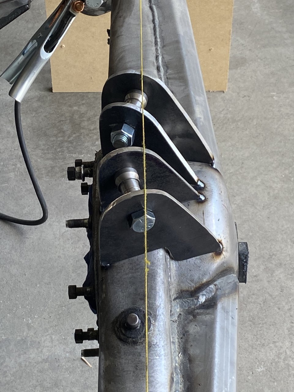

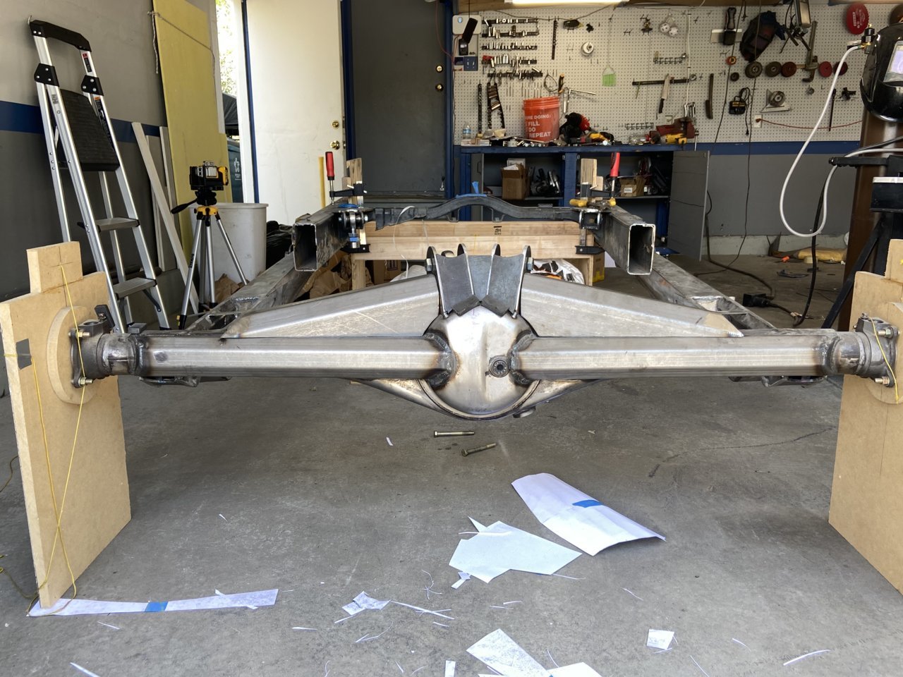

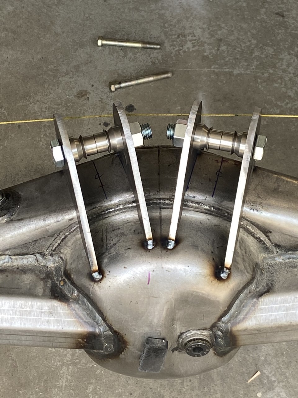

    Finished the last few pieces for the axle and links. Once the truck gets back from paint I’ll chop it and start building the rear.

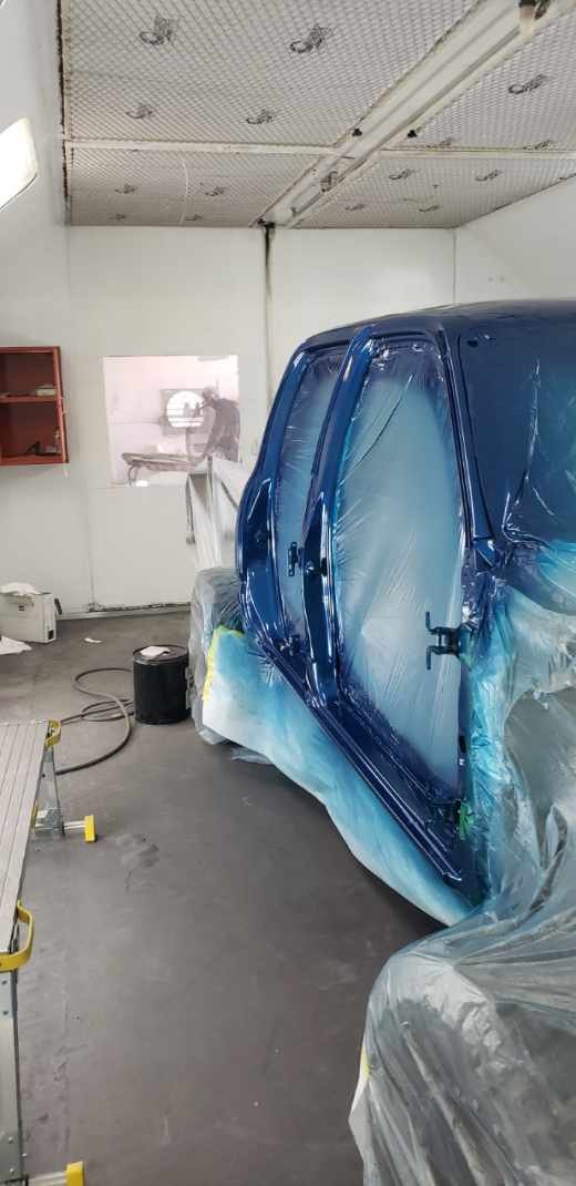

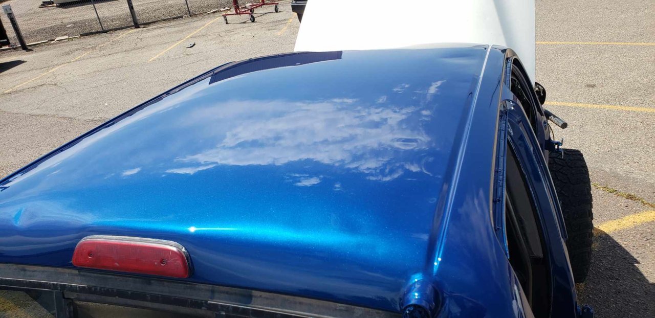

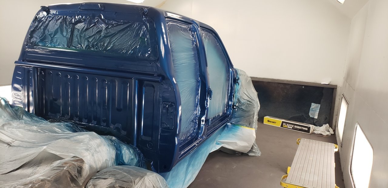

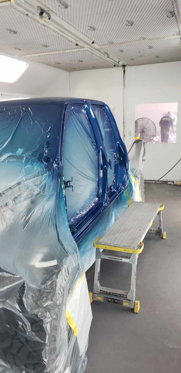

    Super happy with the color.
  9. Jul 3, 2020 at 5:45 PM
    #2349
    chenbro
    chenbro ¯\_(ツ)_/¯
    May 27, 2009
    #17697
    3,335
    Broomfield, CO
    2009 Silver DCSB TRD OR
    What haven’t I changed?
    But now it’s not a silver ghost anymore

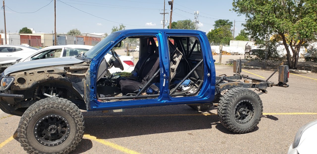

    And so it begins.
