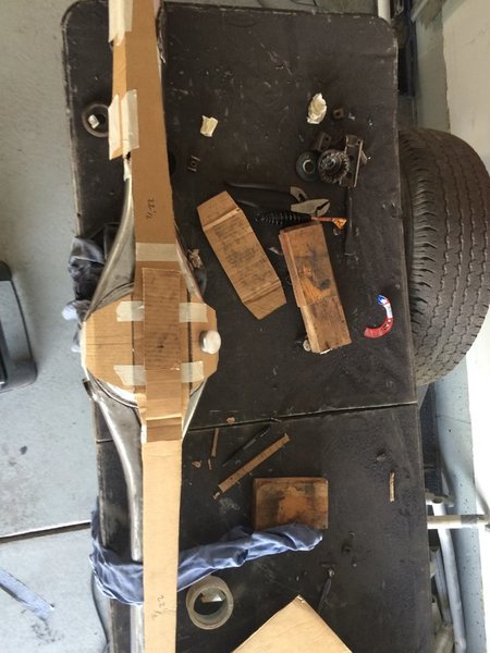

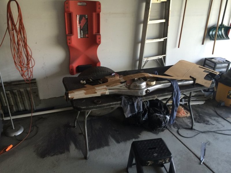

    That long run across the back - you gonna have Corey keep that one piece and plate break it or weld all 3 sides?

    If you keep it in one piece, I'd recommend you have him put it on the brake.
    If you have him break it... well, then it'll be broken and that's no way to start a project. :D

    Not sure at the moment. But once I get the design done I'll be headed over there to talk to him and get his .02 but he is defiantly the guy I trust to weld the finish product to the axle. Some of the angles will be welded and some bent on the (break, brake) :D
    Haha :facepalm: I'm the last guy to know the difference between the two. :anonymous:

    Now that I think about it the width of that truss he can probably brake one side but there would not be enough room to brake the other side. But keeping it one piece of metal will definitely help strength.
