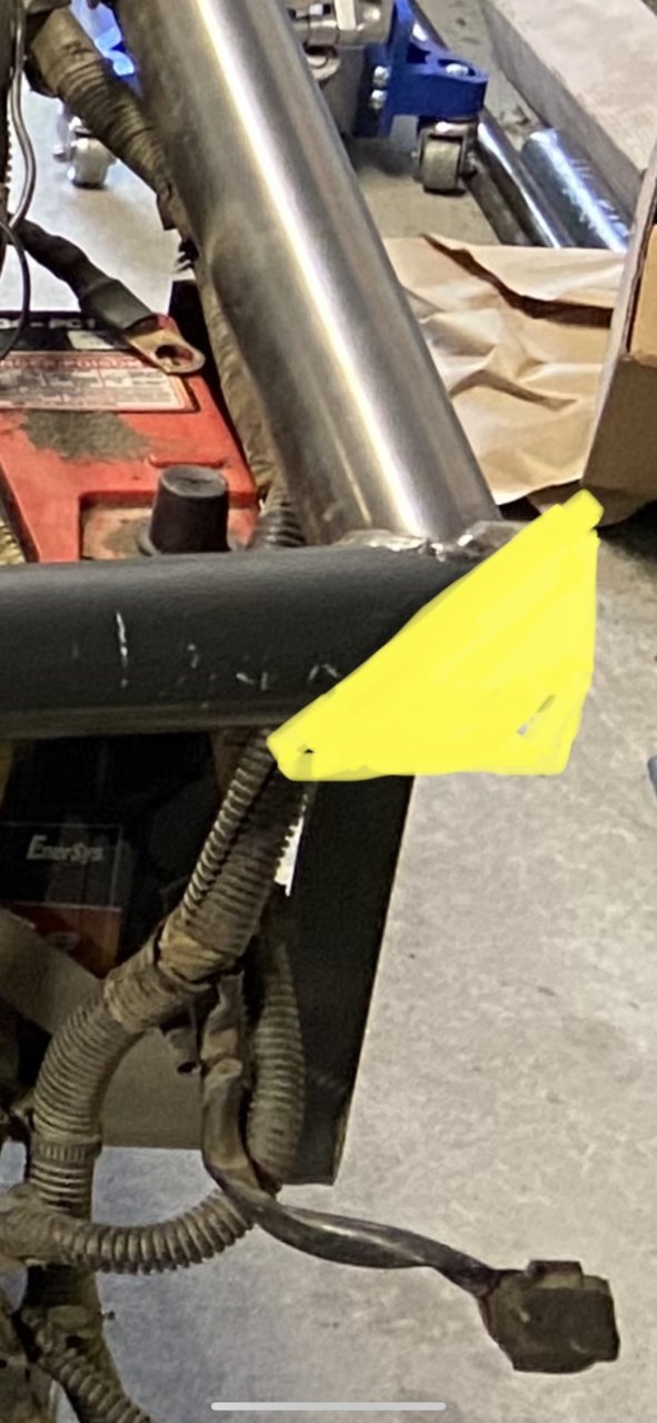

    It’s coming together. I did run into a slight fitting issue with my original hood. Right at the outer corners of the cage. I might have to trim a little bit off of the tube ( the yellow section) but I won’t know for sure until the new hood gets here. It will be very small amount and then I’ll cap the end off at an angle. Nothing like building an engine cage. Very interesting experience.

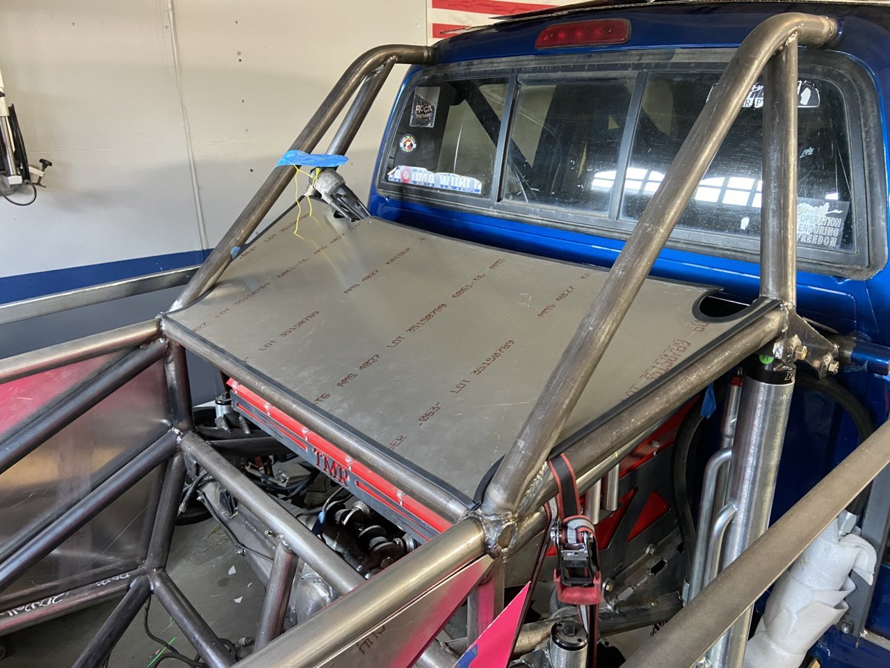

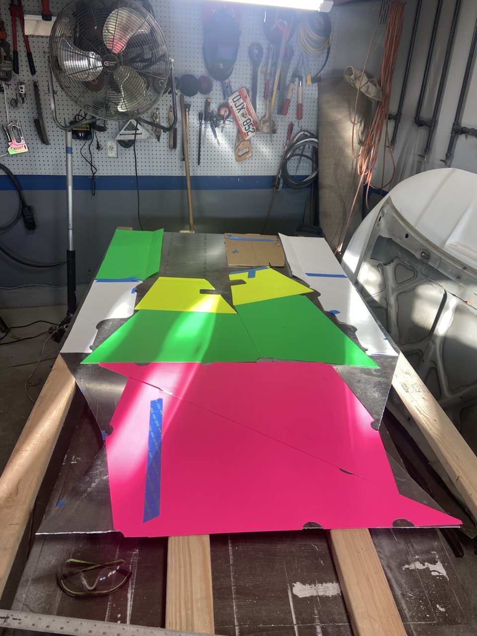

    Putting this here's I'm debating aluminum sheet or ABS.
    jubei and Blackdawg like this.

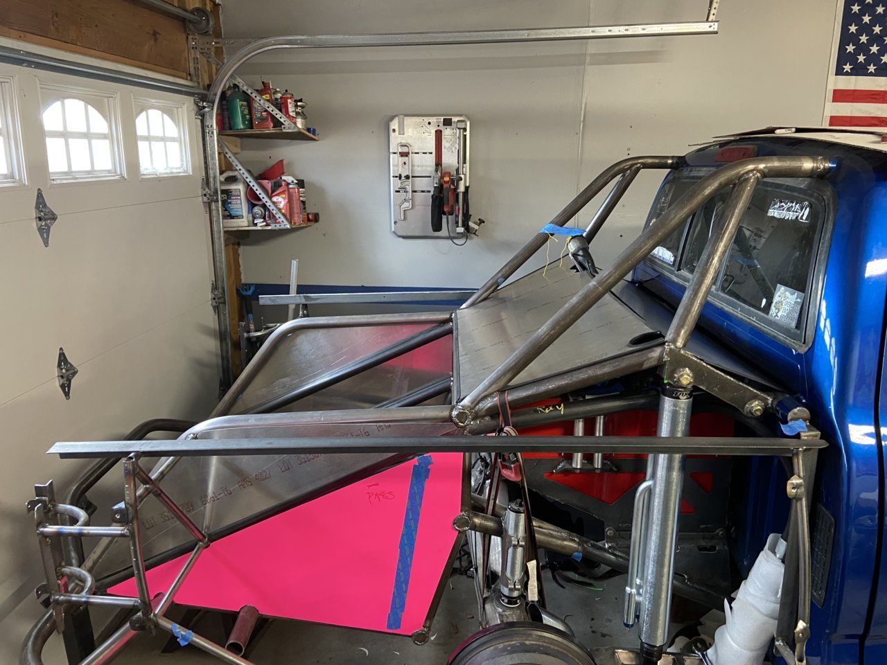

    :facepalm:The truck has been sitting in the garage way to long.......:sadviolin:A few weeks ago I strained my lower right side of my back. I was on my knees hammering rebar into concrete at work and I was over reaching on my swing and pulled it. Shit happenes. Hopefully I'll be back at getting this damn thing done soon. I was in the middle of cutting aluminum plate for bed cage panels and enclosing the bed. My new one piece hood did show up and I had it line-x sprayed. Doesn't feel so flimsy now. Once I'm healed......

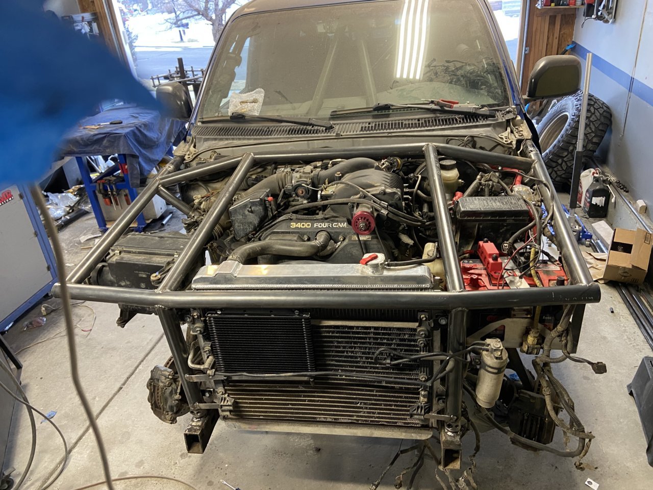

    • Build framing for the new hood

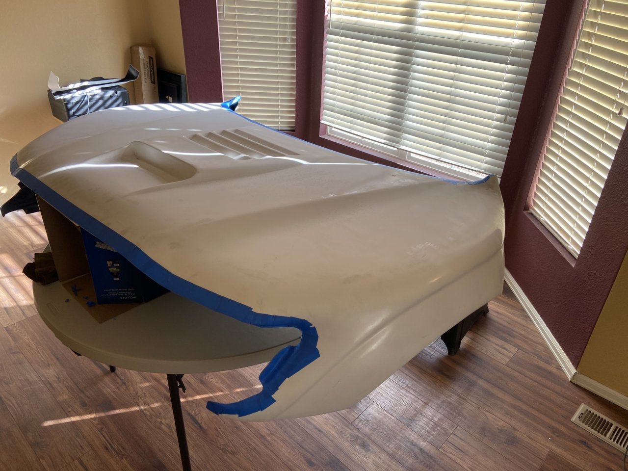

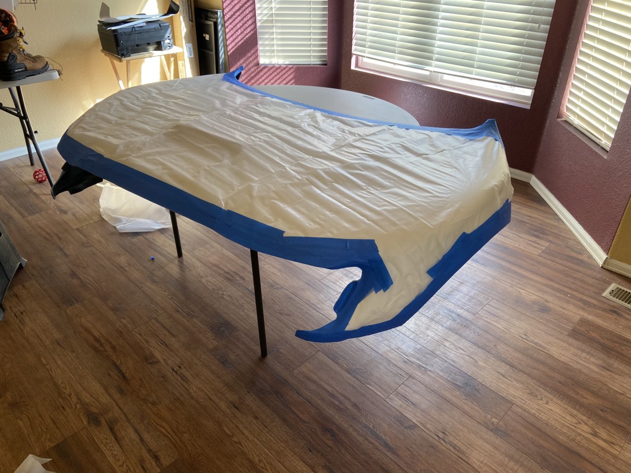

    Here! You happy now! In the middle of pulling the tape off the edges and trimming the over spray.

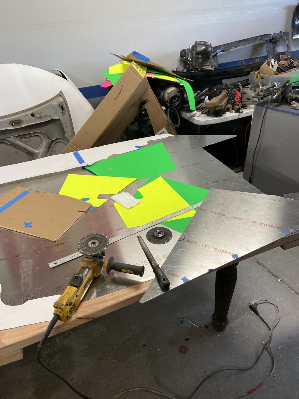

    Oh I guess I still have some photos. Before I line-x the hood. Most of the panels are cut. I have two more panels for the top of the bed I have to trim. Also need to weld tabs and drill holes through the panels.

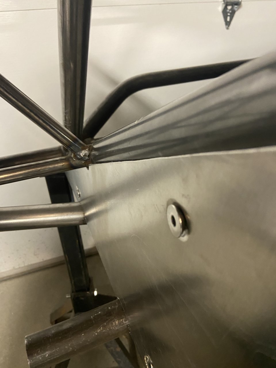

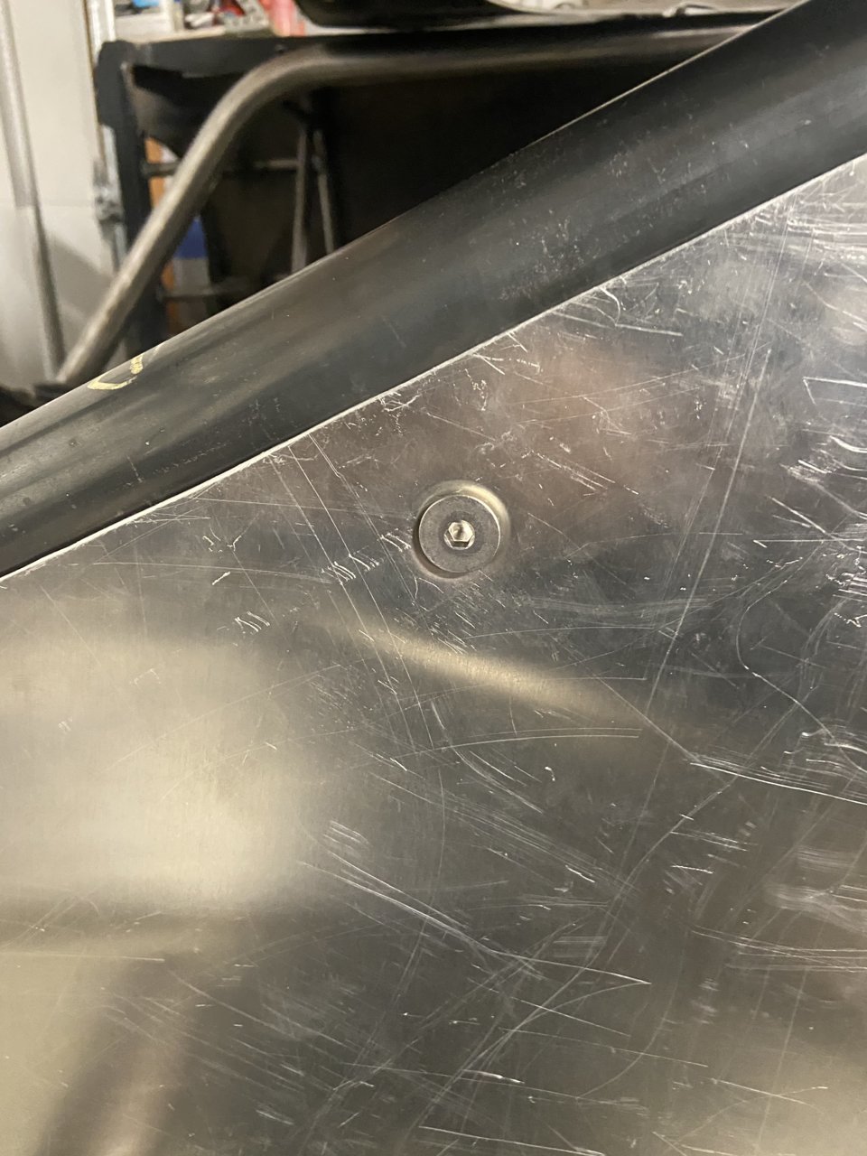

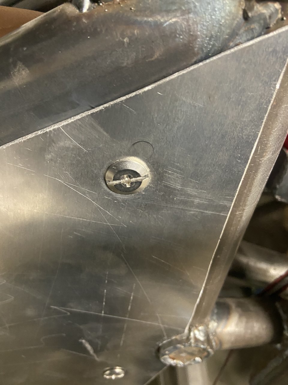

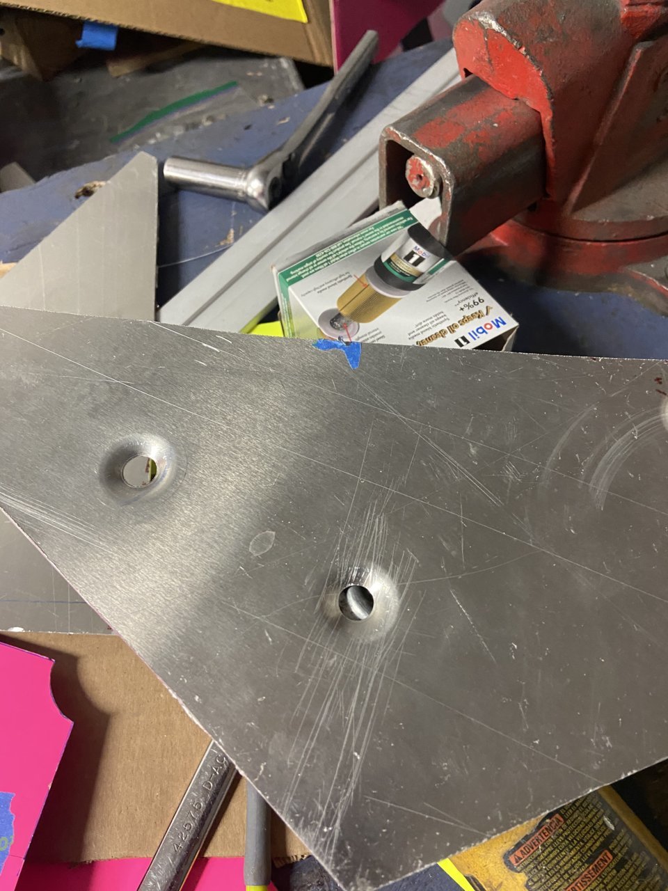

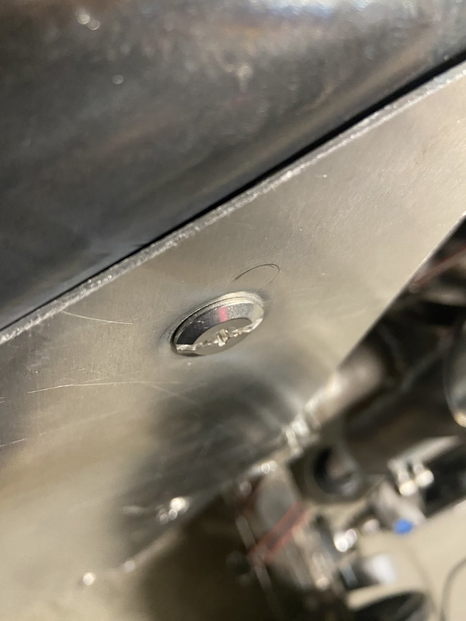

    This is where I left off. I have two choices of bolts to use for the panels. I have a hex head or a philip head bolt. The cheap dimple die I got off Amazon works great but the angle is all wrong for the hex head bolts. They won’t sit flush in the taper of the hole. So I’m just going with the philip head bolt even though it’s not flush to the panel. It still seats better. These little things is what takes so much time to do.

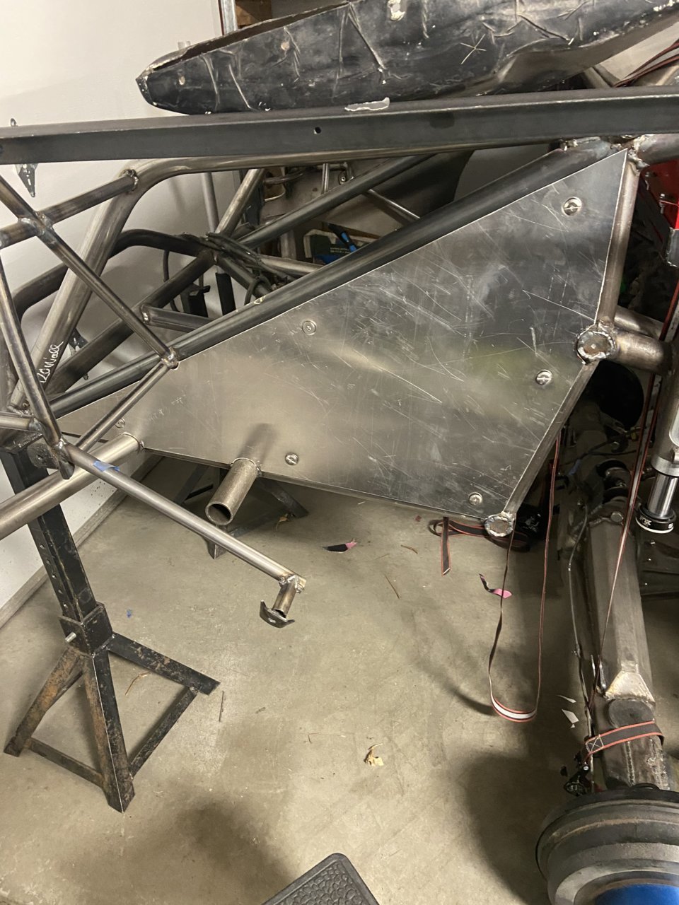

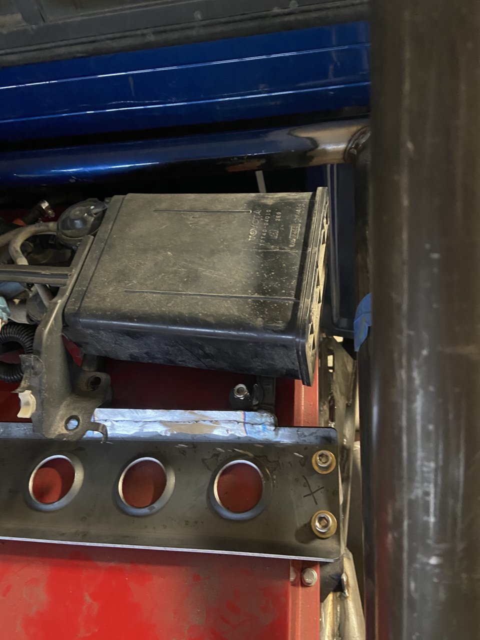

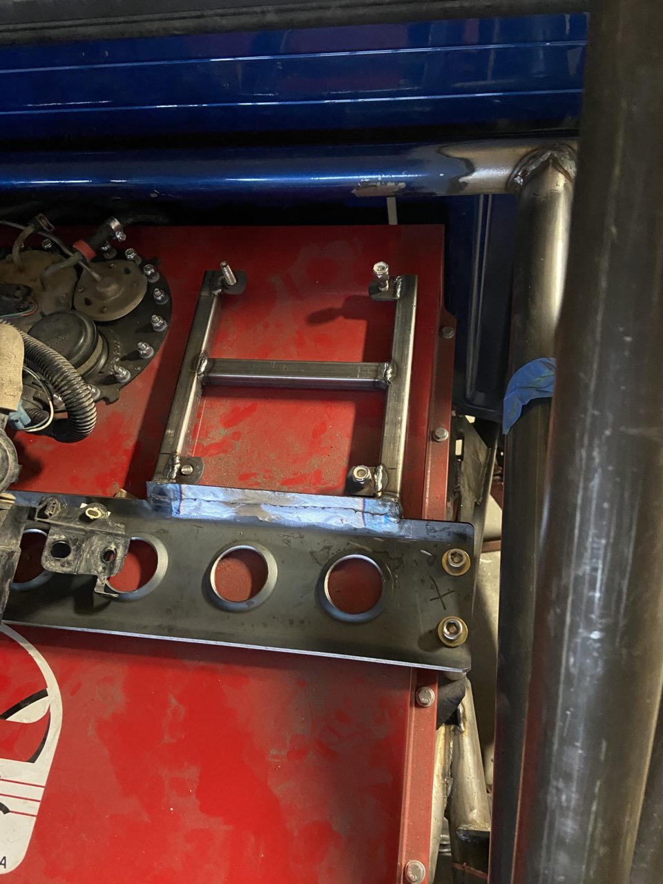

    So after a 5-6 weeks of not doing anything on the truck. I tackled the charcoal canister mount last night after I got off work. I figure I try and keep it simple and use what I had. I used the stainless steel flat head bolts I was going to use for the panels and they fucked me. They didn't like the heat one bit. It was a struggle trying to get the nuts off after I welded them. One completely broke off and one was stripped so bad I had to cut it shorter. At least I can still salvage what I could and still be able to use this mount. Looks like shit but all of this will be covered with panels so I'm ok with it as long as the charcoal canister can stay in place.

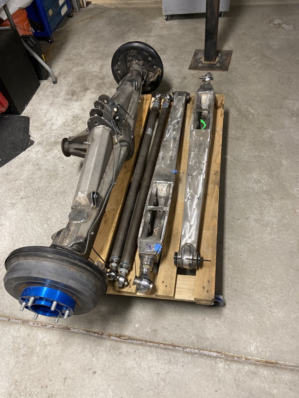

    So I removed the axle and links to finish up a few minor things and paint.

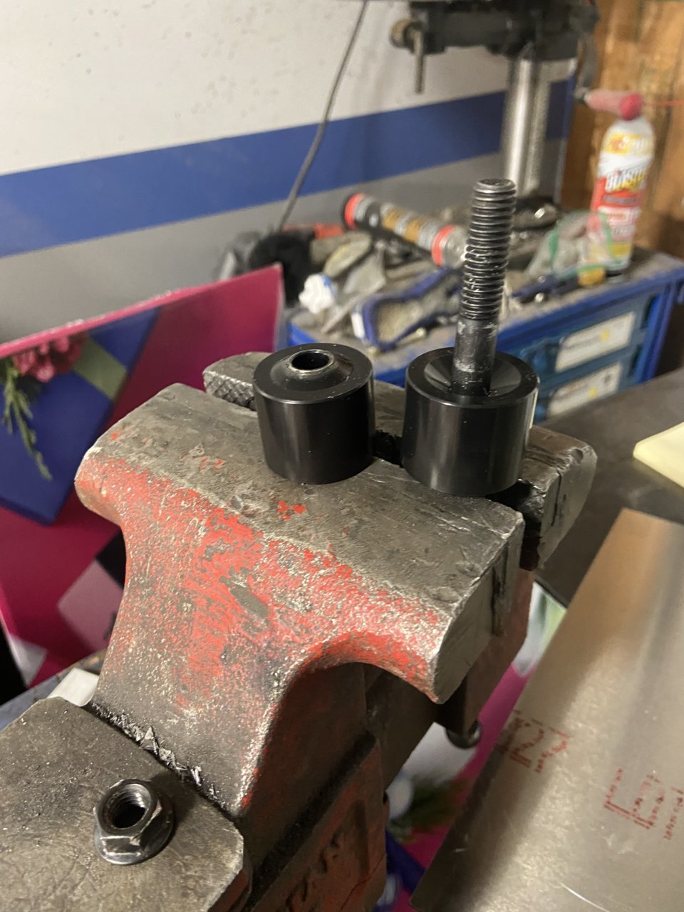

    ha that like the 3rd person I've seen making those now.
    Edit: scratch that, 2nd. That's the same dude I've seen.
    Curious if it'll work!

    I saw those and really wonder if you are just moving the weak link to the single bolt.
