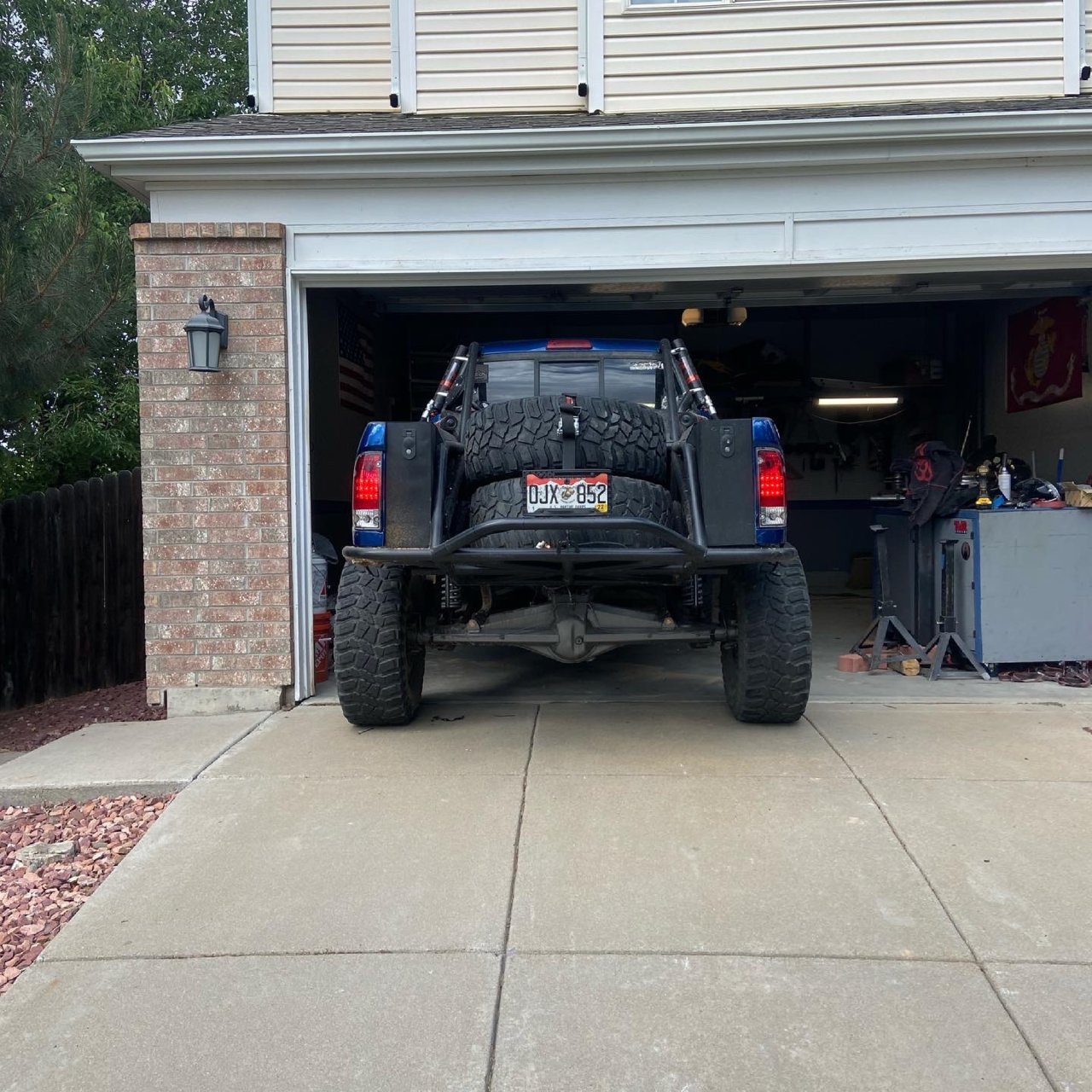

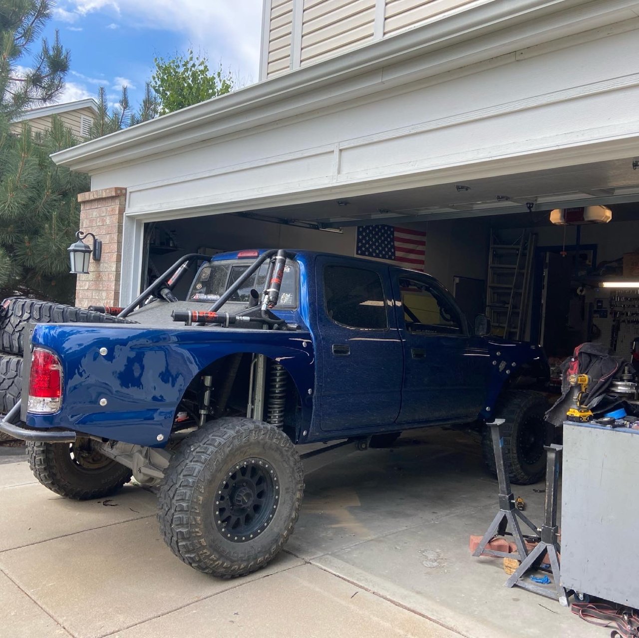

    Ray you forgot to wear your FRC when you took these photos :rofl:
    Hope to see BlueGhost(?) in person some day soon :cheers:

    Very, very impressive! LOVE the blue on it! Nice work man. I know you put in a LOT of time on this

    Looks sick! Can't wait to see this thing ripping :bikewhoops:

    Looks like it fit well! :cheers:

    Yes it did bud! Good job, Thanks.

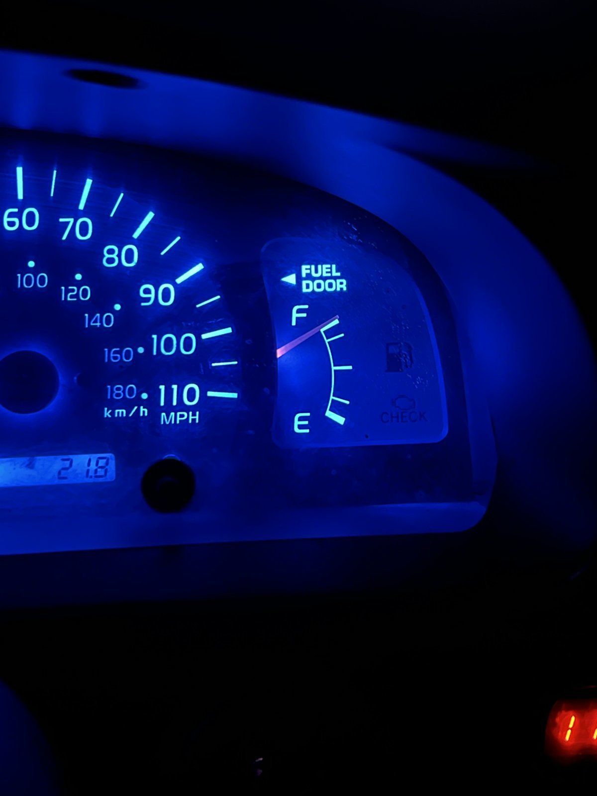

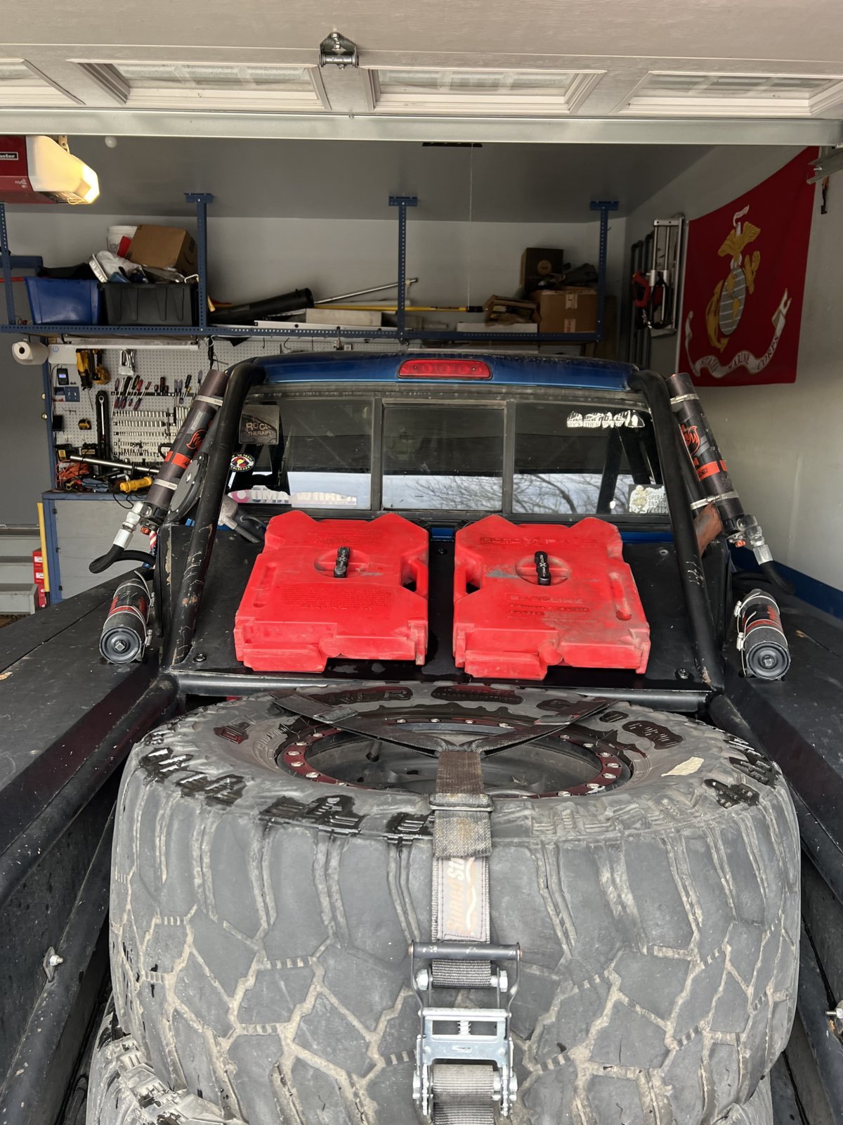

    I did a couple of things. So when I put the fuel cell in I used whatever wire I had laying around and the sending unit wasn’t working. Most know it works on resistance, with the wrong size wire it didn’t work. I finally got some 18 gauge and replaced the three wires. In the fuel tank/ cell it’s a black, red and a clear copper wire. On the plug it’s the three smaller ones, (brown, yellow with black stripe and a grey one). Now with the right gauge wire the fuel gauge is working. I get about 360 miles out of 28 gals. It’s a 35 gal fuel cell but without a buffer the fuel likes to splash around. Or maybe I need to lower the pump in the fuel cell but I’m not going to tackle that project just yet.
    I also added my Rotopax too. Decent spot…

    Ok , I’m terrible at getting photos but here ya go.
