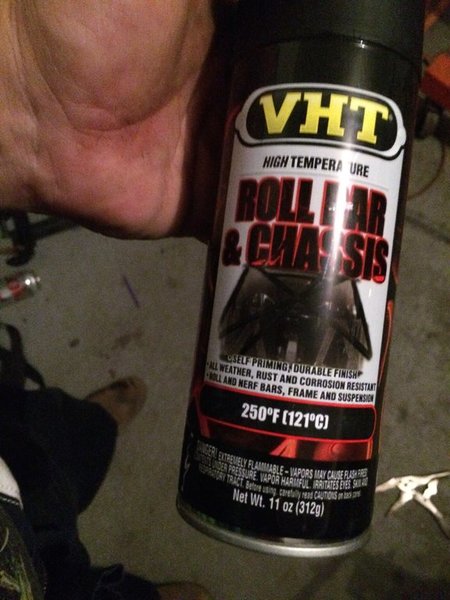

    Thanks.This stuff. I was pretty impressed with the finish. (Satin) now how well it holds up I don't know. This was kind of an experiment. Any auto part store should have it.

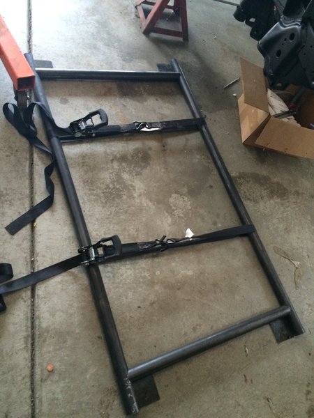

    Rained out at work. Decided to hit a project I was trying to put off. But it needs to get done.:sawzall: :welder:

    Ugh oh....I think I know what that is.....!

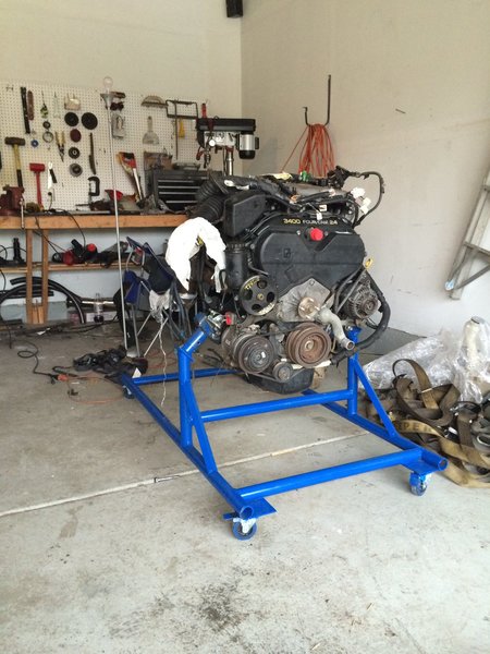

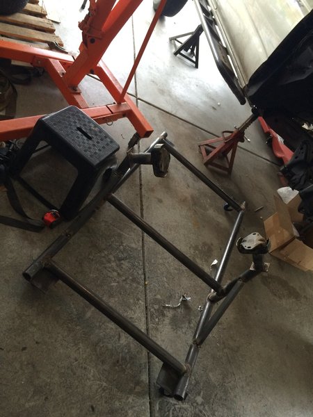

    Finished it. Just a coat of paint. And put the motor on it. I needed a motor stand to so I can take care of the timing belt, ect. And put the tranny on when it get here.

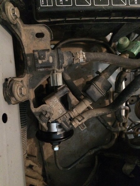

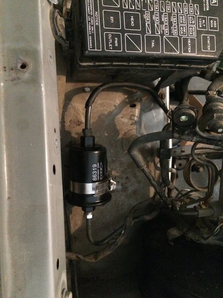

    A couple of weeks ago I bought a fuel line and when I went to install it the line was a little short, around a foot and a half. So I bent back my original fuel line added a filter and made another fuel line to end in the original spot. I couldn't use the accrual bracket that came with the filter so I just used a hose clap. Not the greatest looking thing but it works. Good thing my charcoal canister is over the tank or else this would of never worked. I don't think it will be an issue with the location but I needed to start somewhere. I'll move it if it because an issue.

    As long as it's not soaking up heat, it should be fine. I understand the 4 cyl was mounted right next to the block?
  13. Oct 25, 2015 at 9:41 AM
    #373
    SilverGhost
    SilverGhost [OP] Well-Known Member
    Sep 16, 2013
    #112635
    8,717
    RayRay
    Reunion, Co
    02,03 some 04, it's complicated
    #junkyardparts
    Yeah it is under the intake where it went into the head. So the new filter isn't far from the original spot.

    What are all the hoses and gizmos above the filter?
  15. Oct 25, 2015 at 9:50 AM
    #375
    SilverGhost
    Sep 16, 2013
    #112635
    8,717
    RayRay
    Reunion, Co
    #junkyardparts
    That is a great question:notsure: I don't know exactly what they are but I know they run to the charcoal canister to the rear.

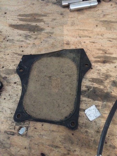

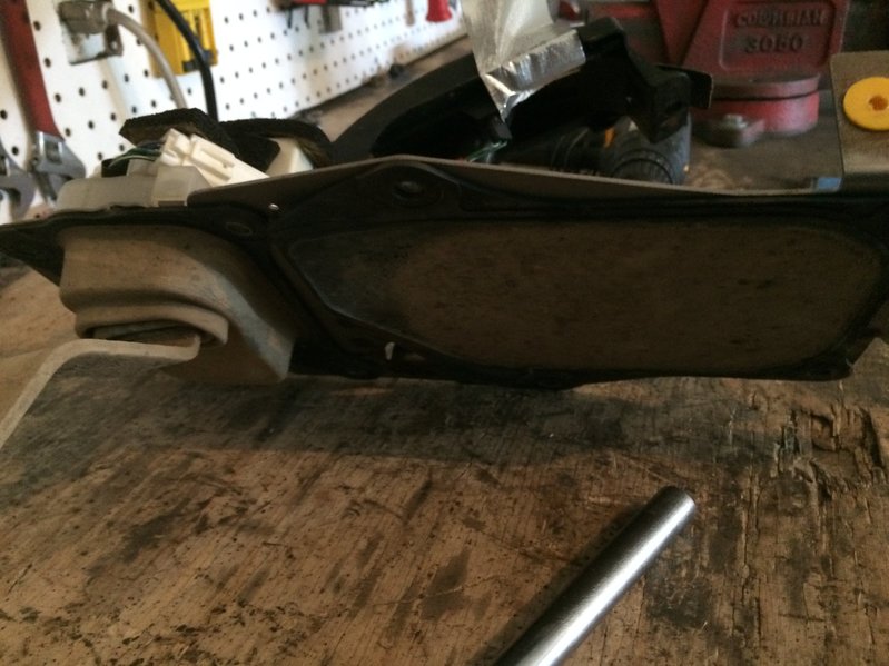

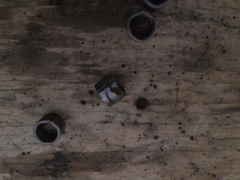

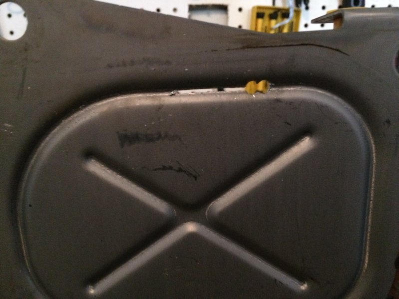

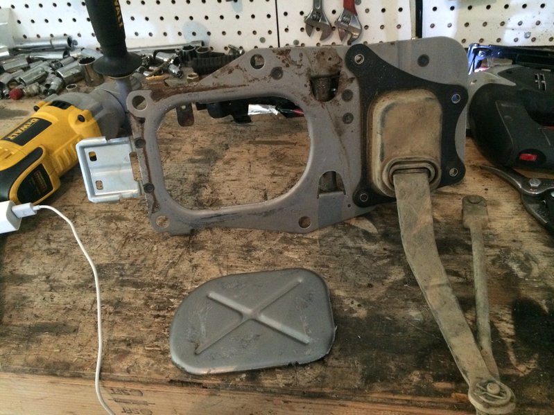

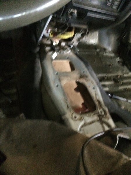

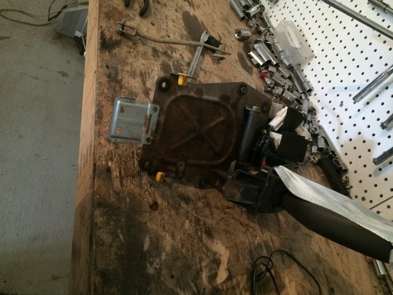

    I did the shifter plate today. Getting it ready for the TCase.
    So to get the rubber piece off you have to remove the steel sleeves.
    I drilled two holes and then used my jigsaw to cut it out.

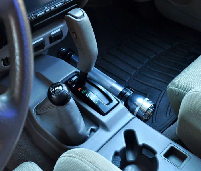

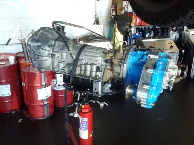

    ^ What T-case you going with?
    I did the same things you are now doing when I installed the Inchworm 4.7 Lefty. I made my shifter after starting with the J shift kit from Marlin Crawler. Works killer.
    You need part #'s for the shift boot?

    Here is the part number for the OEM 4x4 console: 58802-04080-B0 This is for the grey or Dark Charcoal.
    Below is a pic of my trans just before install and the shifter once I finished that.
    Hope this helps you.
