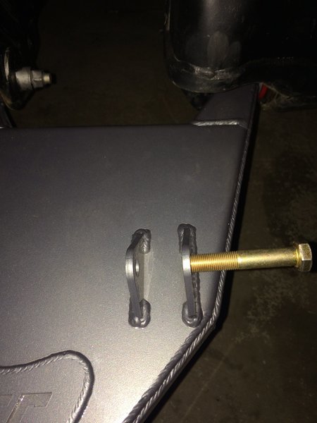

    Big thanks to @InSainFab for getting these done for me.
    Giving them a quick coat of paint.

    Corey does some real purty tig welds don't he?
    Just noticed that they labeled your spindles L and R.
    Must've thought a 1st genner would need a little help :D

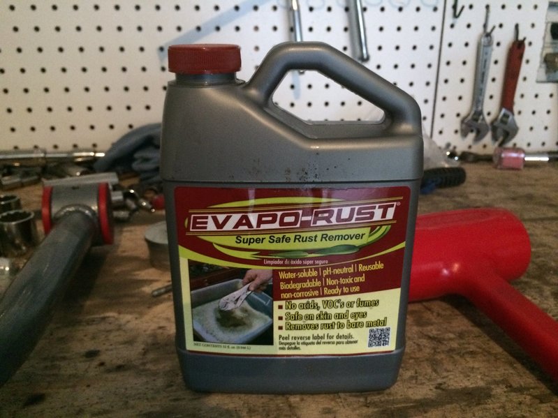

    I also soaked my cam bolts in this stuff. Works awesome. They are very clean and look like new. I did get them from a junk yard so they did have rust on them.

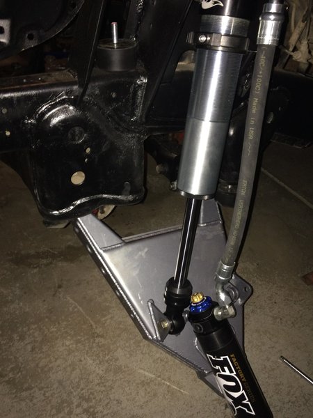

    Spindles are painted and I should get the new ball joints from camelback Toyota by this weekend and start cycling the front Long travel.

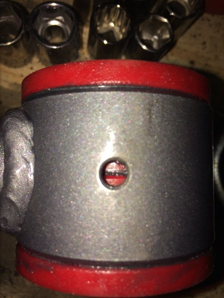

    I came across a couple of speed bumps installing the LT kit. Powder coating in the holes. For the grease zerks and bolt holes. I ended up pulling a thread off one zerk but got a replacement from work. Then the bolt holes I had to file the powder coating to get the bolt through. Just little things really. I just figure I share for the next guy thinking about this kit.
