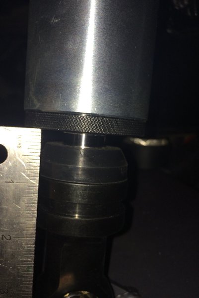

    @Gramps, So I called Fox today and the tech told me as long as I see some of the shaft between their bump and that end plate I'm good.

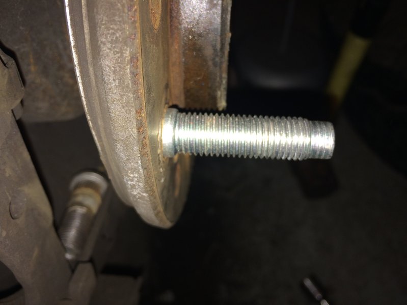

    I also ran into another problem with my new ET lug nuts and wheel studs. I can't use either with the wheels I have. So I also called Method today and found out I need an acorn style lug nut with a 60* angle. The wheel studs shaft is just a little to long for the front. For the rear they are just a tad to thick. Been doing some homework and measuring and found another wheel stud I can use. This time I'm going to pick one up at auto zone before I buy all I need. I'll post results later.

    I picked up a wheel stud today to give it a try. It worked out great.
    With the 1/4" spacer I have just over 1/4" gap. Then when my son jumps on the frame it compresses to about an 1/8. It never bottoms out.

    I wouldn't cut it too close Ray.
    When you huck that thing, or rather when it lands, it's going to be a whole lot more force than your son bouncing on the frame...
    j0shu4 and SilverGhost[OP] like this.

    Yeah I still wonder on that. I mean on one hand Ray is using all the travel possible which is what we ultimately want but on the other hand I would personally sacrifice a bit of travel to insure not having a suspension catastrophe after a mall speed bump. :p

    I hear ya. Once those bumps get a few hits on them they just might need another spacer. I also jumped on the frame too and the boy said it never bottomed out. But as much as these coil overs cost I'll add another 1/8 spacer. Thanks for your input guys I really appreciate it.

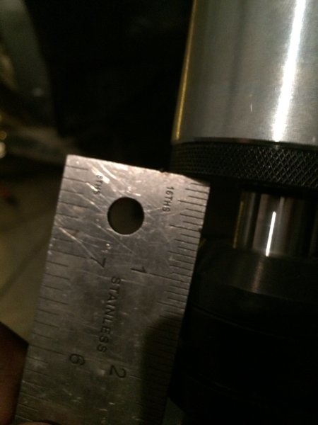

    The bump stop spacer is now just over 3/8". I now have 9/16" of shaft showing. While I jump on the frame I still have quite a bit of shaft showing.

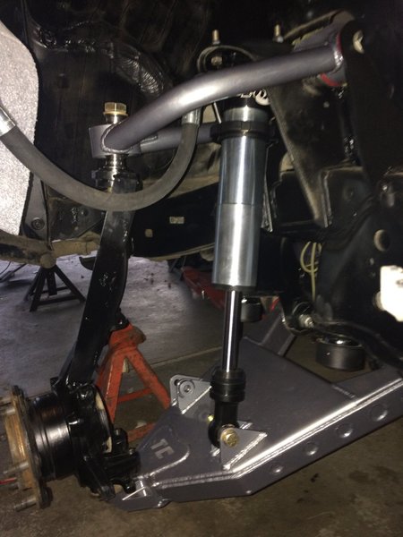

    It's finally on. I still have to do the limit straps and remote reservoirs.
