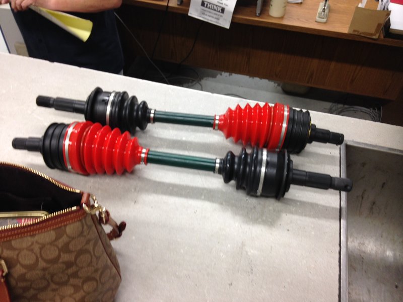

    Cvj will only rebuild oem which are of better quality. Napa are great spares to carry but if you can afford cvj they are best

    Dylan and I also talked about RCV and he said they are not worth the $$$$. That's when he mentioned CVJ.

    What's CVJ so I know for the future? How do they differ? I picked up the napas because I thought for over another 1k for forged axles was ridiculous. I'm sure the napas work fine as a bunch of other guys run em with no issues.

    http://www.cvjreman.com/index.php
    I'm pretty sure you should be fine. Worse case scenario, they break and you get new ones. Not a big deal. Things break. :D

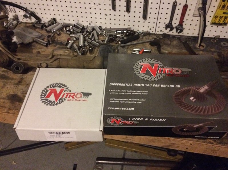

    Sep 16, 2013
    #112635
    8,716
    RayRay
    Reunion, Co
    02,03 some 04, it's complicated
    #junkyardparts
    :woot: 4.56
    I would of gone with 4.88 but I didn't have the funds to regear the rear diff. I should be good with 4.56 running 33".

    412.00 with free shipping.

    My wife just sent me a pic of the new CV's. They are sexy! The ones I took in look like shit and had me worried.

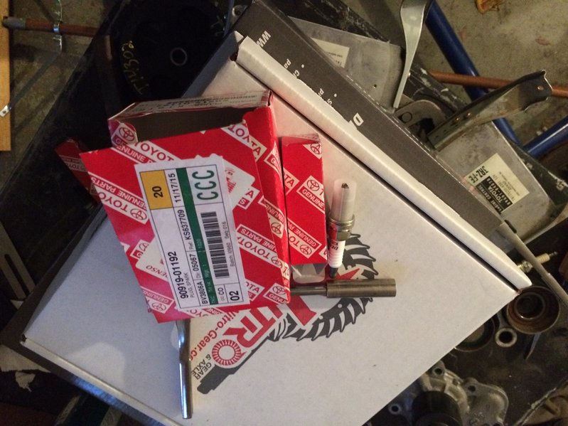

    I got a few things done today.
    I got lucky. The transfer case came with a boot for the shifter. So I removed the one i cut and installed the right one.
    I replaced the steering rack bushings that I got from wheelers off road. Thanks @BDN I used a bolt and washers to press the sleeves in.
    I replaced the old outer tie rods with new OEM ones. I Had to put the Tie rods on left on the right and right on the left because of the curve in the tie rod to be facing away from the secondary shock mounts on the LCA. I also added the TC extensions for the tie rod. I added the steel brake lines.
    The right spacers came in for the drive plate. There are two of them one between the plate and block and the other on back. I used red lock tight and torqued them down to 61 lb ft is a star pattern.
