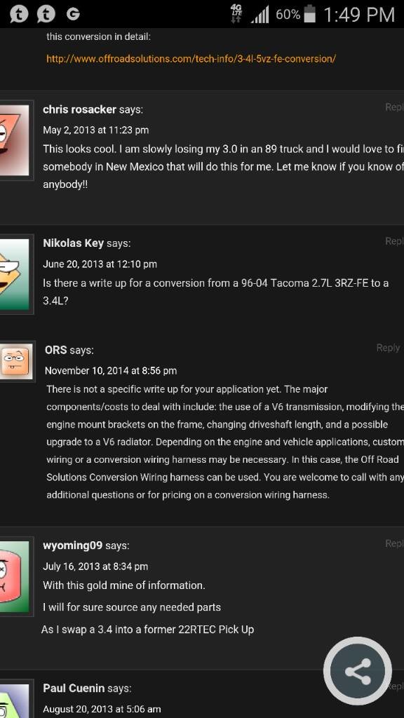

    That's the next thing. When I remove the tranny from the block I'll set it in and double check. Now if the mounts on the block it's self are off. I can't say for a 100 percent. The motor did come with the mounts already connected to it plus I found some interesting information on the mounts. A company offers conversion plates for the mounts but I don't trust the design. Looks weak. Now to make sure the mounts on the block are for sure correct I would have to see a 3.4 and compare to what I have to make sure 100 percent.

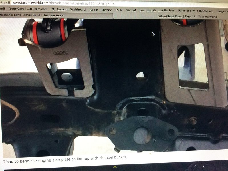

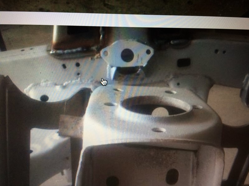

    Been doing some home work and I remembered about a buddies truck that he stripped down to the frame before he built his LT truck. It's a 3.4L. Here's a comparison of the motor mounts. Both of his mounts are closer to center on the coil bucket. @steezemcqueen
    Driver
    Passenger
    Mine is just forward of the coil bucket. Driver
