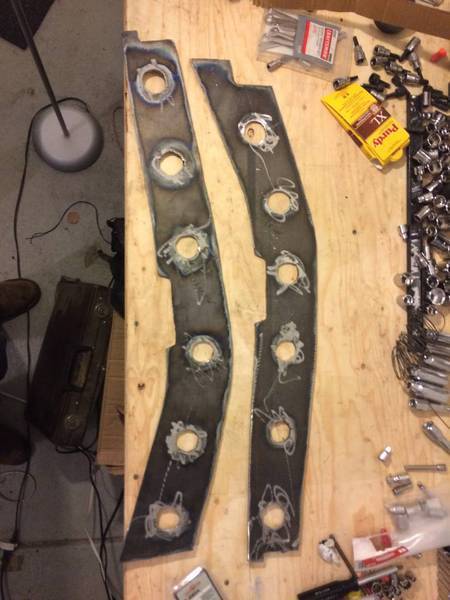

    You need more cardboard, maybe laminated layers, doesn't look stiff enough for the support you'll need.
    That paint looks good though. :cool:
    Any plans to box the frame whilst the bed is off? Or just the side plates?

    Yes I'm going to box the frame too. Then move to the bed cage and double tire carrier.

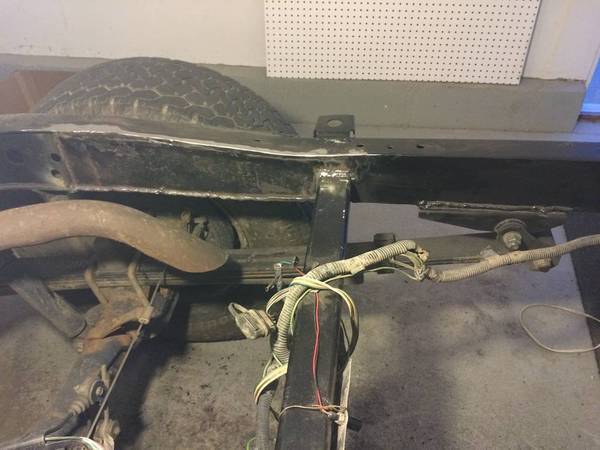

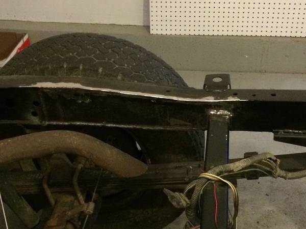

    Another project done. Only cost me about 18.00 to get done.
    [​IMG][​IMG]
    Forgot the jack so I improvised.
    I painted the backsides of the reinforcement plates and silicone in-between the tac welds on the frame to try and keep water from getting behind the welds. Trying to keep the rust out from between the the steel.

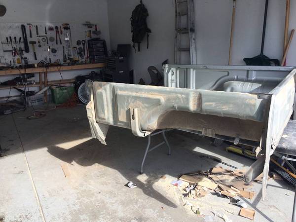

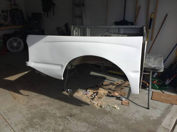

    I was sent home from work due to snow. So I got started on the bed.
    Test fit to see what they look like.

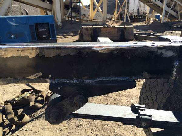

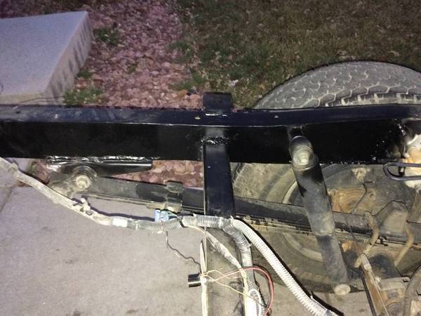

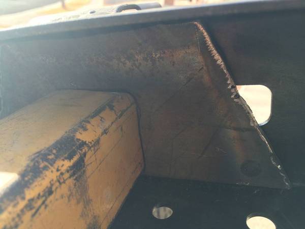

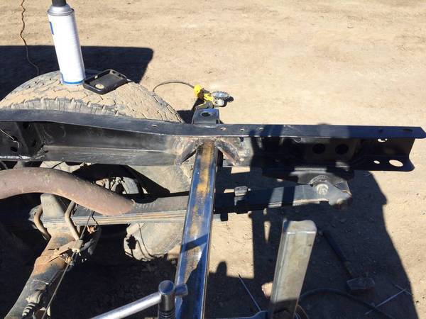

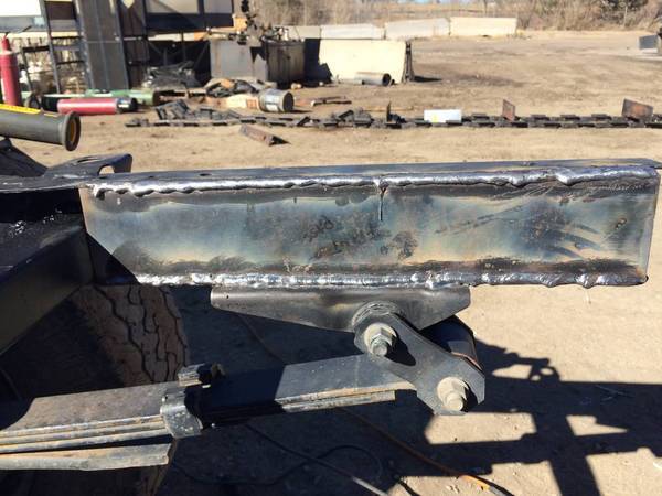

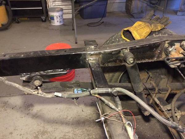

    Finished boxing in the frame.
    This is 1/4" tube and I added 1/4" plate on the inside the frame. I've seen welds rip the meat out of thin steel when being pulled. But this should hold well.
    More cardboard stencils.....
    I also added 1/4" gussets on the side of the tube.
    I did the plate in sections and welded it all together. I buffed what i could and painted it.
    Another project done. Time to move on to bed cage mounts.

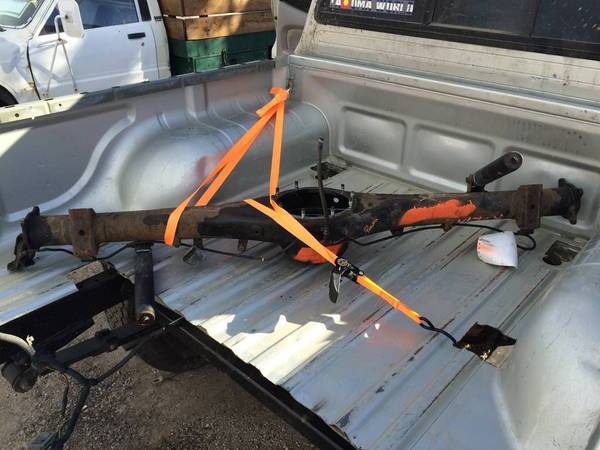

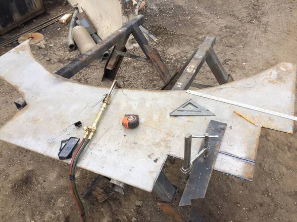

    Picked this up before I lose out on it.
    Started cutting up 1/4" plate to make cage mounts.
    Put the boy on grinder duty.
